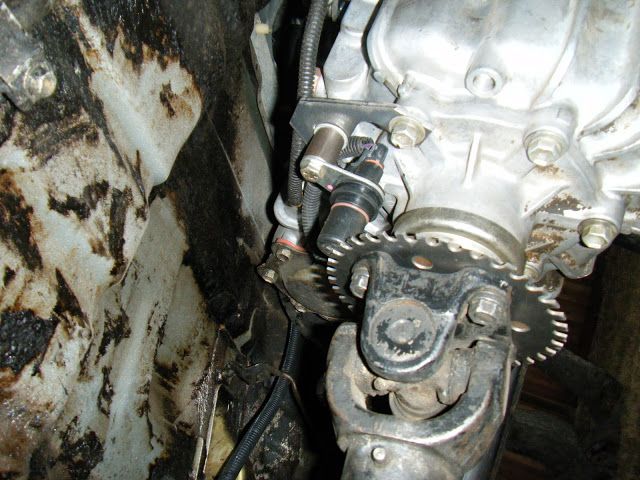

Hey @orangefj45 Georg,
Did you come up with this vss set up or know who did on Oyajijon’s fj60?

I’ve seen several VSS setups; about 6 that I can think of.
The one pictured was already installed in the vehicle when we worked on it.
Iirc, Ron @ Custom Cruisers made setups like this, he may have built that one.
