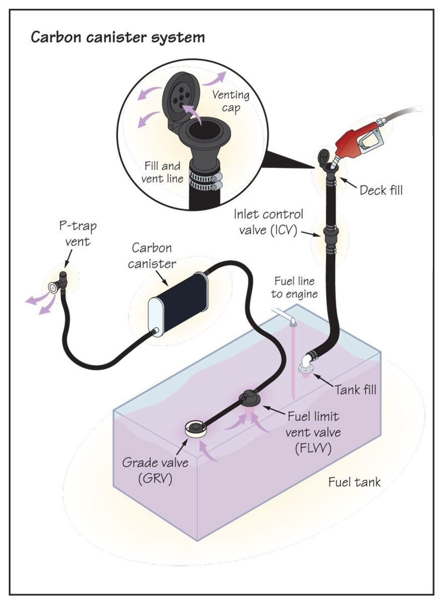

Maybe for our 04-07 LC100 we have to use venting cap separated from main filler port. Maybe need another electronics controlled valve. For more environment friendly, second canister is needed as well.
I've had a few thoughts about this sloshing issue. I don't need a 1" vent to atmosphere. I only need to release an equal volume of air to fuel coming into the LRA Aux, so that the fuel neck doesn't back up. 5/8" vent should do it. Also, putting a couple 90 degree couplers in the hose should impede liquid fuel from getting too much momentum, but not reduce too much vapor escape.

Did you install and anti-spill valve?
I'm building it just like the diagram in post #68. My first anti-spill valve is to not roll the truck. But not a terrible idea... I'll look into it. Seems like Holley Racing makes one that could go in-line. Ideally, I'd locate it down in the wheel well, just before the vent hose enters the OEM jack storage compartment.
Yes, I see in the diagram what looks like an anti-spill valve but can't see anything like that in your pictures. I'd highly suggest something in place in case of roll-overs. I was on the Rubicon trail the week after this bad accident involving spilled fuel.
