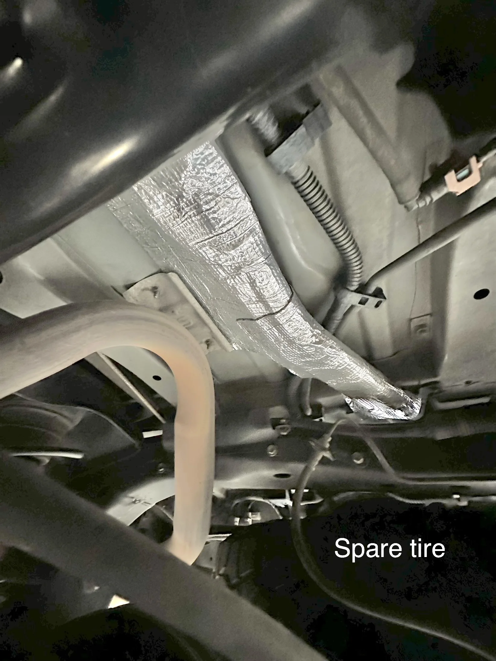

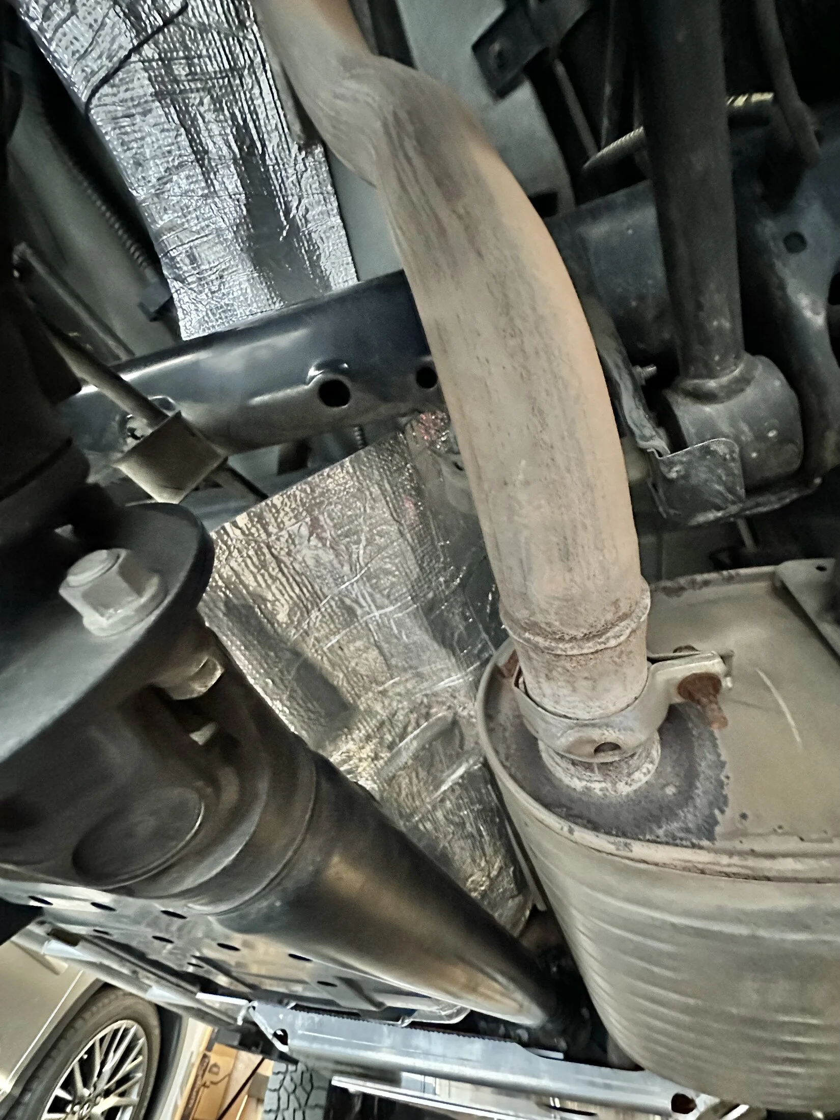

Mine is an 06 and Yes I replaced the fan clutch when I did the timing belt and water pump et al service. What solved my gas tank venting and fuel spewing out of the filler neck problem was insulating the gas tank. That’s it, the issue never happened again. It lowered the fuel temperature in the gas tank hence lowering the pressure as well.
How did u inuslate it?
