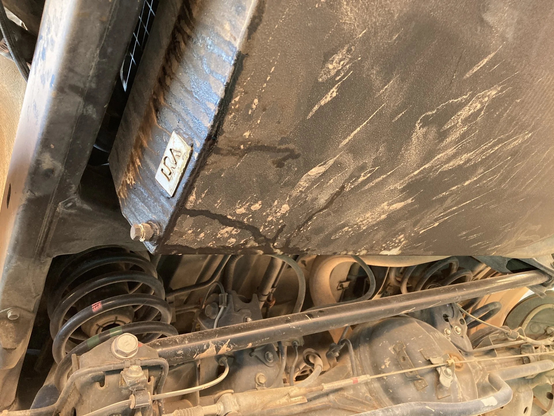

(UPDATE 05.14.22 - LEAKS, FUEL SMELLS, AND EVAP CODE ISSUES RESOLVED. CRACK IN FACTORY WELD. SEE POST #44)

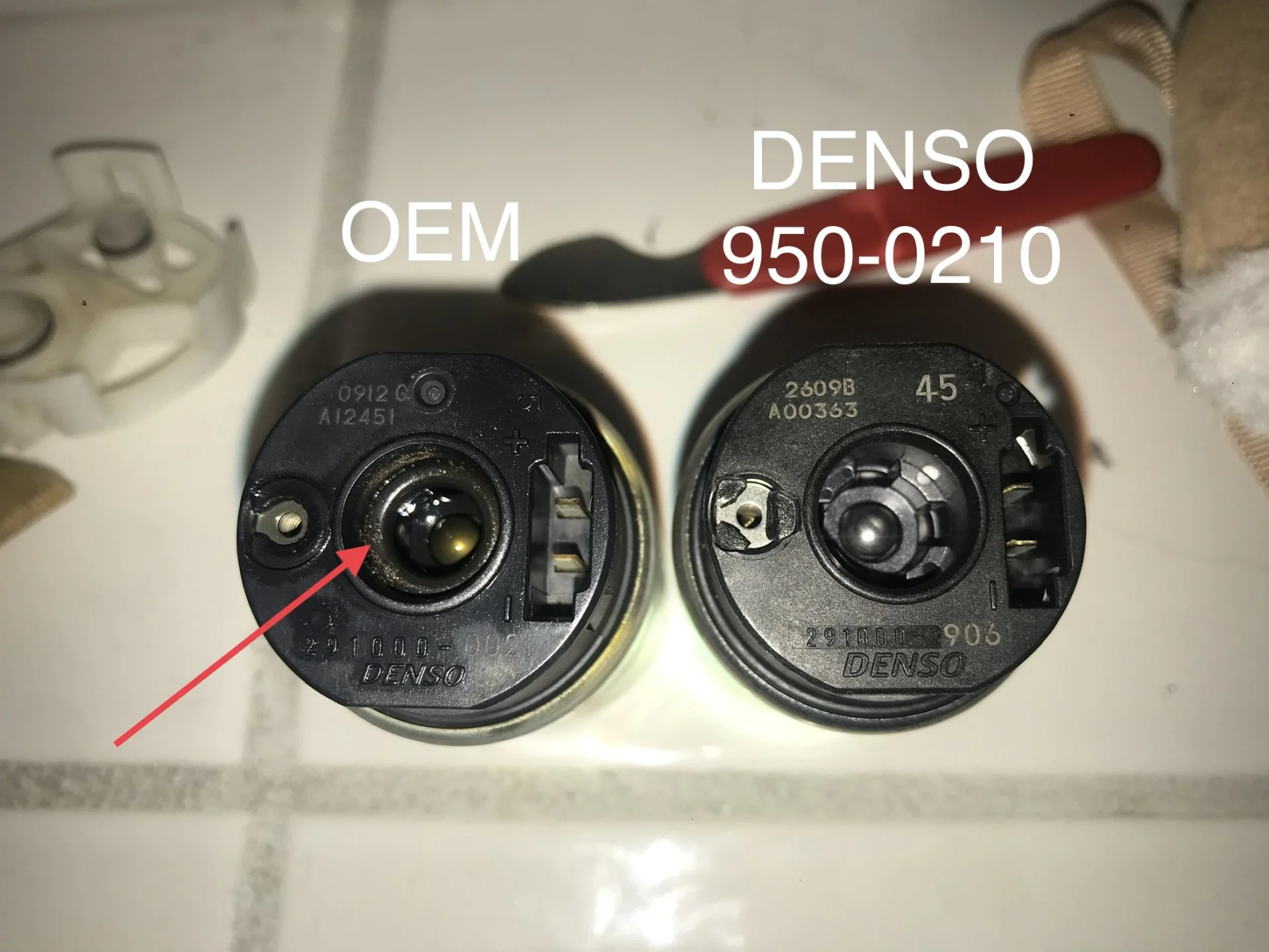

This is the part number, and try not to forget to transfer that critical rubber o-ring (red arrow) from the old to new, otherwise your engine won’t start.

To clarify: is the Denso 950-0210 and aftermarket part that you recommend using to replace the OEM Toyota part (which is usually a 5digit-5digit part number? aka, what is the difference between these two parts in the image?
The difference is just the part number (sorry I would have to look up the original part number and get back with you). Both are made by Denso which is the component provider of Toyota/Lexus. But if my memory serves me right, the old part number is no longer in production and has been replaced with part number 950-0210. Which is also used by the Tundra Platform which share the same motor with the VVTi (that experienced the same symptoms of stalling under high temps/high altitudes).

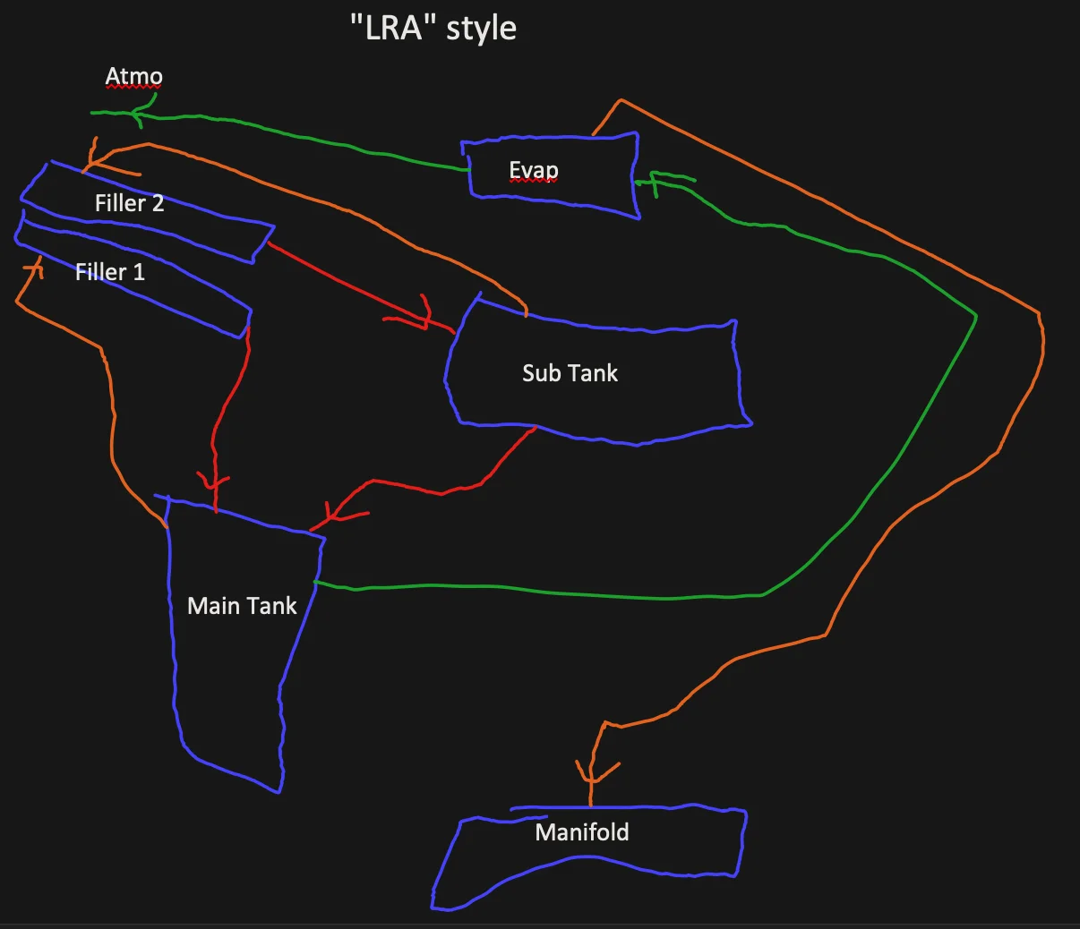

Is the solution you propose something that you could represent in a sketch? That would help me better understand precisely what you are describing.

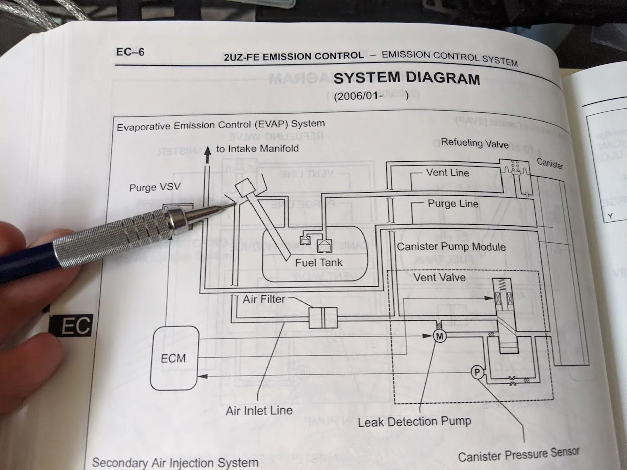

This diagram is from the Lexus manual for an 06.

The EVAP/charcoal canister is the same on the late 100s as what comes on Prius, Scions, and Camrys of the same era. They are definitely undersized and cause problems on stock 100s. But there is also a second problem of excessive heating of the fuel by the engine and exhaust on the 100. I documented the 4 best things I did in this post: Gas tank building excessive pressure & fuel smell. Dangerous for sure! Why does this happen? - https://forum.ih8mud.com/threads/gas-tank-building-excessive-pressure-fuel-smell-dangerous-for-sure-why-does-this-happen.1214321/page-11#post-13251496
Like I said spewing fuel out of the filler cap after climbing a mountain on a hot day is something just about every 100 owner can attest to. That's probably not being caused by the LRA tank, but maybe exacerbated by it.

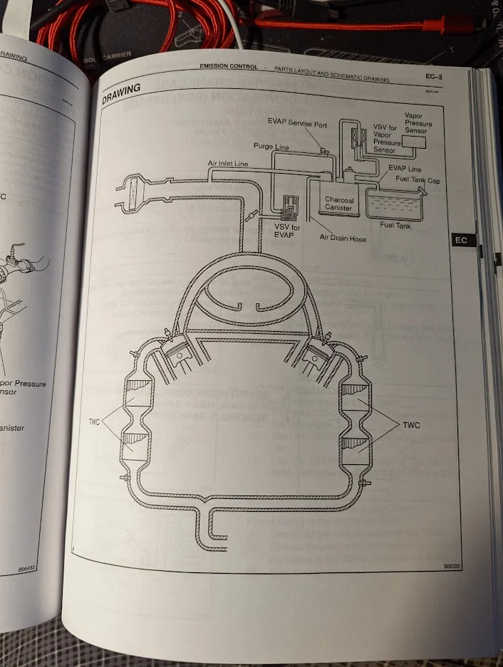

I'd be curious to know how this schematic compares to that of a pre May 2004 built vehicle.
I'd also like to know how the evap system on a 100 with a factory sub tank differs from that which LRA offers.
At your service. Here's the 99LC system.
