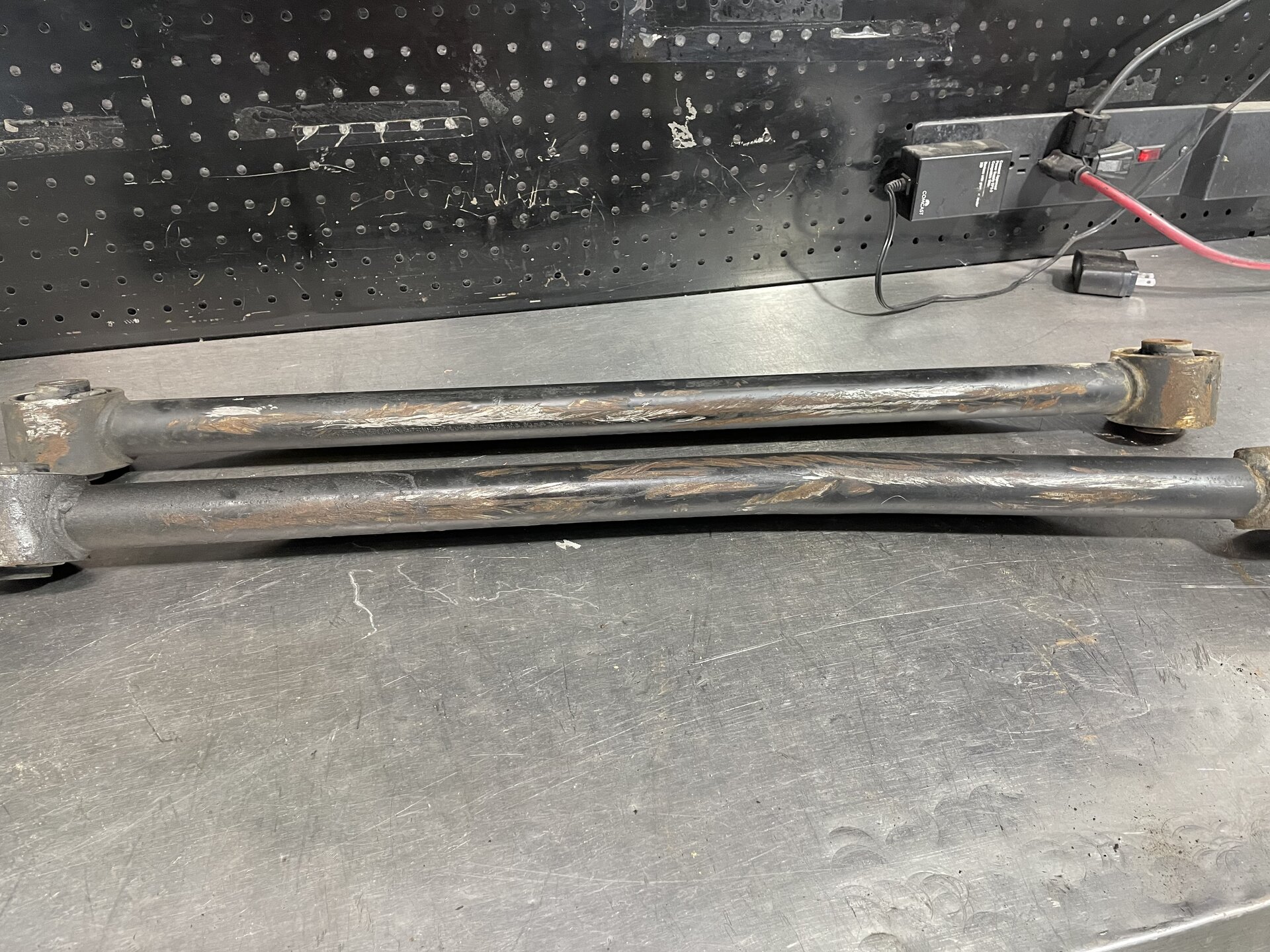

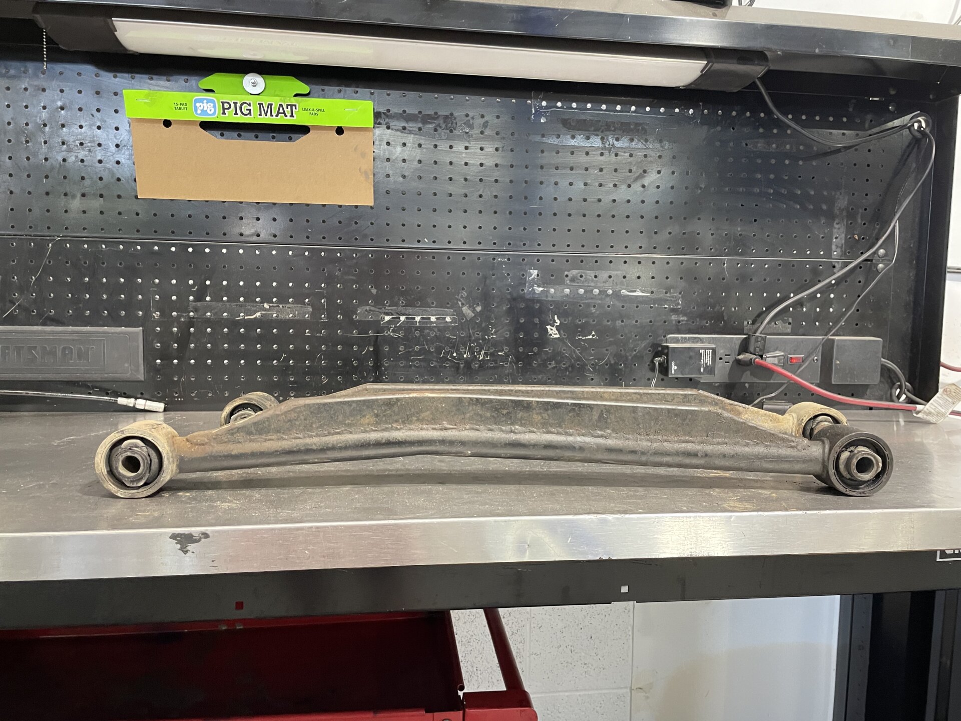

Hi All,
I have standard oem lower arms to fit to 80, they have no markings.
They don't appear to have any off set, Is there a front and rear or left and right for them or can they be fitted any which way?
Cheers
They can be fitted any which way. They are symetrical and identical.
While they're out, now is the time to up-armour those bad boys.
If you are replacing bushings, make sure to go by this TSB from 1996 which is reverse applicable.

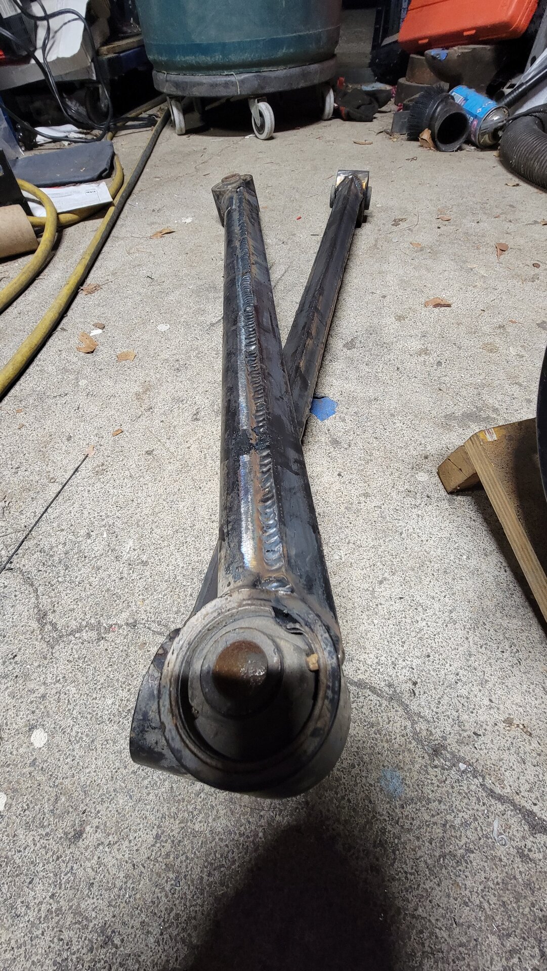

It helps, but they still bend.
I’ve even bent one of my blackhawk replacement. 🤦‍♂️
1/4" wall dome tubing cut in half never been a problem since. plus 93/94 have bigger arms.
Bent up a few before that, been about 5 years now no problem ;)
