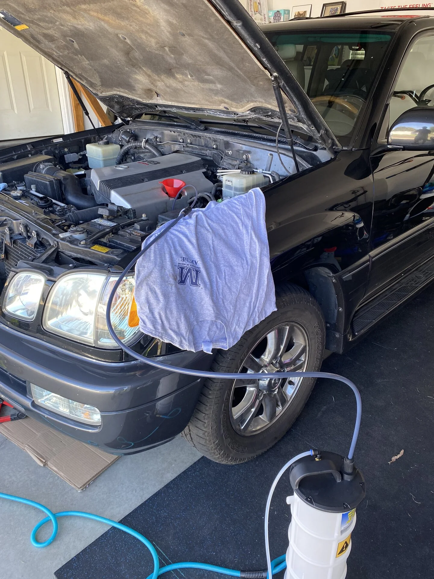

I used an extractor and sucked out the oil from the dipstick. I wouldn’t necessarily recommend this but I didn’t want to open a can of worms. I got out 6.3 L or so, so I feel good that old stuff is out. You will have to shove the hose in there pretty hard and I “skinned” some of the hose forcing it through the 45 degree elbows.

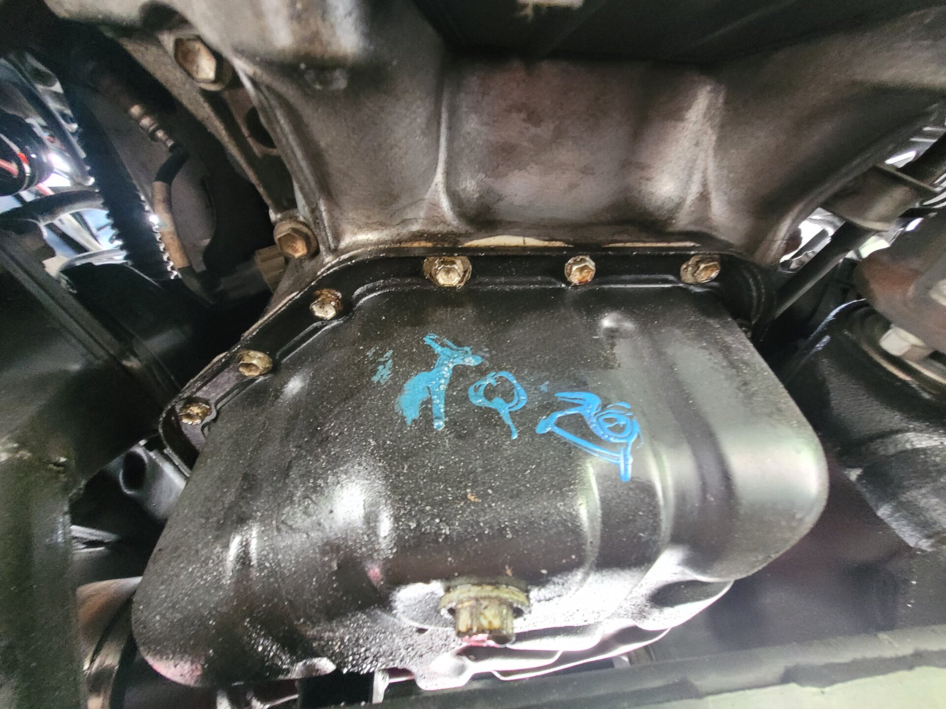

We don't usually see pans leak, unless they've been removed.
Seeing oil only on LH side. I'd look along LH side of engine for point of leak.
Best way to find leaks: After taking pictures of all point wet/oily. Is to clean all oil off engine and re take pictures, so you've evidence it's clean. Than watch after each time engine run, for point oil leaks first from. Work from pictures of wet areas.

Oil dip stick tube O-ring. Replace O-ring. 98% of all 4.7L weep here. This weep over time, builds up becoming first noticeable on LH side of pan, just like your picture.

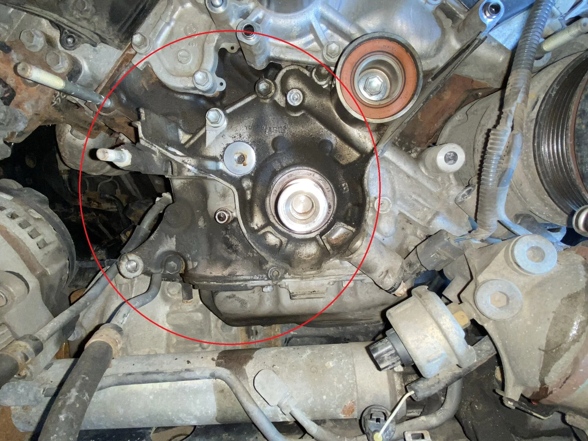

You said "Cam and Crank" seal leaks. I'll assume the crank seal leak was front of engine. If so, was it the factory seal in place at time of leak or a replacement that was leaking. I do not see factory crank or cam seal leak on 99-05, only replacements.
At the top of the oil pump housing is an O-ring (must remove oil pump to replace). We see these weep, but some are leaking bad. The ones leaking bad, usually are engines that had HM (HIGH MILEAGE) oil in them for 2 oil change or more. These engine also leak at rear main crank seal. HM oil damaged all rubber seal, which the oil pan is not affected, as it's FIPG (silicone) seal. These engine leak very badly.

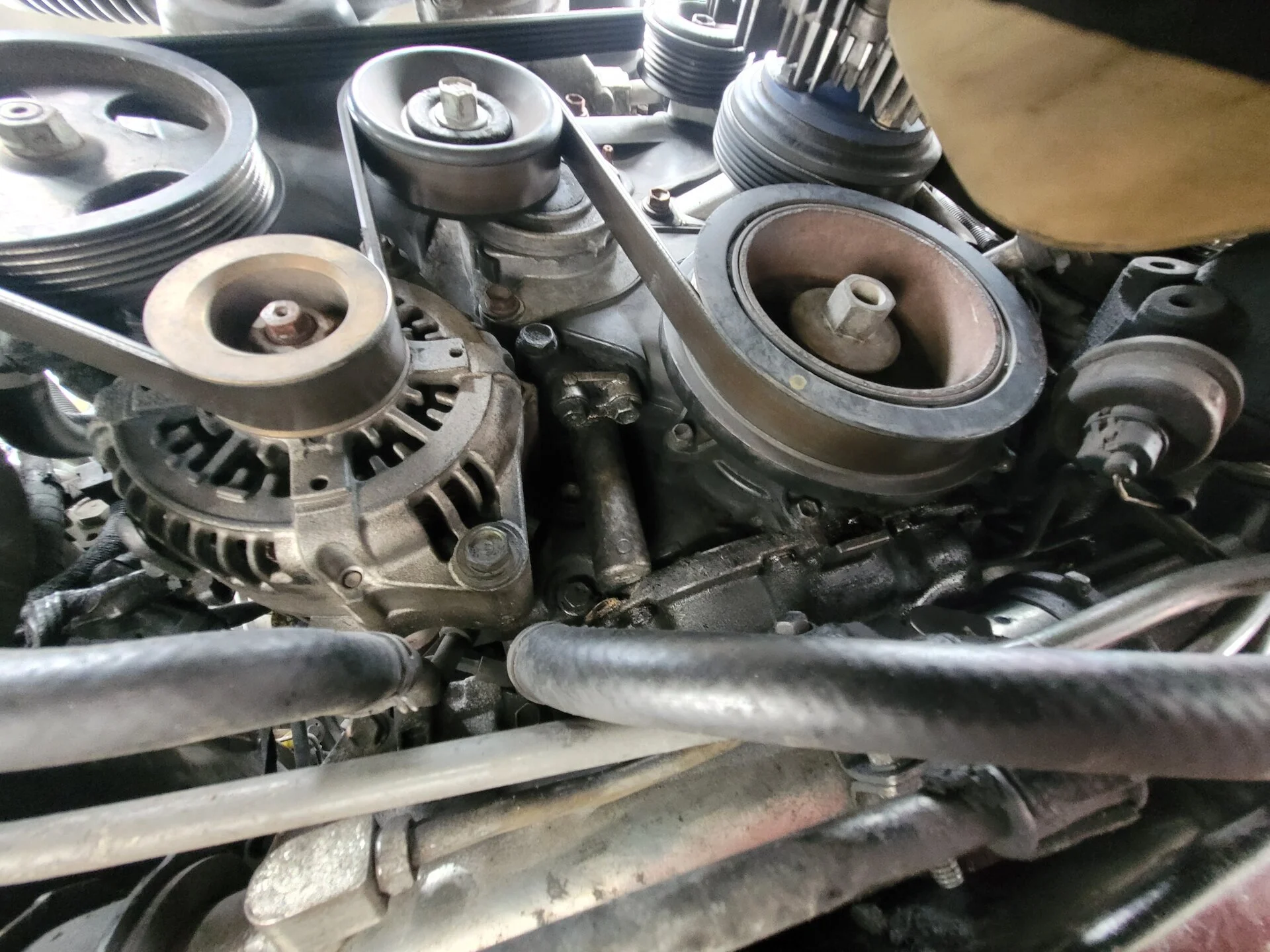

I haven't started into dismantling yet... only took the undercarriage shields off to inspects and gets all parts rtg. Scraping off caked on grime and sprayed with degreaser.
I know there a leak above timing belt hydraulic tensioner.
I know there's a leak on passenger valve cover.
I know there's some kind of leak on the power steering pump reservoir, atf running down both hoses to the pump.

I don't know if the front crank and cam seals are original. Engine has over 350k. The LX is new to me, I don't see much in way of service records.
Ill start to research rear main crank seal.

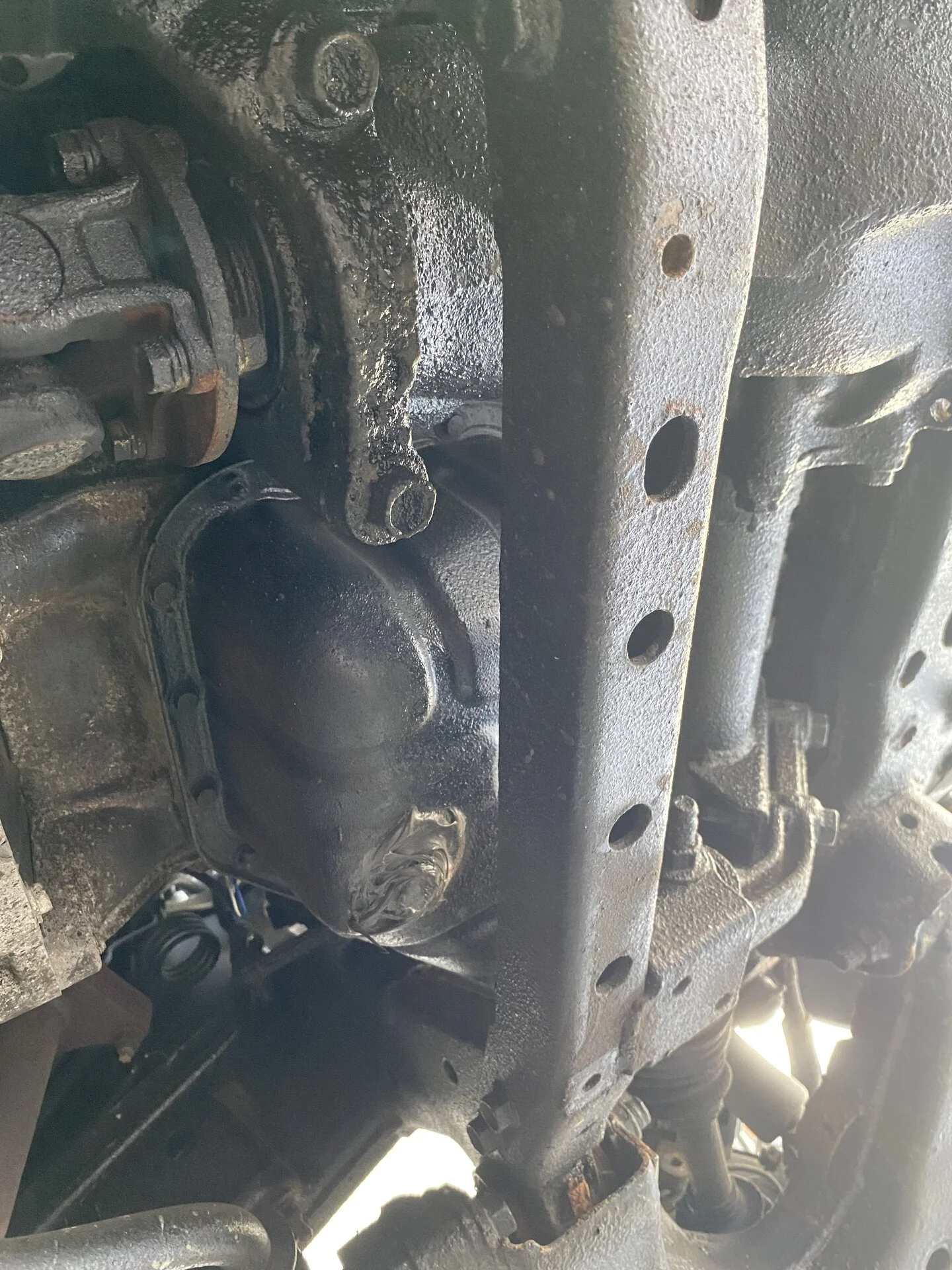

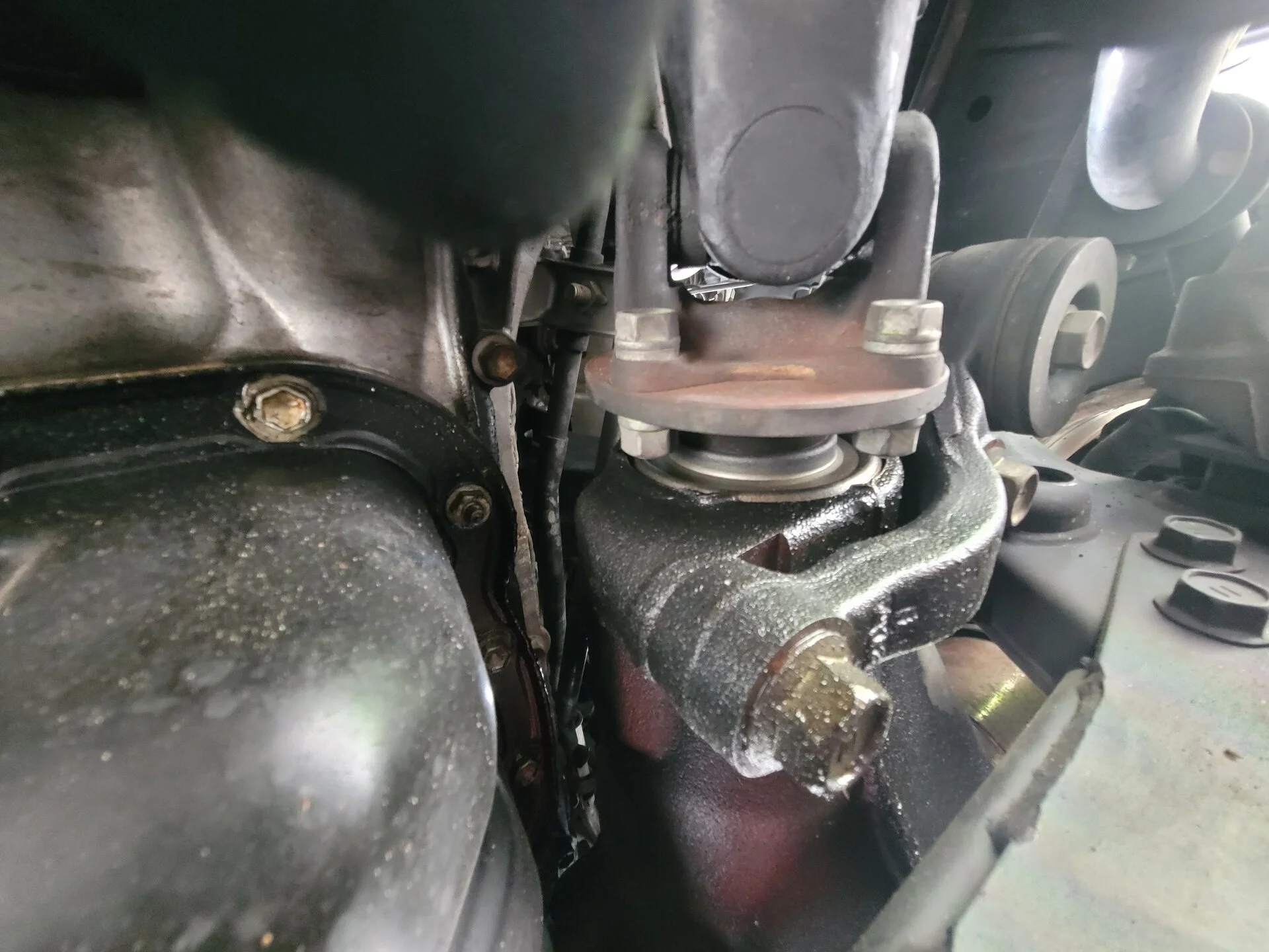

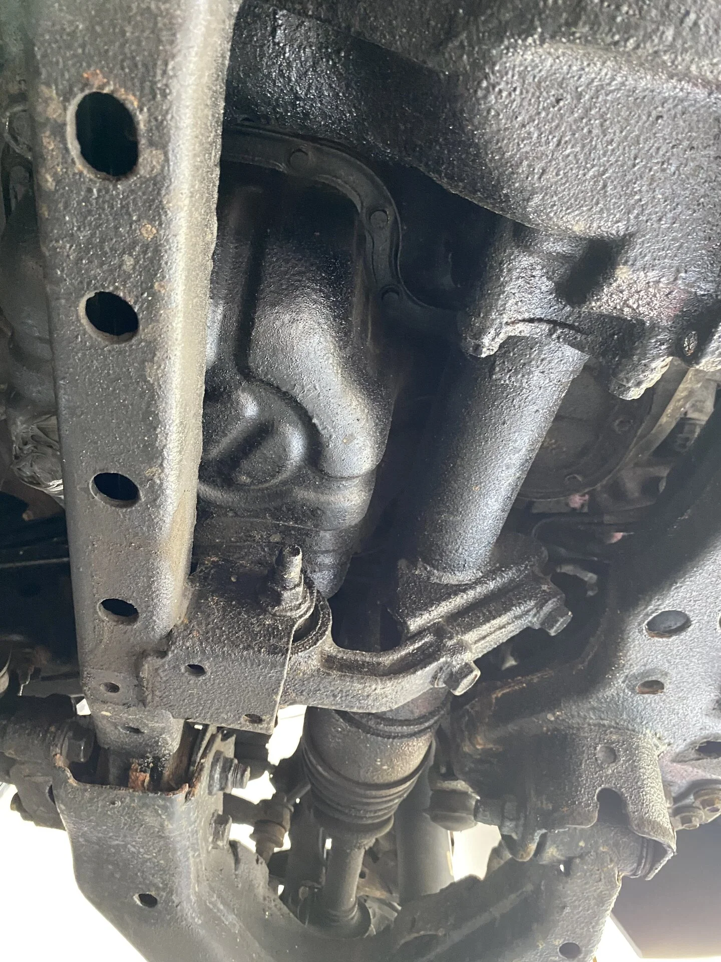

I do think front differential has a seal leak as looks wet and could be slinging oil around.
The cv boots looked intact but I did notice a lot of oil/grease caked onto lower control arms.

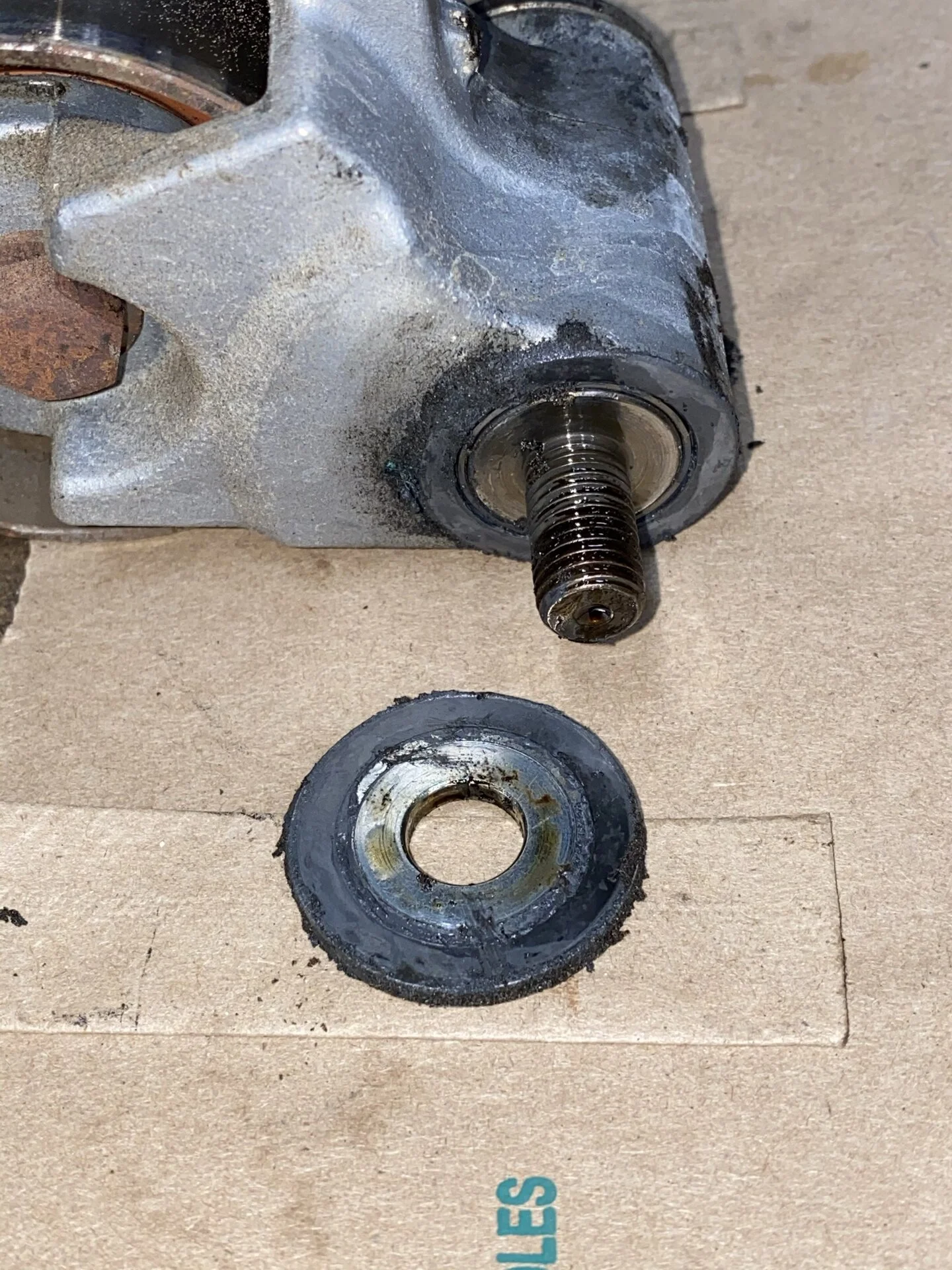

Very common leak seen front RH engine around timing belt tensioner. It is due to not sealing threads of timing belt #1 (tensioner) pulley.

Can this be fixed without a whole new belt job? I believe that is my leak. Waiting for a few more drives and checks, but I think that is the source.
Yes. But you'll need to go as deep as T-belt job. Just no need to remove water pump or #2 idler.
