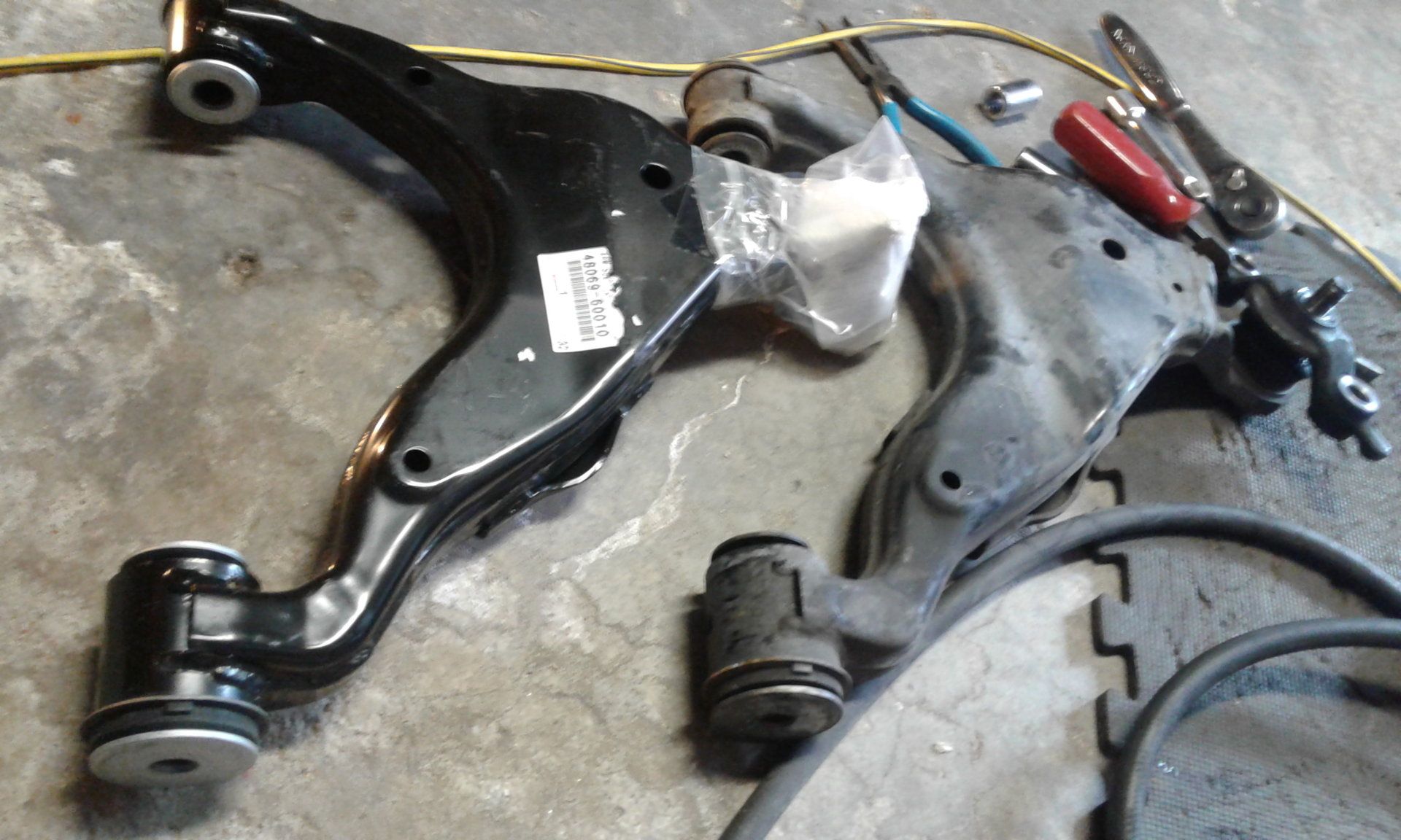

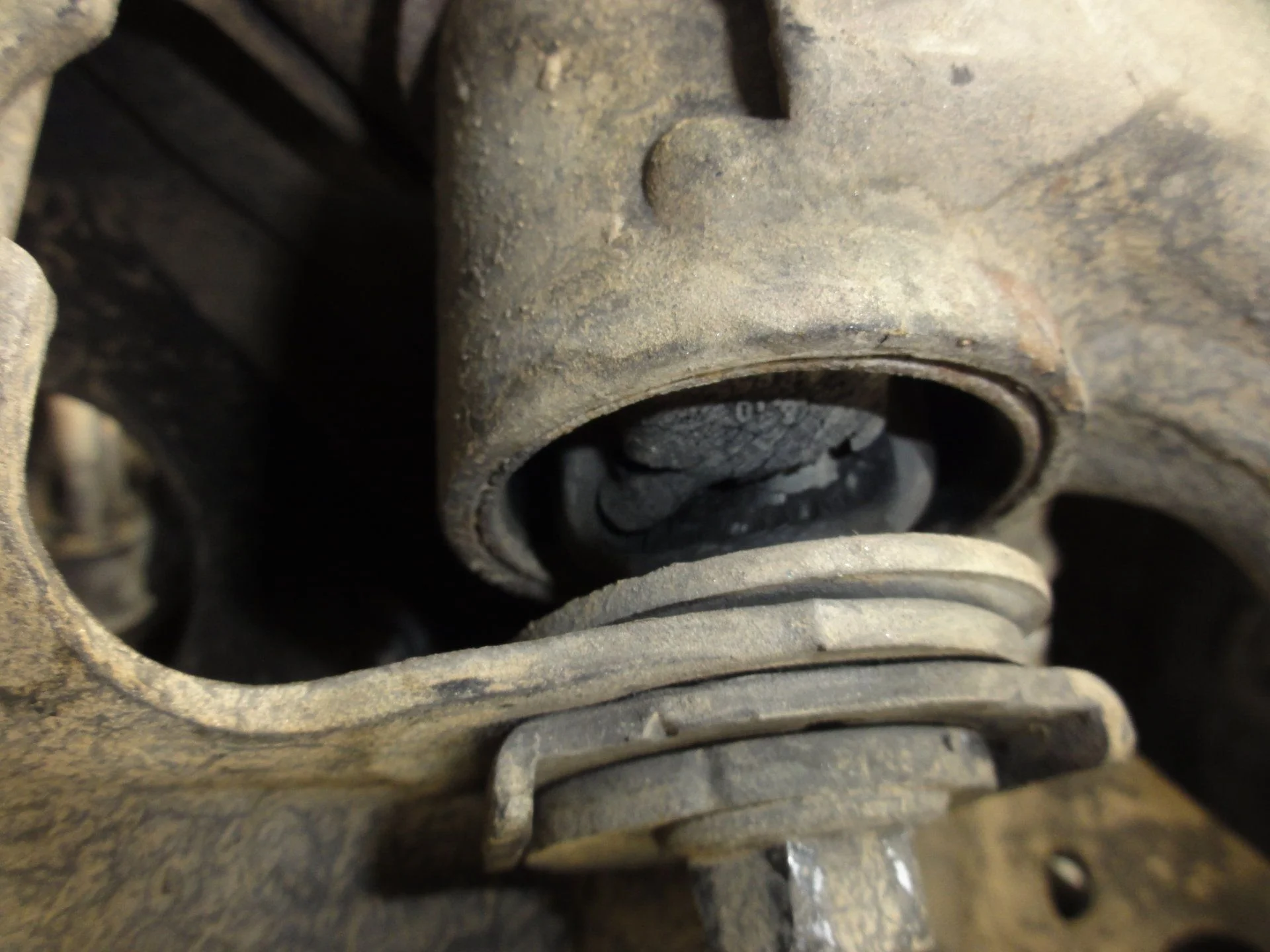

I'm not sure what's the best thing to do and keep it low cost. Here's a picture of one of my bushings from the LCA

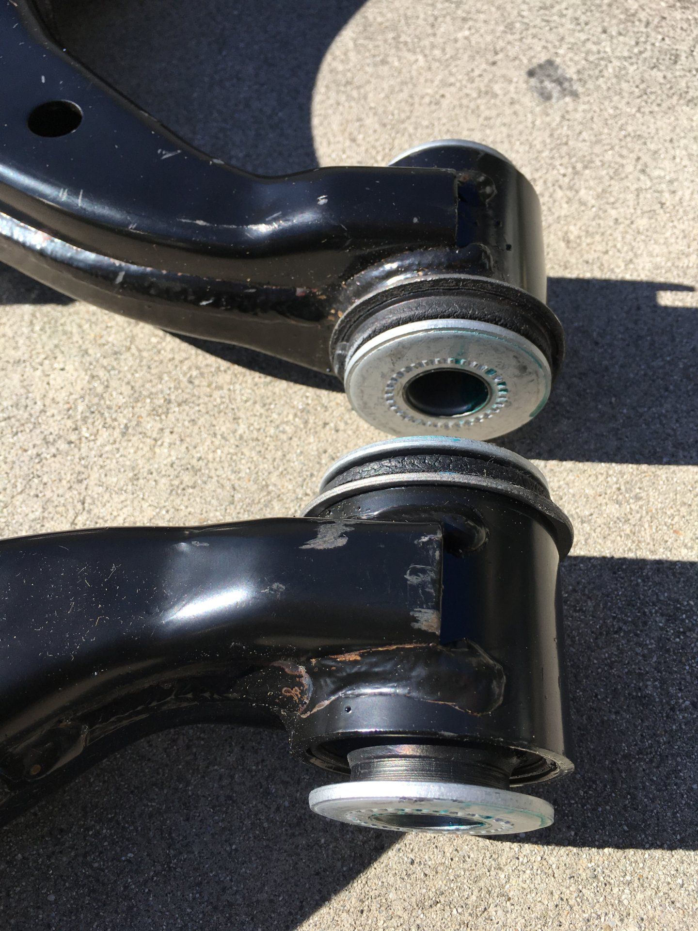

I went with new OEM LCA's. I got them off ebay and the price wasn't much greater compared to the after market offerings. The originals lasted 12 years and 128,000 miles. That was enough to convince me to spend just a bit extra for OEM replacements. I don't want to redo this job anytime soon.

I replaced mine with new OEM LCAs because I didn’t want to redo the job in a few years. I got 11 years and 174,000 miles on the original set, so OEM made sense to me.

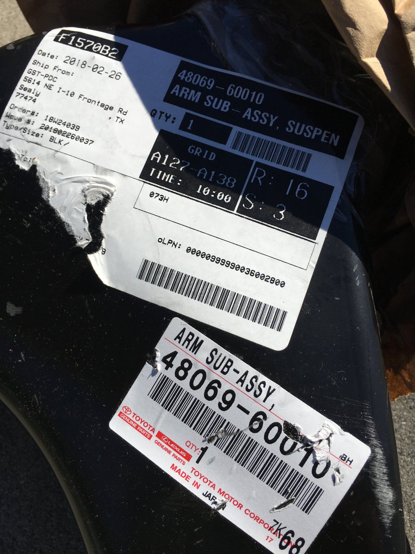

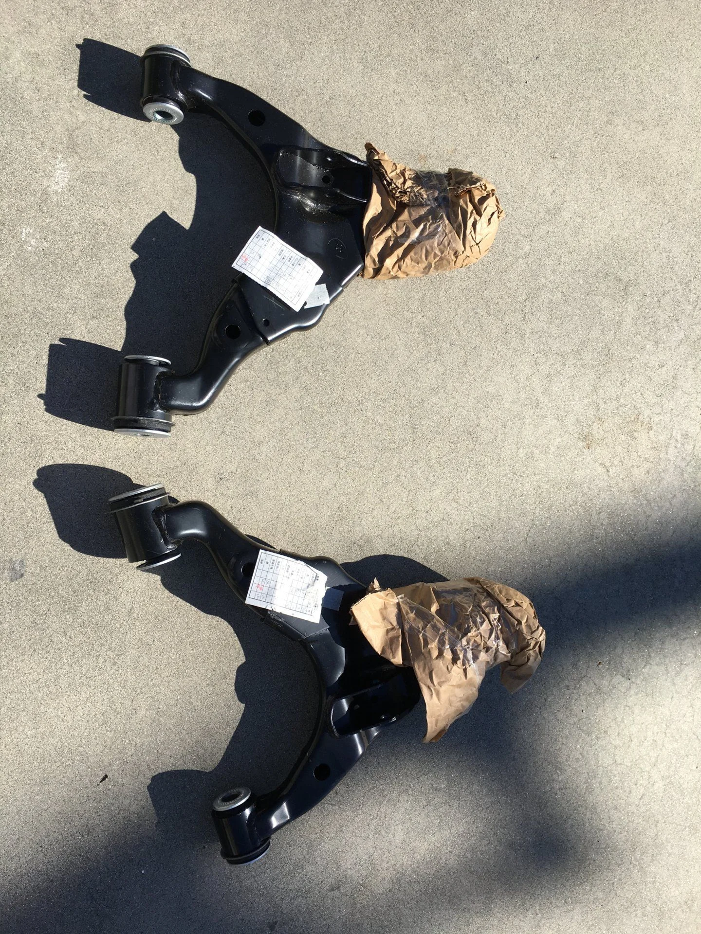

Decided to go with Toyota oem LCAs for $528/pair from trdparts.com with free shipping and no taxes upfront because I'm in a different state. I think they are in Houston, so no upfront taxes to California.

I've only got 85k miles, but the boots on my ball joints are cracked and seeping. Can you just replace the boot?

Moog makes good stuff with my experience. For the boots on the ball joints, not seen replacement boots before. I just R&R the joints if they are exposed and getting sick.
