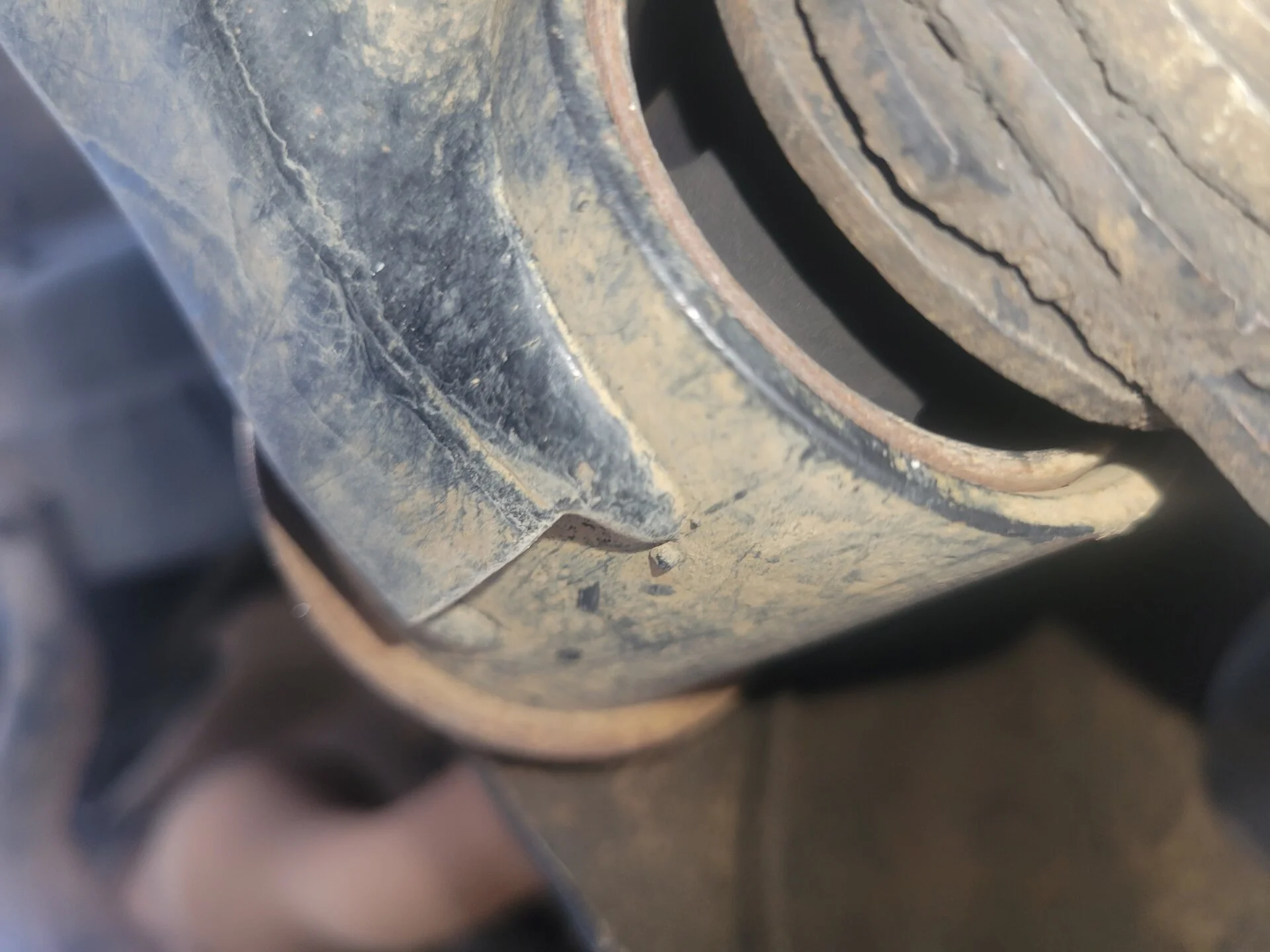

My OEM arms had cracked bushings and floppy LBJs at 145k. They might have kept going but the performance was definitely degraded.

I pulled mine at 180 and the bushings were good visibly and still had little give. The LBJ could move easily but had no play.

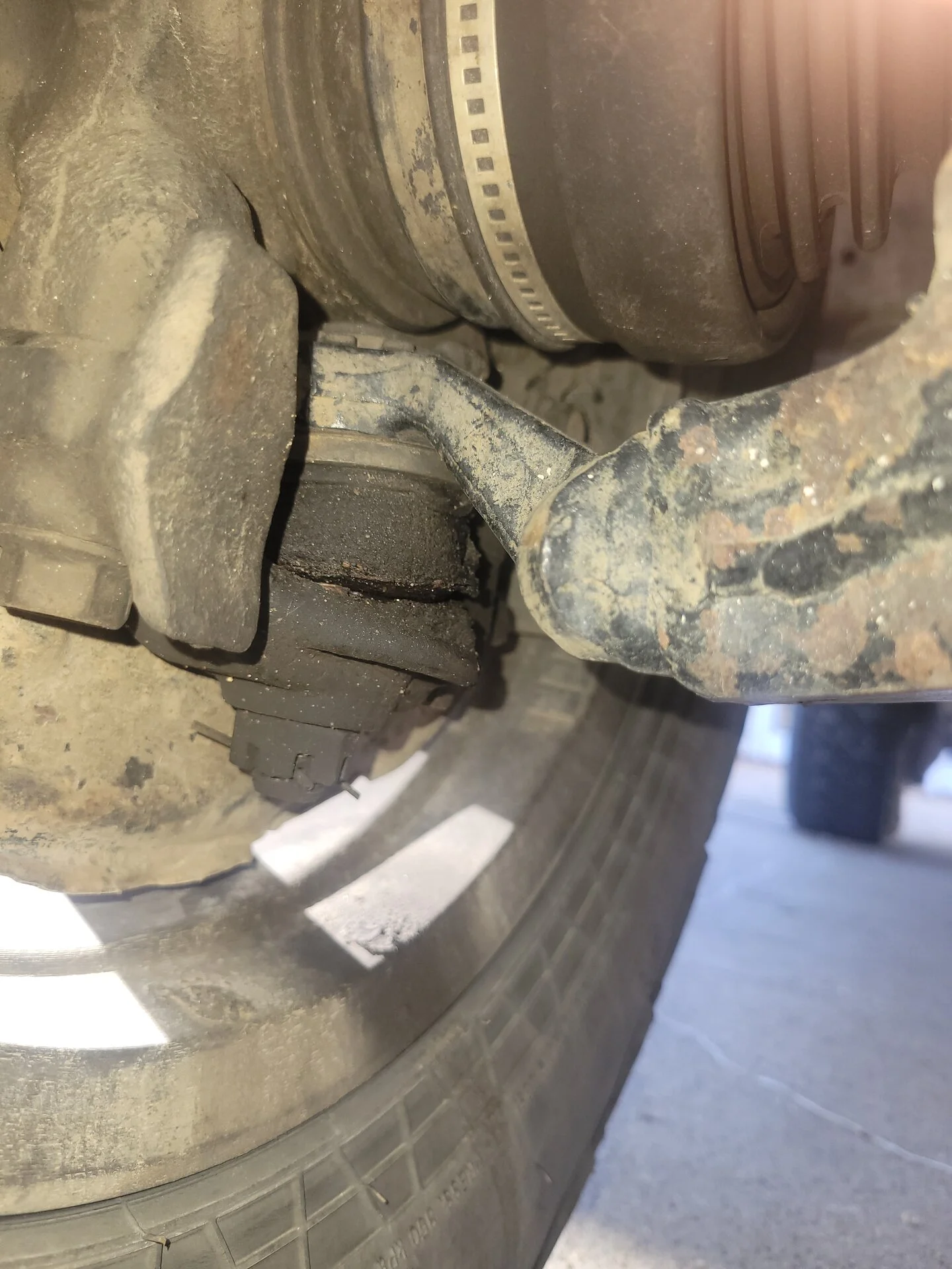

Here are my Moog LCA LBJs and bushings after ~30K of use. Zero issues. The greaseable joint does puke a bit of grease past the lower seal when I grease it at oil changes - just like any other greseable U-joint or slip yolk. When compared side-by-side the Moog LCAs are near-exact replica of the OEM UCA's, including the bushings. I'd get them again, but will also update this thread and my build thread if I have an issue with them in the future so there is a record of how long they actually do last. I have no idea of if these will need replacement at 60K or make it to 100K+ - only time will tell.
My GX does get wheeled and used harder than many, so these have seen a lot of non-pavement miles (washboard roads, occasionally getting a bit of air, lots of rocks, etc). I'm also lifted ~2.5" in the front. Since these have been good to me, we put a pair on a buddy's 1st gen Tundra (albeit with OEM Toyota LBJs given how failure-prone that style is) and they were also exact replicas of the OEM LCAs. They saved him a few hundred bucks as well.
