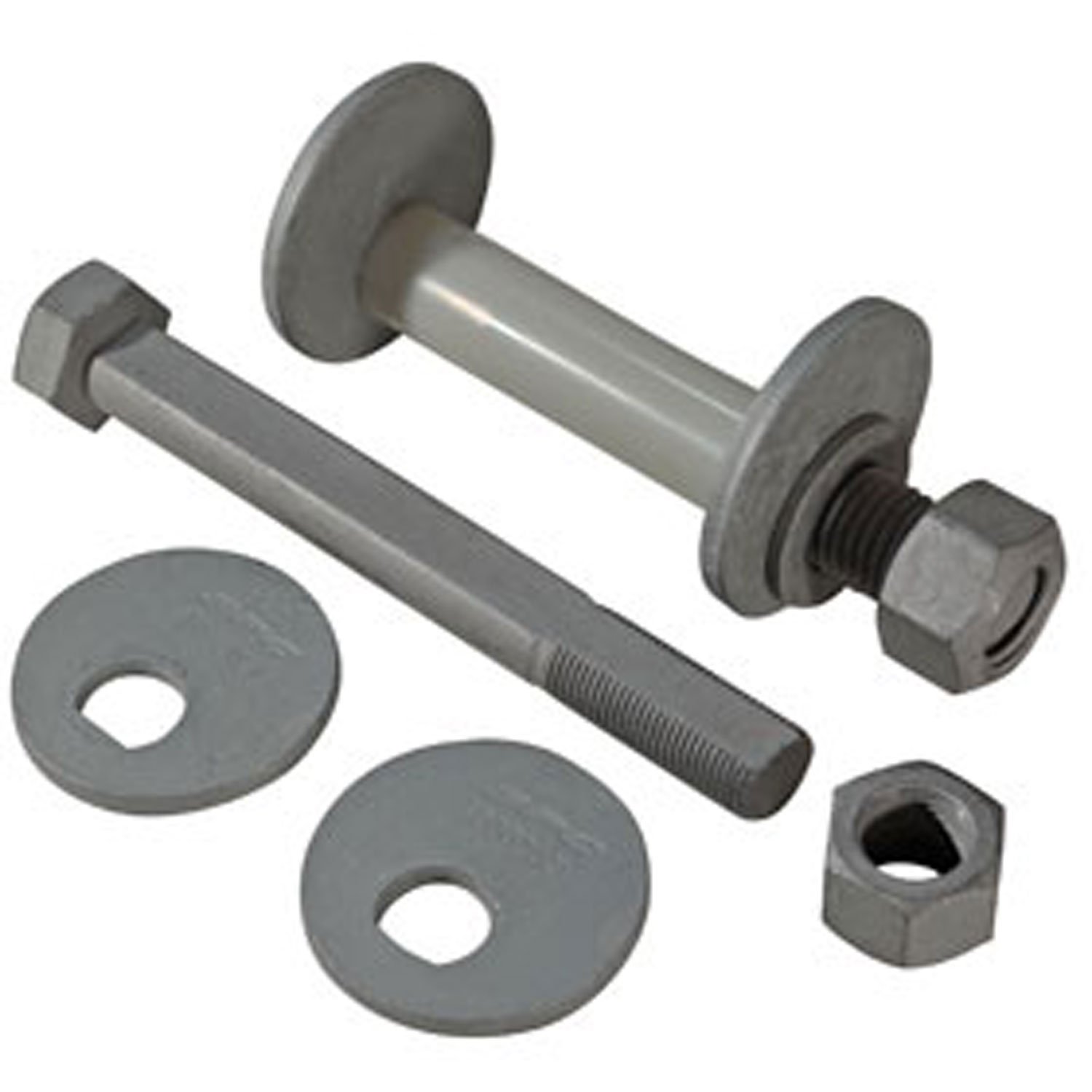

The bolt is in a sleeve. The bolt can seize to the sleeve with the cams. An impact may bust it loose though. Or it'll just spin the sleeve and hose your cam tabs. Worth a shot though.
Those are the the bolts that hold the control arm to the frame. I think he’s got a problem with the single bolt threaded though the shock.

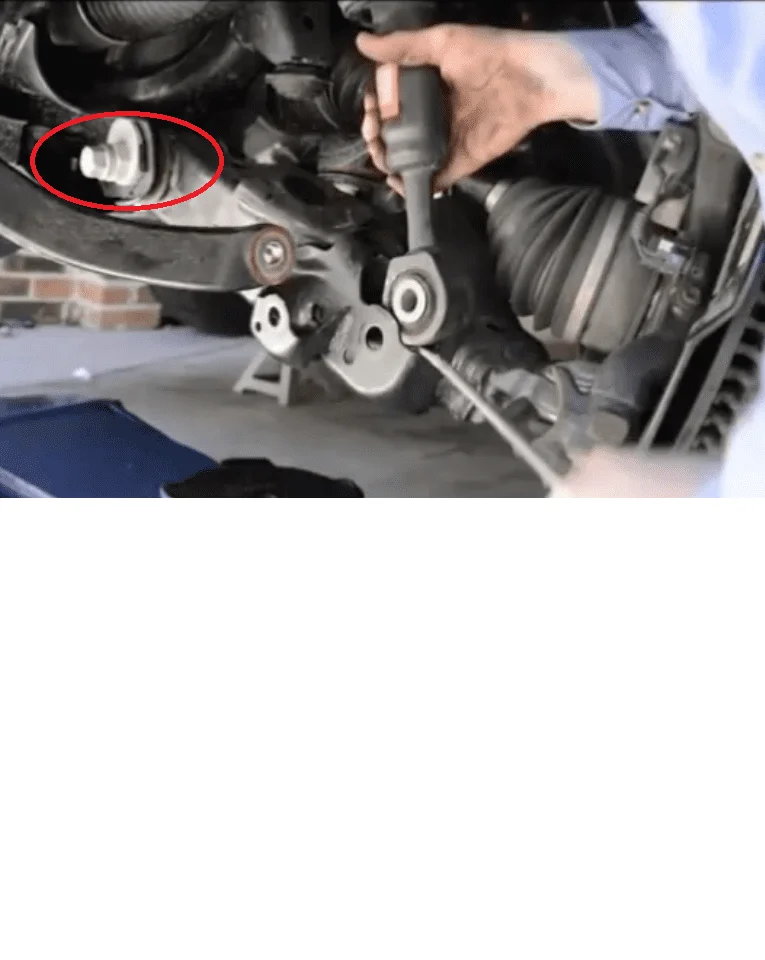

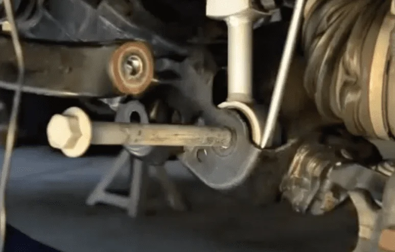

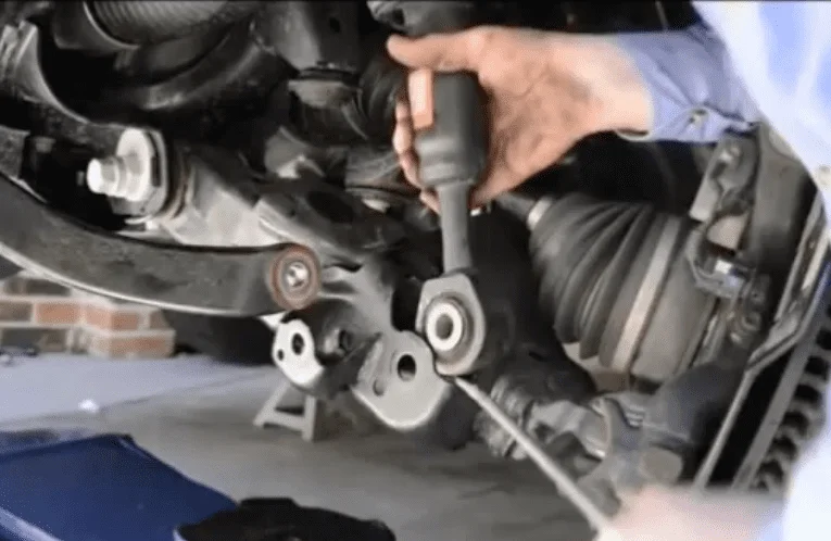

the one he seemed to have removed with zero problems...through the LCA/bottom of shock

Yes. Push down on the LCA. The LCA bushings are already pushing up. You can loosen the LCA bolts, which loosen the bushing tension, or you can take a long crowbar and just lever the LCA down.
In the photo you posted in post 10, the guy is using a long screwdriver to lever the LCA down so he can get the shock itself out, but same idea.
If you are installing a lift, it is often easier to install the new front shocks with the LCA bolts loosened a bit. This allows the LCA to drop farther. But be careful not to allow it to drop any farther than you need to, since dropping it too far can hyper-extend your inner CV joint (then you're screwed). And, again, don't fully retighten those until the truck is back on the ground.
