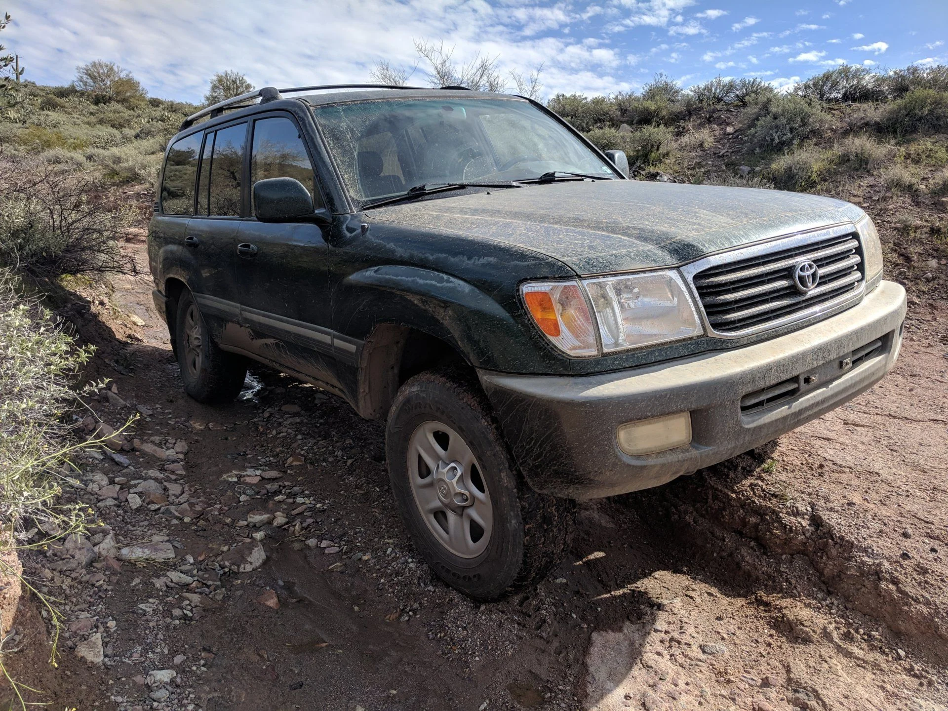

Got the OME medium lift installed. All went fairly smoothly. I will need to change things in the front end a bit when I install my new bumper that should be here soon.
Just realized you switched to the 18”. Was wondering why the gap looked smaller. Looks good BTW, can’t wait to my lift all situated.
Thanks! I'm happy with how it turned out. The ride is stiff, but coming from a history of sporty cars, I feel right at home. I can definitely feel the lift getting in and out, it's a bit more of a hop than I needed before:bounce:
I will probably go back you the stock 16s eventually when I get new tires but maintain the same overall tire size (33ish) and look in general.

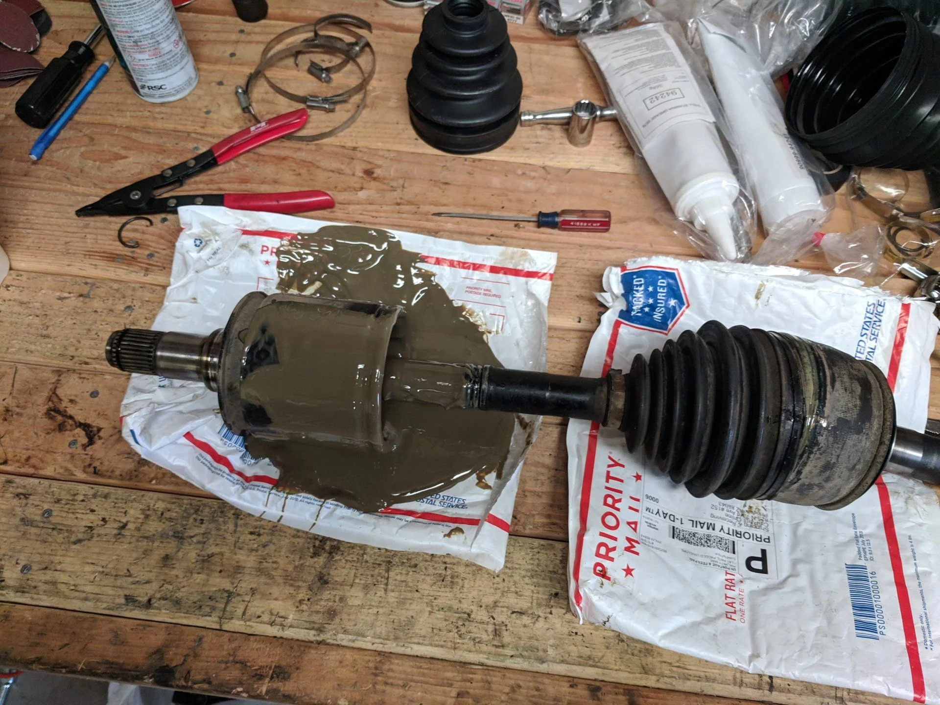

Re-clamped my CV axles with Pfran clamps. They were starting to leak a little bit from the new lift angle. No signs of leaking after about 20 miles. I have new boots and I'll put those on when I have a little more time.

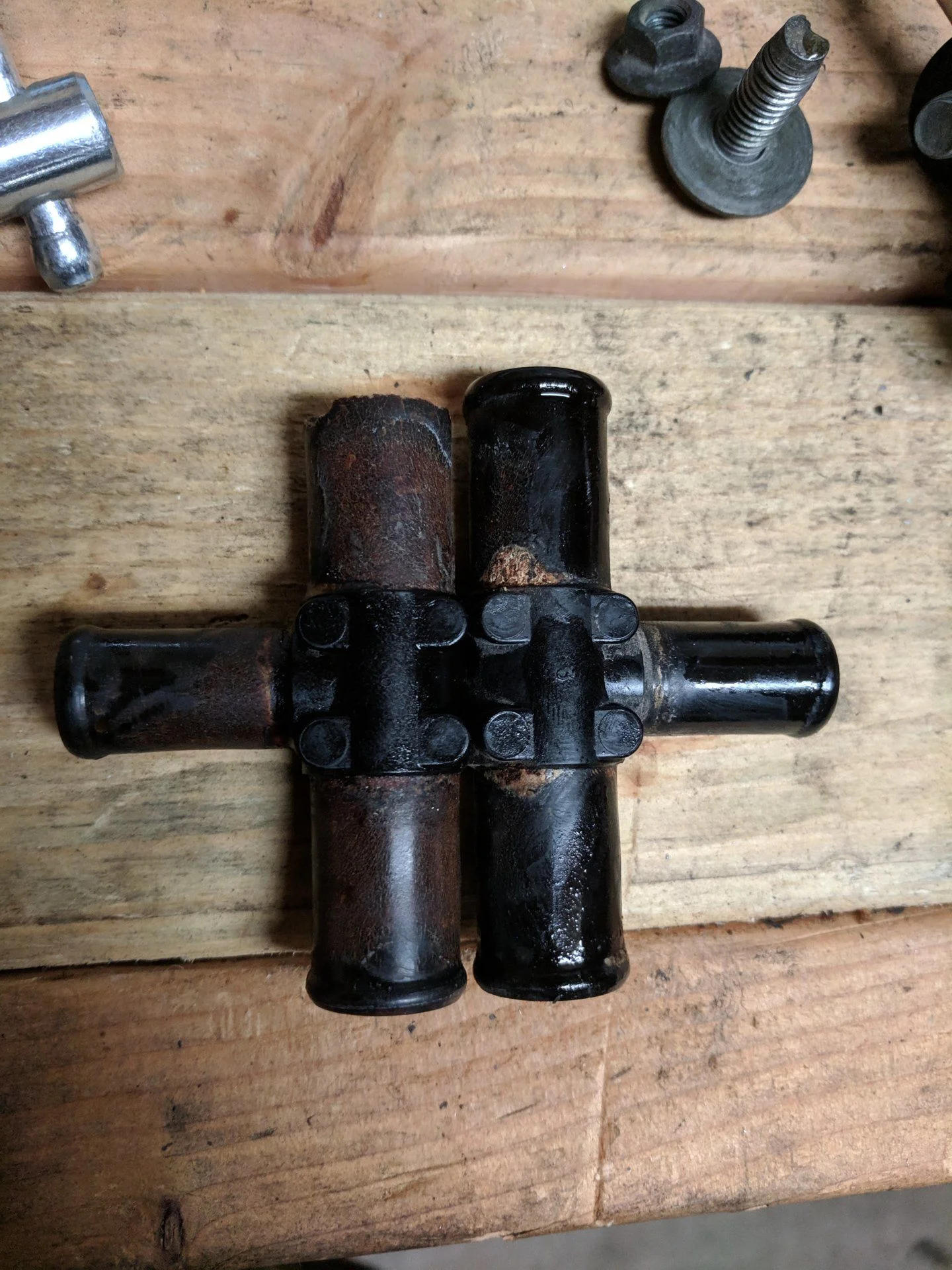

Also took about 30 mins to replace my heater T's with the four seasons metal ones. It was definitely time to replace them.

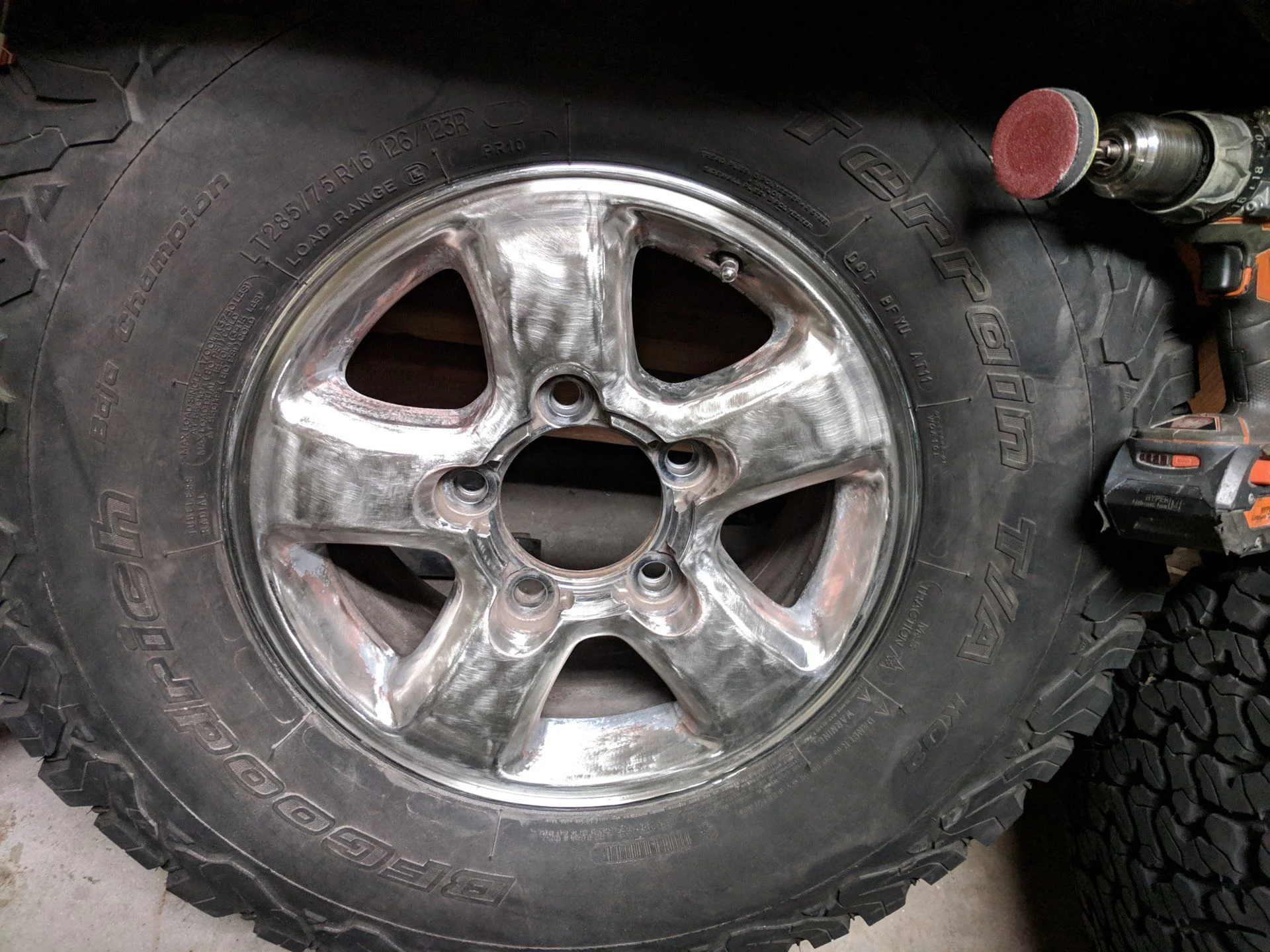

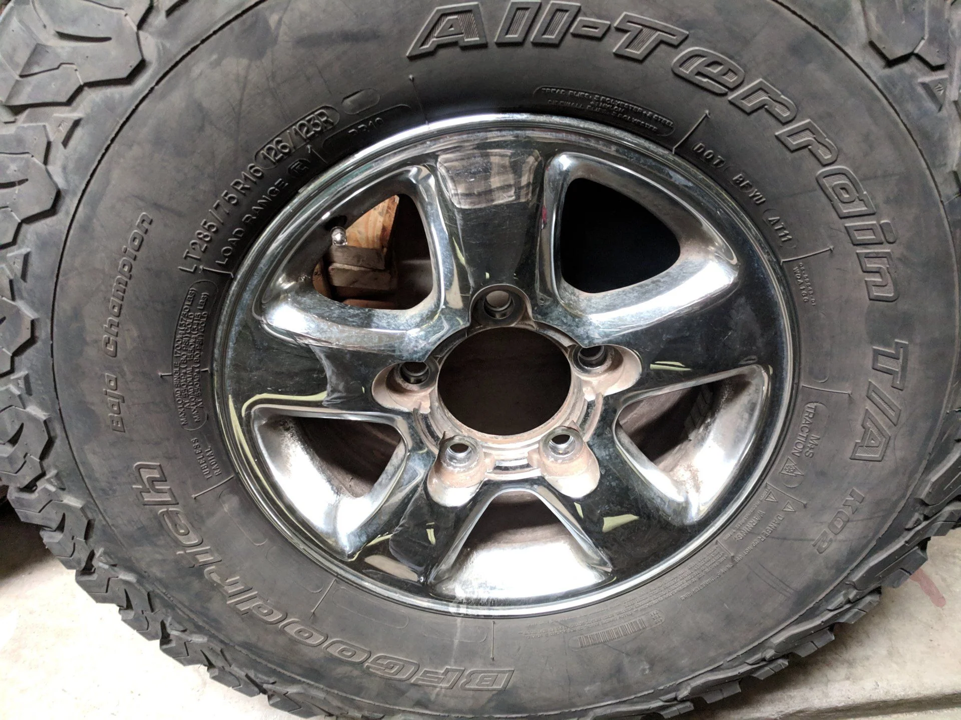

My current project is prepping and painting some chrome 16" wheels. I understand it to be a sin to repaint the stock silver ones, so the chrome ones are going under the knife (sand paper rather)!
Before/After/paint will probably come later this week.
The previous owner had the steering rack replaced about 10k miles ago, but the bushings are not in great shape. Replaced those with the Whiteline bushing kit. I used methods in this thread: Replace steering rack bushings question. Using a bolt, nut, and larger washers to press the new bushings in was extremely helpful. I'm not sure I could have done the job without that. The old bushings came out super easy (not good), but it was fairly difficult to press the new bushings in, but it is done now!
Got the wheels painted, didn't turn out quite how I wanted but they look good enough for now. I may redo them again in the future. Will be installing and getting an alignment in the next couple days.

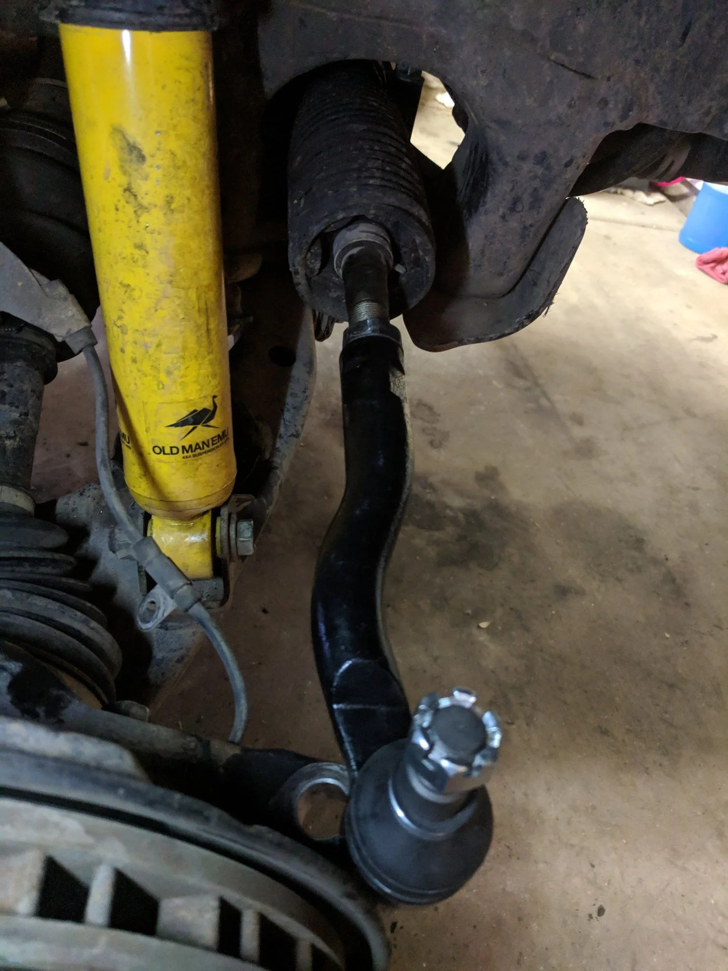

After 3 days of working on this thing, it's almost done! New upper and lower ball joints, tie end rods, and rebooted CV axles (almost finished). Also replaced a caliper, brake line, and flushed the brake fluid due to some pulling after replacing the brake pads. It didn't fix anything, so I'm going to get an alignment and see where it stands after that.

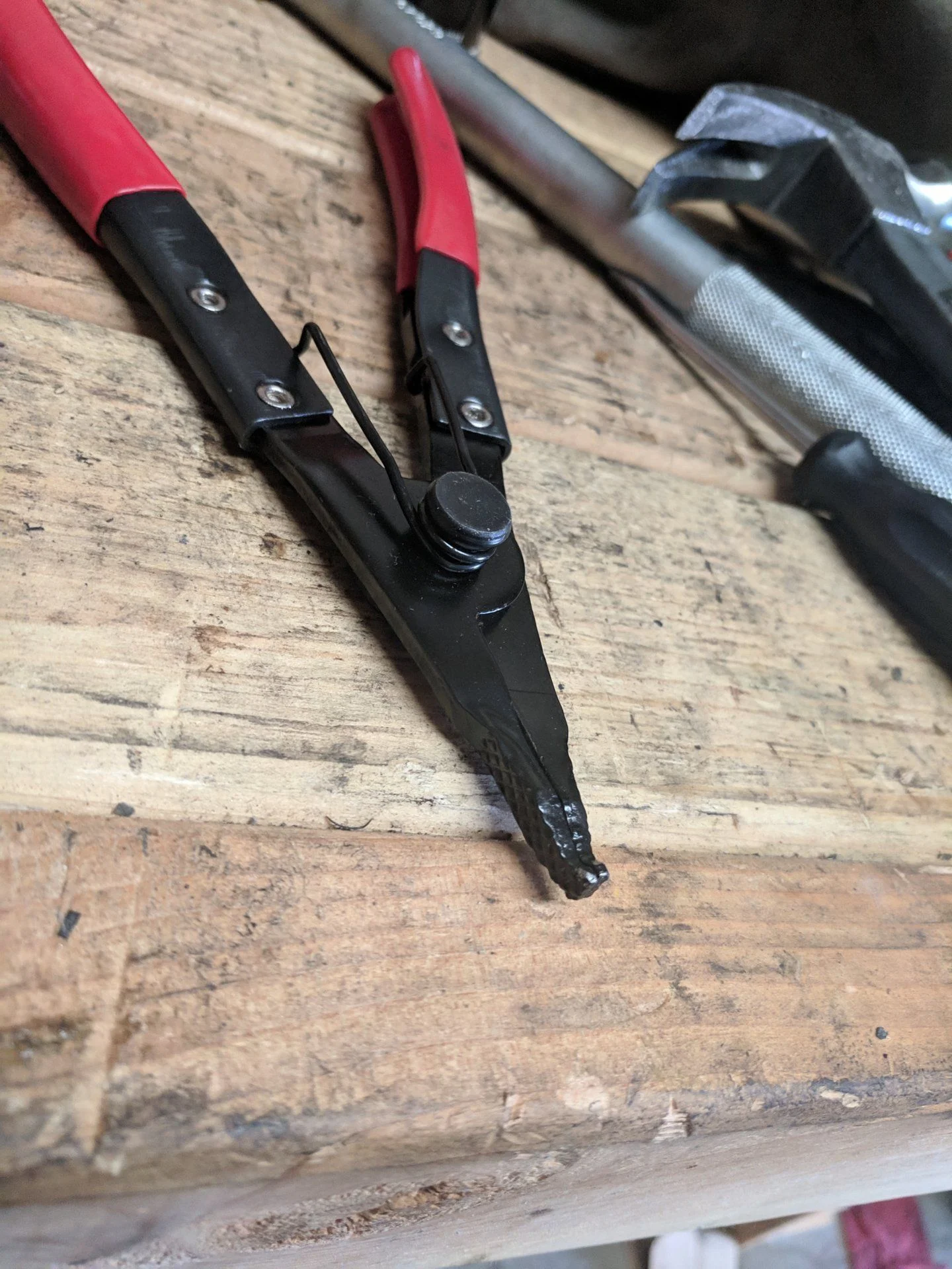

These pliers (bought at O'riley's for ~$12) were very helpful for all of the snap rings.

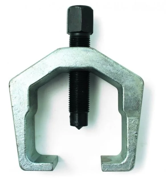

Large Pitman Arm Puller (rented from Orileys) used for releasing UCAs and TREs.

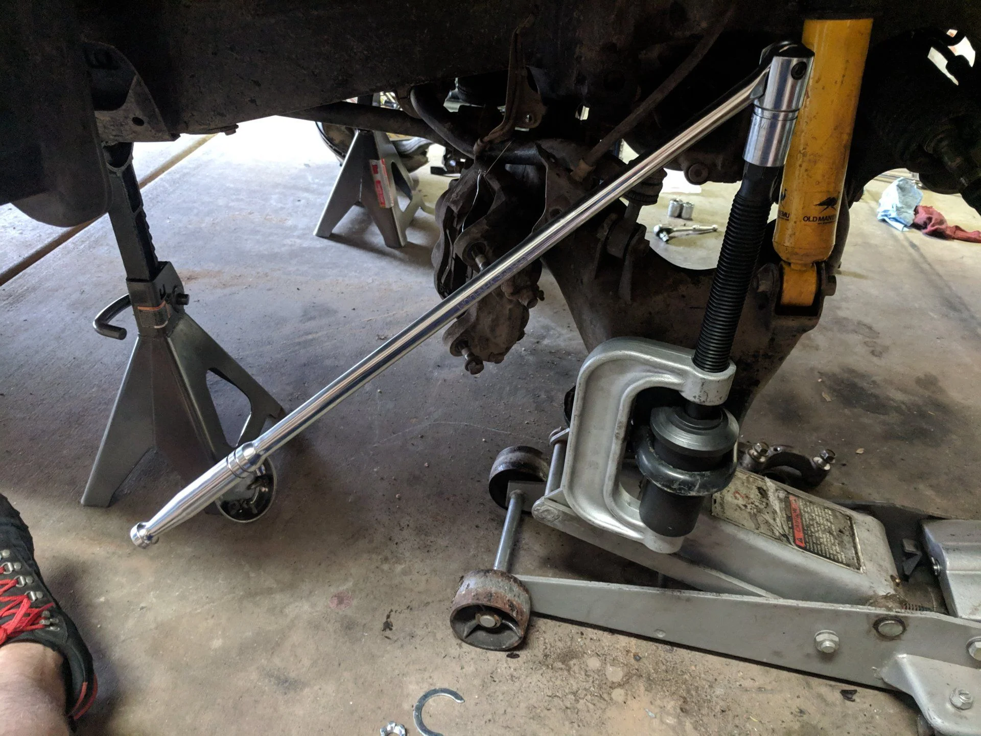

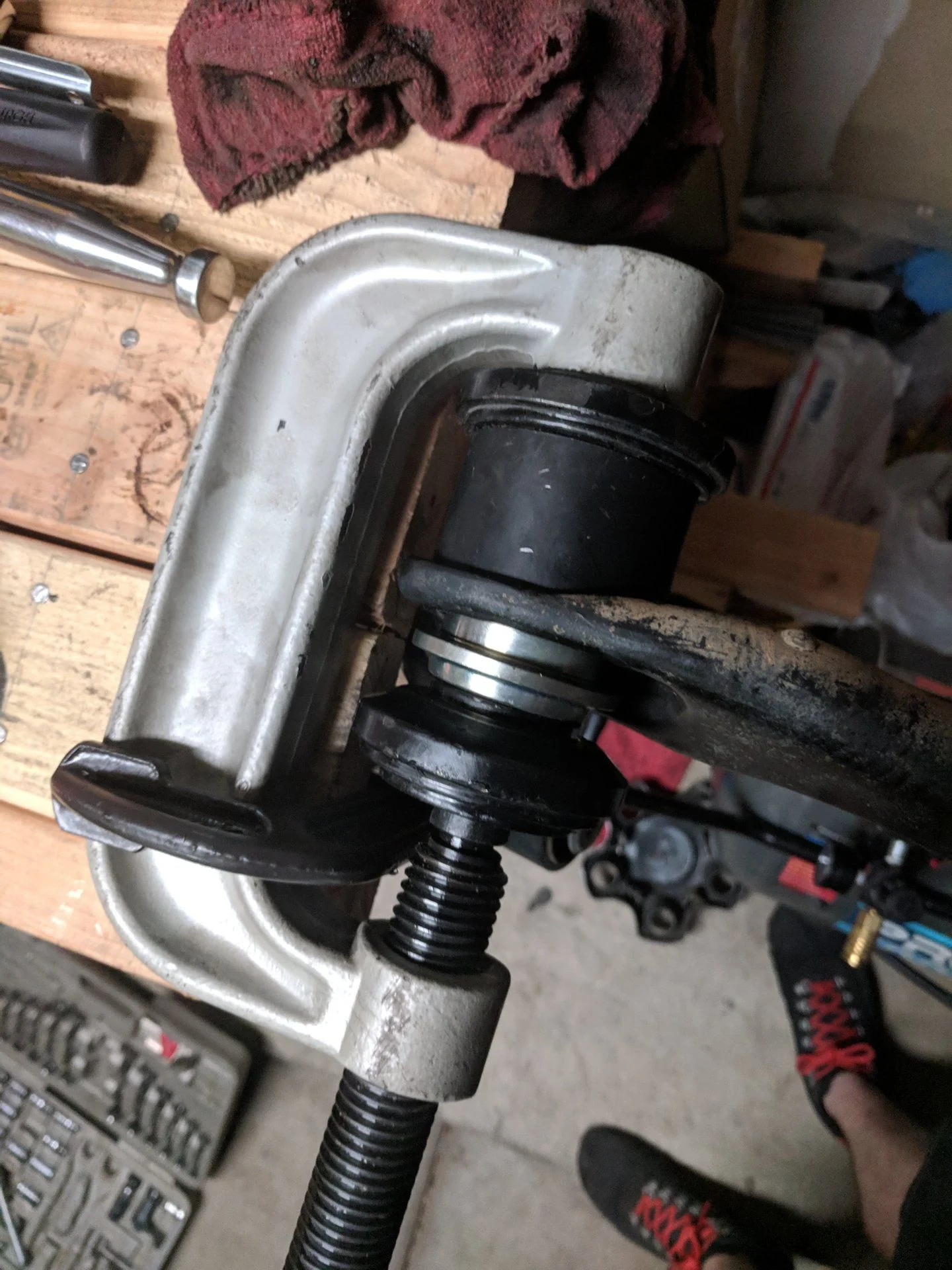

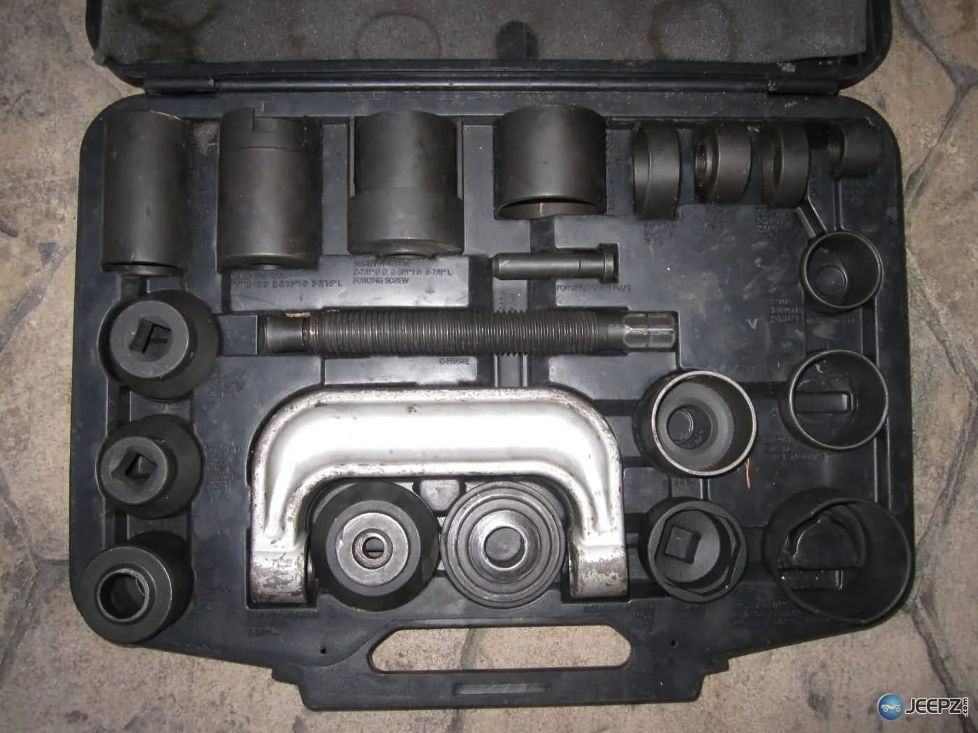

Pressing out the UCA ball joints was wild how much pressure was required. I ended up clamping the clamp style press onto my bench to allow me to use a big breaker bar on it. A vise would have been nice at this point. Note the press clamp kit from Autozone is much more complete than the Oriley's kit. I was also able to use some of these ring adapters to help properly seat my differential seals to the proper depth.

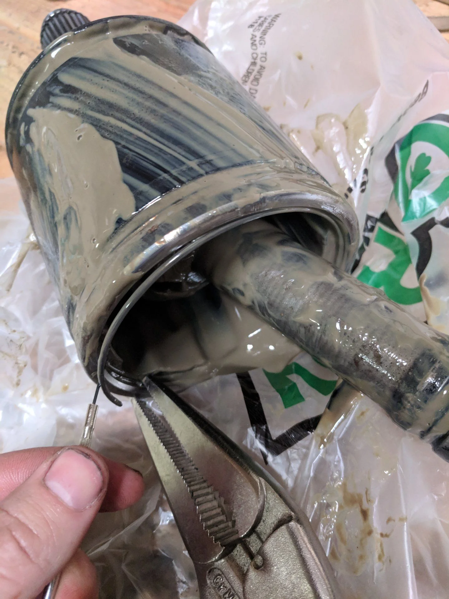

Removing the inner snap ring of the CV axle. I lightly clamped one end with a vise grip and then used a micro-screwdriver to carefully pry the other side loose. Don't forget to put these back in!

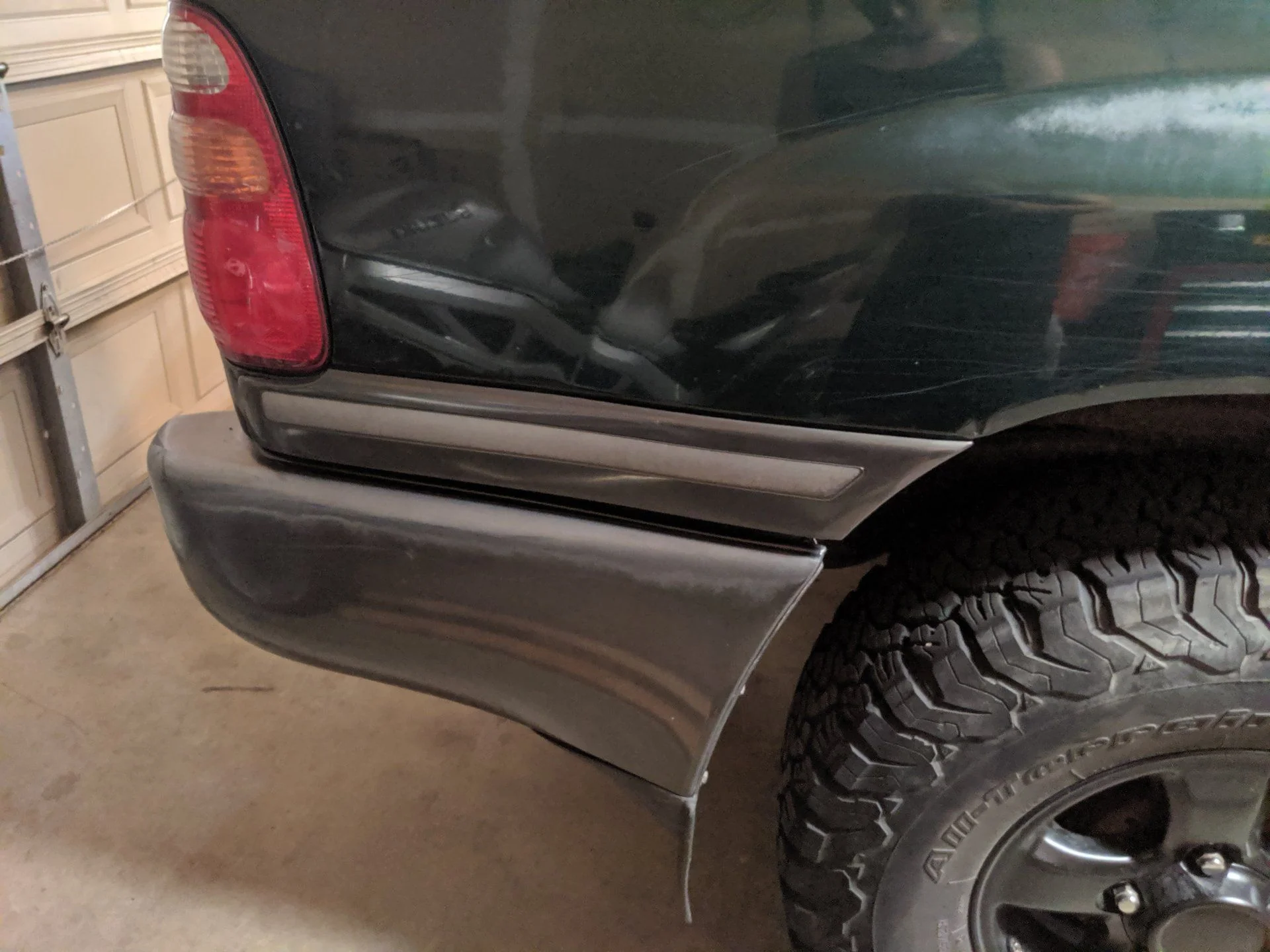

Finally got my body side molding installed that has been missing since purchased. I was waiting a long time to get the proper clips to do the install "properly." I finally said screw it and I just stuck both sides (recently tore the other side off in a car wash) on there with the 3M body molding tape. That worked great. Definitely more solid than with the clips.
