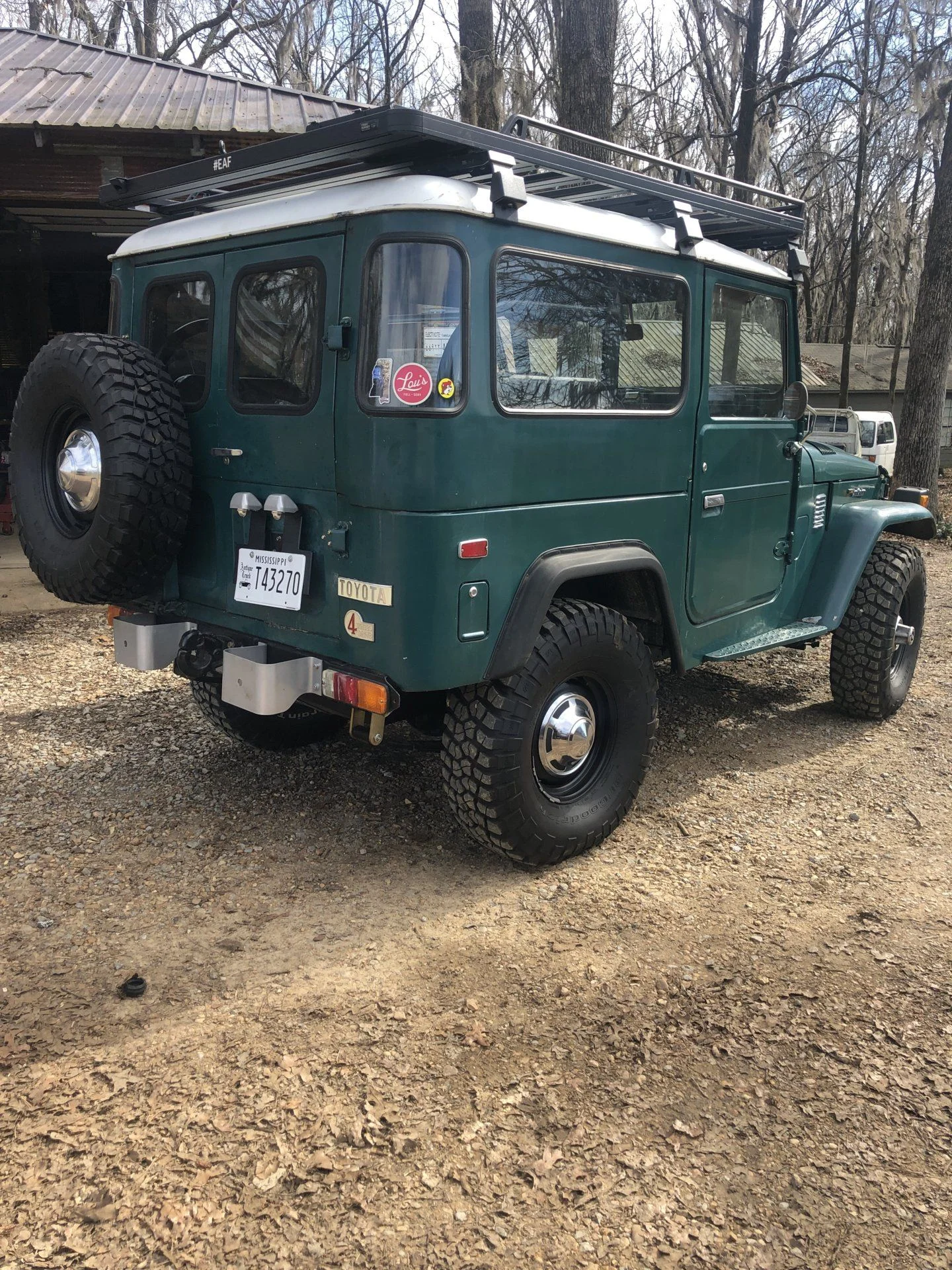

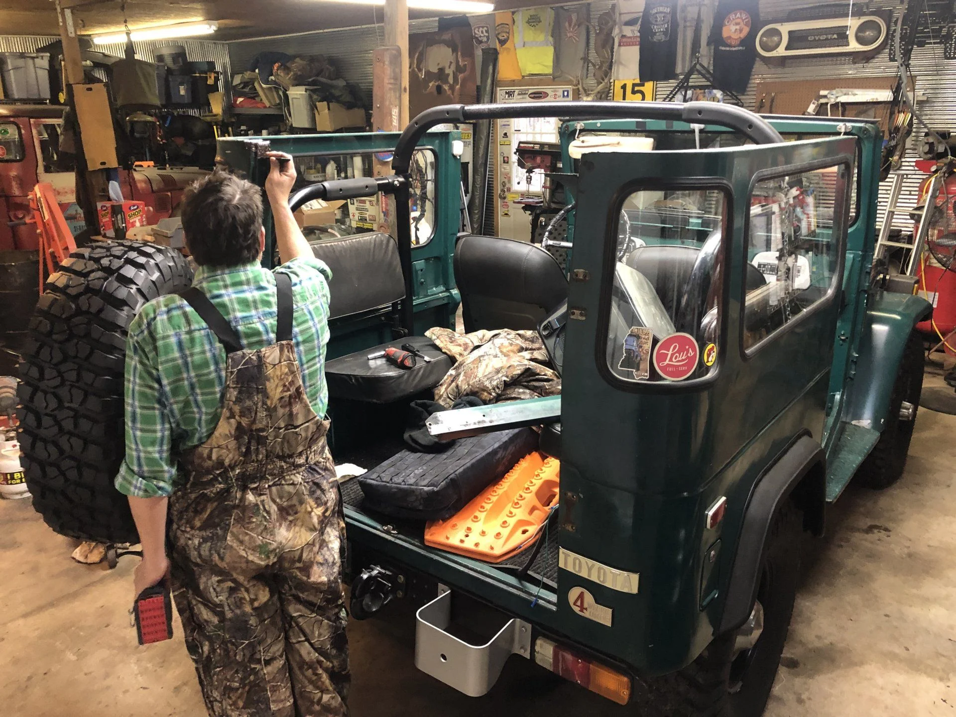

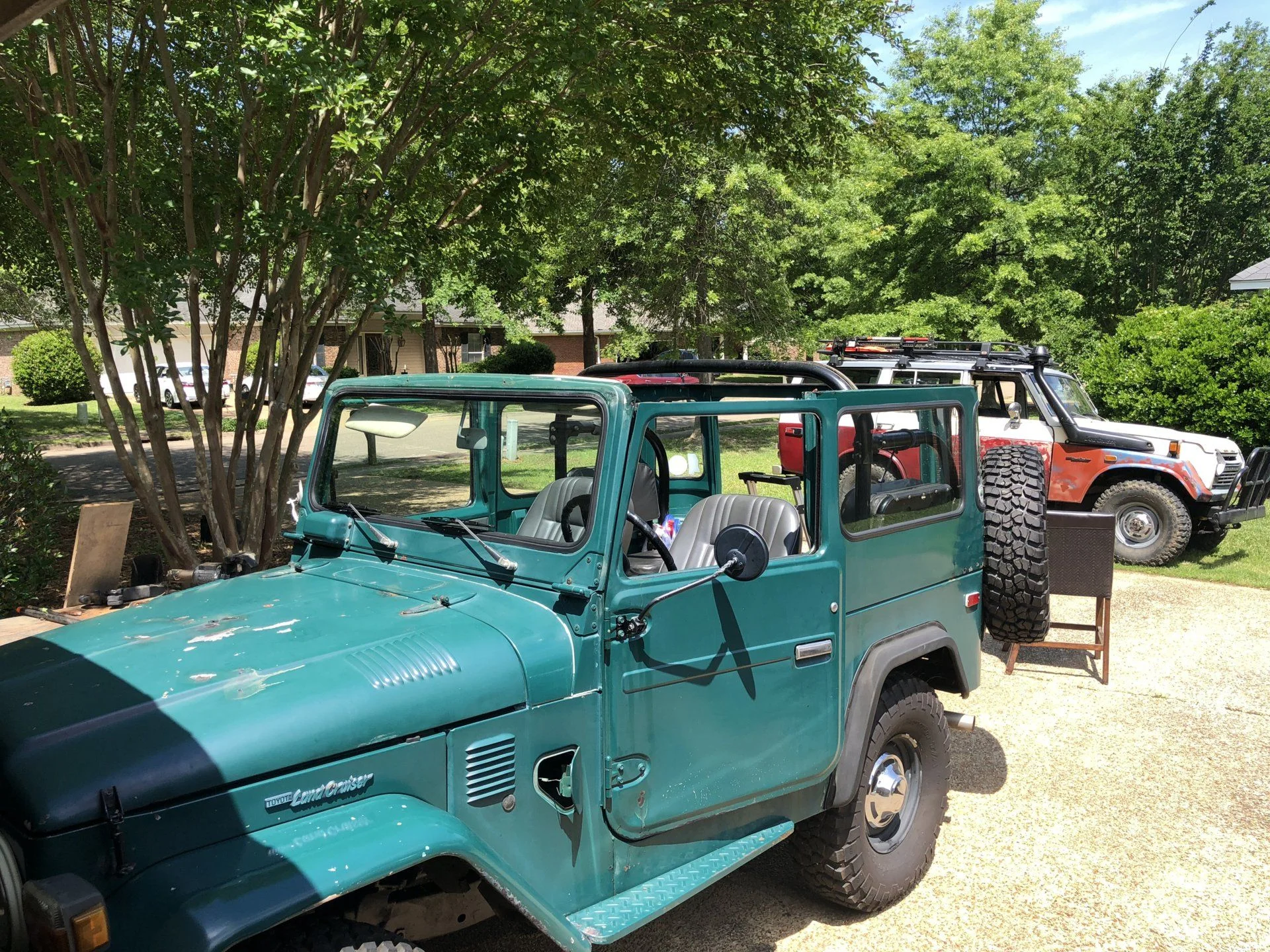

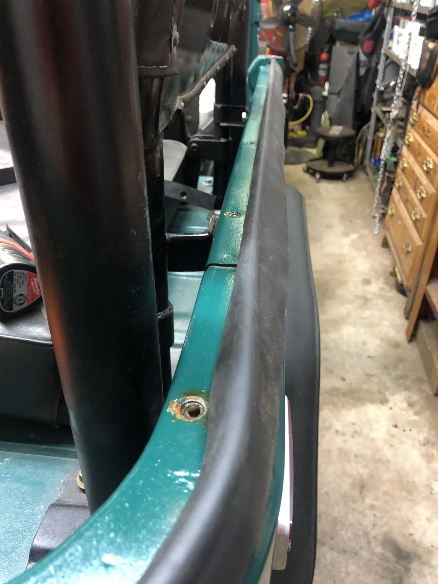

Got the hard top back on with all new rubber and bolts. Fit like a glove.

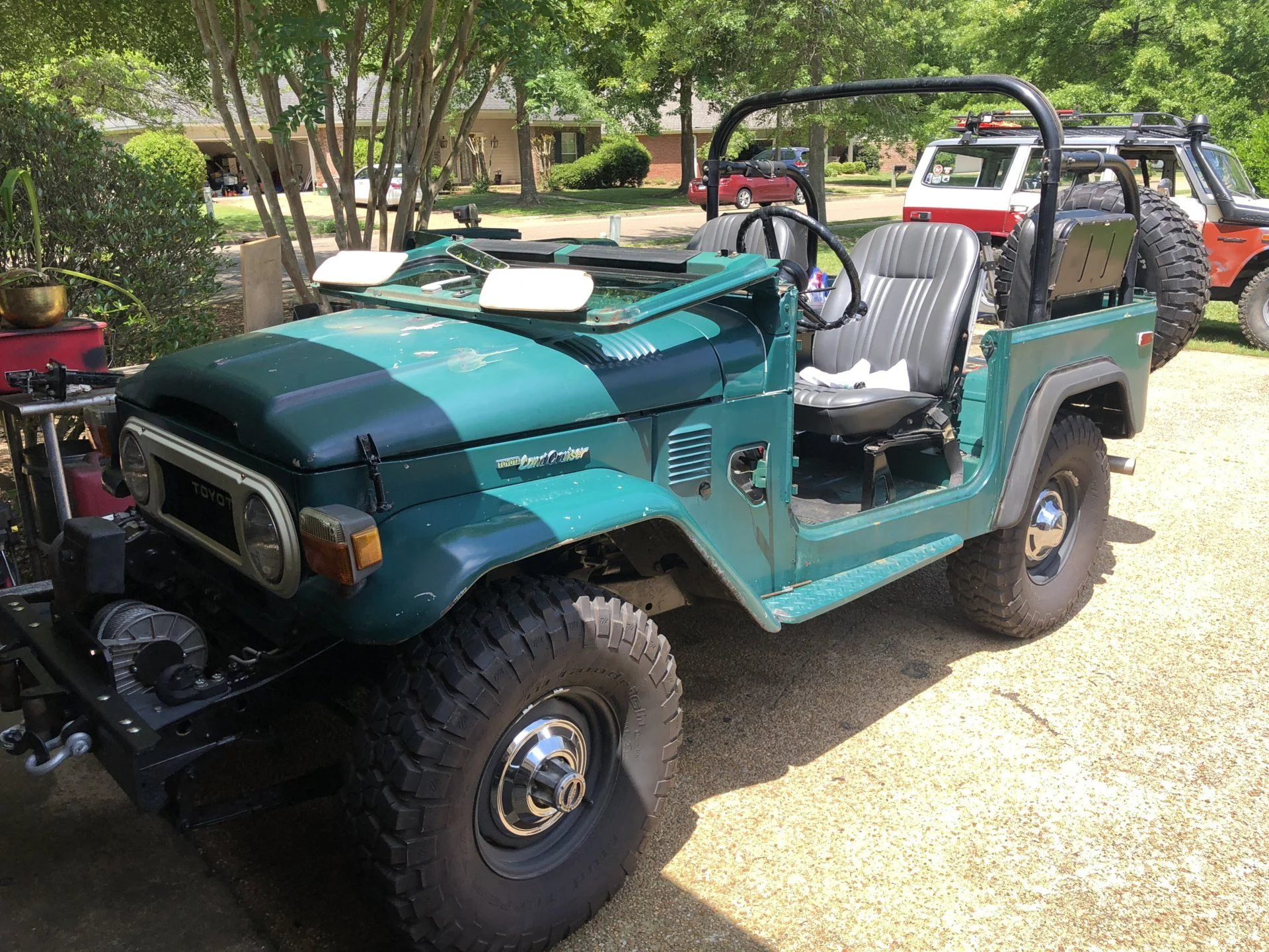

Lou was dressed to kill for the ride up

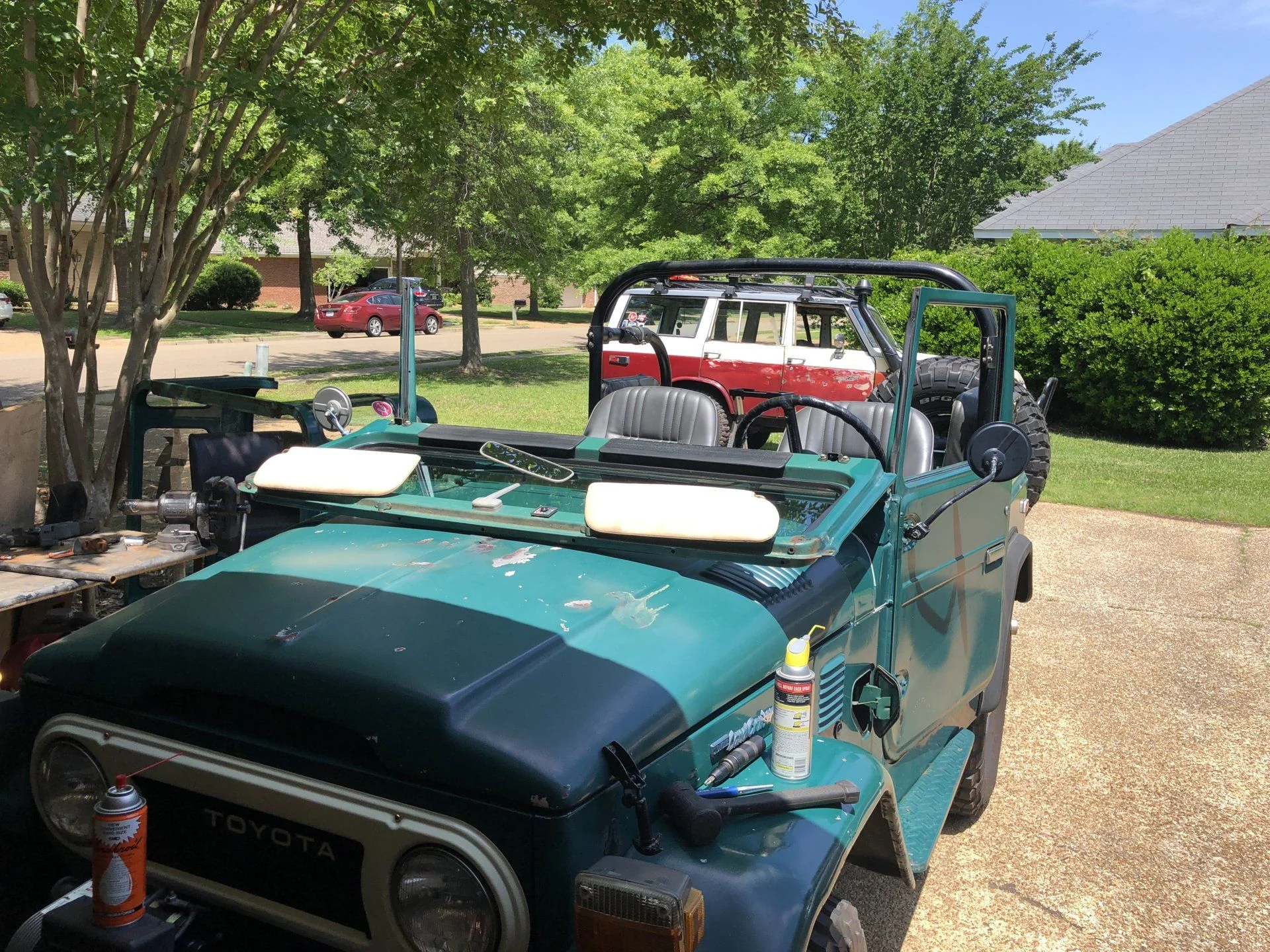

Lou ran up this am on a rare day off for him.

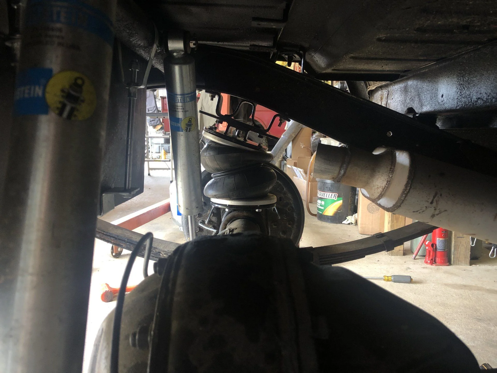

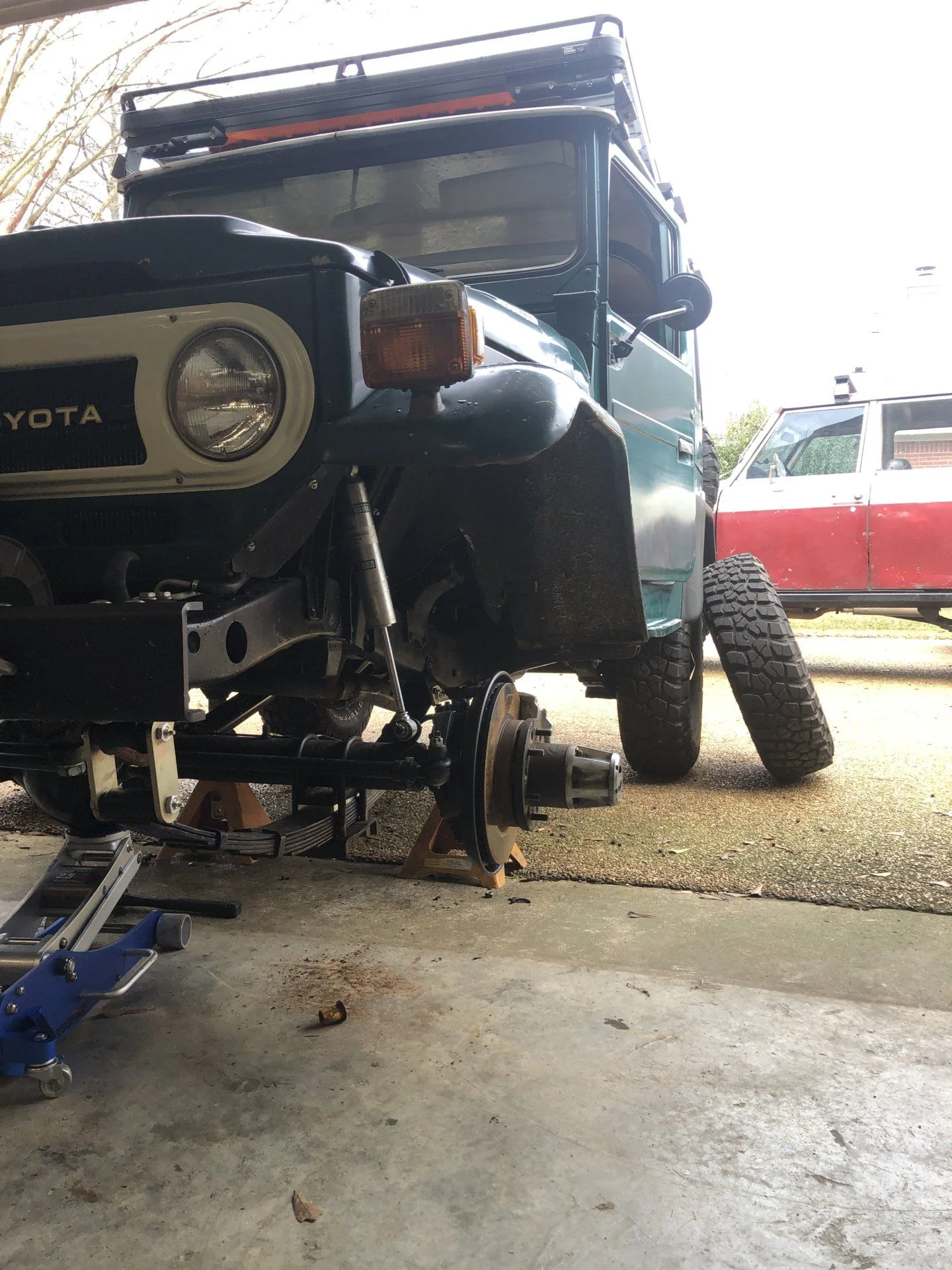

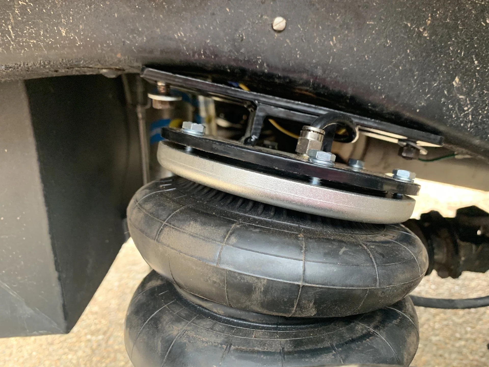

Plan was to install all new bushings and shackles from @Cruiser Corps and a set of Boss air bags
The Goblin has 33’s and stock springs. Lou, as I, like the low slung look of 33’s on stock springs.
Problem is stock springs get tired and flat.
With the hard top and any load they are completely overwhelmed so hence the air bags.

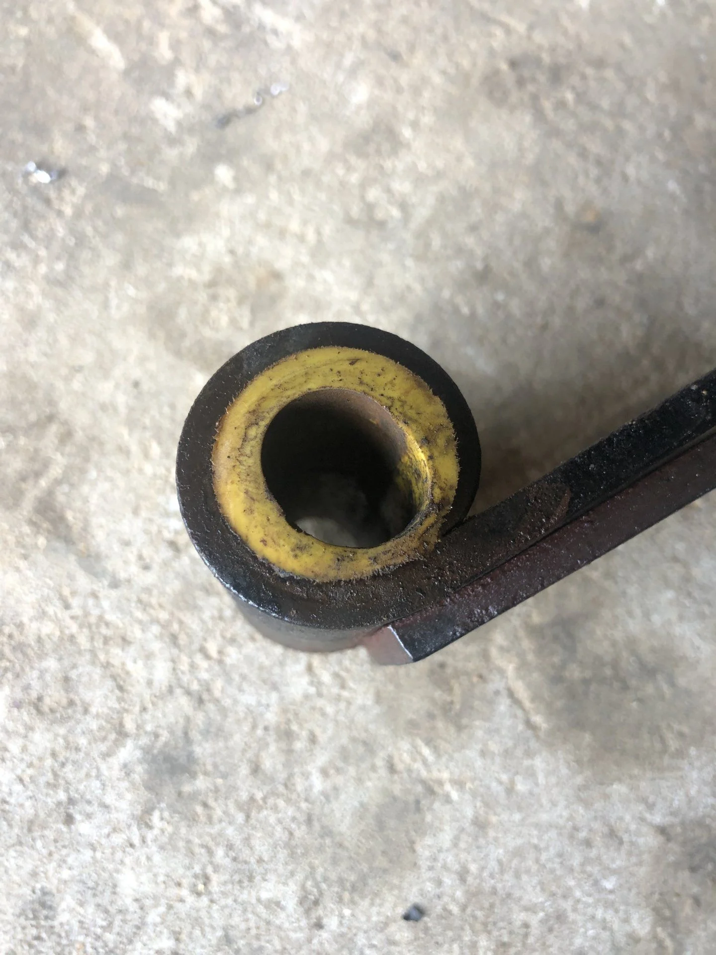

How old spring bushings were gone. It had 1” over stock shackles on 3 of the corners.
Like dummies we did not look at my 40 and see that the bumpstop extension goes away. Once we got it to ride height the truck is sitting on the rubber. Lou fixing that now.
We got the rear buttoned up and realized he just bought one set of bushings so we had to quit but with fresh bushings the ass sits up nicely again.

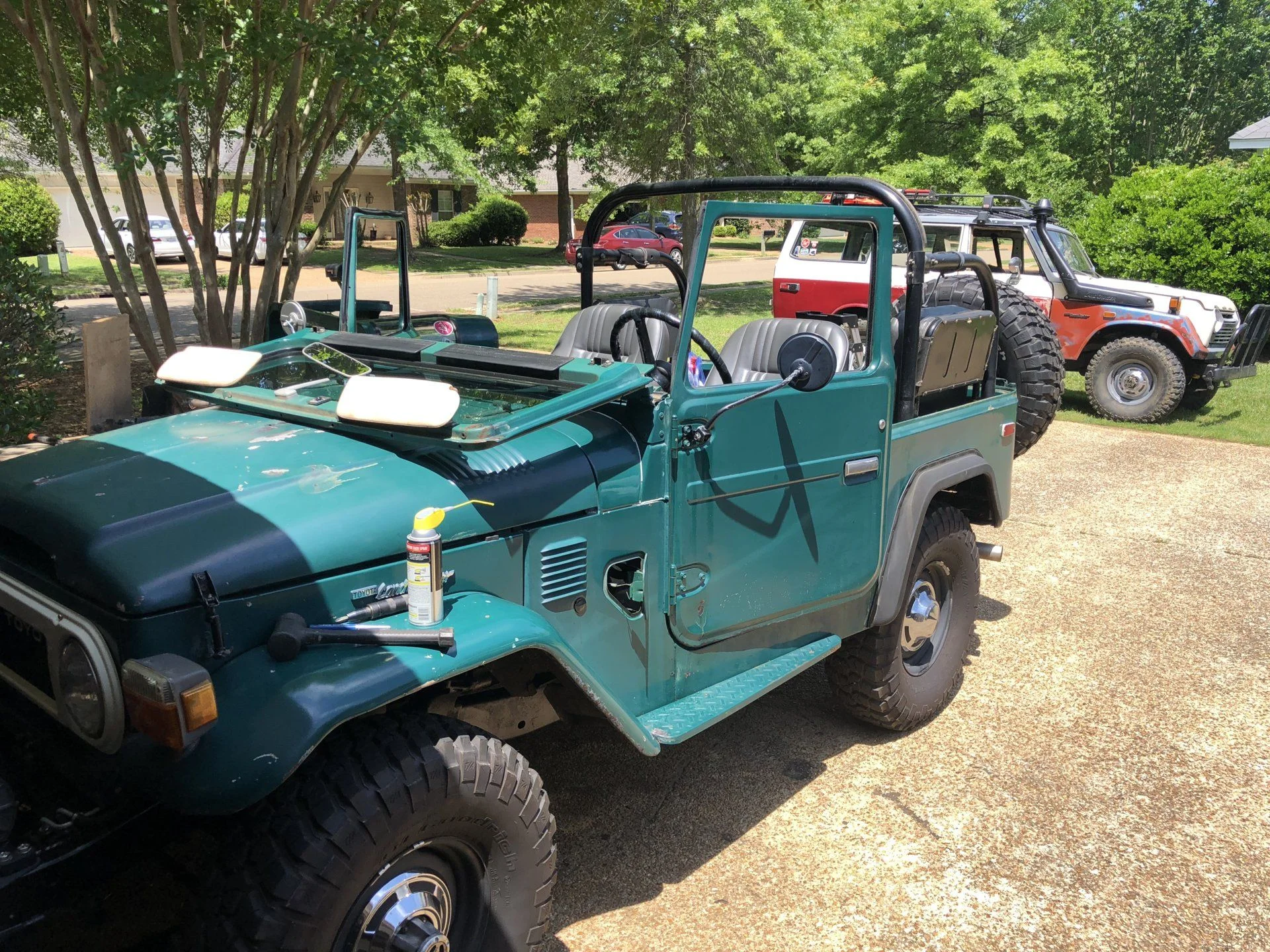

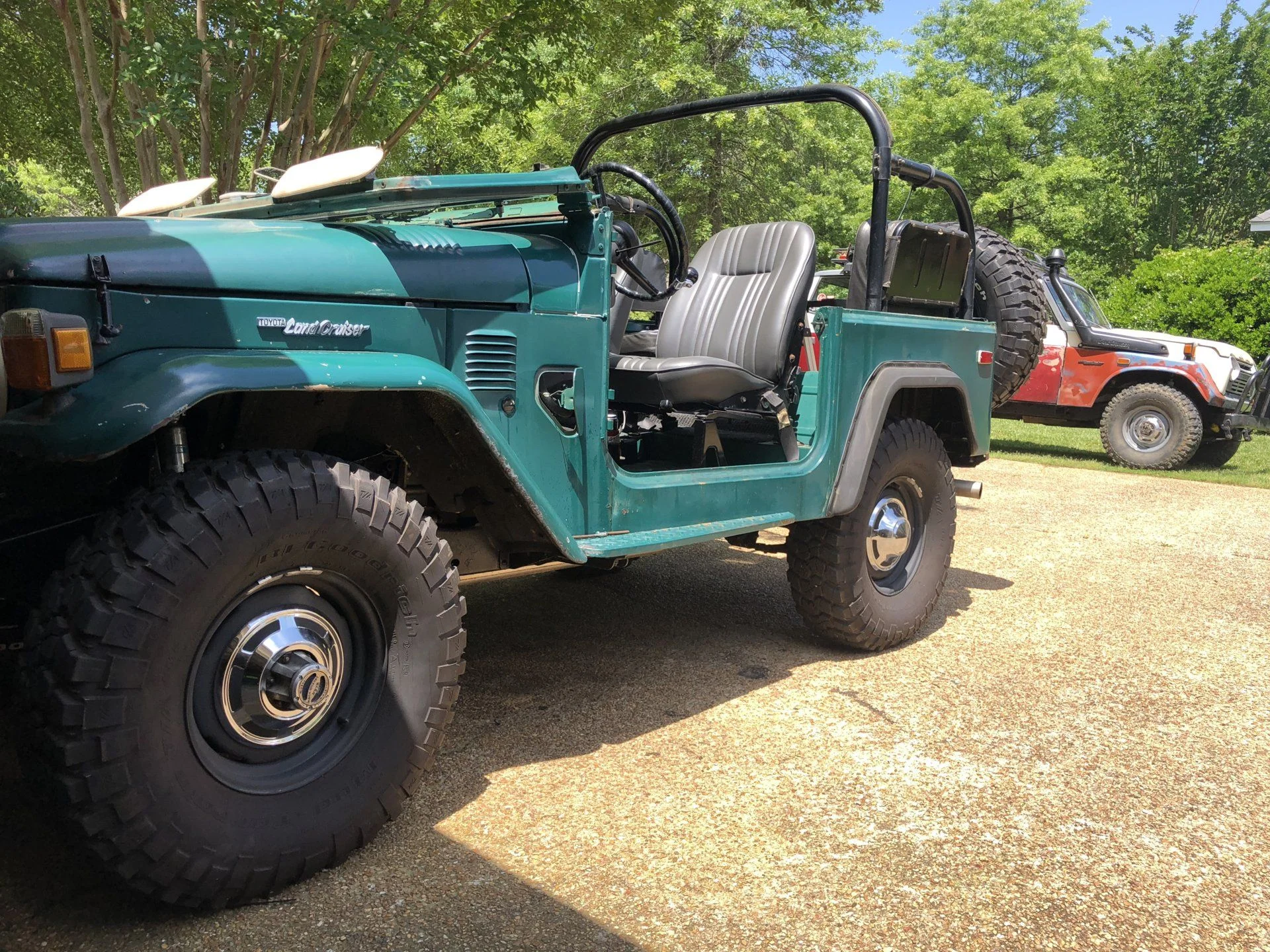

Should have called me. I have bushings coming out of my ears... I could have left some.
Thought the OME leaf bushing might be the same diameter. I must be dreaming.
Nope. 60 bushings are way bigger. @WharfRat is your man for the extras
@Dustin Messina shoot me a text msg and we can discuss the details. I have my big a$$ crescent wrench on the ready.
I’m on good for providing the bushing @wngrog is wisdom for your installation!

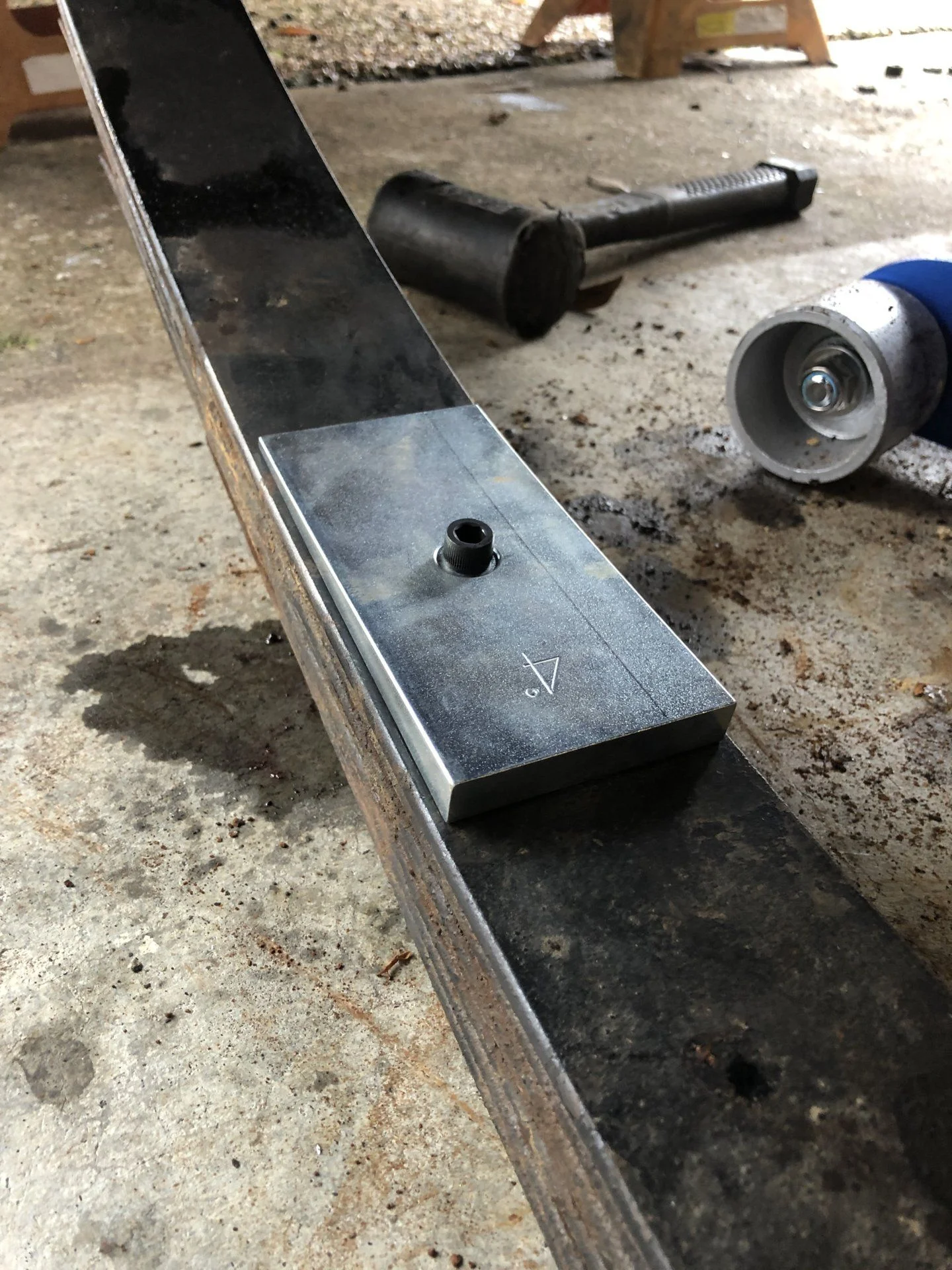

@orangefj45 sent us the parts we needed to finish up Lou’s Shackle and Bushing Swap.
Energy bushings. 4* shims. It should really drive great now.
