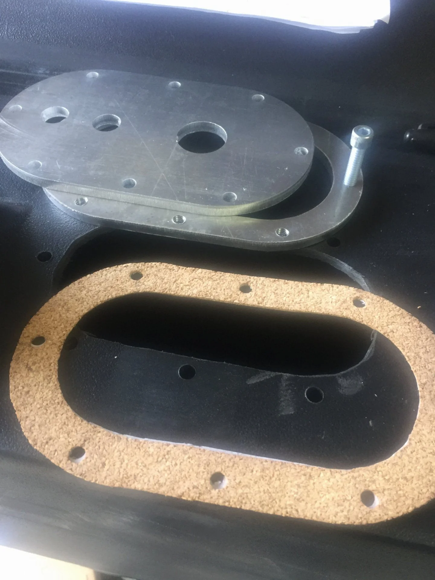

So. I decided to replace the gas tank in the goblin. Multiple reasons. But the main one was the fact that the lining that I paid good money for was flaking up and rust was getting into the fuel lines.
After a little researching and not many options for a relocated tank, I chose to buy a tank from Downey. Ugh.
It was the least expensive option even at $600.
I got it installed with very poor instructions and some cussing.
The [main] difference between this tank and the old one is the feed style. The old con-fer tank had a bung at the bottom for the fuel line.
This new one utilizes a bulkhead at the top of the tank and uses a syphon feed tube from the bottom of the tank.
I "was told" that I "shouldn't have any issues".
Well. The fu cn thing won't feed. I am running a nice performance mechanical fuel pump. And I even went as far as splicing in an electric pump in the previous location to "help" pull the fuel. Maybe it's a pusher. Or whatever style.
Problem is, it not building any pressure or pulling any fuel.
At. All.
Anyone have any suggestions before I set thing ablaze?
#overit

I'm confused as to how this new pump works.
So it creates positive air pressure inside of the tank, and the positive air pressure forces fuel up through a siphon and out of the tank? Is that right?
If so, the only explanation would be that you have an air leak.
No the fuel pump just pulls it up and out.
The fuel pickup was too short. He added a few more gallons to it and it worked fine with mechanical pump only.
So, basically, he was out of gas?
(Sorry, Lou. With you not at you, brother)
Uh. Yes.
Everything he's gotten from that guy has been off in some way.
A pick up that sucks air with 1/4 tank left is lame
