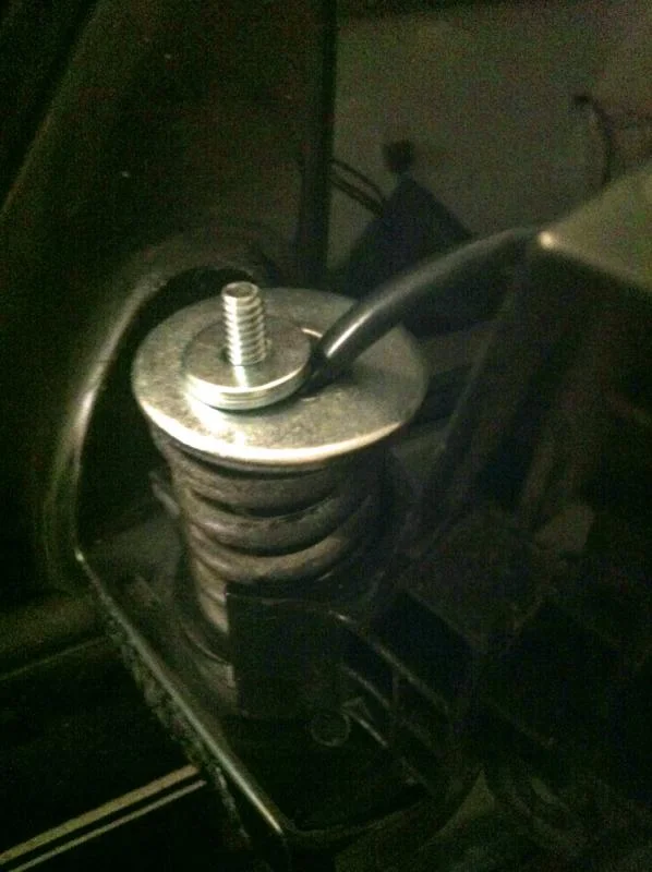

Thanks to all these great posts, even I was able to do this, with a slight variation - Third attempt after 3 hours of :doh:: I used 3 sizes of washers all on 1/4" bolt with the wiring running up thru next to the bolt. This eliminates the need to grind some of the washers for the wire - I screwed that up by grinding a "C" so happened to find the small washers lying around. Works like new, saved a ton of cash. Here's a pic before I put the medium fender washer and locking nut on top.

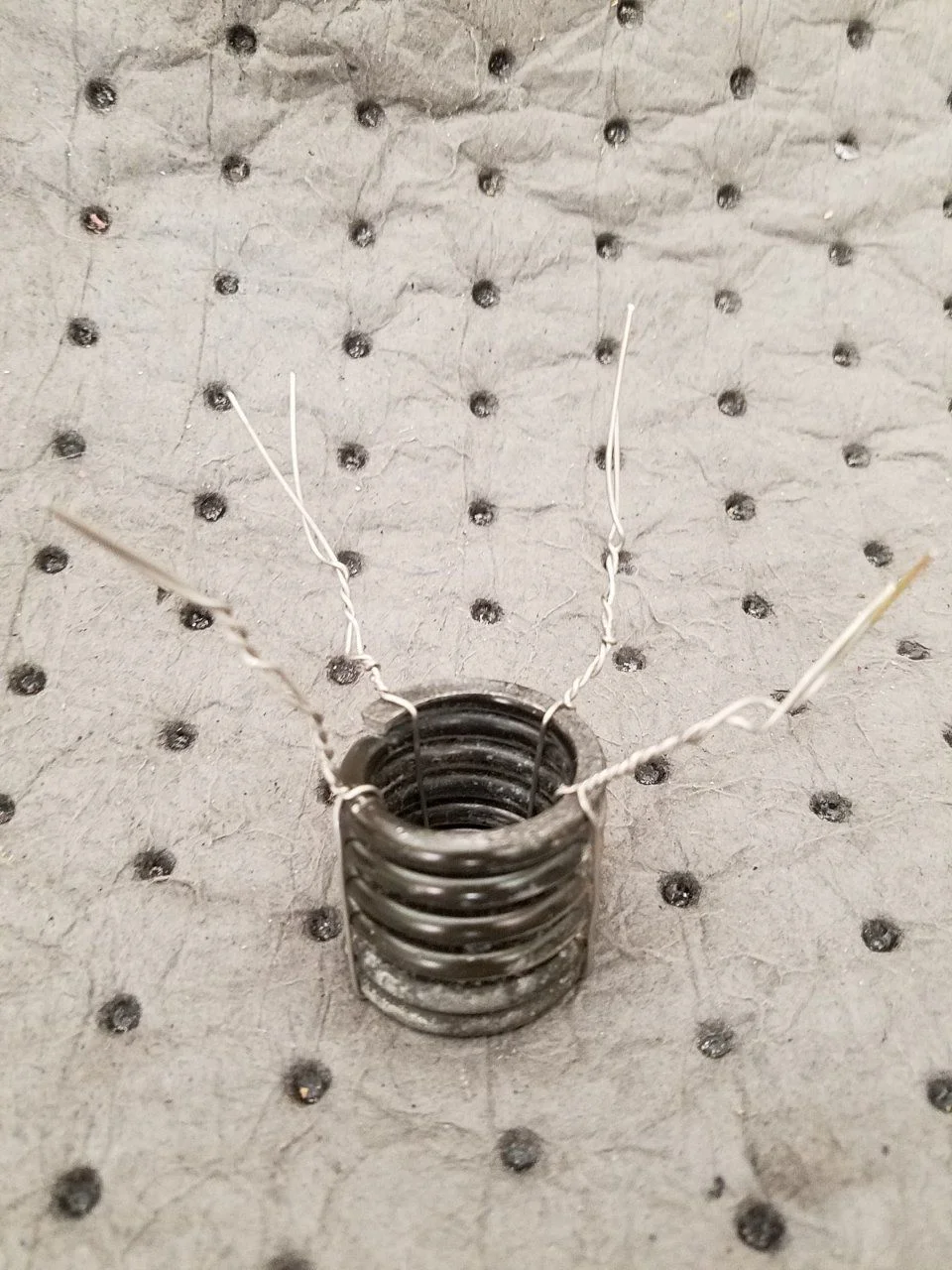

I fixed mine by cutting new slots for the retaining clip as described in post #36. I tried the bench vice and zip-tie method to keep the spring compressed without success, but did have luck with safety wire. I wore a face shield throughout the process - that spring is strong.
