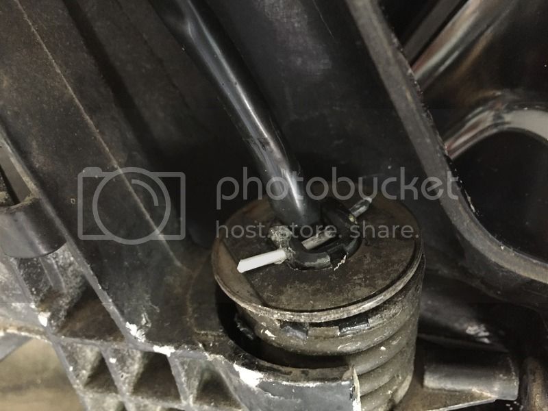

Hey Fellas,
Noob her but old timer DIYer :-)
So I wanted to post my ghetto fix for loose/broken mirrors for the LC and LX.
While taking the mirror apart to replace it, I found the notch that holds the retainer and lock had sheered off :-(
Brain fart, drill a 3.25 MM hole and use a piece of hanger wire sharpened at one end to slip thru the hole.
Voila! Fixed :-)
P.S. I know I know post a pic, but she is brutally dirty, I am ashamed, will post after fixen and washing :-P
Yeah, you are seeing correctly, those are zip ties, 4 to be exact to help compress the spring, will eventually wear out and drop out :-)

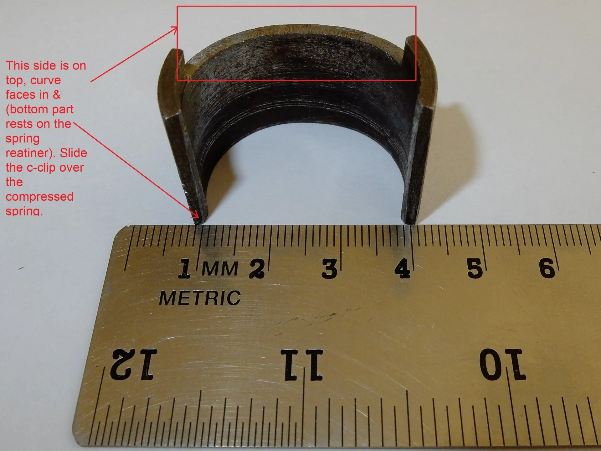

Or, you can make two new slits for the C-clip (lock) at 90 degree to the original sheared slits and at the same level, using a dremmel cutting wheel and a small flat file (careful not to go in too deep), insert the spring & retainer, compress the spring, slip the c-clip into the new slits and that should do it. While at and before doing the fix, remove the 3 small steel balls below the spring, clean everything good & grease well both the bottom & upper spring retainer plates. I think the main cause of this failing (notch sheared) is lack of lubrication. I'll try to post a few pics when I take my mirror apart. Here is a pic of the special tool I made for compressing the spring, used two small pieces of wood and a screw-type wood clamp to compress the spring. Mine has been holding on now for about 3 years.
