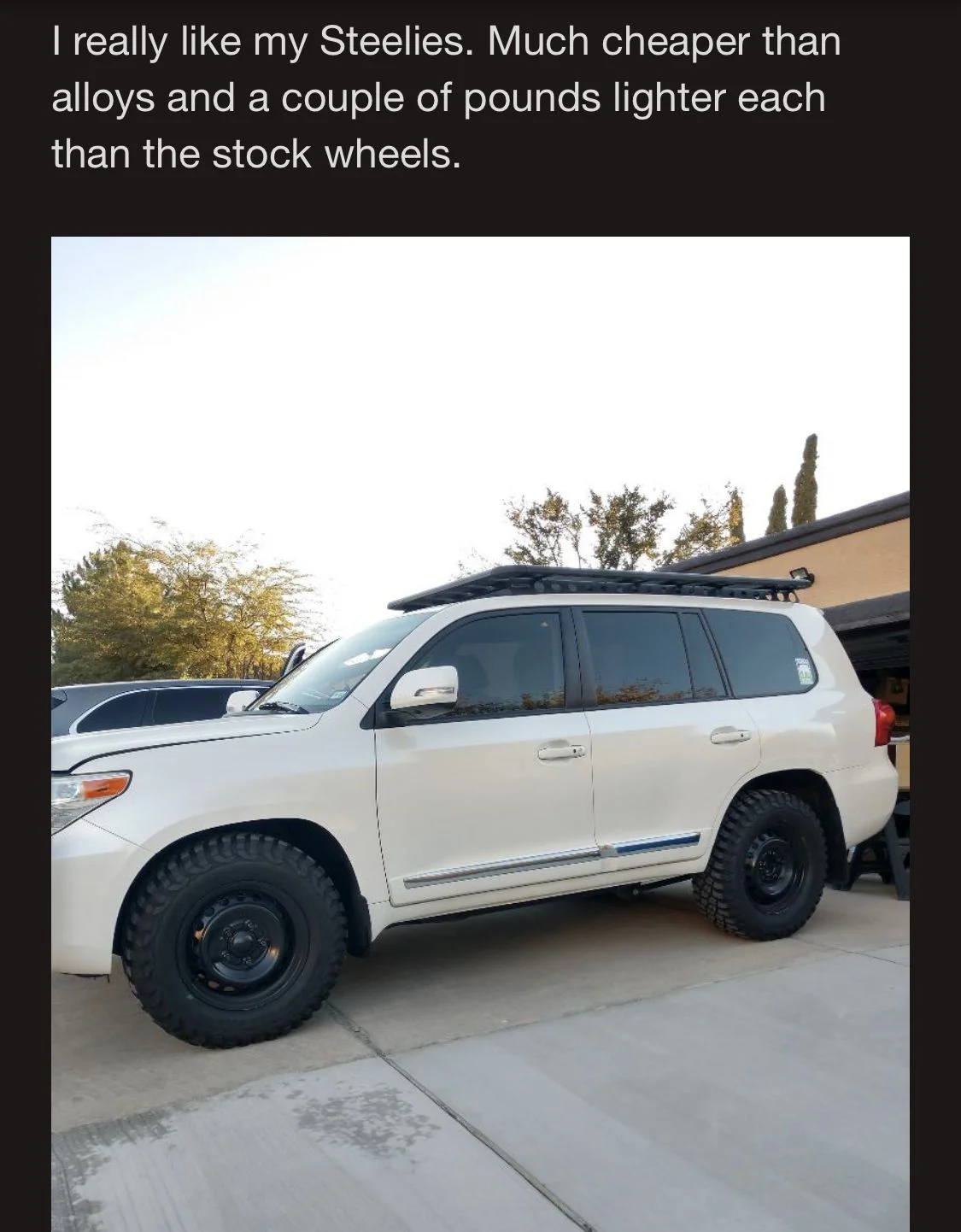

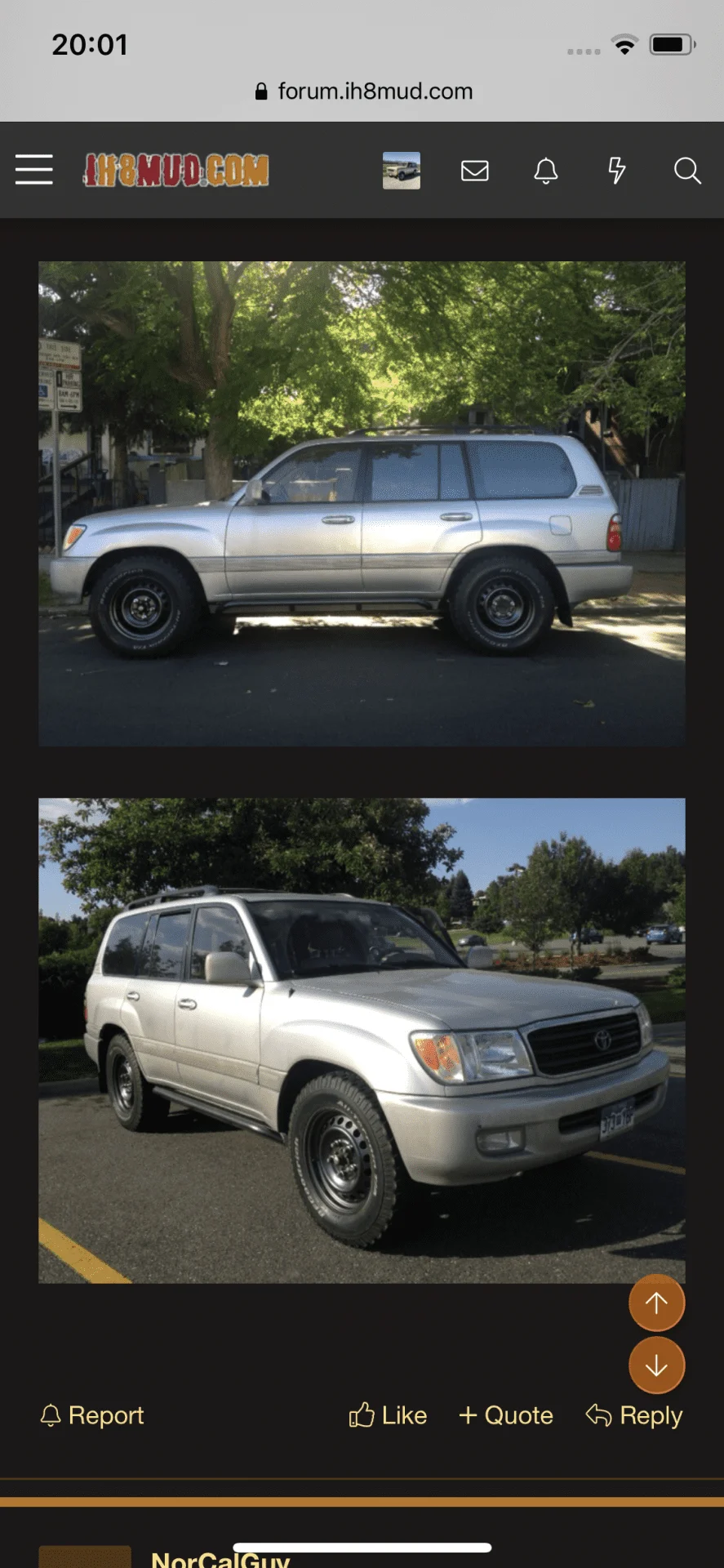

Hi all, new here and love the tremendous amount of enthusiasm and information. I just bought my first LC, a 2010 and first on my list is to change the wheels. I’ve seen a few pictures of other Land Cruisers with black Tundra (I think..?) steelies that I really like. I know this subject has been discussed before but I can’t seem to find the information. Does anyone know where to get those? I hope to add a couple pictures for reference of exactly what I’m looking for (the white 200 series looks especially good, I realize 3rd pic are 6 lug and I need 5 of course). Any information or advice would be greatly appreciated!

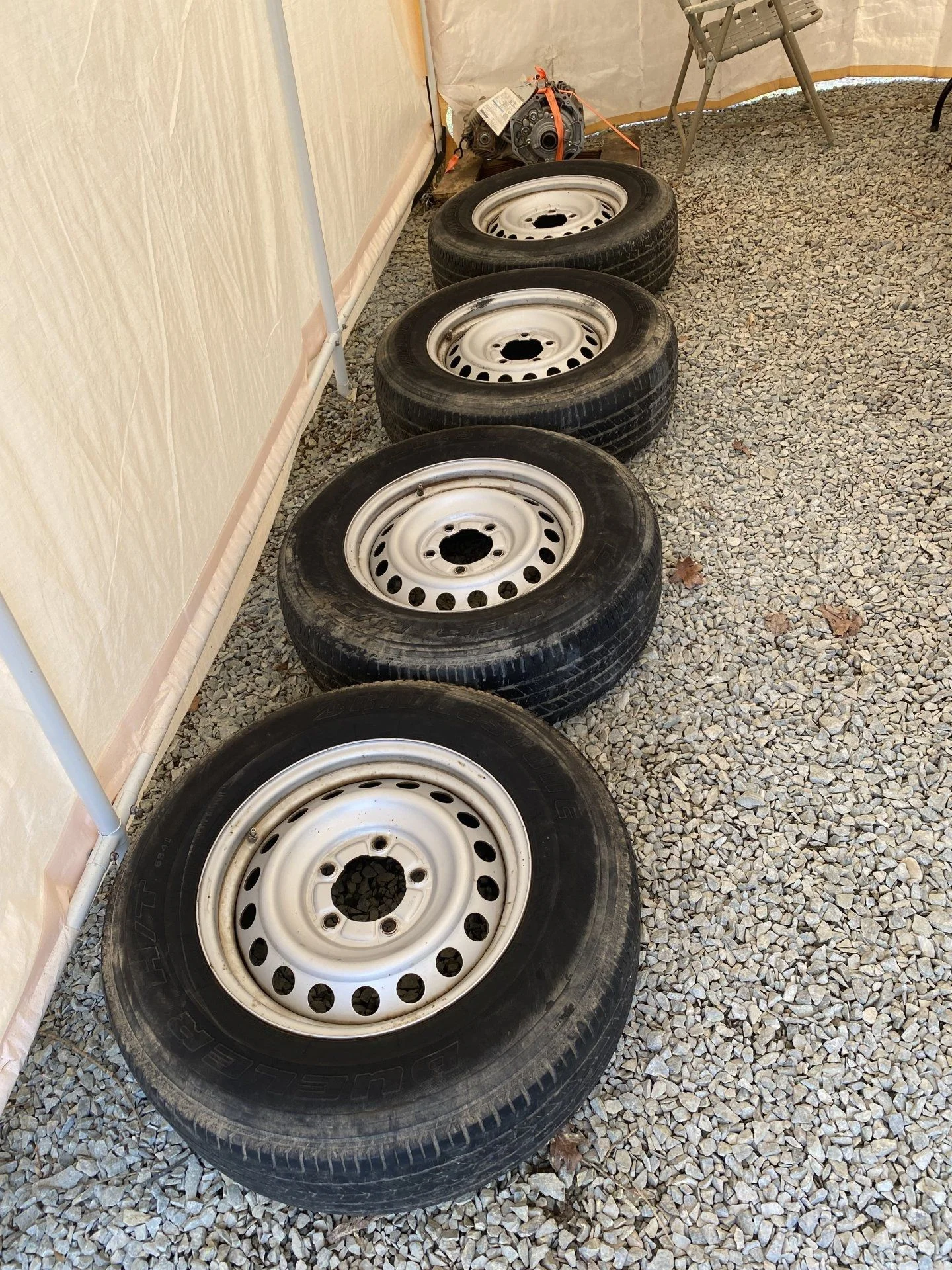

Good deal. I found some I’m just trying to find tires that will fit good. With the off set.

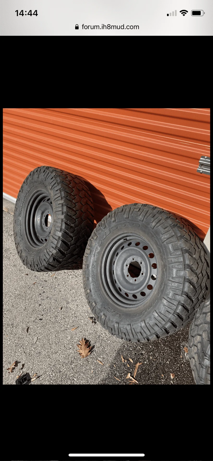

I believe @FlightMedic178 and @mep1811 are running the Tundra steelies. Maybe they can chime in, but should be same tires that work for stock 200 rims, and same issues.
From the reading, I'm doing both of them are running 275/70/18. Now I just gotta do more reading and see what's the biggest I can run safely without a ton of mods haha

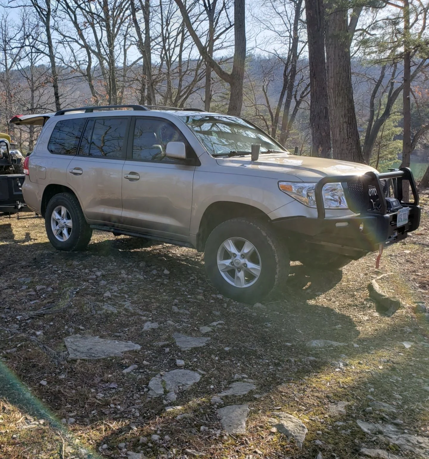

You'll regret it... this is what 275s look like. I'm sharing a picture since bumper are similar and lift. A couple people have done the 285 without much issue. I believe you will need spacers though.
