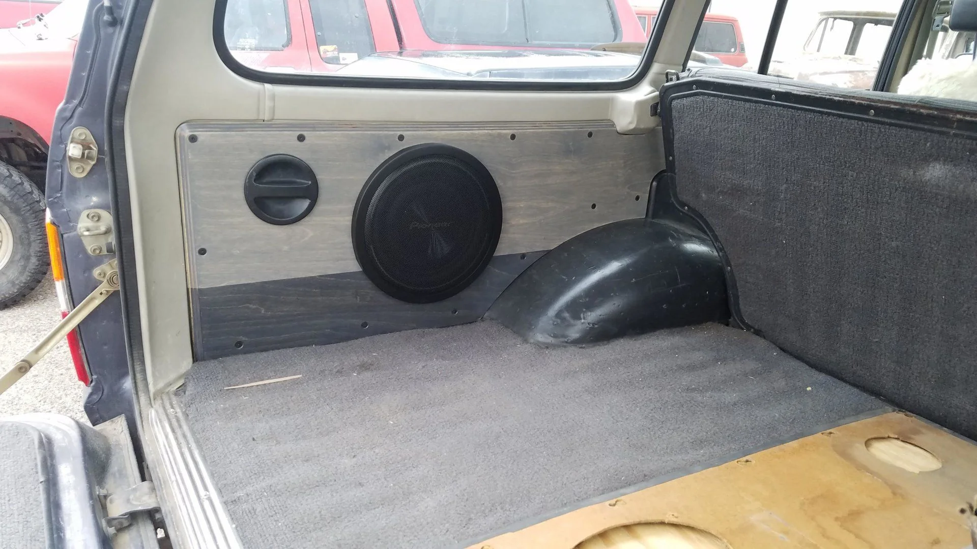

I went with this sub. It's mounted under the driver's seat and I love it. I have an amp under the passenger seat as well. I went with Alpine speakers in the front door and cargo panels
Amazon product ASIN B00OYGGMXK
As far as cargo panels, they're actually not too difficult to build yourself. Can easily be done in two days. I made mine out of MDF, water proofed them and covered with foam and vinyl fabric.
The best way to do the rear panel would be to build a new panel from 1/8”-1/4” hardboard card stock or similar.. and delete the speaker. ESP if running sub
Component choice really is an art .. unless you just want some sound. If you’re picky.. it’s all about power in the car audio environment. Front speakers choices are way more important than sub, stock door panels need mass loader for anything more than a blah speaker. Installation and tuning is critical. That’s my 1000 ft opinions
