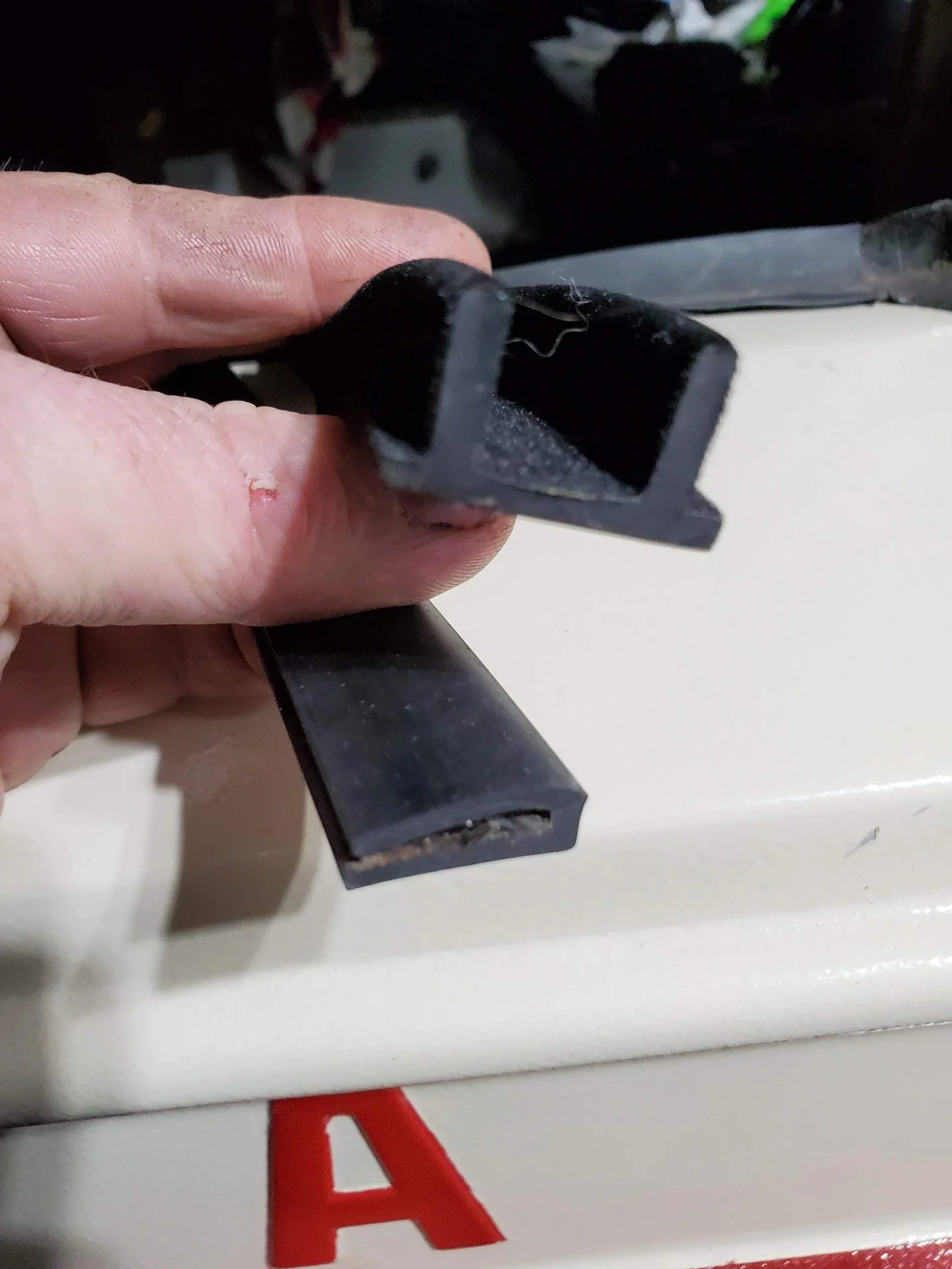

I ordered this from Steele Rubber Products as Slo is out, it just arrived yesterday. The run channel needs to be trimmed so you are left with a "U". I have done this and it tucks in nicely. This leaves a 9/16" run. I don't have my glass yet, coming in two weeks, but it will be 3/16" glass. I had planned on trimming the extrusion rubber to meet the flocked, but am now thinking if I put it in behind the flocked, it would bring the run down to just under 6/16 or 3/8 which hopefully will be snug enough on the window without binding. I will post this to my build thread in a week or so once the glass comes in.

looking good and the flocking is a great thing to keep the window from binding!; let us know how things work!
