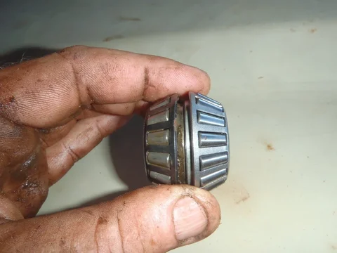

so anyways after spending much of the day doing swivel bearings on a 75 series work ute and looking at the old 61 out the shed door decided to grab a few beers and have a play. pulled one swivel hub apart. heat was handy; esp to budge the tapered washers and steering linkage. the collapsed old bearings simply fell apart in my hand. was dissapointed but not surprised to find the terrain tamer kit i had was wrong.
decided to view the inner axle seal to at least get a number from that with a view to perhaps simply buying the bearings and seals and and slapping this back together. the old felts etc will go again with a kerosene wash. this may still be my plan. sounds rough i know but you need to remember what sort of a project this is; a rusty old 40 that no-one in their right mind would tackle. i am getting this going purely for the enjoyment of the challenge and the dubious glory of 'saving' one of the worlds oldest 40 series.

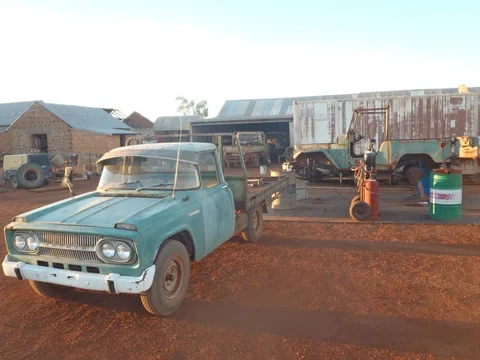

yea stout is a nice old thing. technically belongs to a mate but it lives here because he has no space in the city. i use it from time to time as my daily runabout. is a little rustier than it looks. not sure what year it is. any gurus out there?
