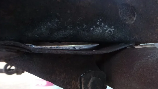

got home early for a quick play tonight. heated a bit more rust out the rear suspension (there some 'before' pics in this thread somewhere). as good as theyre gonna get anyway. then found a bit of straight bar that i placed through side to side. will use this as a guide to straighten things up as i re-weld these up. still plotting but you get the idea; ie the rust distortion i am dealing with.

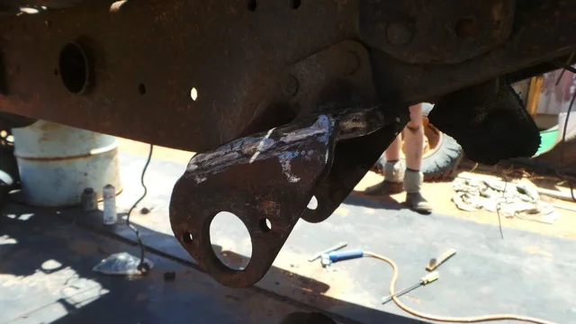

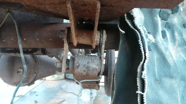

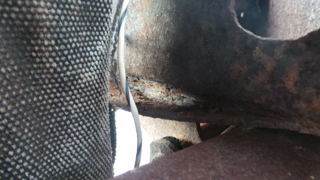

now am going to deal with the same issue at rear of the rear springs. quick play in fading light tonight; removed po mudflaps and starting melting rust. 'chipping away' if you'll pardon the pun. should be no drama here; this will be only welded lightly. only started on one side. for what its worth there is a little battered oem wiring i want to get out of the way before i get heat in the other side. dont like melting it away (and it will stink)

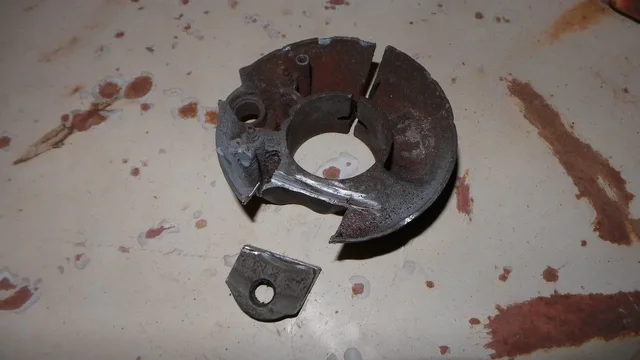

so .....(sorry cult)..... hacked the indicator switch housing. there wasnt a way around this; and i will have a donor somewhere.
