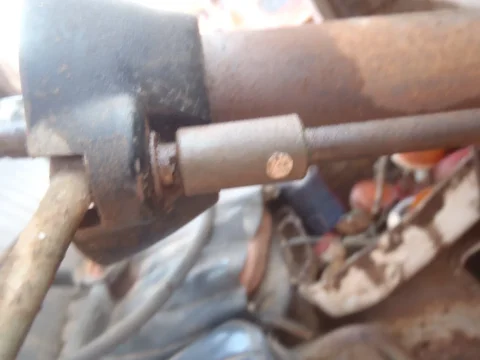

so now to get this one off. my parts wreck has the turn indicator assembly (which i plan to put in the 61 where it is missing) but how to dismantle?
surely i dont have to drive out the pin in the centre of above pic?? it must be just stuck tight where flattened part enters the block on the steer wheel side of the pin??
Please don't sacrifice the cast alloy lump. To remove the assy., there's a phillips head screw on the pax side of said lump. Once this is unscrewed, sit in the driver's seat and reef said cast alloy lump towards oneself. The connecting rod will fall out as it is separated from said cast alloy lump.
