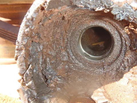

finally, a pic. when i cleaned this up tonight it shows how worn this bush and axle were. the silver markings on the left shows where the axle had been wearing its way into the diff housing! new bush already installed in this pic. incidentally the damage is hardly discerable on the inner axle itself (apart from being 2mm thinner where it ran in the bush)

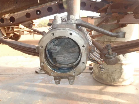

a pic of the 'stepped' front diff housing in the wreck pictured in post 161 above. this donated ball and claw axles to project patina.

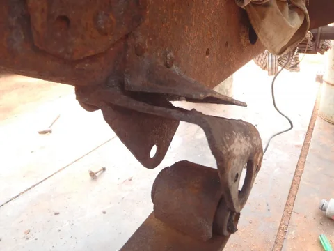

started tinkereing with a little suspension while i was waiting. a whole other can of worms here; esp the rear. wasnt going to tacle any of this yet; had planned to drive a little to loosen things up and crunch up the old rubber bushings. anyhow..... is ugly at the rear!

kept playing suspension; ie that rear ugliness pictured in the above post. really been avoiding this but found the old rust easier to remove than i had anticipated. heat is the go; managed to keep heating the rust glowing red then chip, rattle it out with sharp chisel. it is easy to get the rust glowing and not heat the existing orig metal. believe could blow the rust out with a cutting tip (might try this on the other side) but need a smaller tip than i have. needs a tiny bit more but tonights progress compared to pics in above post.
nearly ready to re-weld these. orientation is a little issue; everything very distorted. currently thinking to fit new rubbers then find a long piece of solid bar thats a neat fit and put it right through side to side and tack weld the spread parts into position after a bit of measure from some point on the chassis. perhaps. perhaps i will just get rough instead!

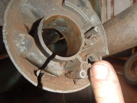

but... the 2 pins that located some of the missing mechanism; pictured here near my finger
notice they are missing on the donor but intact on the 61 original. makes me less enthused to sacrifice the original (as mentioned earlier somewhere). anyone know how they locate in the alloy; ie are they removable?
