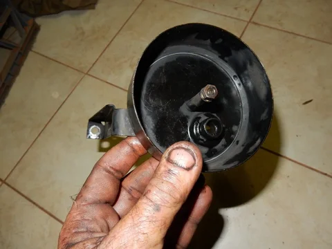

so... ignored the pita screen holddown studs and tinkered. got exhaust and oil canister of this motor, cleaned the heck out of it and pulled the sump. found a few things:

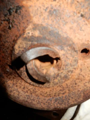

broken lug on the crank pulley/harmonic balancer

teq stamped crank. mentione this before but i reckon this stamp is fj25 specific and i reckon the harmonic keyway is different on these cranks.

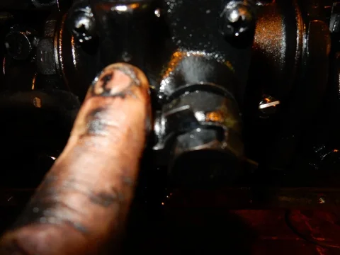

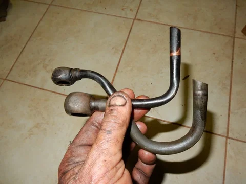

most important was this loose union bolt on the oil pump feed. could get a good tenth of a turn with my fingers. broken and disintergrating fibre washer behind it. bolt play:
also what looked like a crack in the oil pickup line. no wonder i had so much trouble getting oil to the top of this poor old motor. i got a feeling the gearbox failed just in time!
once i pulled the oil feed it seems this is not cracked through. really looks like a hacksaw cut. what caused this damage i have no idea but will swap out or bronze up or sort something better.

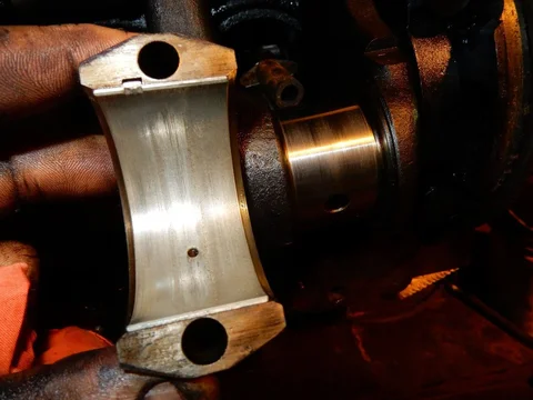

pulled the 2 bigends with missing splitpins. they and the crank are scored to be sure (but what do you expect); and i not an expert is such things, but i can be pretty rough so i (and my budget) are calling them good to go. shells marked teq std. will pull all these for a look. cam is not the best you ever saw but same same; its ok. bores seem ok as far i can tell from underneath.

this rubber grommet where the oil pump pickup locates in its canister is as hard as a piece of rubber can be. feel it should have some 'give'; even if thats just to fit it in the first instance. dont feel this is helpful and may try do something about it?

After my recent experience with oil-less F's west I can safely say your crank and shells aren't nearly as scored as mine were. My shells had liquefied and been pumped into the crank galleries before cooling and setting. Someone else will know better, but can you throw a new set of shells in and call it good?

this crank is not perfect so without a crank grind (im not going there) just going to slap it all back together. inspected and cleaned all bigends, pretty even wear, and got them cleaned, oiled and back together with new split pins. hard to get the castle nuts right within the torque set but swapped a few nuts and got them pretty good. if anything a few are at the tighter end of the 35-55 ft/ld my book recommends.
found a new rubber grommet of unknown application among aforementioned gasket kit to locate the pickup.
i have an f motor in bits. for what its worth block is cast 1966; was the motor that 'patina' (1964 fj45) came with. dug through the box to locate a donor oil pickup line and noticed they different. latter is larger capacity.
this means the oil pump is different also because the union bolt that holds pipe to the pump is larger. wondering what anyone knows about all this; i presume at some point they changed to a larger capacity oil pump. the later pump would surely be the go if you were properly rebuilding an early motor. think i have decided to bronze up the line i have and run a decent oil pressure gauge.

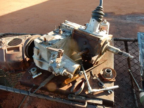

still pondering oil pump so turned my attention to donor (for now) gearbox. have been cleaning this old lump to a stage where i can be bothered turning a spanner on it. nothing too special happening here; just a clean and a few new seals etc.
got all the external linkages apart; drilling out rotten split pins etc. what was bugging me most was this linkage which was stuck and turning the shaft in the trans housing. sorted with no drama though.
very clean in the trans. fair bit of condensation in the box; mostly up high tho. filled this with old diesel and cleaned things up with a little wire brush. will be ok; calling it good to go. first gear is the worst.
also found this old top among my junk; original is (as always) very flogged around the stick locating pins. this dirty old donor in surprisingly good cond. soaking this.

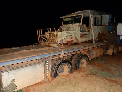

havent done much in the last couple days. borrowed my mates hiab so (the short story is) i been busy with a few other things...
He'll need another stable at this rate. Or a friend to help relieve him of a few fixed-tops ;)
yea the very remains of a very battered old army. i have known of it for a while; just happened to be in the right area with the right 'tools' to hand. was destined for the scrappys crusher. aussie25 is taking a few of the army specific trinkets for his resto but all in all theres not too much to like. is one though (and i didnt have one haha) and the price was right. couple more views (including a pic pertaining to the 'long story')!
