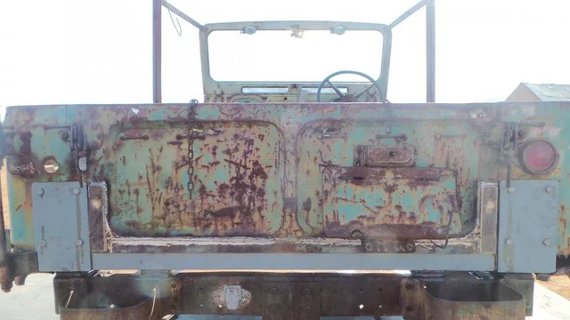

the weather got very hot. a few thunderstorms threatened but the cruiser gods didnt strike us down with a lightning bolt so we continued. fabbed some plates to hold the rear quarters in 5mm plate. welded these to the 50 square

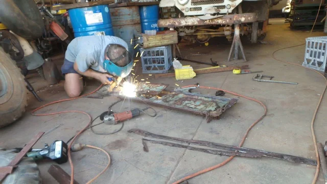

hard to see in above pic but there were a few wires and things holding this tub together. my brother is a carpenter b y trade and pretty meticulous. a lot of measure and remeasure went on. i held the dumb end of the tape. below is the new structural member getting a lick of rustproof paint atop the old structural member

west. tell me something old mate. can you tell me why this rectangular plate here:
couldn't be installed in here:

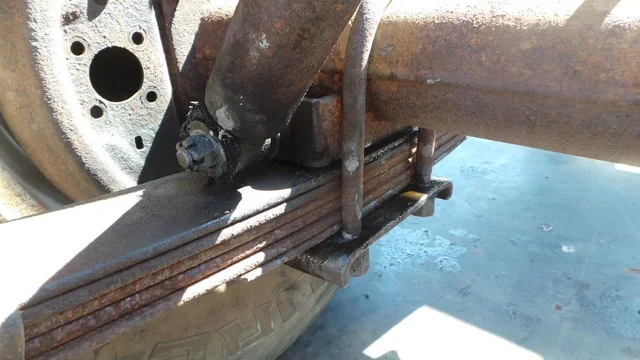

it was a couple days of teamwork; there was plenty going on. bumstein undid rear u bolts and lifted housing. the u bolt plates were belted flat on the anvil and rust layers between housing, spring and plate cleaned up. all replaced with a healthy dose of tar. one spring had a broken centre bolt and the leaves were shifting. sorted this. dunno if these springs are my final answer but they are doing the job within budget for now. having some structure made springwork easy; note the ratchet strap!

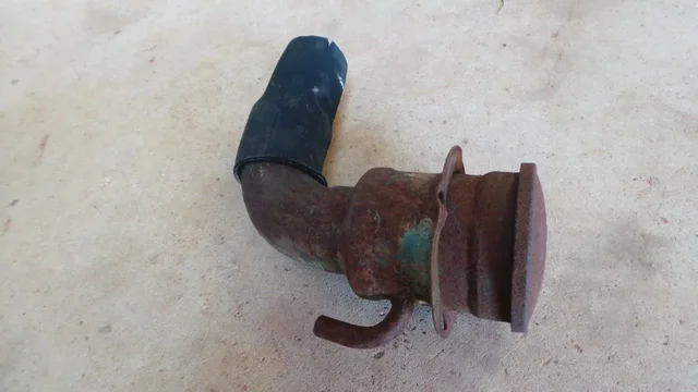

ground out some ugly po bolts and removed filler neck. needs a little straightening and a lot of gentle coaxing to get the cap off. check out the unbroken oem cap chain! (unclipped here)

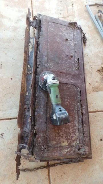

it was time to tackle the tailgate. this bad the structural integrity of about 24 horseshoes wrapped in alfoil as a flat package.
my brother got the hinges off and cut a slice off the bottom. replaced this with a piece of 40x40 angle. he's handy with a stckwelder; i could never have welded something so thin and rusty! next a piece of 4mm flat bar was welded up each side on back of tailgate. this overlapped the angle to give it some strength

ok cult, back to that 5mm plate. this gives all the strength at the rear because it overlaps the 40 square (not butted in) and is welded all 4 sides. as per plan we ran a little weld between this and the lower spare trye carrier hinge to brace this. we need to be able to carry a spare on rusty of course!

it lives! well done! but i meant why not install the plates behind the body intend on the outside of it..?
what's next, get that F going?
knew what you meant cult, yea we coulda done that; but then our mighty resto work would be hidden! didnt really think of it. neither here nor there when you look at the project as a whole! that plate is 5mm thick so doing it like that would kick the tailgate hinges out a bit. also we sorta designed it to gently weld the bottom spare carrier hinge to the plate. this is a pretty easy undo if that carrier needs find a better home one day but happy enough with it for now. i might add that every metal on metal surface during this build is getting a good wire wheel clean and a coating of tar (for what its worth).

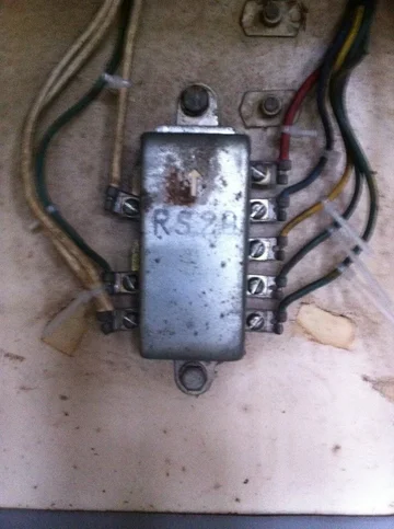

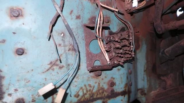

took a beer down to parts wreck no.1 (64fj45) tonight and pulled a few things; fusebox and accessory light plug among them. a bit of wiring is next; want to sort some under dash and bit of engine bay with room to get myself about before the motor and box go back in. anyways i got to geeking out over early fusebox variations and ran outa light. wondering if the later fusebox can be tweaked a bit and the mount holes elongated to fit through and under the old 25 style fusebox carrier.
wiring is not my strong point but its not the most complicated circuit; just hacked a lot. thinking maybe just a twist and tape patch job to see if i can get it up to speed then maybe try for something a bit more subtle and oem looking. need to do a bit of study.

some treasure i pulled from parts wreck no.1
original fusebox on rusty
been having a quick look at fuseboxes. my fj25, rusty and proposed 64fj45 are all slightly different. (my 62fj45 fusebox is in deep storage and 63fj45 silverbullet doesnt have one).
anyone have a pic of an early fusebox to get me started here? will have a wander through some old threads. guess i want to see the configuration of the top fuse that has been bypassed; mainly if the feed side is supposed to be bridged to the fuse below it. i need to find an appropriate wiring diagram i guess. im a poor auto sparky!
