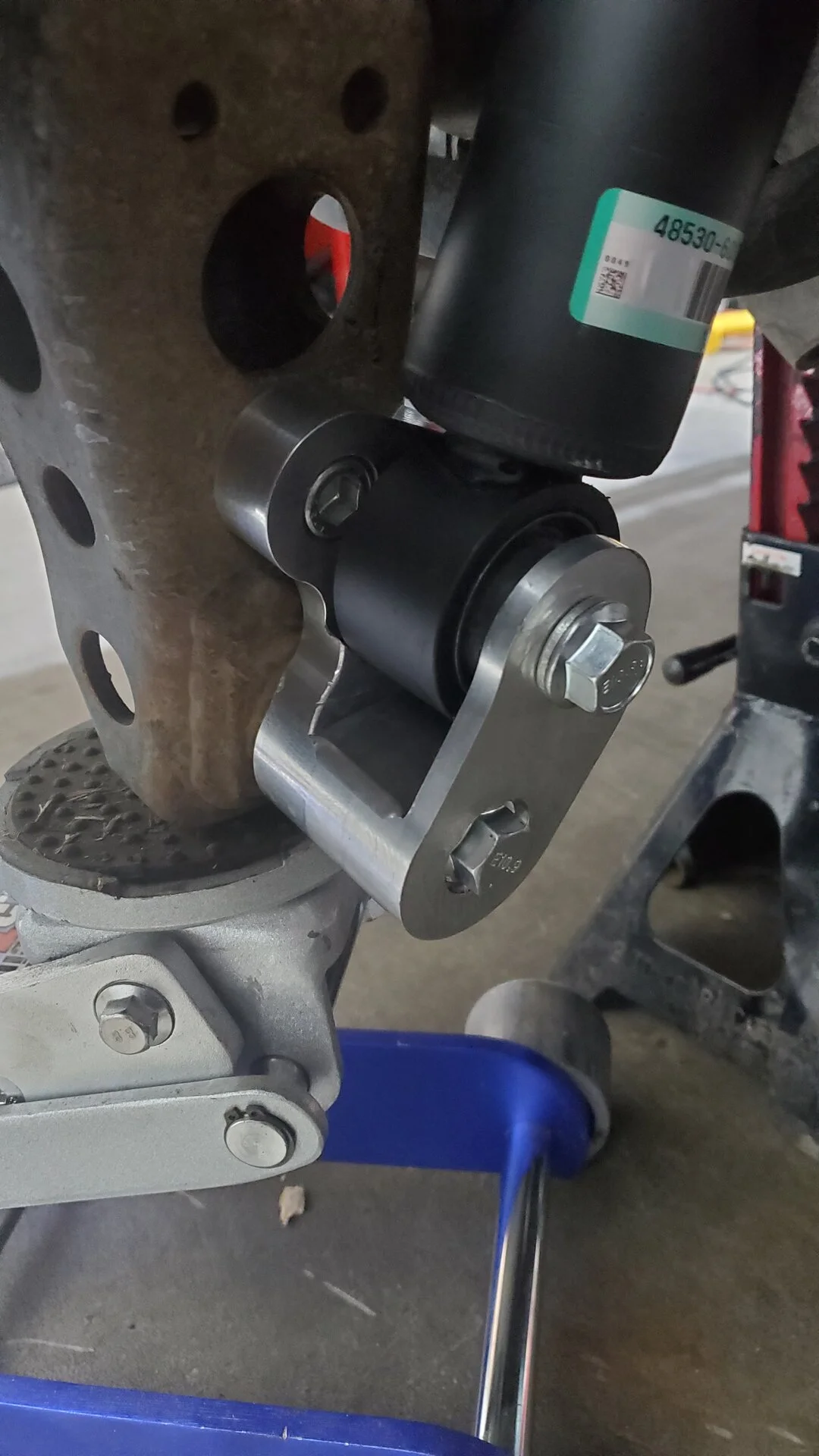

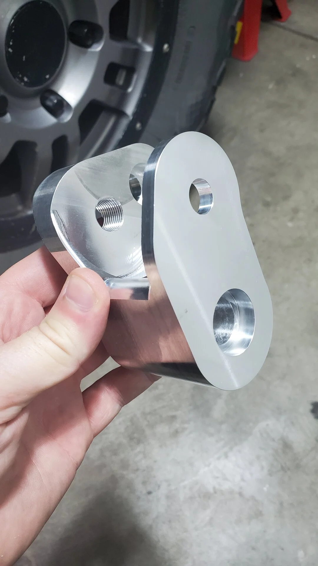

Update for those that pre-ordered. I dropped the parts off at my anodizer today.
I may have to ream out the anodizing out of the main mounting hole as it is a tight fit on my stock shock mounts. Other than that everything seems like a good fit.
Shiny bauble. Nicely done.
