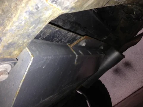

Here is 24 gallons. No provision for charcoal canister. Tank wraps up and over resonator. The rear support is mounted right before the frame "triangulates." The tank could probably extend back a little further but it is also nice to have a little buffer.
