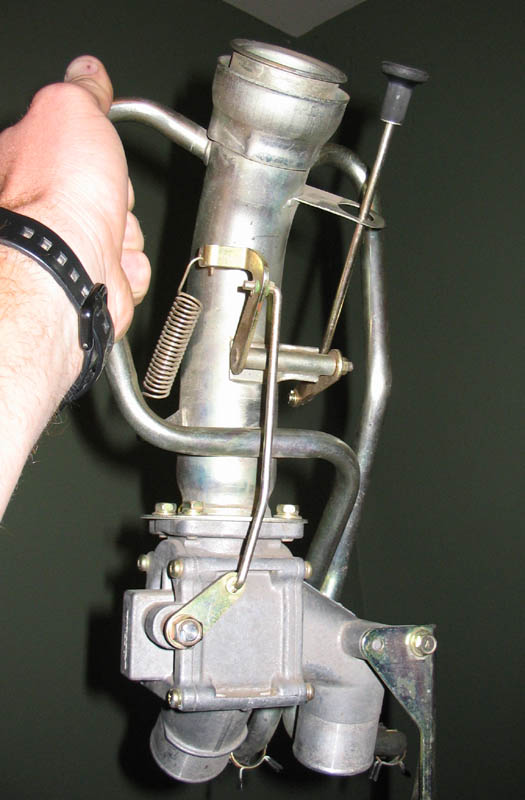

Mobi,
Do you have photos of how you mounted the gas filler to the truck and to the tank? I have the tank and the filler that came with it - I was able to get the dual filler you have and I am hoping to see how you did it.
Also, do you have any issues with vapor - when it is hot out, off-road and at altitude? Thank you very much.
Amando
This has been a backburner project for me. I went ahead and got a dual filler pipe from Dave at Japan4x4 and then sourced some additional parts for the connection to a custom fabbed tank. Just haven't had time to measure out a tank to fit and then figure out the attachment of the tank. Got a fabricator in line to make it...just no free time. I would like to maybe do this over the summer.
I've wondered which 100 series that plunger type dual filler neck comes from. All the 100 ones I see have the non-plunger type. Amando, next time you get a chance, is there a part number on your filler neck anywhere?
