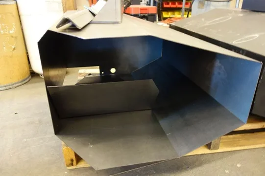

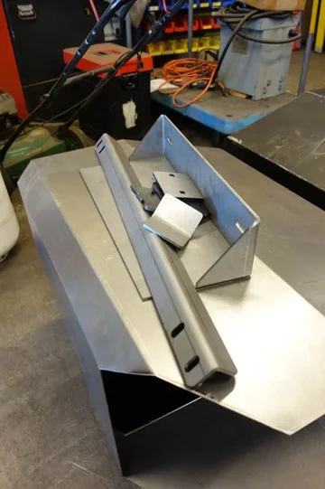

I went to the fabricator's shop today to chat with him about timeframe, etc. He has made some progress on the tank, but has been super busy with a couple of priority orders. However, I did get some photos :bounce: The black painted tank on the right is a FrontRunner 170L subtank that I am using as a template for the prototype for the largest of the three tanks. Should be around 45 gallons. Enjoy the photos!
Once this prototype tank is finished, I will be installing it in my 2001 LX470 to test fitment, etc. I will then be starting to take orders on this tank. This tank will only be available for 1998-2002 rigs only.
After this process is complete, I will then have the fabricator do prototypes of the 30 gallon tank and the rockcrawler tank. Got some more goodies coming in that I will post info on in the near future. The fabricator said that he is going to be super busy for the next week or so, so we are a couple weeks away from having this prototype done. Timeframe is still looking good for prototyping of the other two tanks in August. Anyone have some time to get down under their 2003+ rig and get me some detailed dimensions of the charcoal canister and it's location?

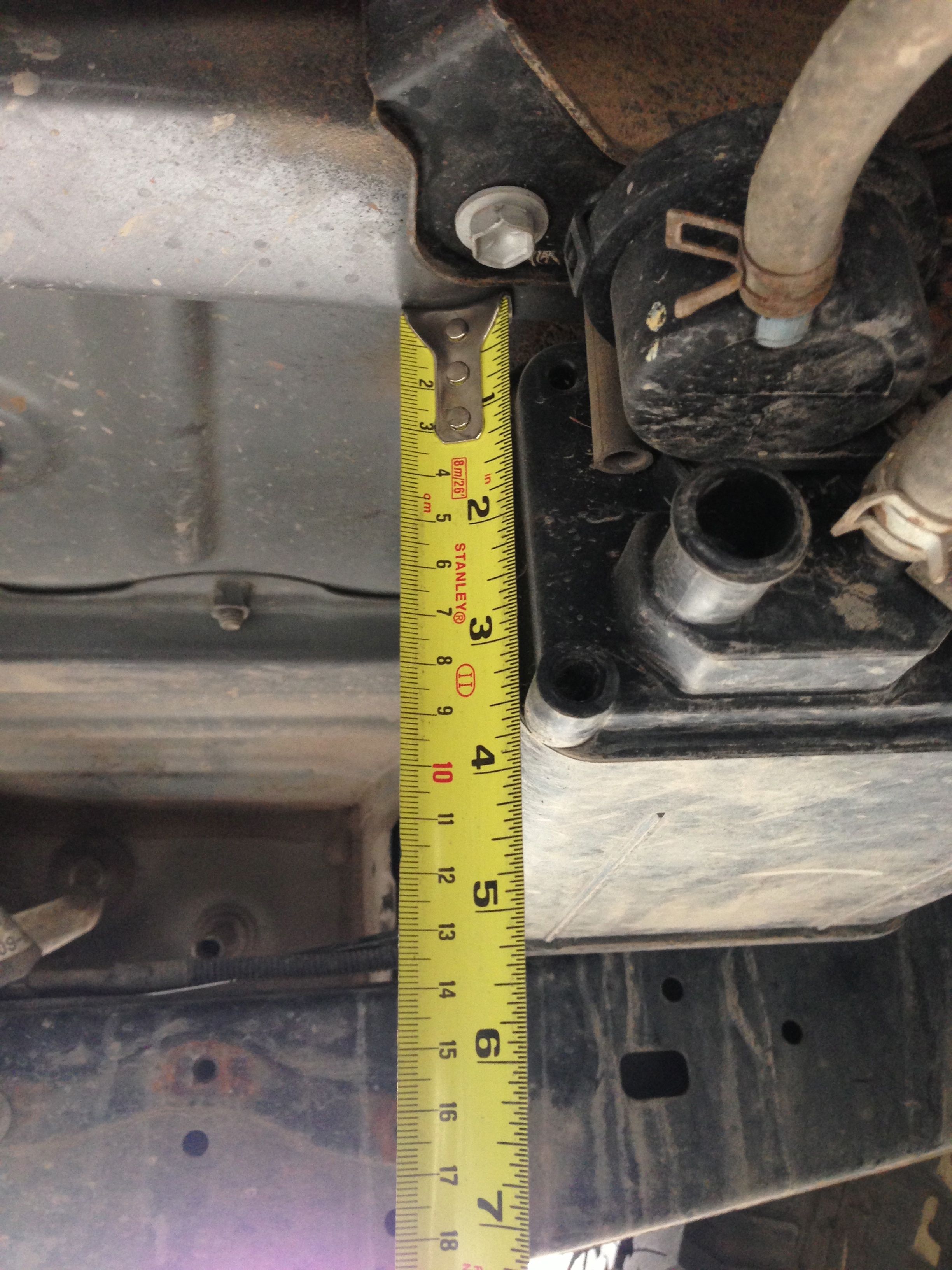

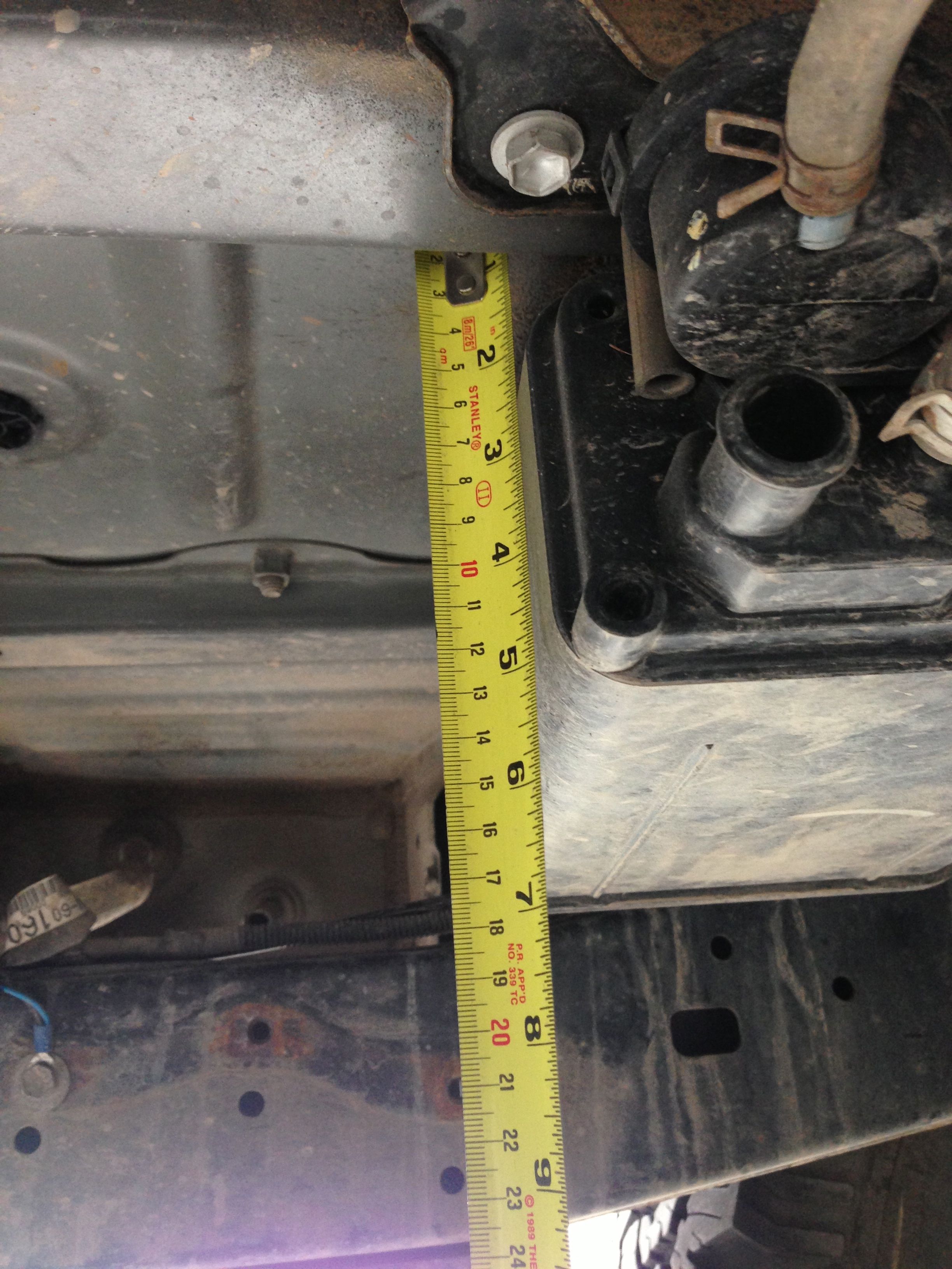

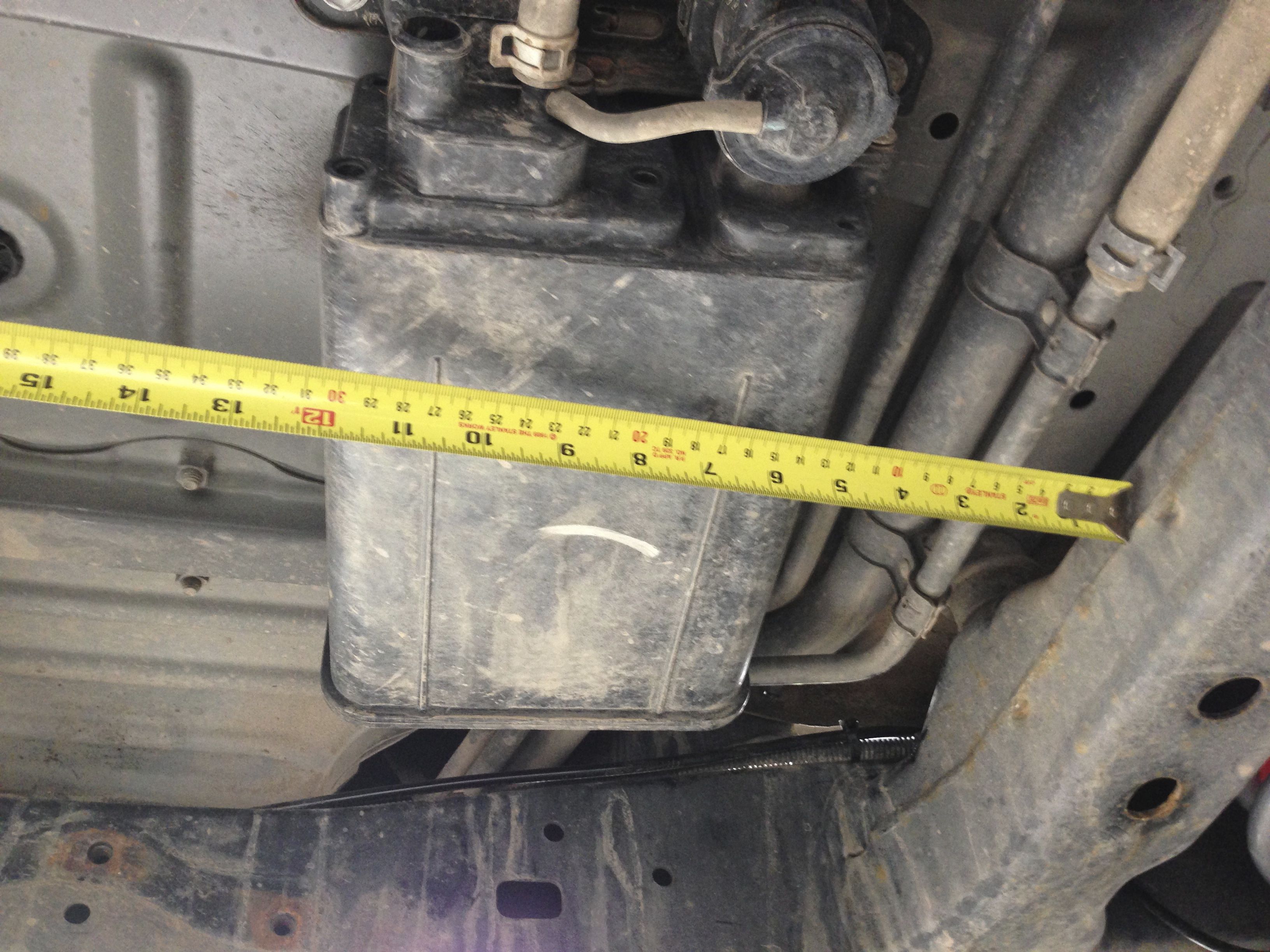

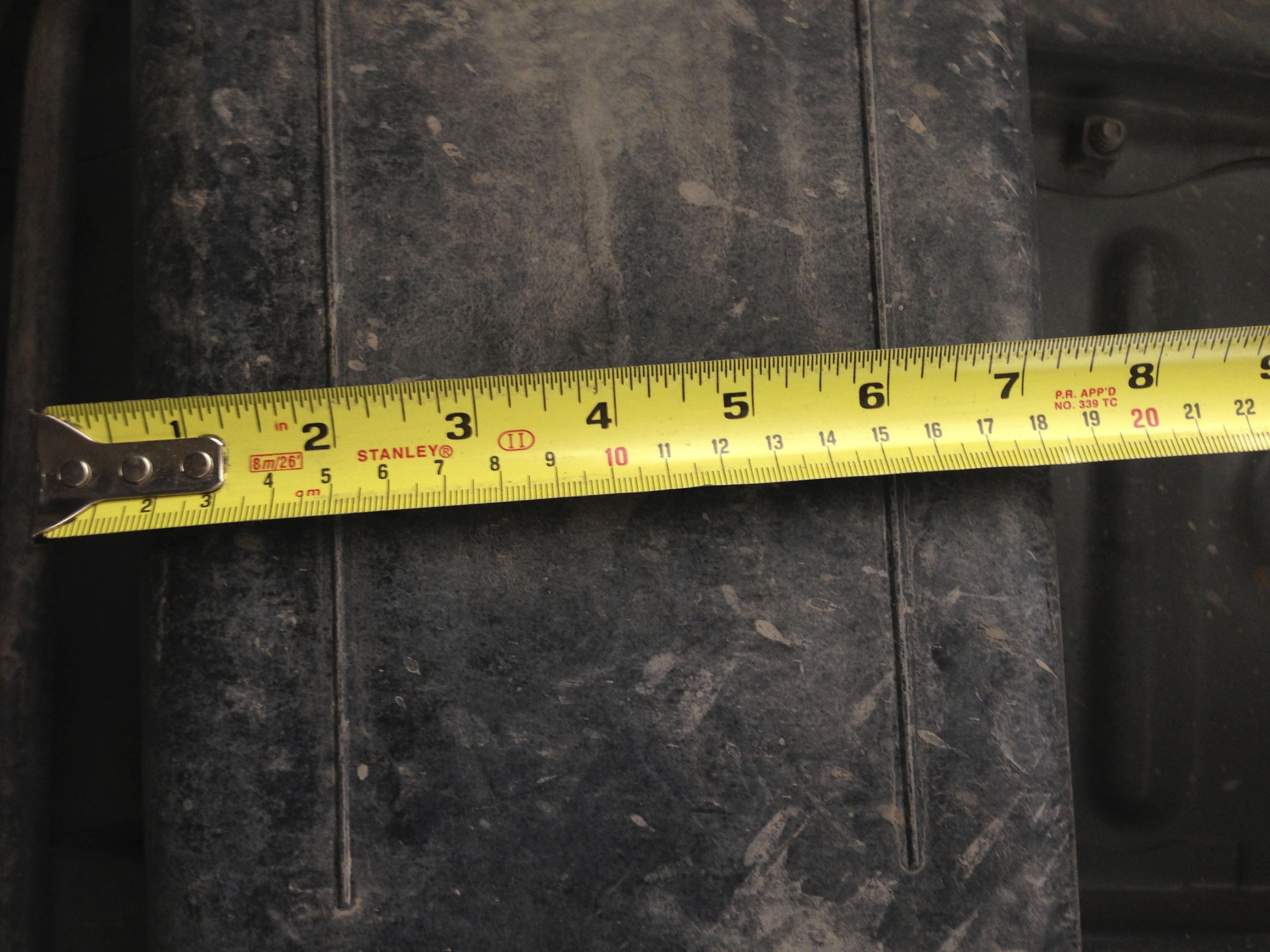

In hopes that I'll be added to the interest list for a tank on my '03 with the cannister, I tried to take some pictures. Hopefully they're useful...was a bit difficult to get the phone and tape measure to play nice.
Panoramic shot. I have an aftermarket exhaust...no resonator. I also removed the cross member and all associated hardware from which the spare is mounted.
The dreaded cannister...this thing stinks when it is hot out!
Width
Measured from the floor...
...and from the frame rail.

perrobravo, those pictures are almost exactly what I was looking for! Thanks for posting up!
Looks like we may have an issue to solve. To me, it seems that the filler pipe on your rig has an additional bend to accommodate the charcoal canister. That could pose an issue with the dual filler neck sourced from Japan. I'll may have you try to take more photos if I can't meet up with gypsycruiser later in the week...
