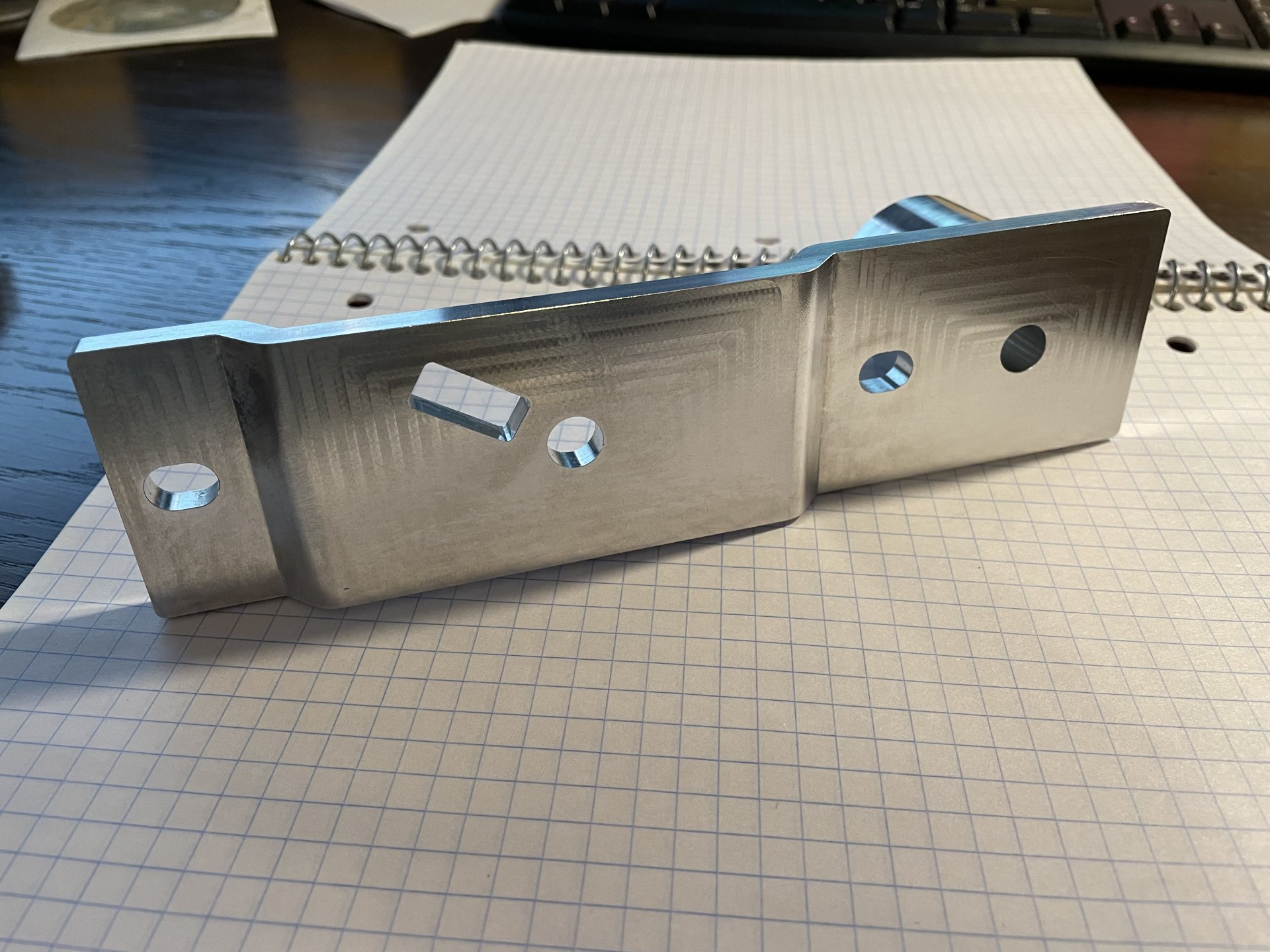

probably a "stamped" piece as opposed to bent

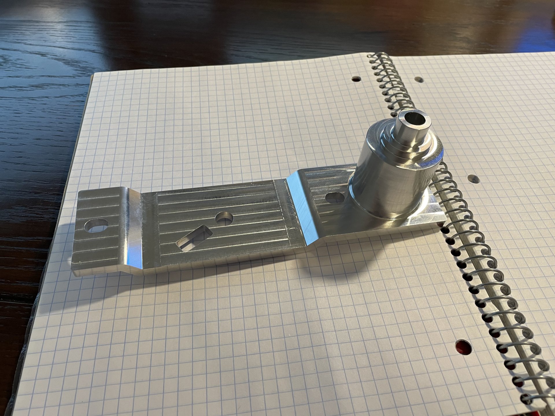

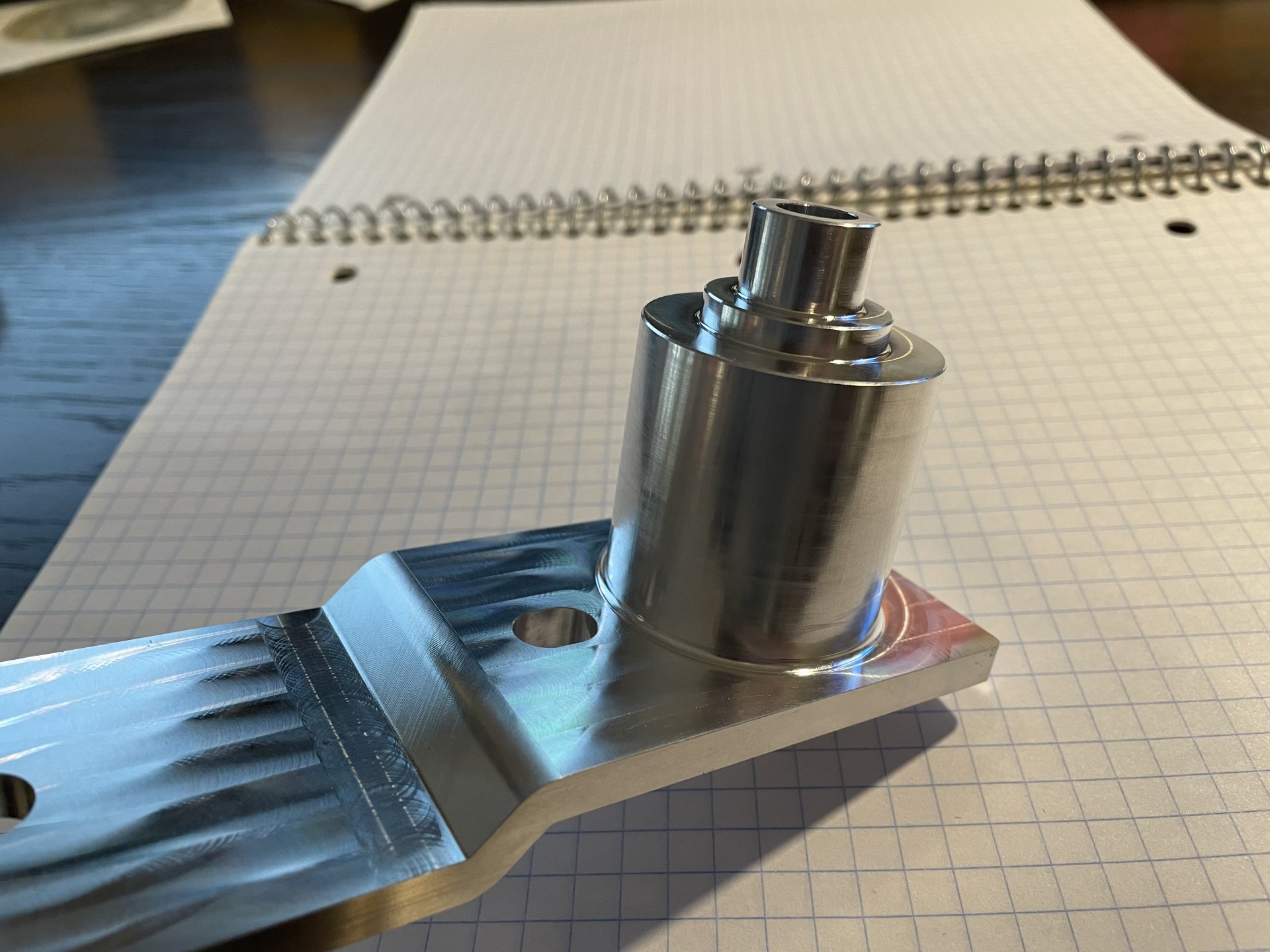

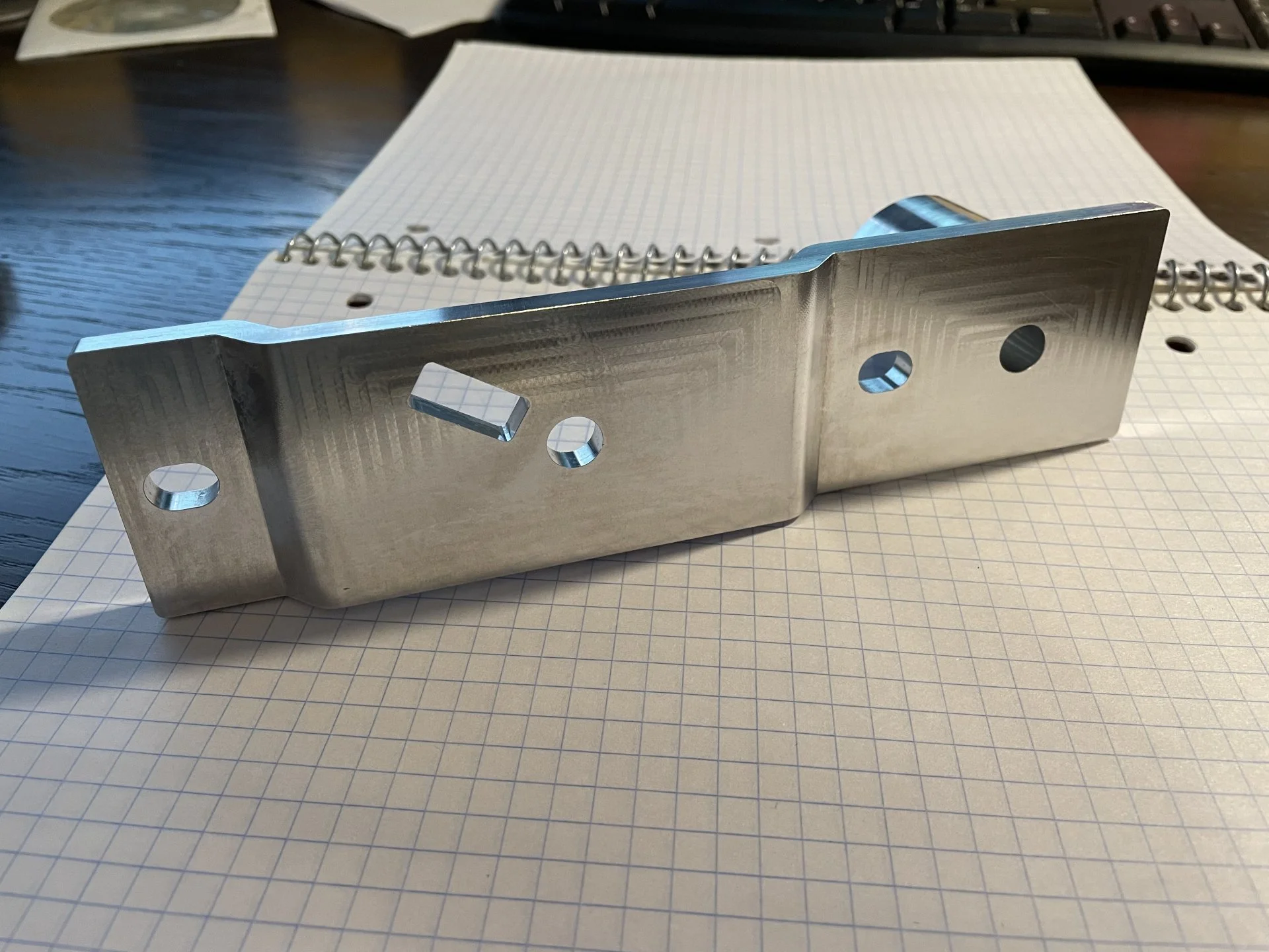

Yes, you are right - stamped may be the best way. Because the production number is low (1 or 2) the price will be high for all. CNC may be the cheapest based on setup and required parts. I am leaning towards making an assembly from aluminum. An alternative solution may be to make the bracket into 3-piece design that bolts up. This can avoid a need for a press and can possibly be made at home by hand.
Finally finished the 3d modeling and had the part CNC made from aluminum. Came out perfect. Such a beautiful part. Price can be significantly reduced with larger quantity runs.

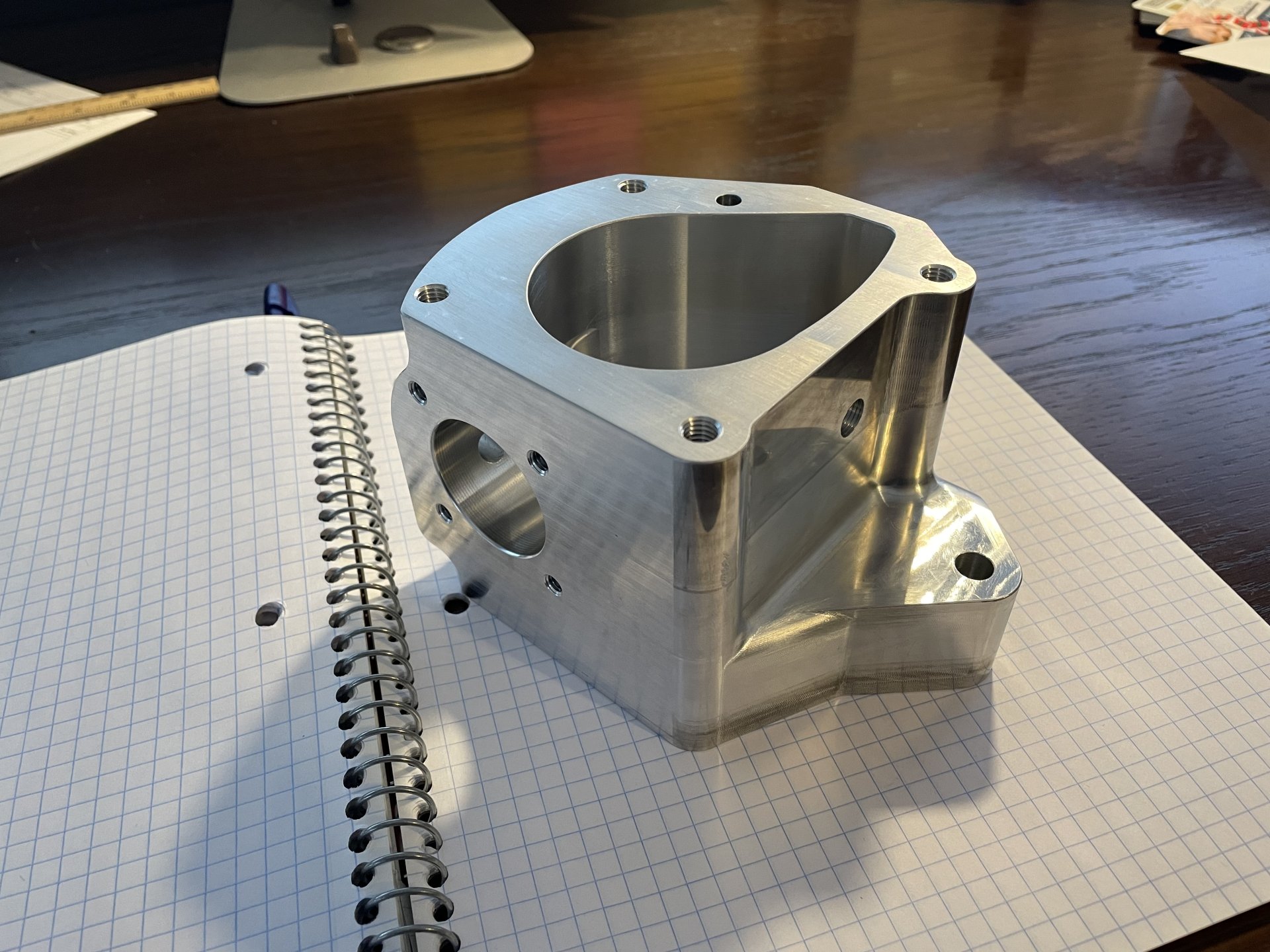

Next part I am working on is the throttle body adapter. I have most of it designed in Solidworks but need to check some measurements. If anyone has photos of it not installed please share. I am designing from pictures and measurements that I take from the parts I have.

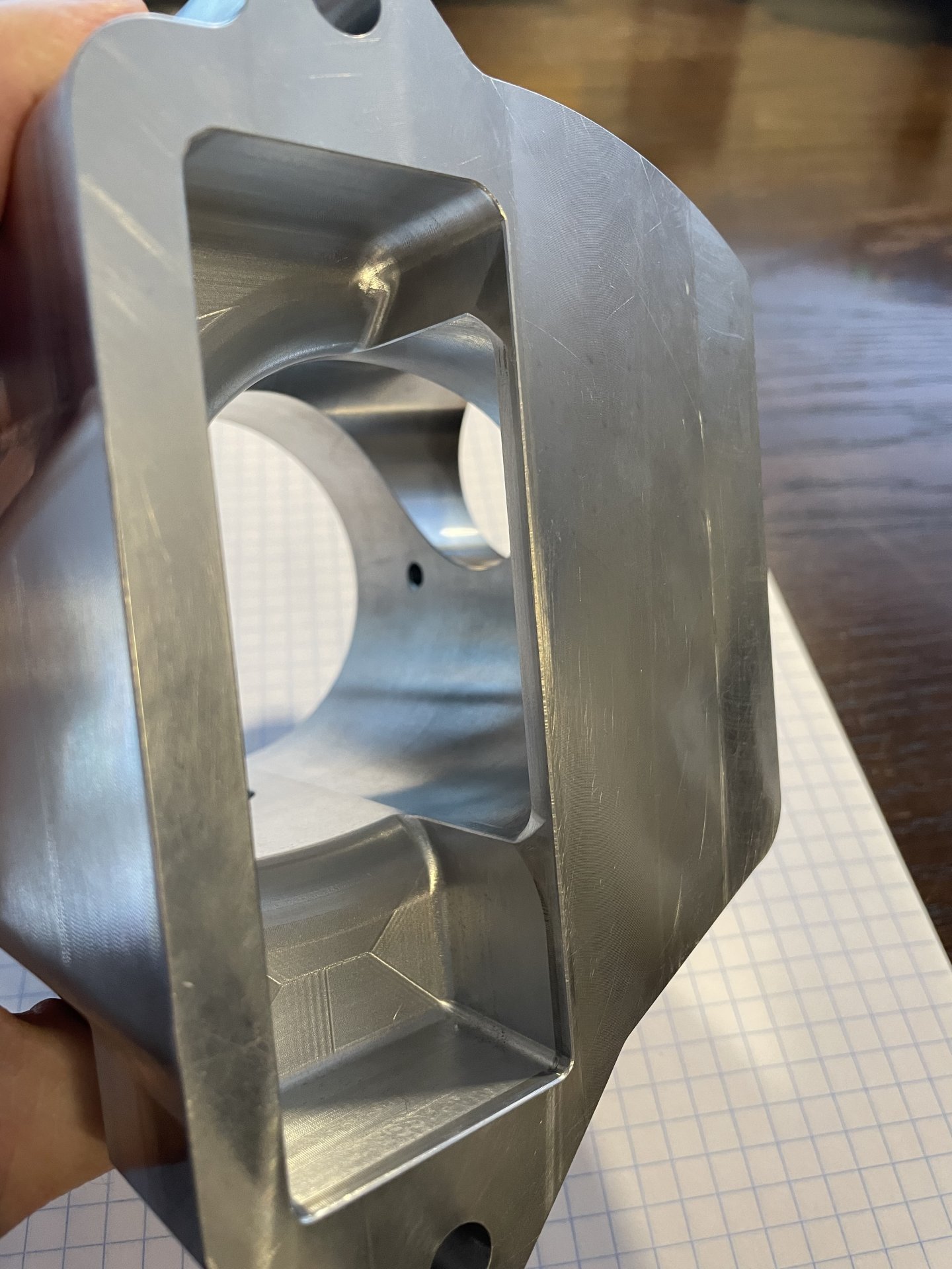

Finalizing the throttle body adapter before CNC. I have smoothed out the air flow and maximized the opening.

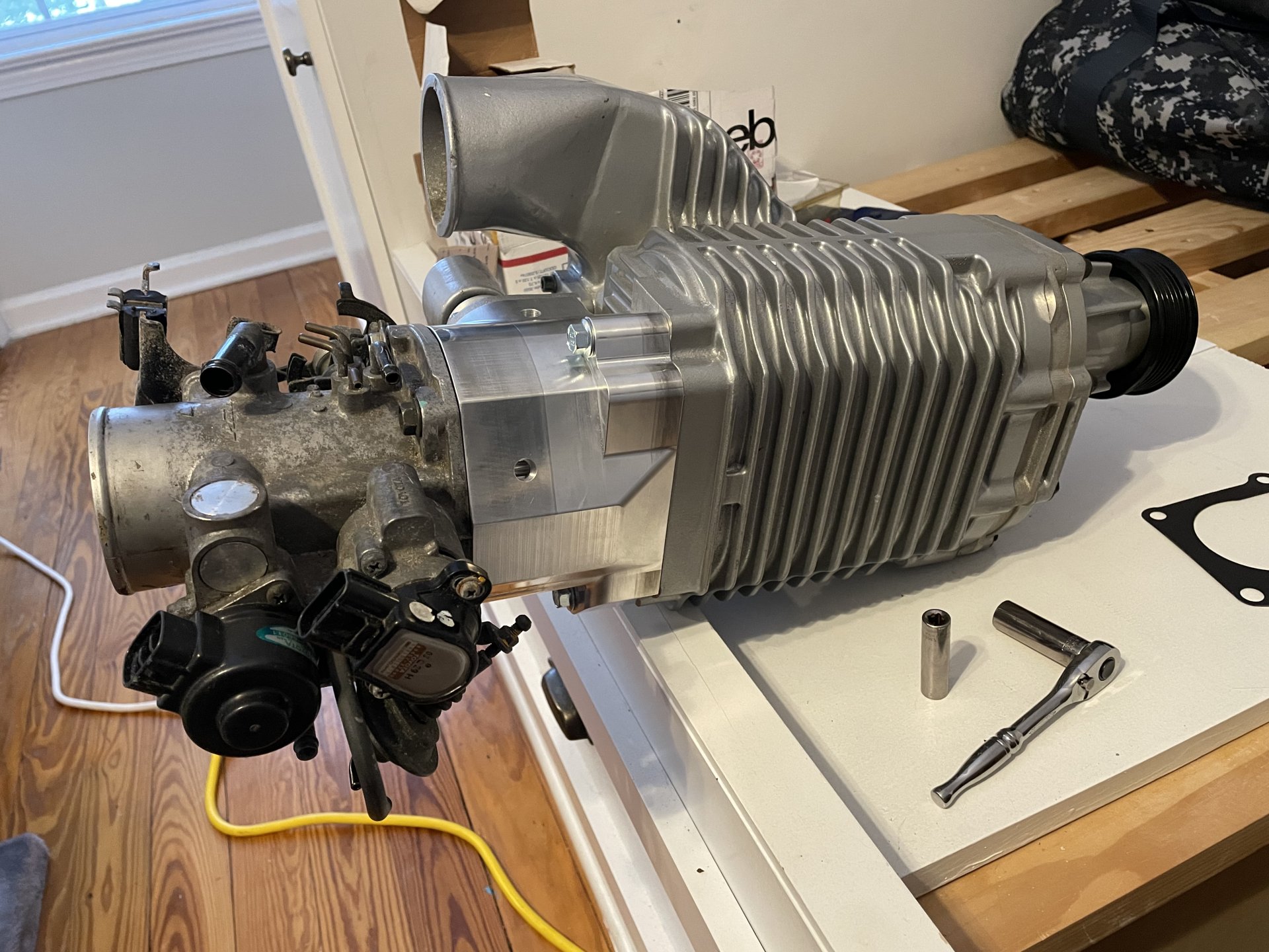

Throttle body adapter has been produced and is a perfect fit.

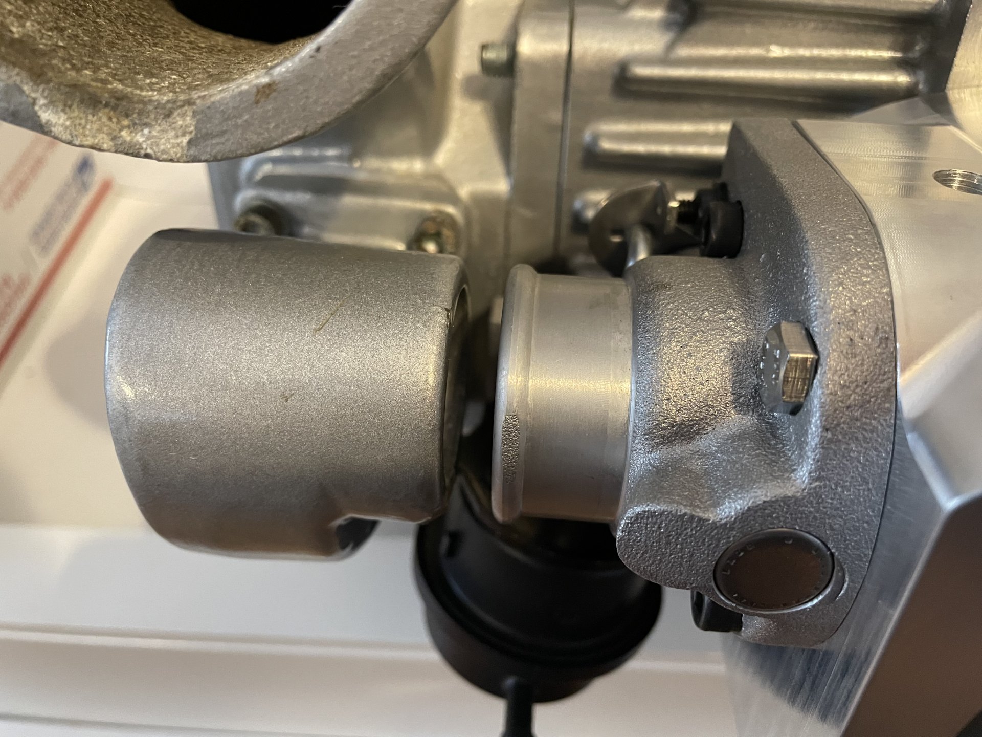

I’ve improved the alignment between the bypass valve and discharge plenum. I recall the factory setup was slightly off in one axis. Now it’s perfect.
I have also smoothed out the internal surfaces and removed sharp corners in my design to help with air flow. No test to show effectiveness.

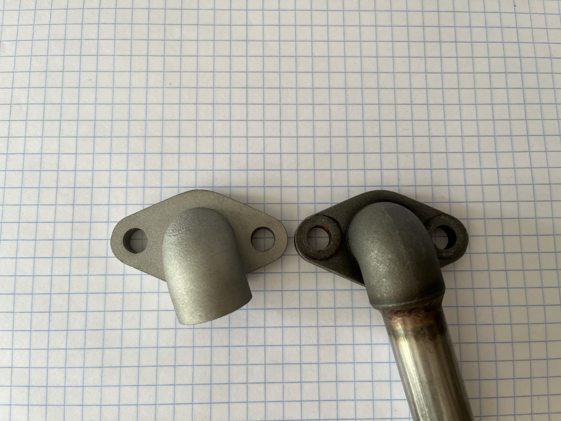

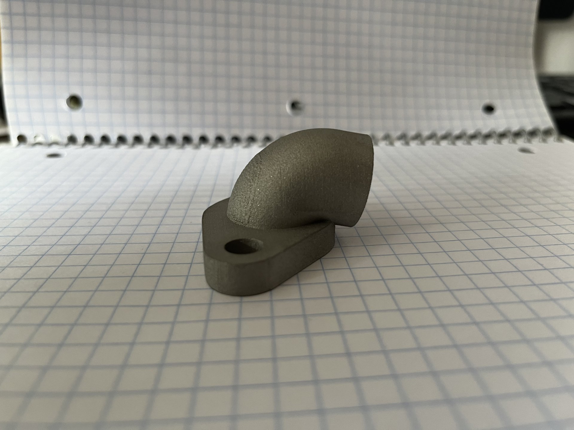

The original coolant pipe has a ferritic stainless cast flange that is welded to a stainless 3/4" pipe. The pipe is easy to obtain but the flange with elbow is a custom build because it is not symmetrical and has a few angles in all axis. I duplicated the flange/elbow in CAD and because of the tight internal radius, CNC will not be able to fully produce this part. So, I am going the DMLS (direct metal laser sintering) route. This process is very precise and can do things that CNC will never do.

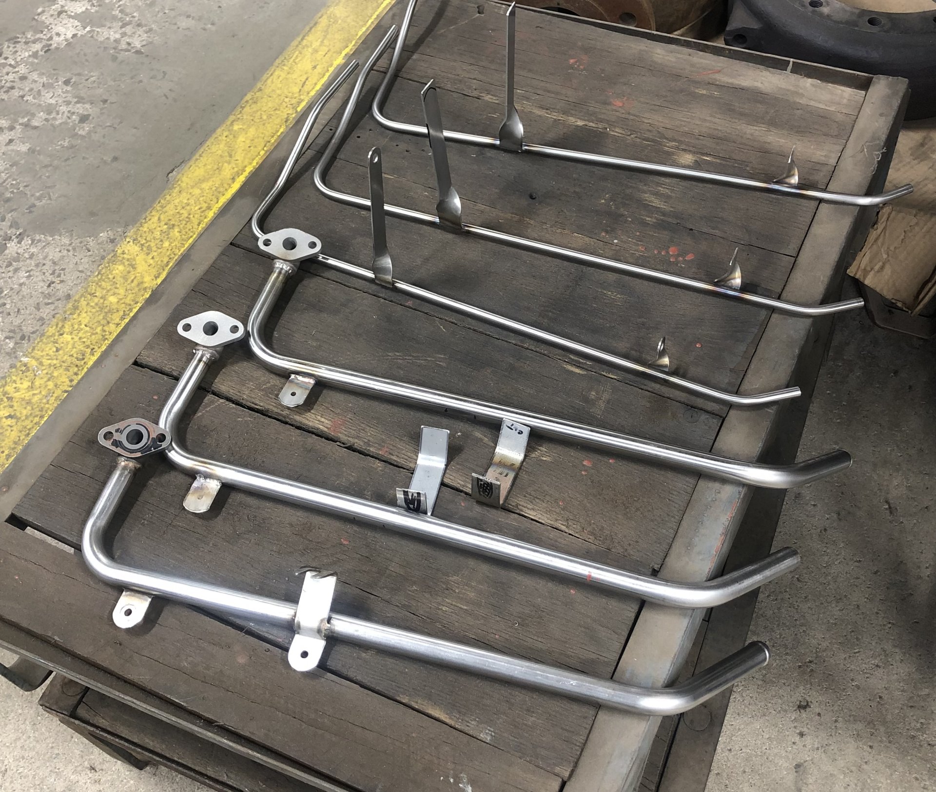

The plan is to produce the flange/elbow and weld it to the stainless pipe that I will bend and weld mounting tabs to, just like the original TRD pipe. In the end it will look and function just like the original.
At this point a number of supercharger components are reproducible if they are needed. I have developed in CAD the throttle body adapter, belt tensioner bracket and pulley spacer, intake runner pipe flange, coolant pipe flange, and crank pulley/spacer.
The flange
Capability of DMLS: This is pulled off the web to show the capability of internal details as shown in this cross section cut out of a gas turbine.

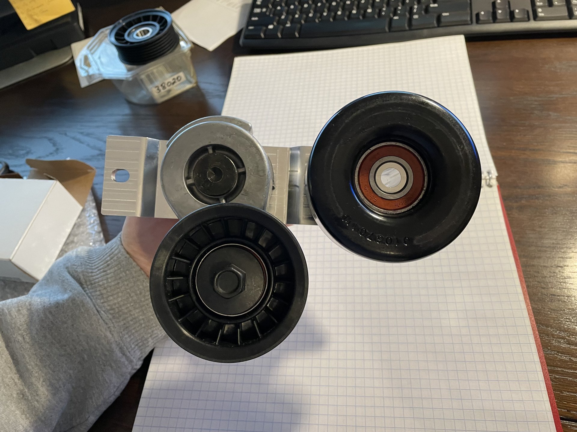

View attachment 2860996View attachment 2860997View attachment 2860998View attachment 2861000View attachment 2860999
your pulleys are on backwards, they need to be swapped

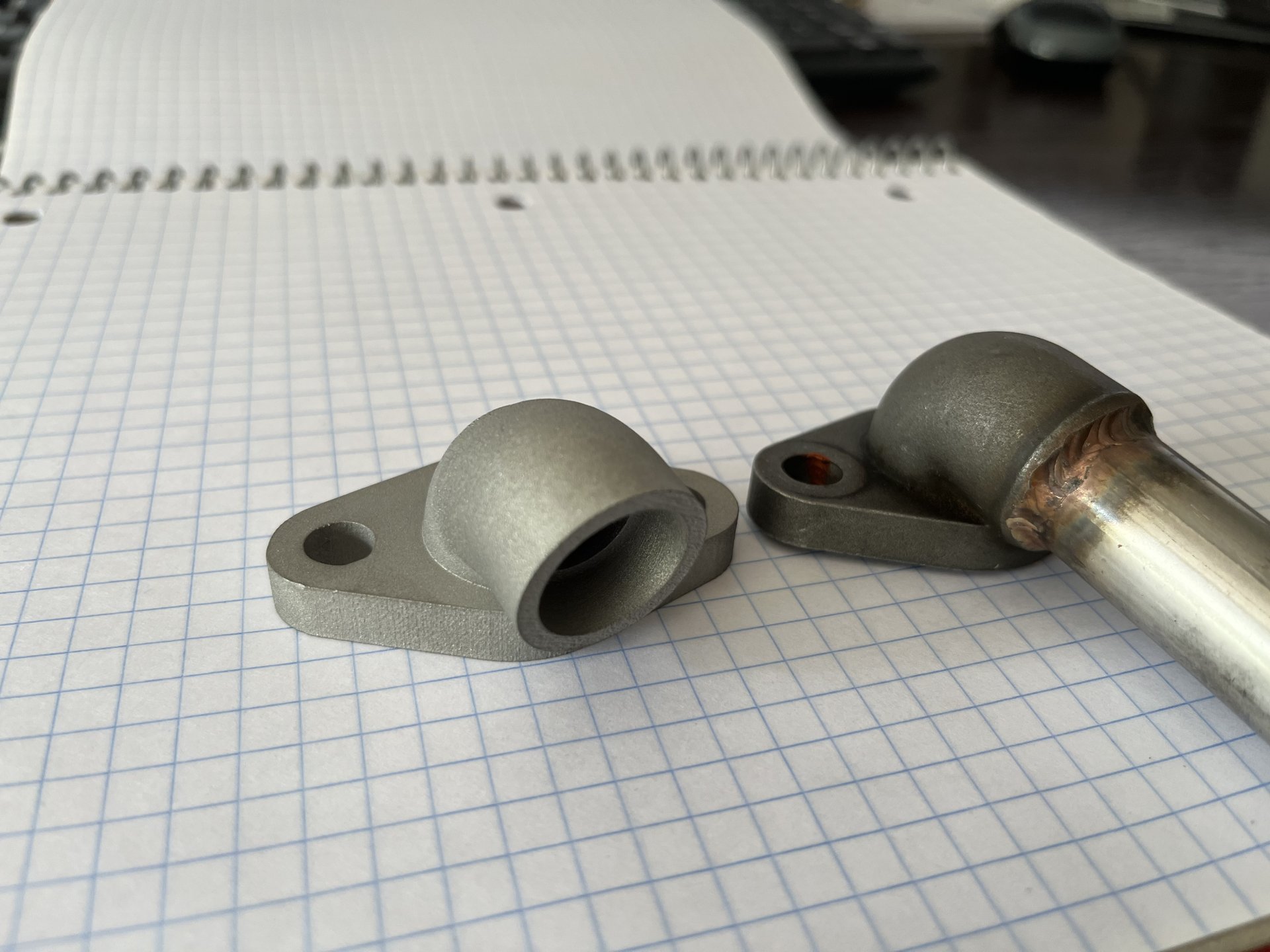

Here was the last part - vacuum and coolant pipes. The 3D printed stainless flange was welded to the stainless tubing and so were the mounting tabs. Came out awesome. Photo is just before finishing.

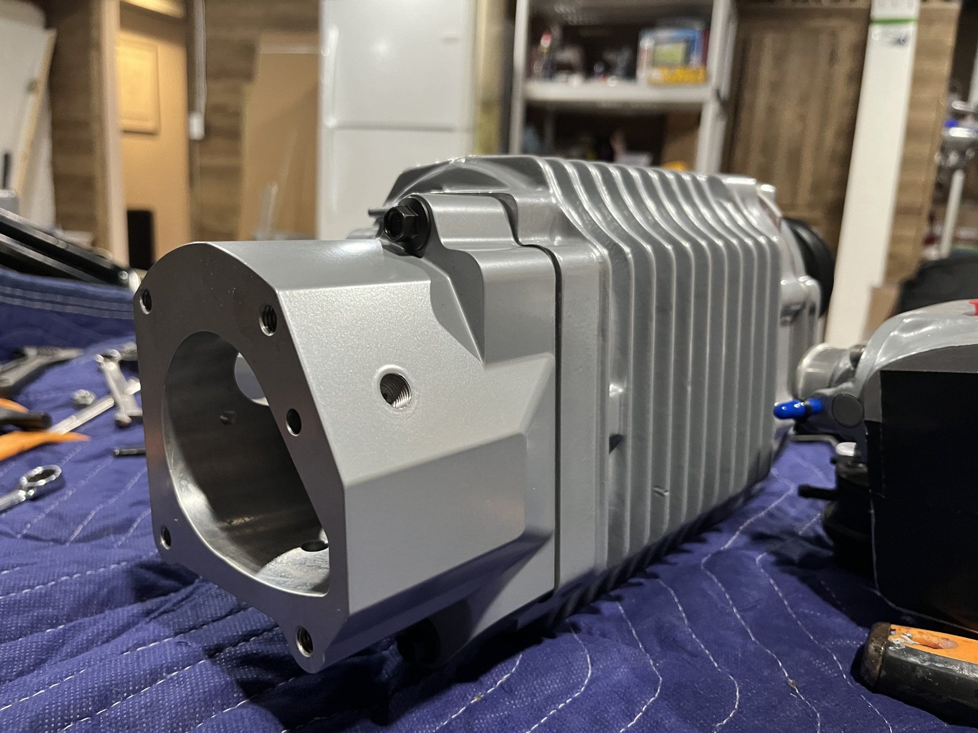

My aluminum CNC throttle body adapter was powder coated to match the supercharger. All new hardware for the entire kit.
