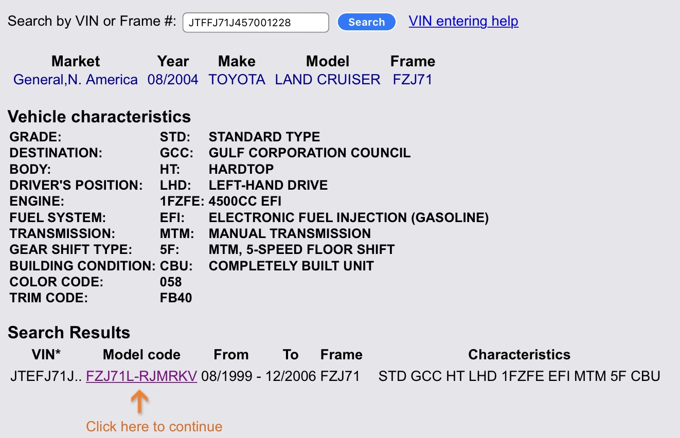

Thanks Juan : actually I do not see neither a 5 or a 2 as final digits in the various numbers I see on the plate in the engine compartment :
Frame No : JTFFJ71J457001228
Trans/Axle : H151F A01A
Running the vin, your truck should have 4.10 gears and a LSD looks to be optional. There will be a caution label on the rear differential if it has a LSD.
That is cool information!
What are you accessing to run an international Toyota VIN?
Thank you! Found mine, huge help!!!
