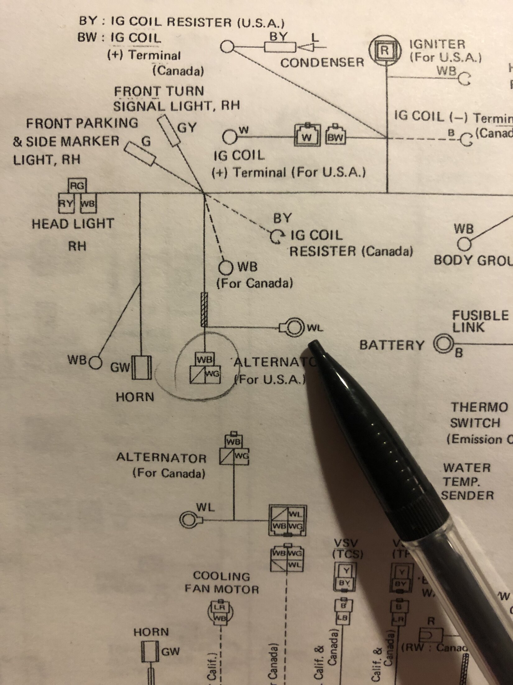

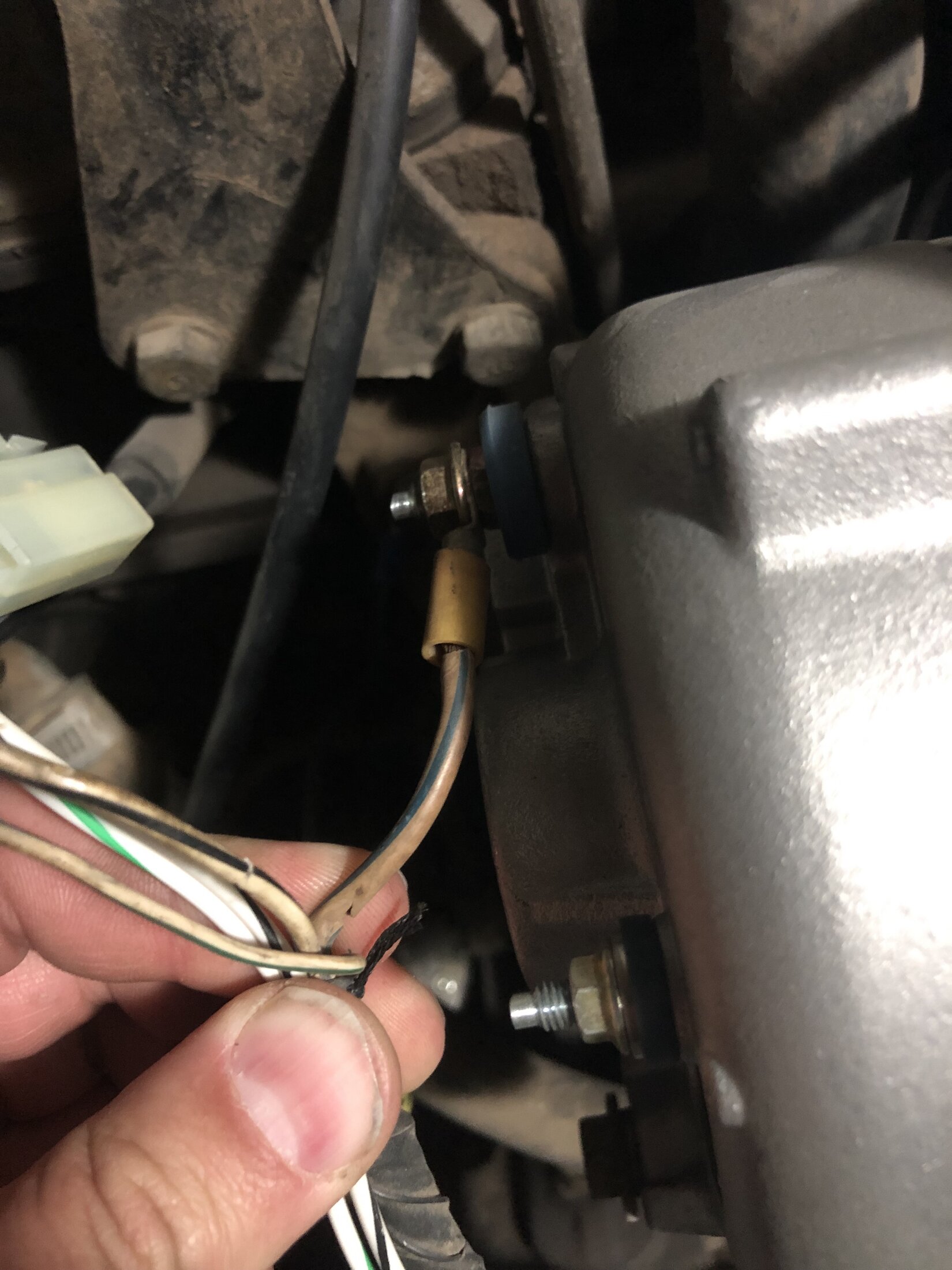

I have new results. I disconnected the alternator a few days ago. Then forgot and drove it today and it started right up. I was headed to a car show and didn’t realize until half way threw the day! So I am now looking into the alternator and the last remaining wire that I haven’t replaced. I need to figure out where the other end of this wire is connected to. It’s a thick white and light blue (WL) from the alternator.

Ok! I believe I have found it!!!! Oh my lord I think I’ve found it! My draw is currently .276. If I pull the plug off of the alternator, the draw is still .276. But if I pull off the white/blue terminal lug off, the draw drops to .032! I finally found the wire on the schematics. So I connected the white/blue wire back on the alternator and I pulled the white off of the fusible link and the draw drops to .003. I believe I need a new white/blue wire from the alternator to the ammeter and possibly white wire from the ammeter to the fusible link? What is the possibility that the ammeter would cause the draw?
