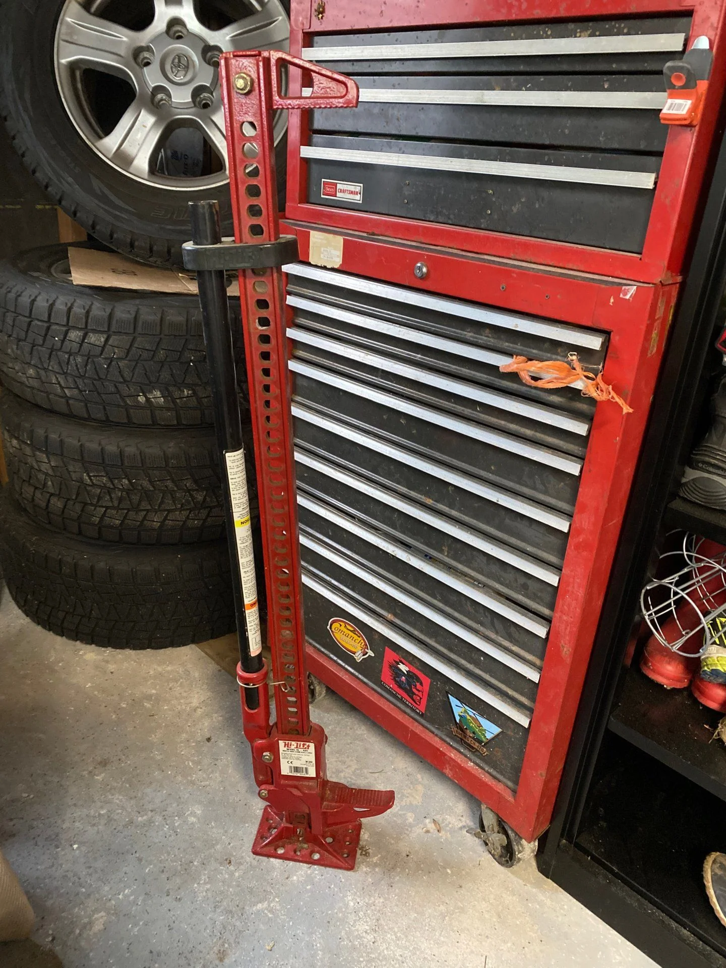

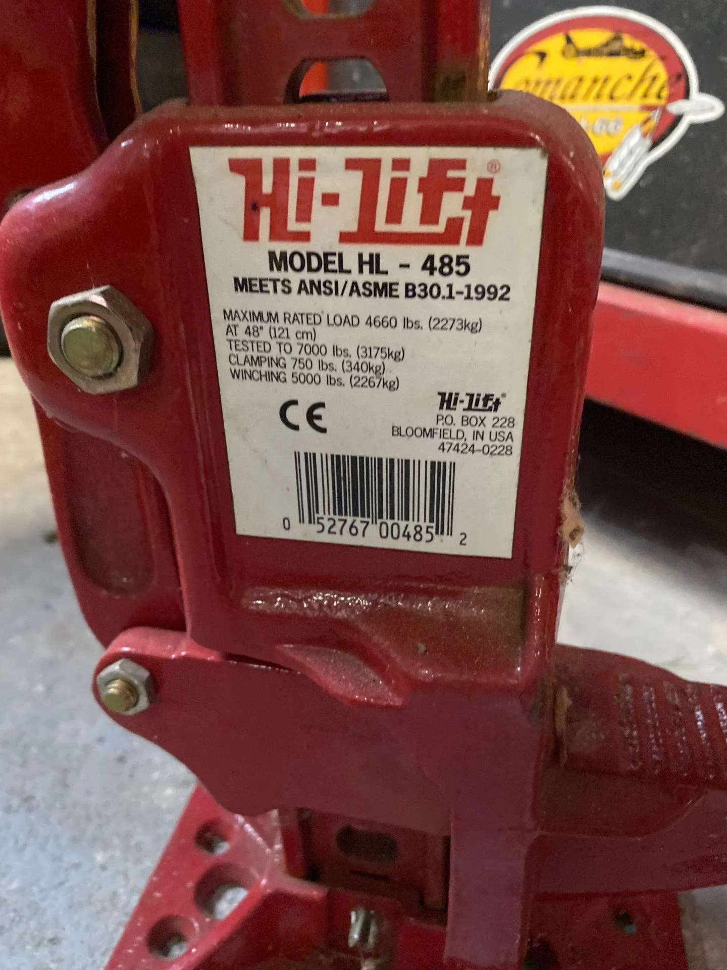

Local buddy of mine is selling this for $50. He’s in west Chester, but would gladly store and/or aid in delivery within reasonable distance.

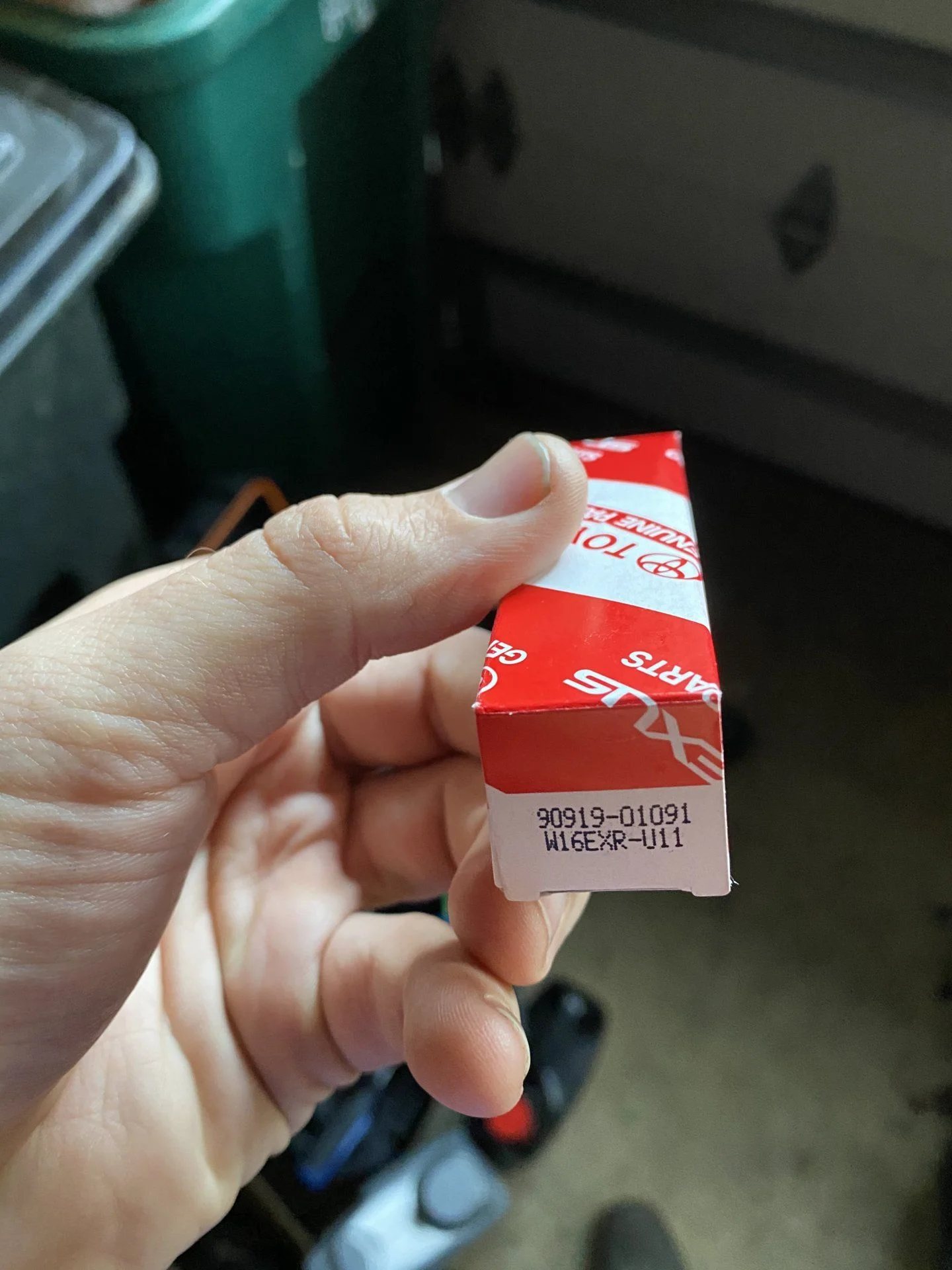

I have a FREE set of Denso OE plugs for a 3FE / FJ80. They were sent to me on accident when I ordered some tune up parts.
Figured they should go to someone who needs them instead of in a drawer
