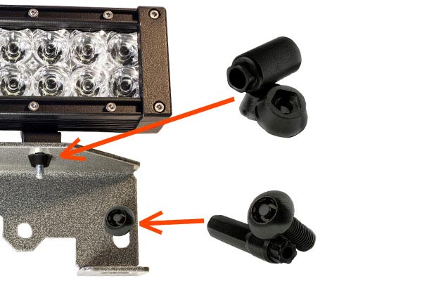

I used a c-channel with square nuts on my Rigid as seen in my picture below. For the mount to the truck itself, I used a stainless allen head screw and drilled the center out. With a lock washer, it tightened up nicely from the backside where no one can get to it easily.
Any and all ideas are appreciated...

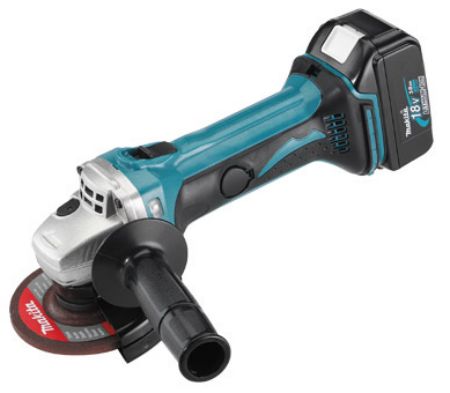

If you protect the bolts that attach to the mounts, someone could just cut the mounts off. It's the lights that are expensive. The alu mounts will cut like butter with an angle grinder.

Um, what about the tool in the above picture?

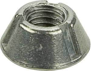

Yea, I know. The tri-groove nut is the best deterrent in this thread.
