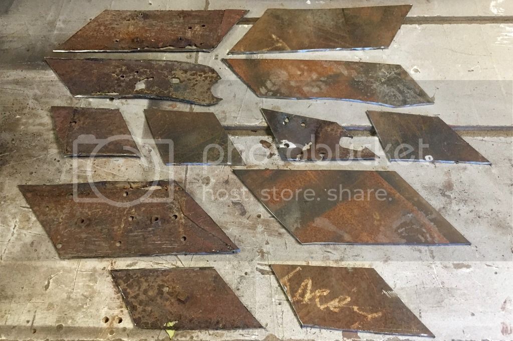

- Frame repairs and upgrades, including 6 body mount brackets, reinforcing weak spots, and drilling drain "mouse holes" for washing out dirt.

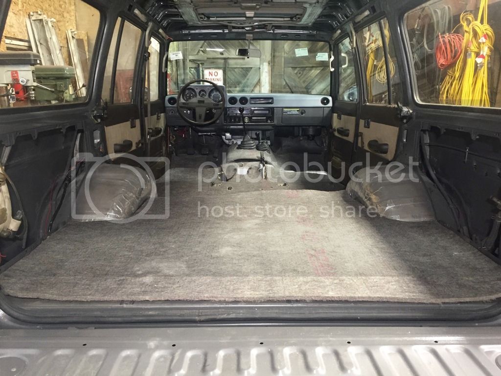

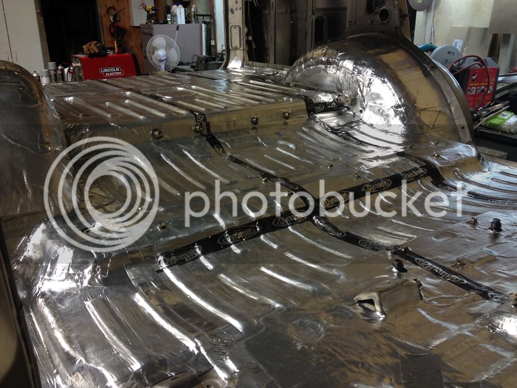

- Dynomat the floor after removing OEM brittle material.

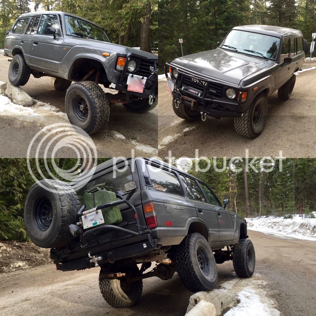

So, without further ado, a few before and after pics and then some shots of the process. I think I have around 900 pics of the entire job...

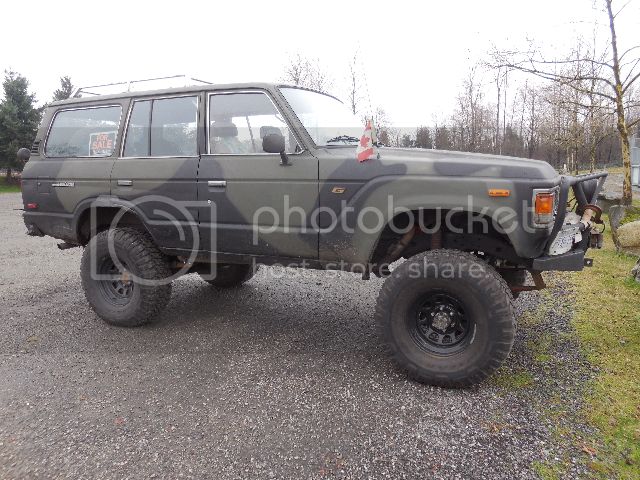

This was right around when I bought the truck just over a year ago.

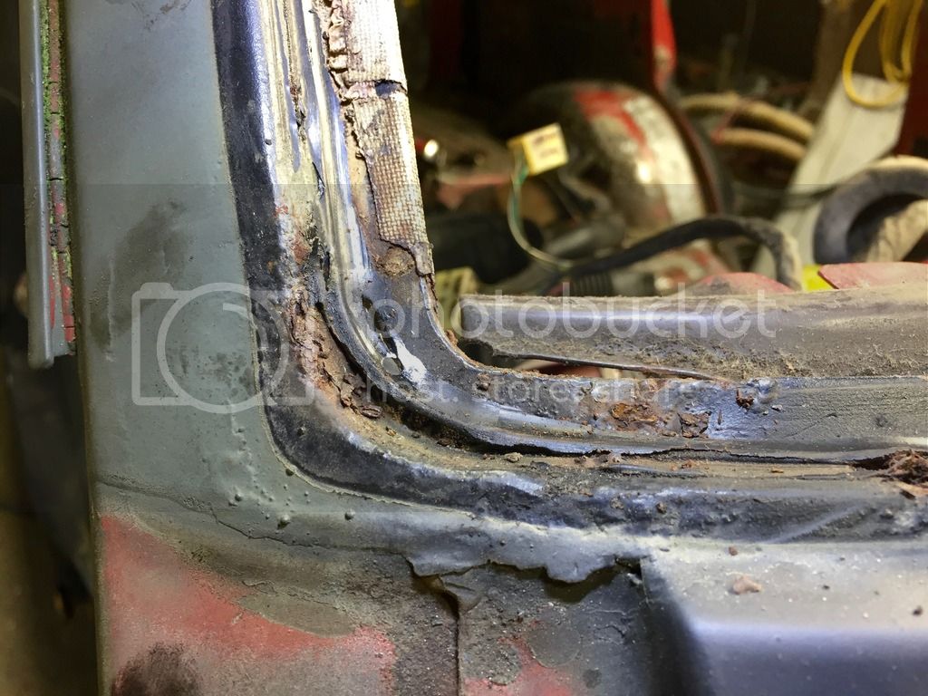

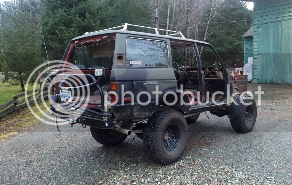

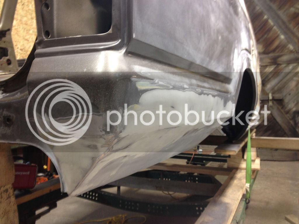

Some of the rust and patches on the old Camo body.

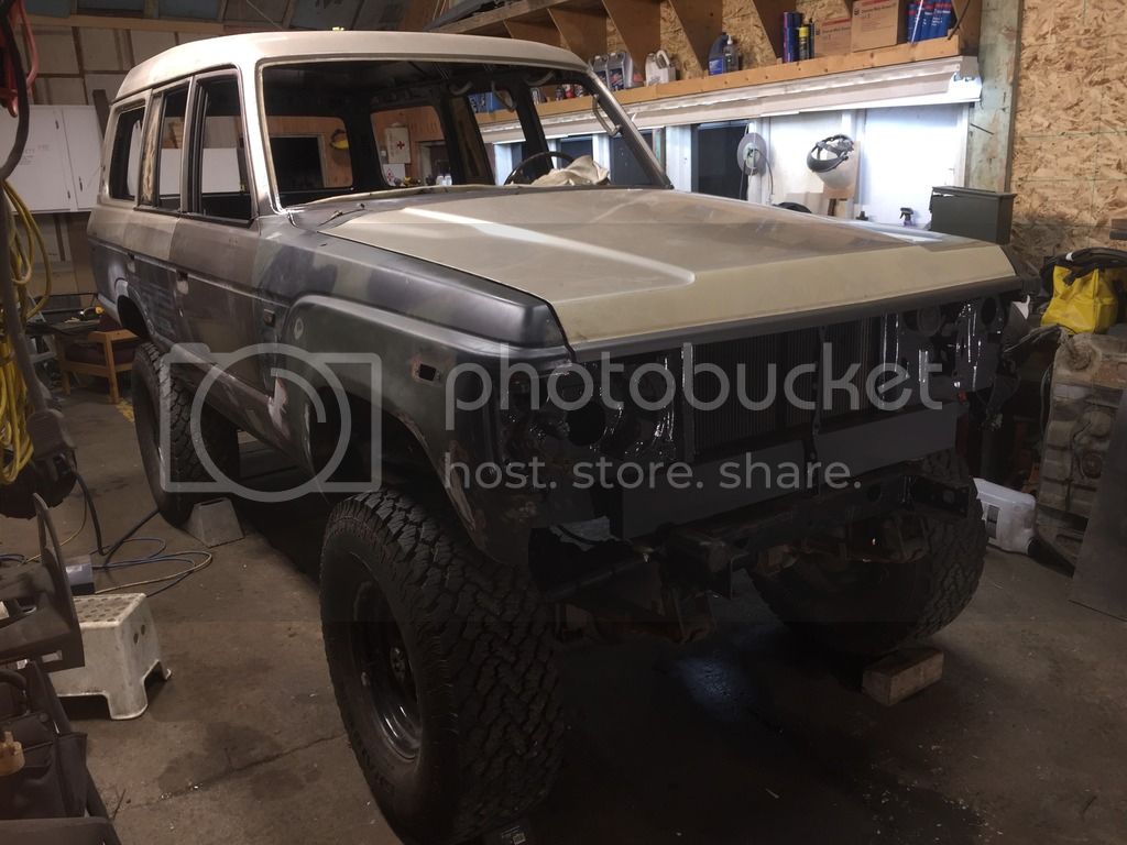

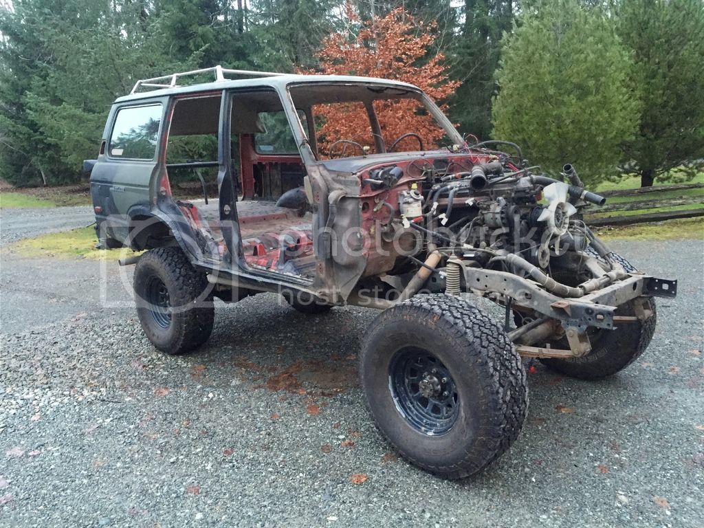

Rippin it apart...

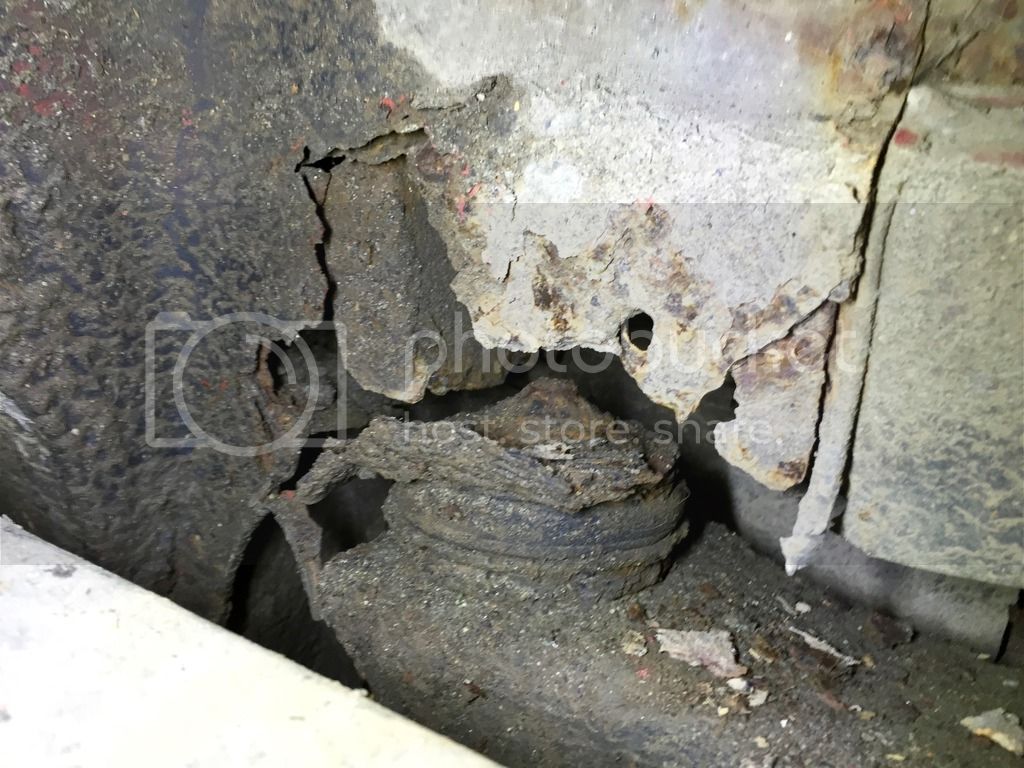

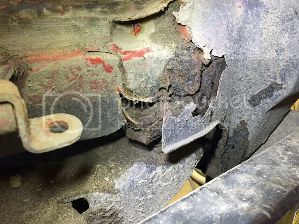

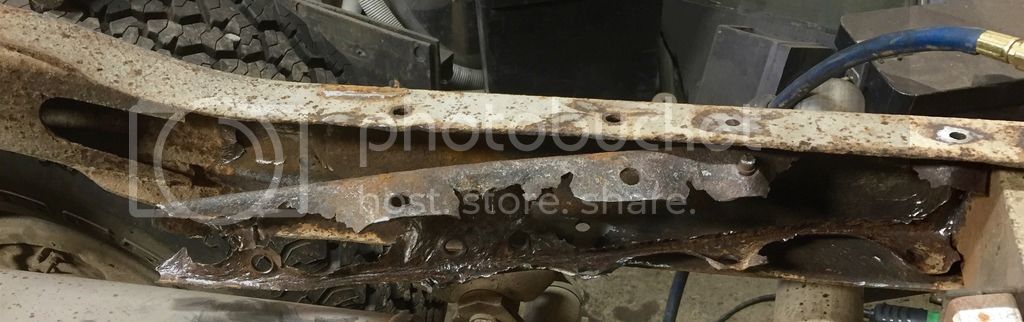

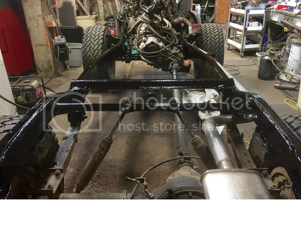

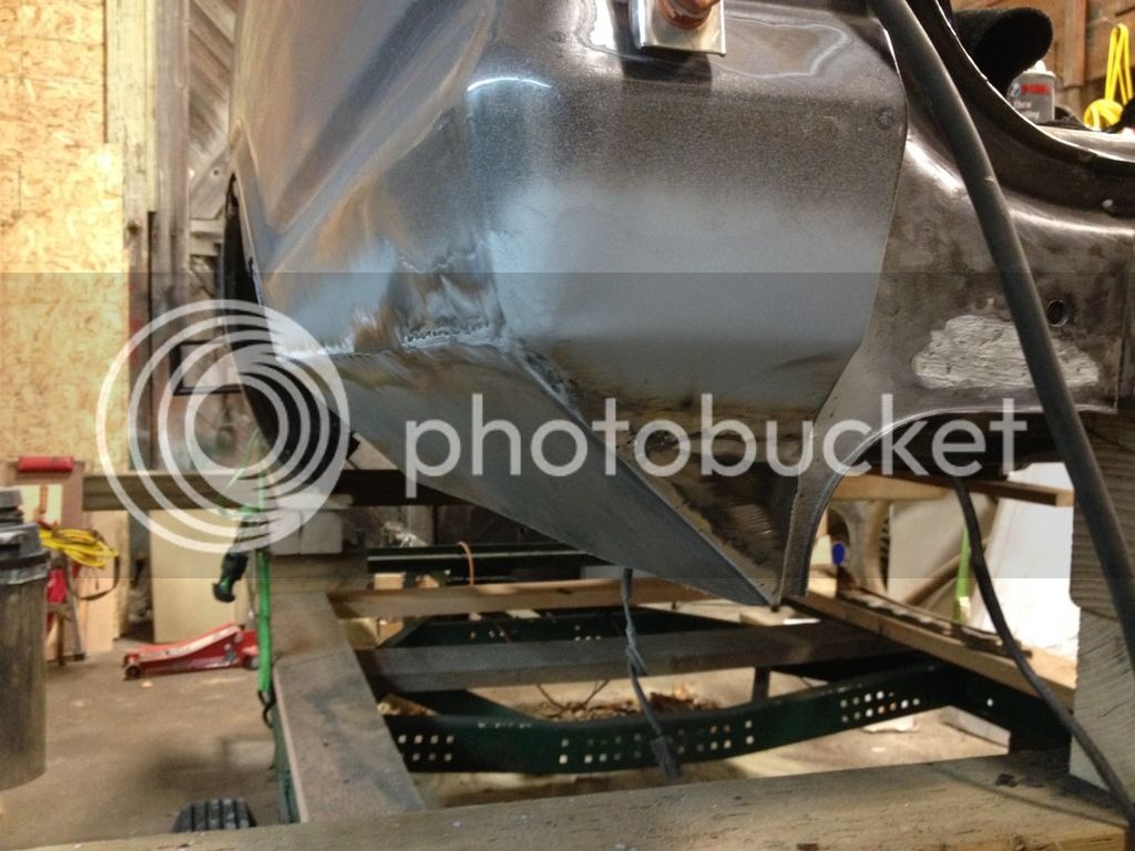

Frame rot, inner rear.

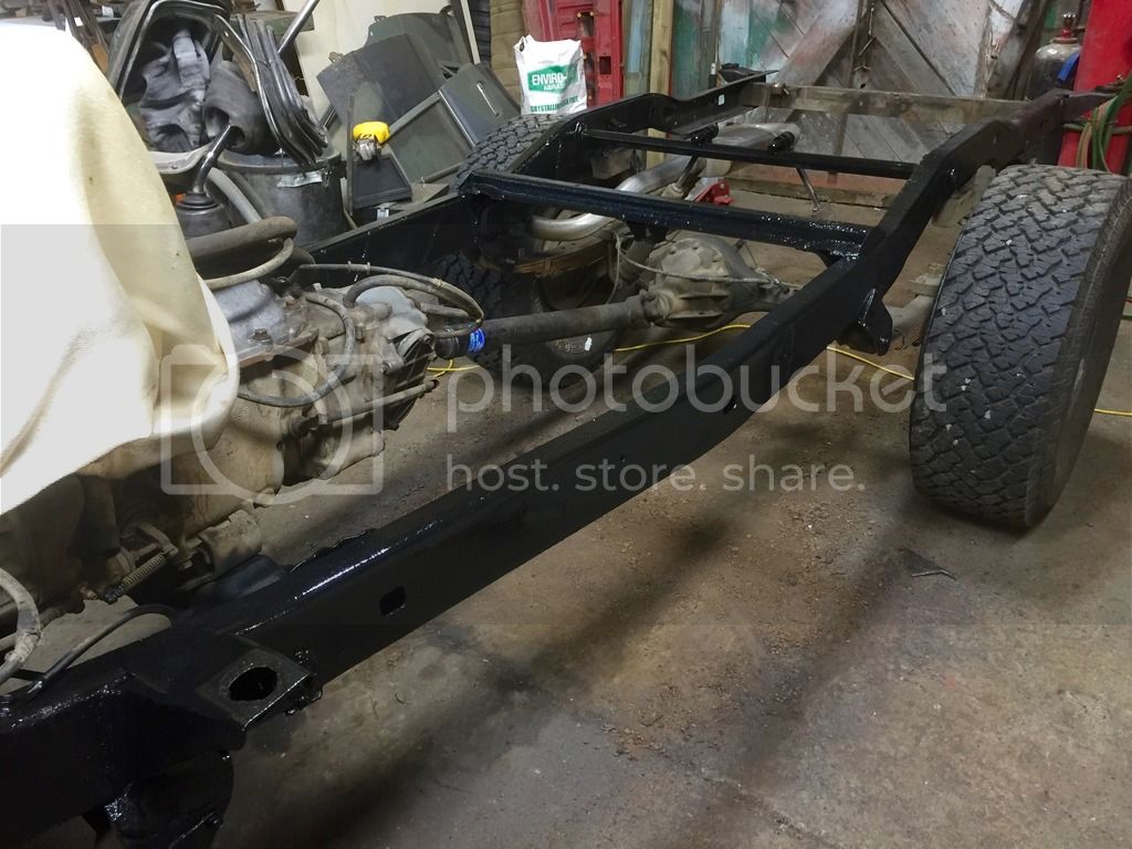

Frame repairs completed. Primed, 2 coats of gloss black, then asphalt coated.

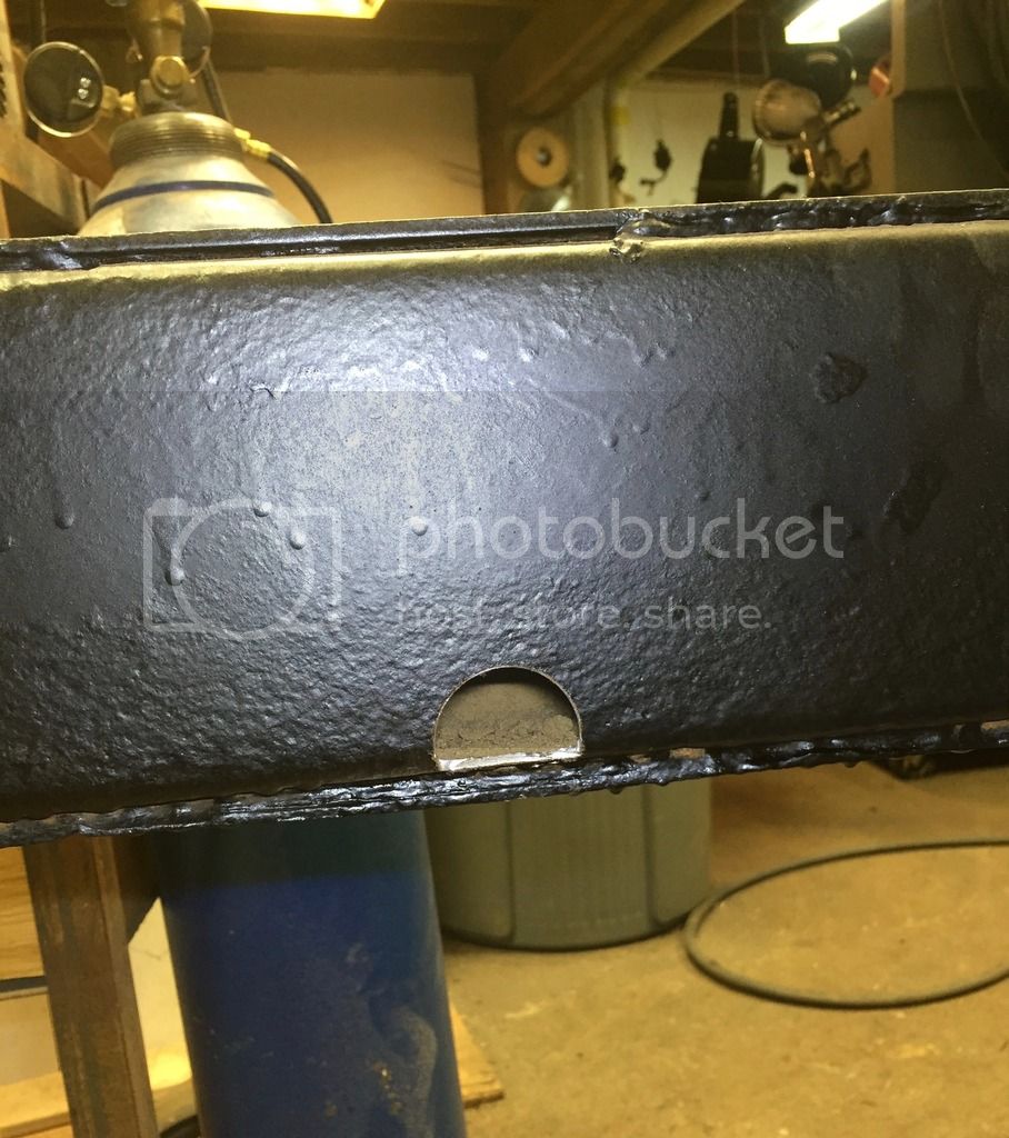

Frame "Mouse Holes" for better drainage.

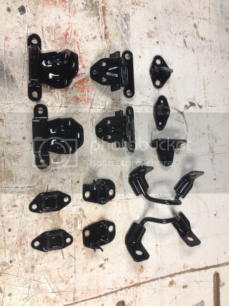

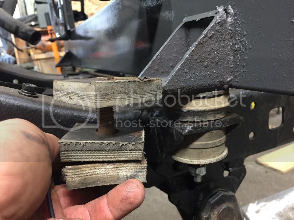

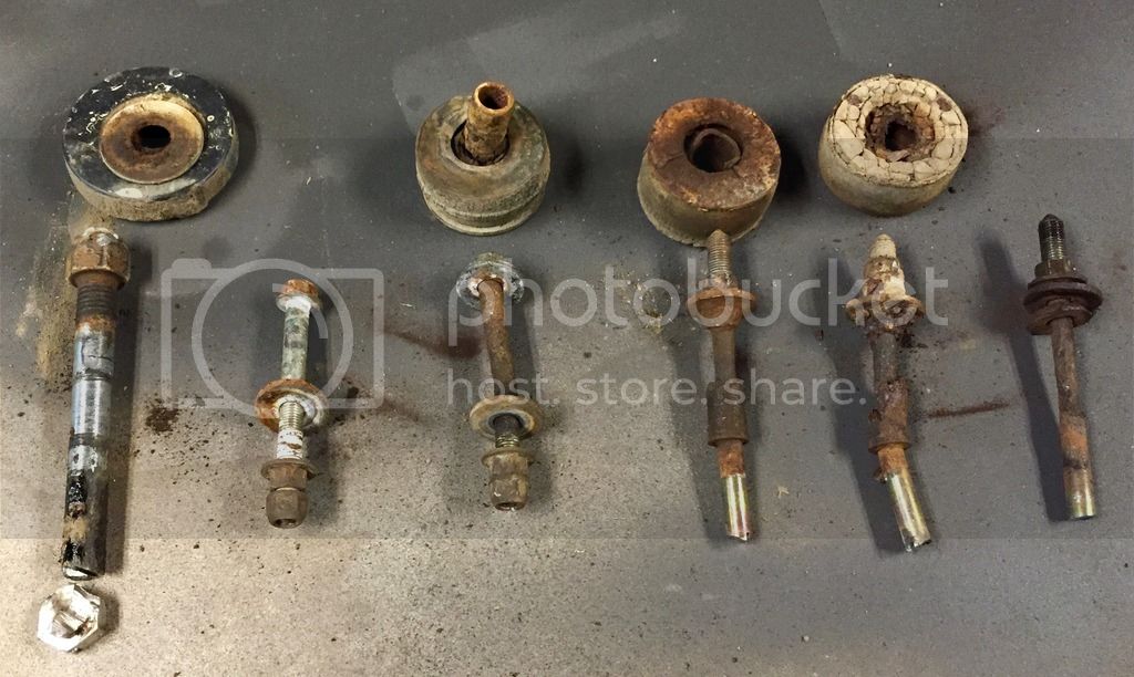

Body mounts: Old and new

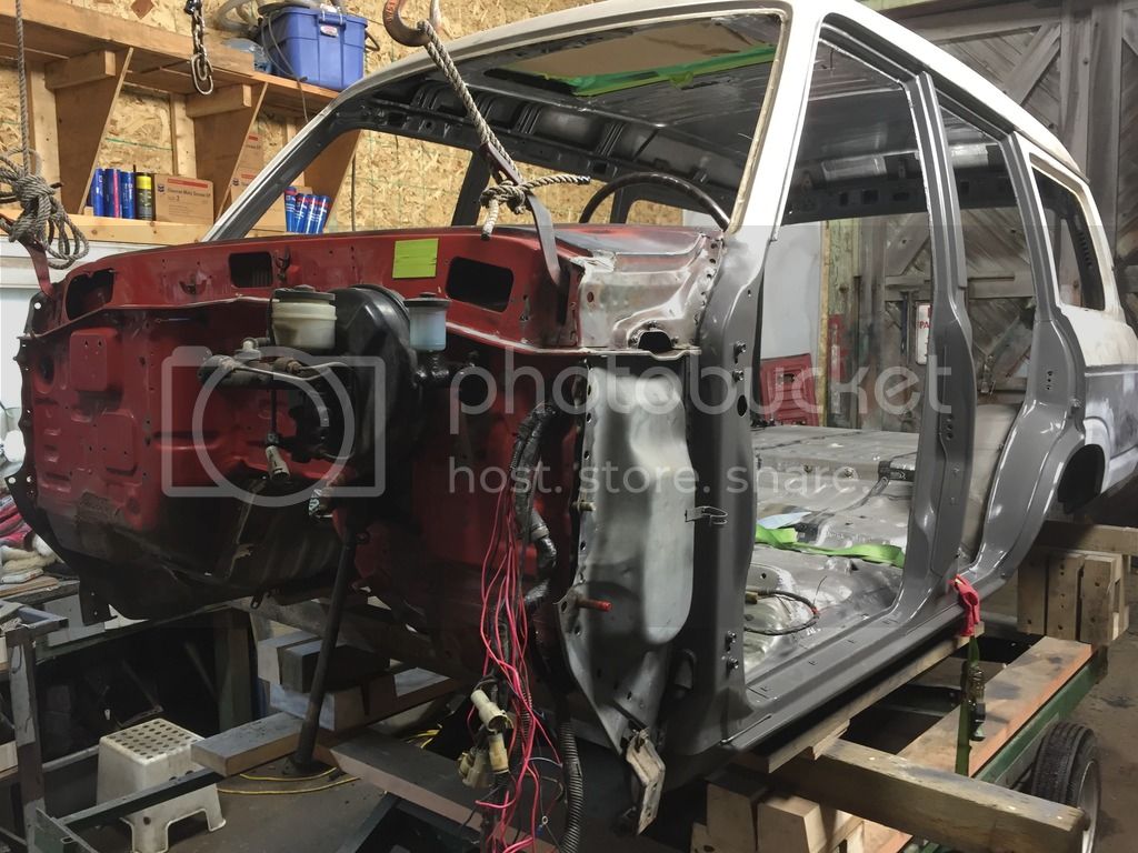

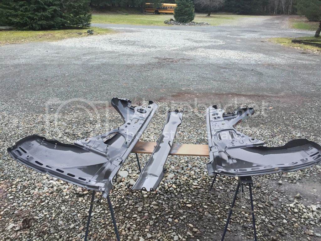

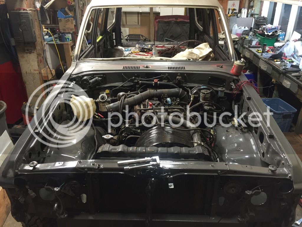

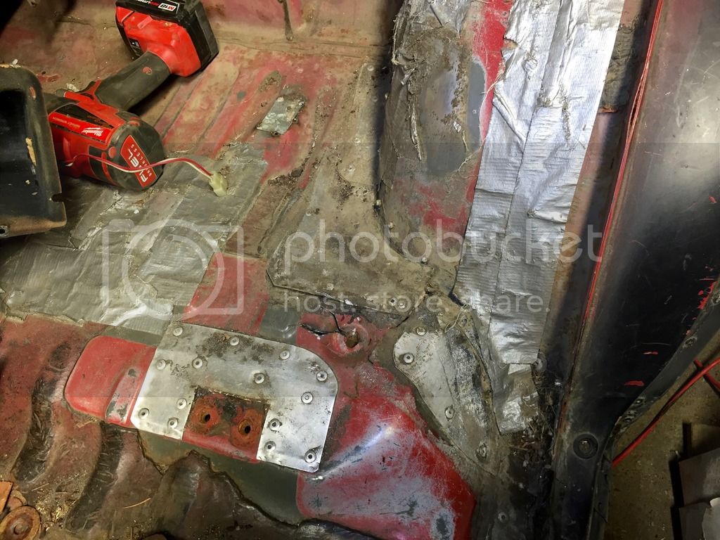

Firewall work

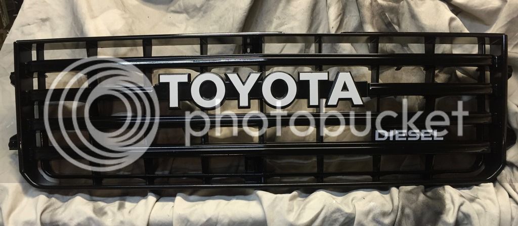

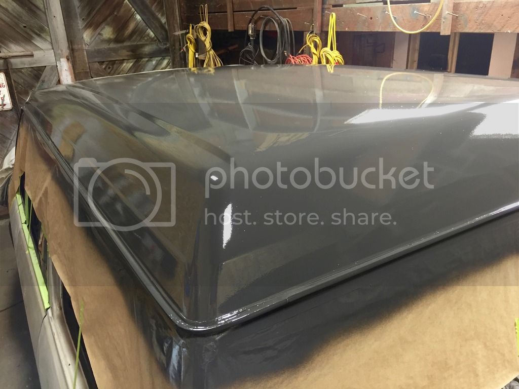

Stuff repainted:
Rippin it apart...
Firewall work
Stuff repainted:
