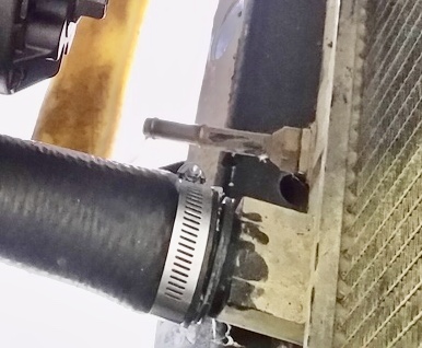

Hose just fits, I had to trim a lot of the original but got it to fit with out rubbing anywhere.
Lower fits well.
Do you have the part numbers for the upper and lower radiator hoses? Are they just the OEM Dodge hoses?
Also, did you have to use a reducer for the Dodge upper/lower radiator hoses to the Toyota radiator inlet/outlet?
The Dodge hoses have a larger diameter than the Toyota radiator inlet/outlet.
Most of us are using custom thermostat housing with water neck that matches Toyota. The accessory rail had the lower that matched Toyota. On my new build I am using an updated accessory rail that is all steal instead of aluminum. I will use reducer for upper hose.
Thanks! What do you do for the lower hose? Use a reducer?
