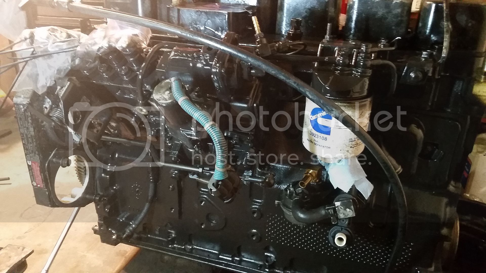

Well today I actually felt like I was moving the right way. I got the pump all cleaned up and painted. New O ring on the front to seal the timing cover and pump. New fuel line seals and other bits.
I also painted the side of the block and side of head that never seems to get any from the factory. Replaced the seals on the lift pump and the pre filter. Eliminated the fuel heater since it was non functional. Think I covered that already but post it again.
Couple poor quality pictures, I have to say this Cummins paint is kick ass. Goes on nice and smooth and is dry enough to work with in 30min.

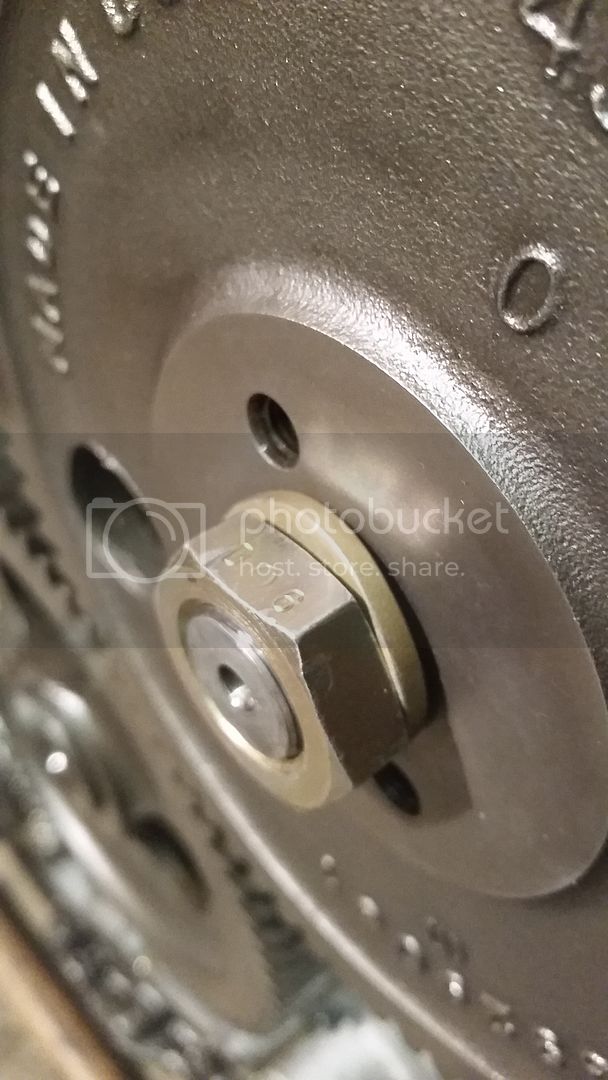

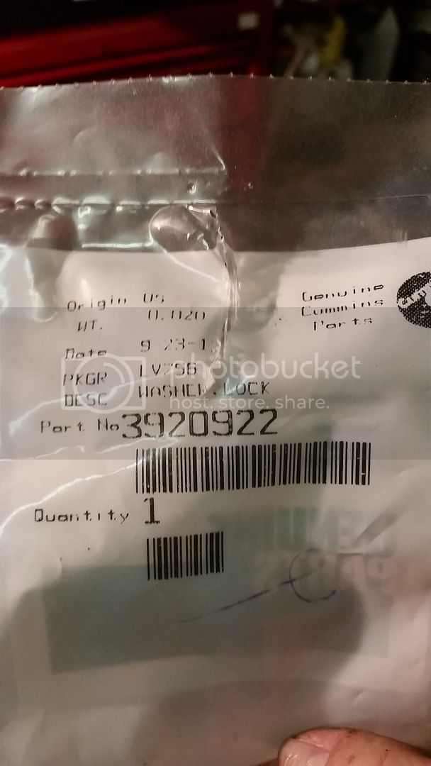

Never re time or take the pump gear off with out getting a new lock washer.
New lock washer installed but not torqued.
Ready to torque when I have the snap on parts to change the timing. I have it pin timed for now.
I also got a few other parts painted and have a whole pile to do still.
All I need to do on this side of the engine is get the vacume pump rebuilt and mod the power steering pump for more flow and pressure.
I also painted the side of the block and side of head. I have to say this Cummins paint is kick ass. Goes on nice and smooth and is dry enough to work with in 30 mins.
