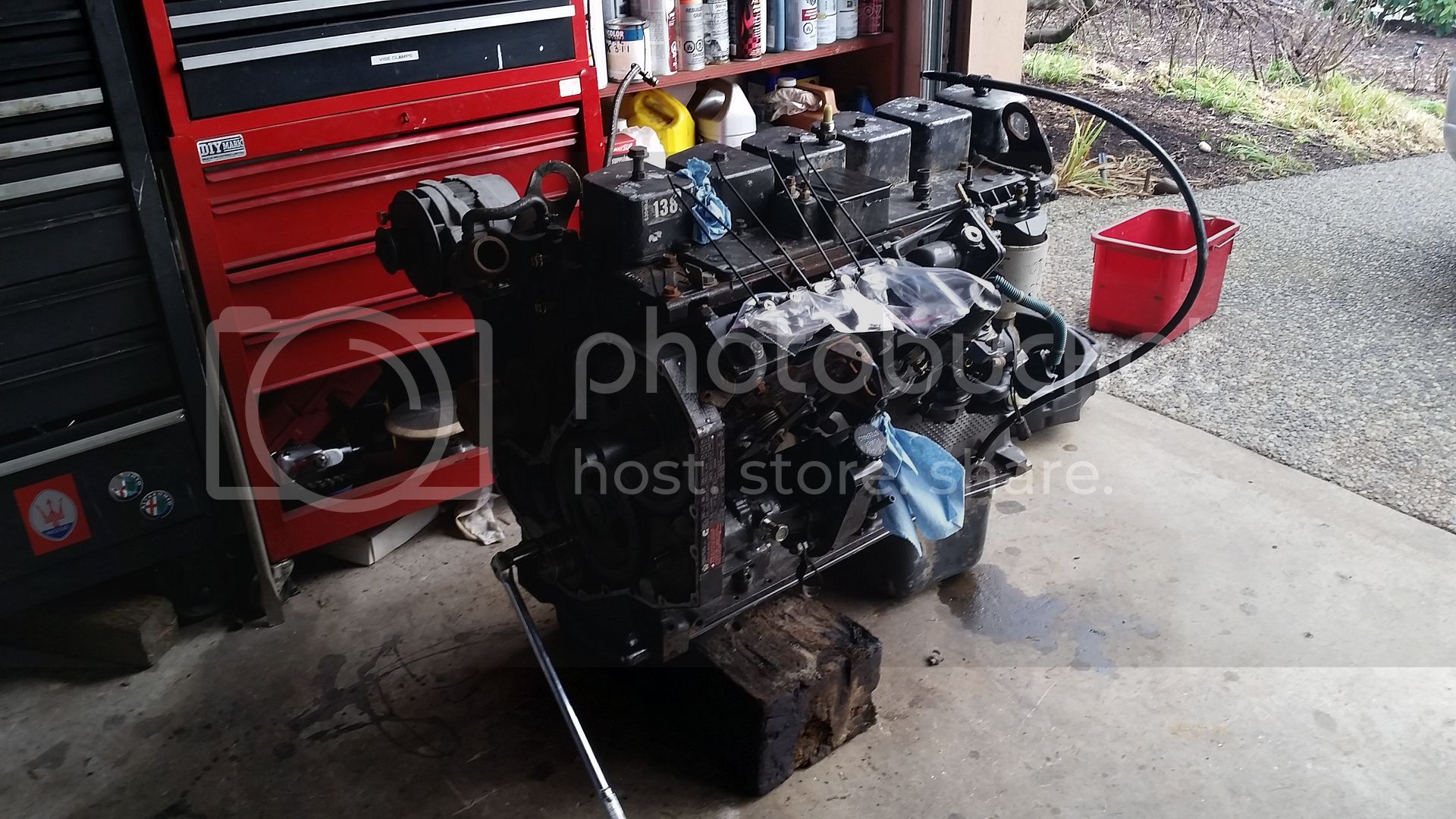

Anyone want to guess what I did today?

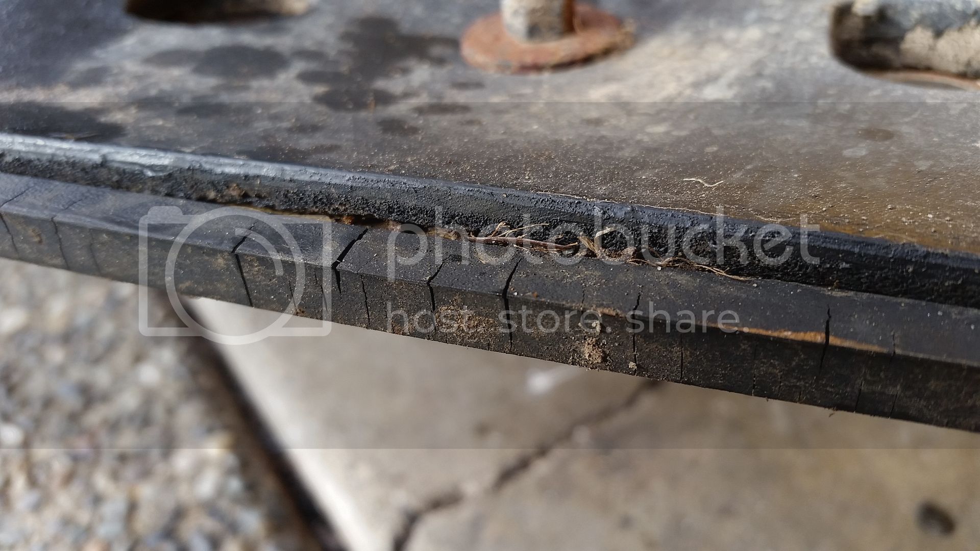

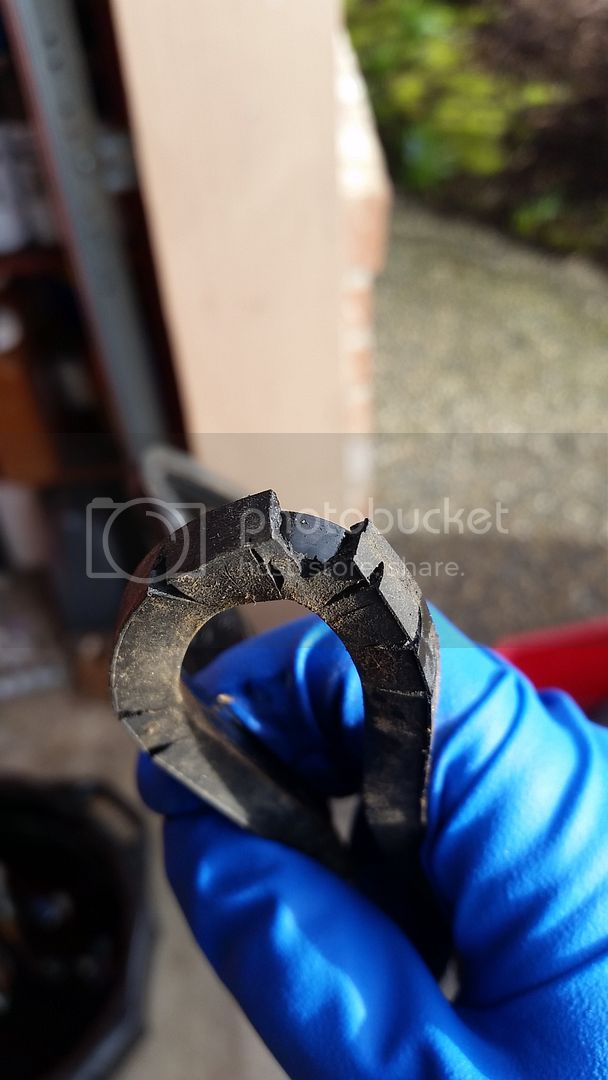

Decided to change out the side cover gasket and grommets. It's just one of thoes gaskets I would have absolutely kicked my self for not changing if it split. After starting on it I was happy I decided to do it.

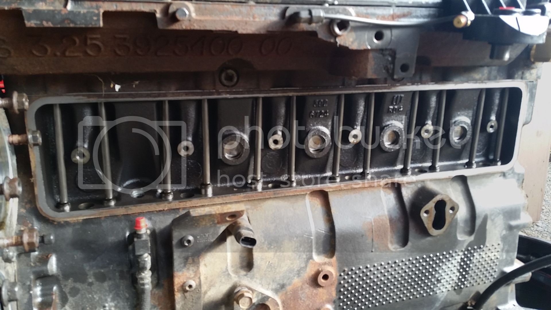

Clean like new inside. Supper impressed with how clean the inside of this engine is.
Yep glad I'm changing this.....

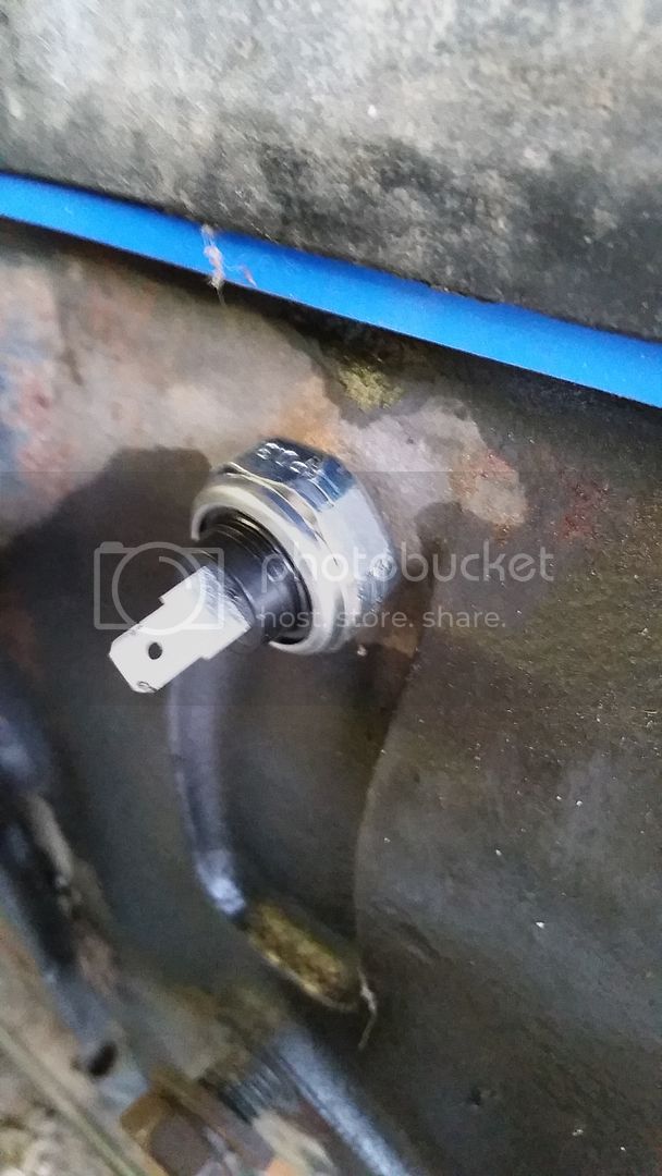

I also installed a Toyota low oil pressure switch in place of the factory Dodge sensor. I am wiring this to a low oil pressure light and buzzer.

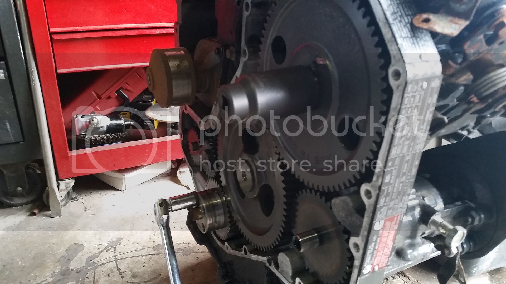

Taking off the injection pump was a bit daunting. I found that the pump timing had slipped at some point. When the engine was keyed at TDC the tab in the pump was barely visible in the little side window. I would guess it's about 3mm off where it needs to be apparently it's 1.5deg per mm. So it was about 9.5deg. I will re time it when I re assemble. Hope to set the timing at 15-16deg up from the spec 13.5deg. Dont want to loose cold weather starting but would like to gain some MPG's.
I did not want to get this far into this engine but it needed to be done and I'll feel better knowing it's done.

I like your idea for a low oil light/buzzer.
Honestly anyone running this engine should have one. I have seen more than a few pump there oil into the coolant and seize weather it was a head gasket that failed or a oil cooler.
I have blown two toyota diesels very quickly by loss of oil, first one lost a drain plug, second one the axle peirced the bottom of the oil filter...I don't want to go through that ever again.
Have you determinds what you will use for the warning indicator? Any reason you replaced the dodge sensor with a toyota one?
I have, I plan to use a simple LED with a built in buzzer. I was actually going to wire it up to a kill switch that would kill the engine. Issue with that is if it killed it in the middle of a left turn or something. I used the Toyota sensor becouse it's a simple grounded switch. The Dodge one was two wire and I did not want to try and sort it out.
Do you have the part number for the sensor you used? seems like a fairly simple, yet invaluable addition. I like the way you think.
Why not run it to the factory low oil gauge on the instrument cluster?
I want something I can't miss, I will also have the factory oil pressure guage hooked up. It's not so much for me but others that may drive it.
