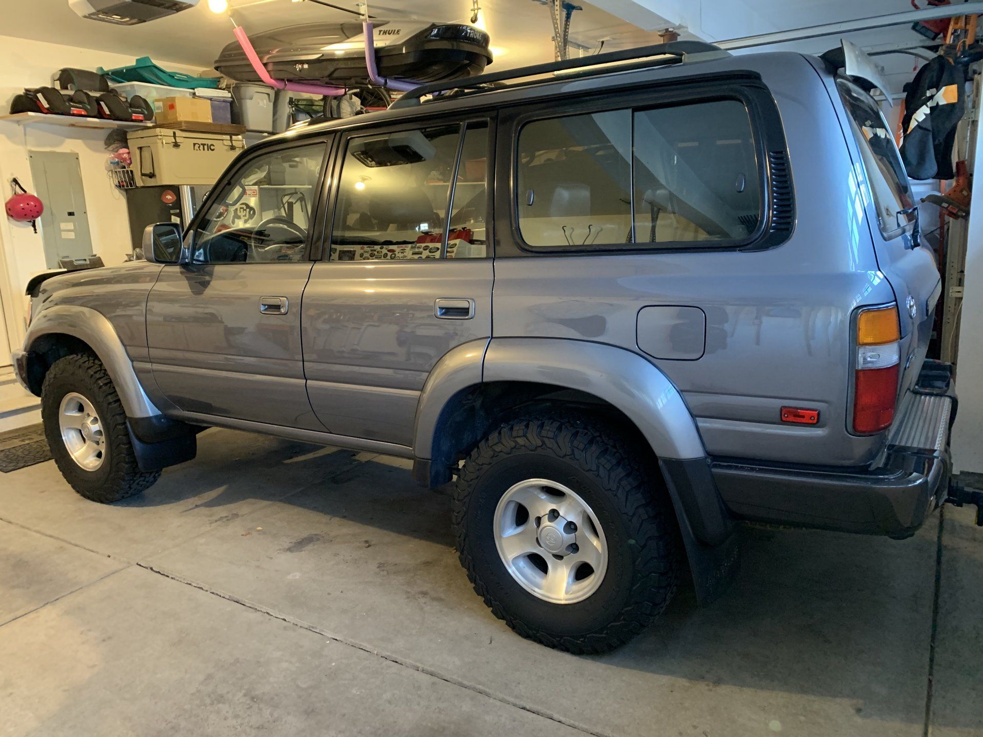

Last night I added the CDL switch. Super easy mod and will get a lot of use out of it. Updated some bulbs and put some liner in the 2 center console pockets so my stuff doesn’t rattle as much.
A couple updates...

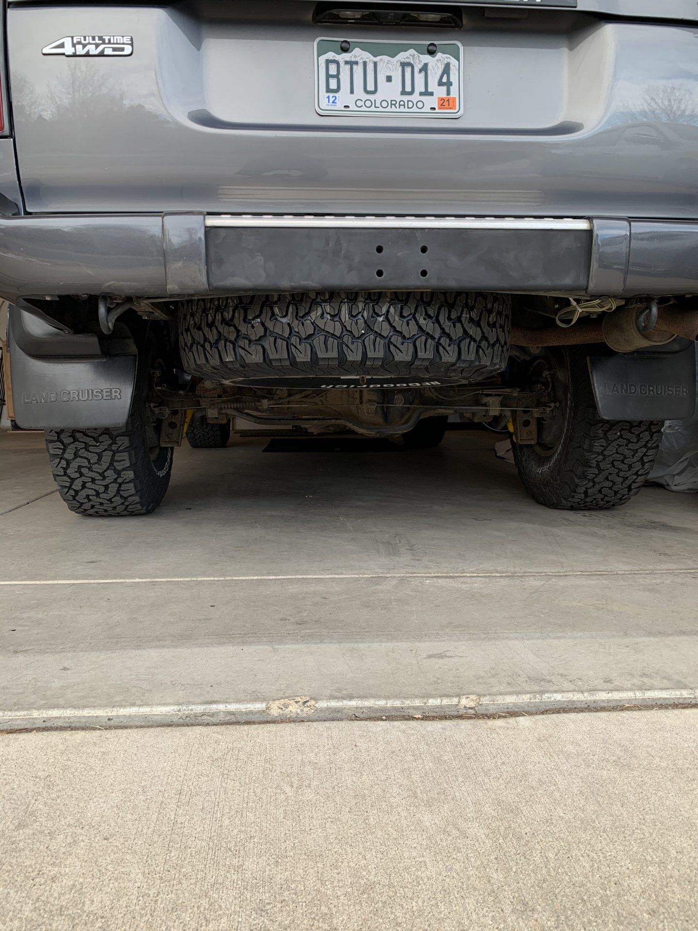

- Decided against a rear bumper so I bought Wits End rear tire leveling kit which worked out awesome and super easy to install. It moved the front portion of the tire up about 3” and gave a much cleaner look.
- Removed the tow hitch and got a hitch from manafre that fits in the stock bumper holes. Not planning on any towing just to put the bike rack on.
- Also did the auto up window mod which is fantastic... love this forum!
- Added oh s*** handle on drivers side top. Popped covers off and screwed it in.
- White Knuckle sliders on order. Removed stock steps in the meantime and installed some ome front mud flaps.

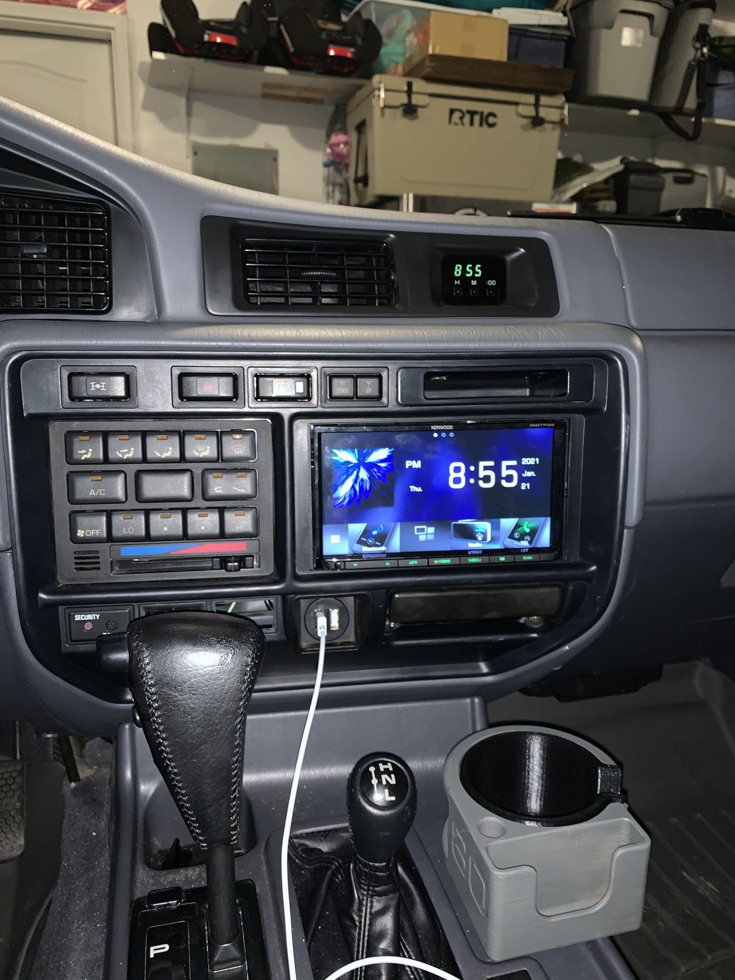

- Removed factory radio and speakers and upgraded to a Kenwood CarPlay stereo. Man I love CarPlay... crazy that my 80 now has it but not my 200...

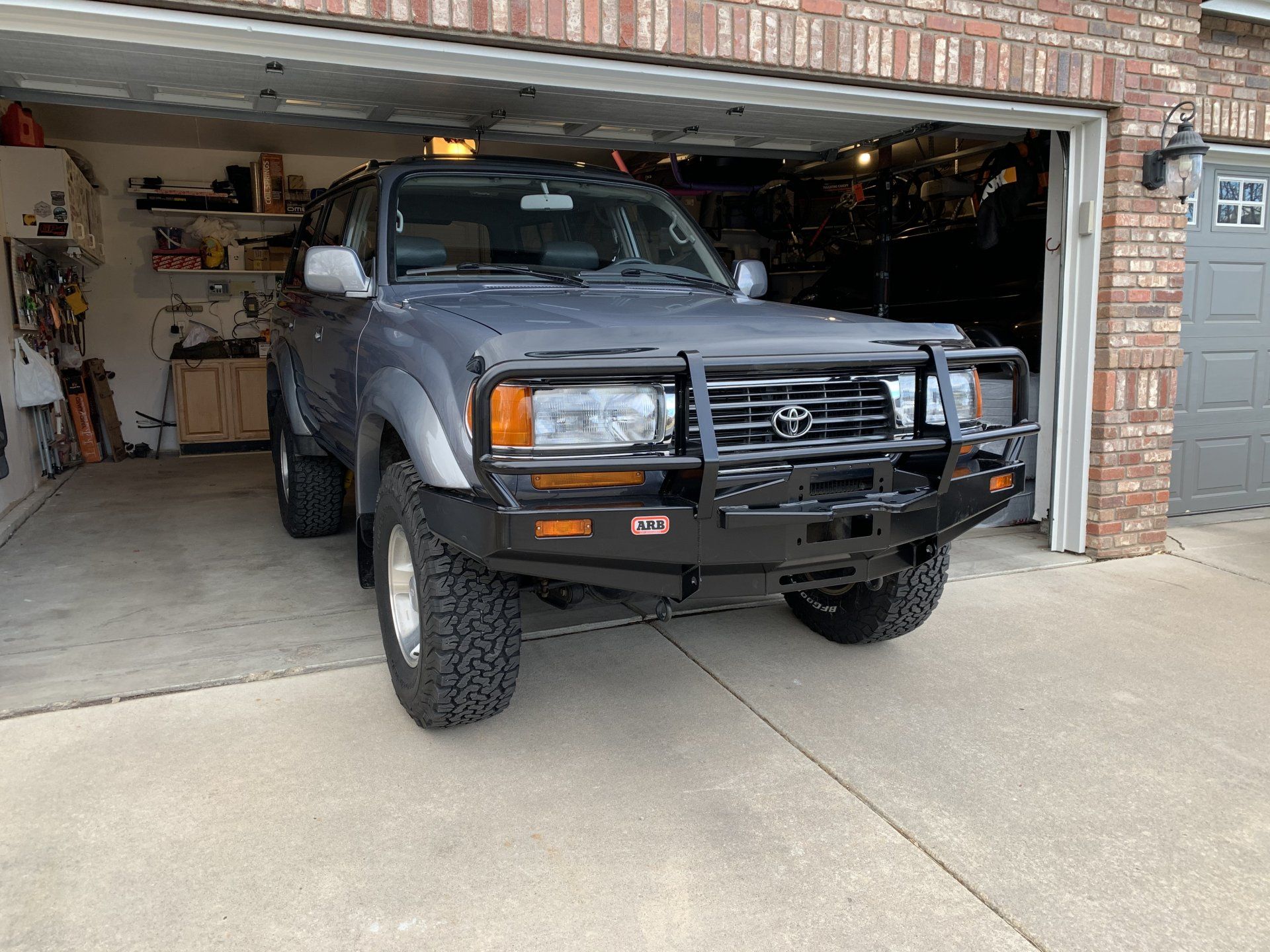

- Installed ARB front bumper. Haven’t decided on which winch to put on yet so just installed to free up space in the garage. Never needed a winch in all my years of wheeling so hard to justify a $1200-1500 come up or warn.

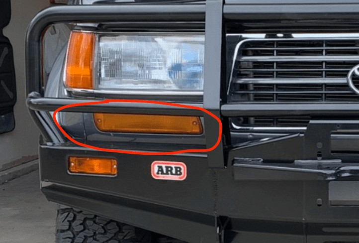

- ARB bumper wiring... for some reason the marker lights on the ARB and the 80 lights don’t light up with headlights on? They both work for turn signals so what did I do wrong??? Any suggestions?

A couple updates...

For the lights on the bumper just wire them to the running lights circuit.
Those lights aren't designed to light up with the headlights, turn signals only. Several mods out there on changing the operation of the lights. I used the MoGas Mod but this only allows the side markers to blink with the turn signals.
MoGas Mod - https://forum.ih8mud.com/threads/mogas-mod.121071/
For some reason I was thinking they illuminated amber when the headlights turned on? If they don't and only light up when the turn signal is triggered then I got it right... These below:

I run the lights in my ironman bumper as running lights without problems. Granted they are LED not incandescent.
