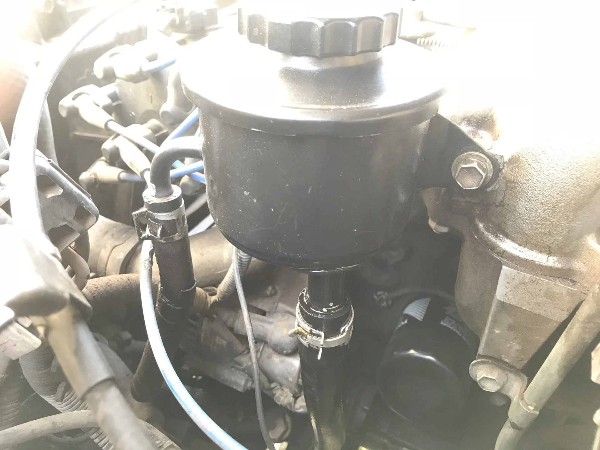

PS leak-I wiped off a huge amount of grime and PS fluid off of the reservoir when I brought it home. So far the only leak I can see seems to be coming from the larger hose which I believe is return hose. It's just a slow seep at this point.View attachment 1649969

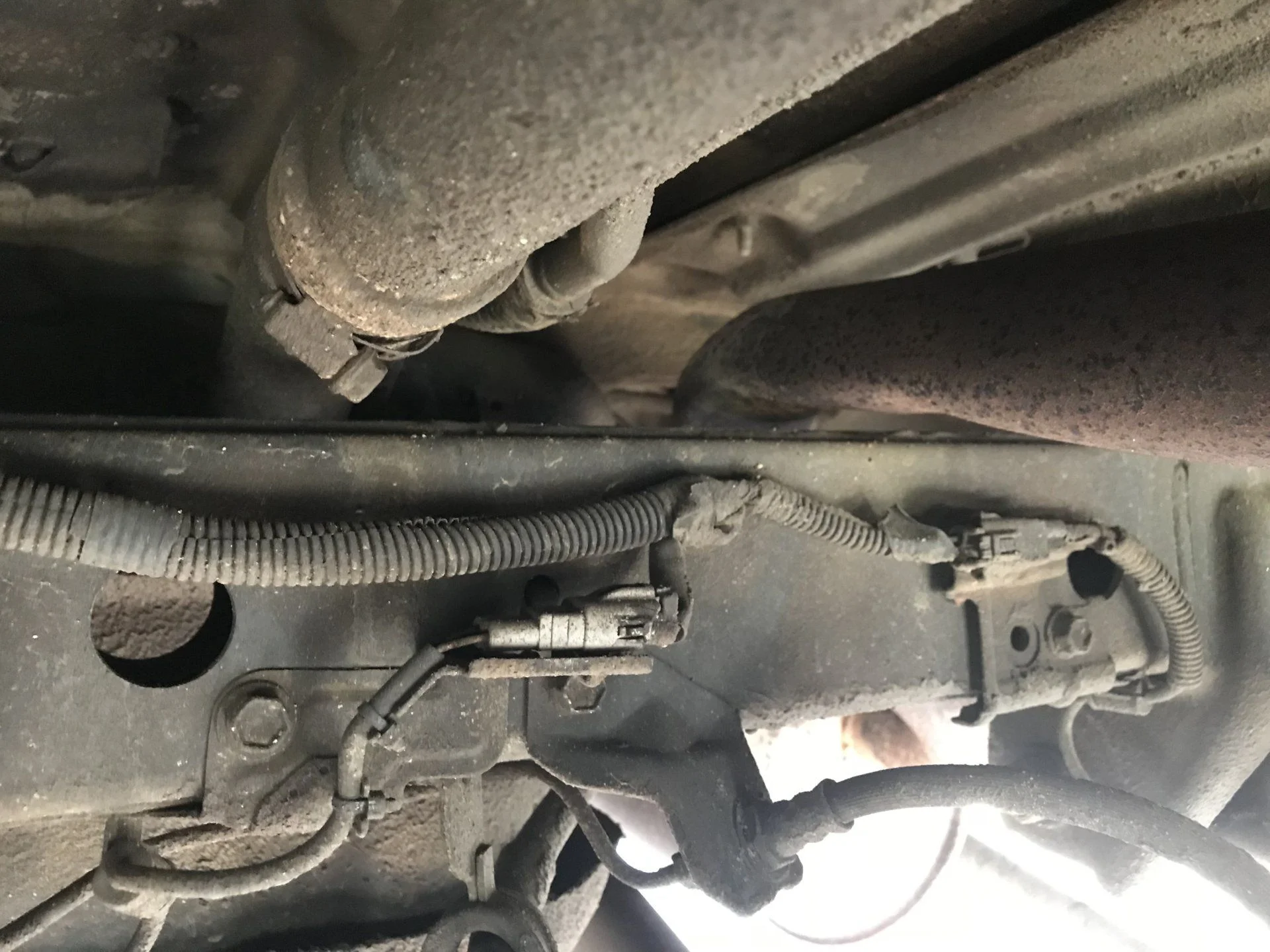

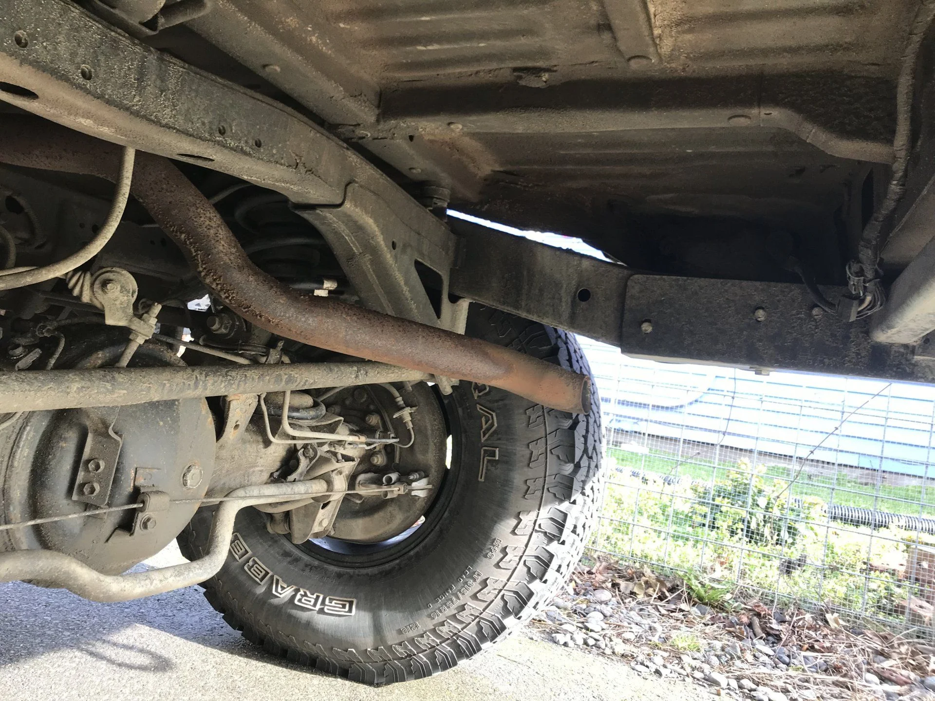

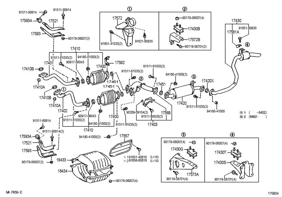

The exhaust hanger you show in your photo and bracket are missing, as is the tuner. The shop that installed the bumper elected to cut if off IIRC what the PO said. When purchasing the vehicle I attempted to contact the shop in Bend, OR that did the work, but they never got back to me. Needless to say seeing those things missing without a solution to secure the tailpipe is a little concerning. View attachment 1649971View attachment 1649972
The whole thing is loose and that sucks. It needs attention. I’m sure that the deformed tail pipe isn’t helping performance at all. Im not sure where the last bracket connects-is the bumper obscuring mounting holes? I'll search for a photo later...
It looks like things are not connected properly from point 3 or point 4 in the below diagram. rad.View attachment 1649977

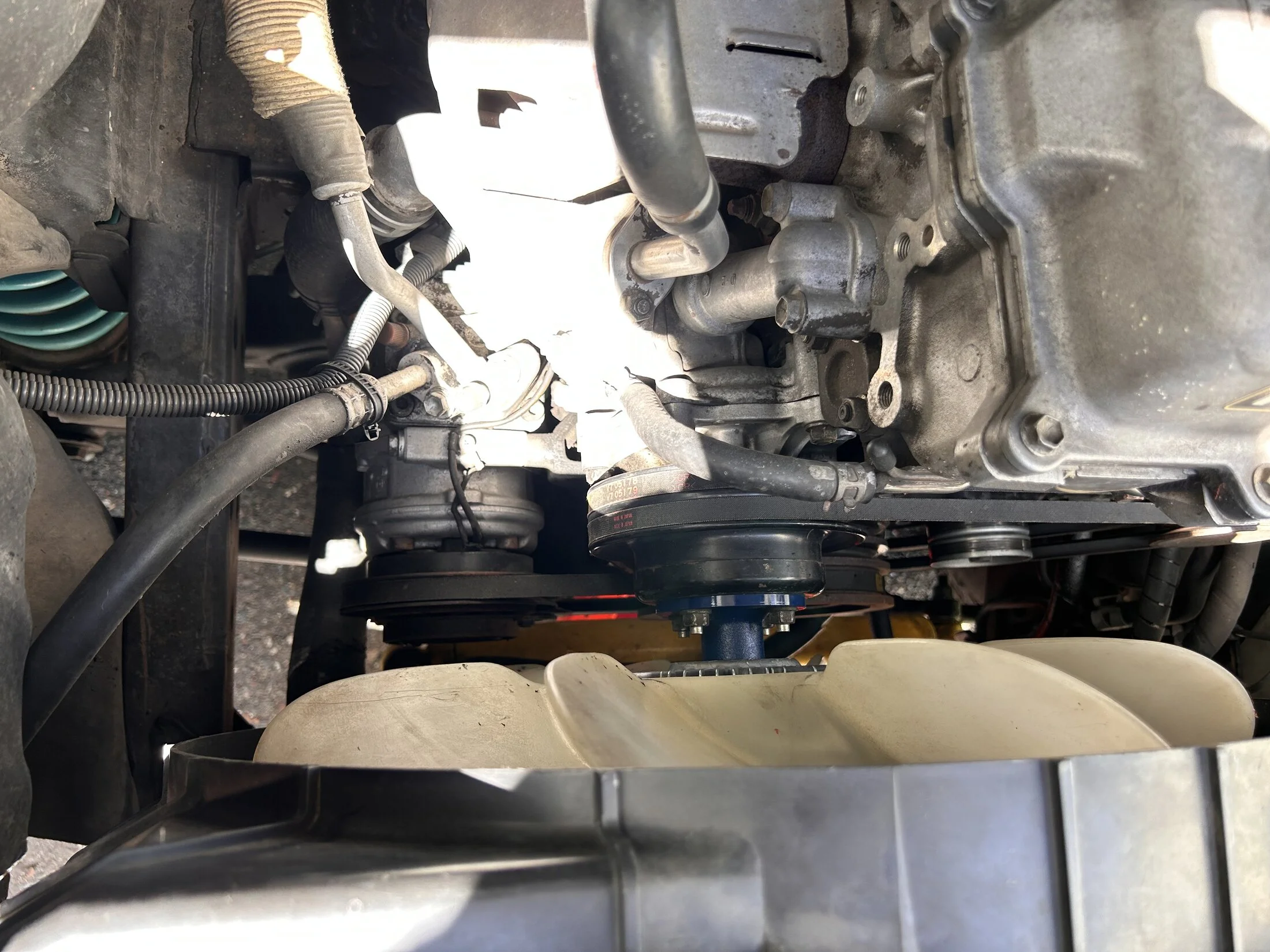

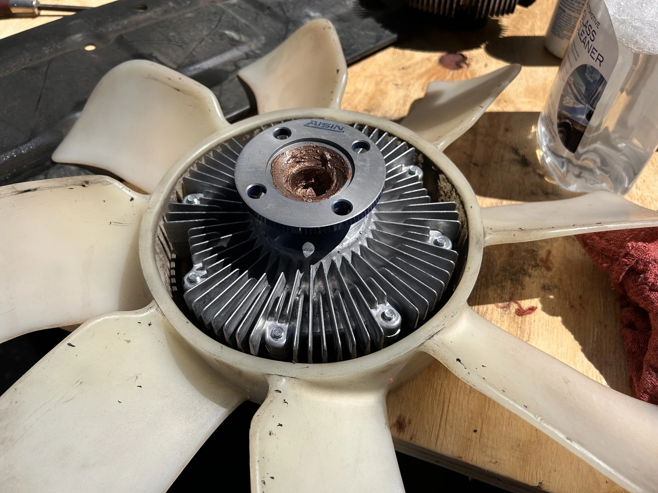

i then removed the fan clutch. First I loosened the four nuts retaining the clutch hub. I used a brass drift and a small hammer to gently tap it loose from the water pump. I stuffed a piece of cardboard between the fan. Las and the radiator and left the nuts partially threaded so nothing could go flying. Once loose I passed the fan between the radiator and the shroud by removing the two bolts at the top. My “nipple guard” had to be pryed up a bit to release the shroud. I may need some new tape to secure it securely again.
Once out I removed the fan and cleaned it off. I then secured the old fan to the new blue modified hub from @landtank and put it all back on the cruiser with a dab of anti size on the hub mating surface (I’m still scared of MN).
Tada!

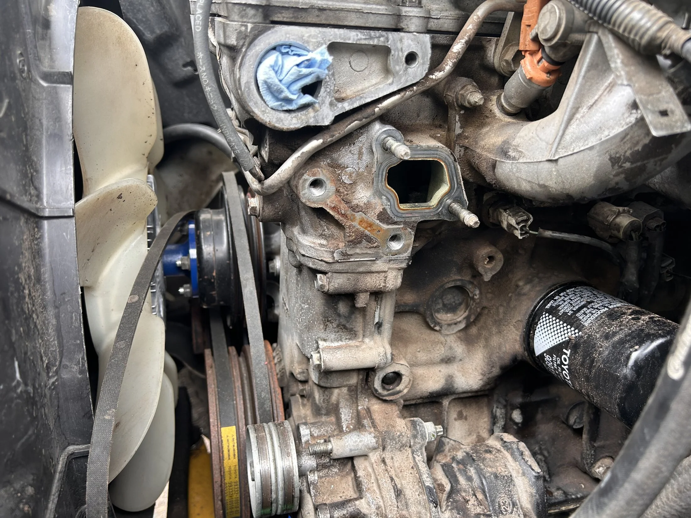

So I did end up pulling the water inlet pipe to drill and tap for a little aux gauge. I no longer have a drill press, or a vise, or a work bench. So given that I was doing this on a wobbly piece of plywood on plastic sawhorses it turned out ok. I used some high temp thread sealant to guard against seepage. I dont have the gauge hooked up yet, but I'm sure it will either be helpful or highly distressing and distracting. We will see.
Here is a pic that shows the location of this project. To access this pipe I removed the battery, tray, distributor, alternator, and the alternator bracket. I had a bit of trouble breaking loose the alternator bracket, but I did eventually get everything to come apart without any carnage to bolts or studs. The inlet pipe nuts I soaked in penetrating oil (Kroil is the current flavor I like). I also picked up a new gasket for the inlet pipe at the local Toyota dealership.
While I should have spent lots of time cleaning this all up, I didn't . I just cleaned all the mounting surfaces up well and bolted it all up again as I was short on time and needed the rig drivable at the end of the afternoon. So in conclusion if I were to do this all over again I would strongly consider the mid hose temp sensor route. As far as drilling the hole out while the pipe is still attached. I can't recommend it. I know it's been done, but I made a LOT of metal shavings. I can imagine I would have caught most of them with some heavy grease on the bit and the tap, but it would have been needlessly stressful, and I personally would have probably introduced a considerable amount with my limited experience drilling and tapping into a closed system like the 1FZ-FE's cooling system.
Finally, the new land tank fan clutch seems to be working well. I could't get the rig to overheat idling in the driveway, but I'll take it for a test drive to see if everything is working well and my coolant is staying in place. I'm not sure when I'll get to the gauge mounting and wiring, but hopefully I can combine that with the other electrical work I need to do in my dash related to the locker and air compressor switches.
