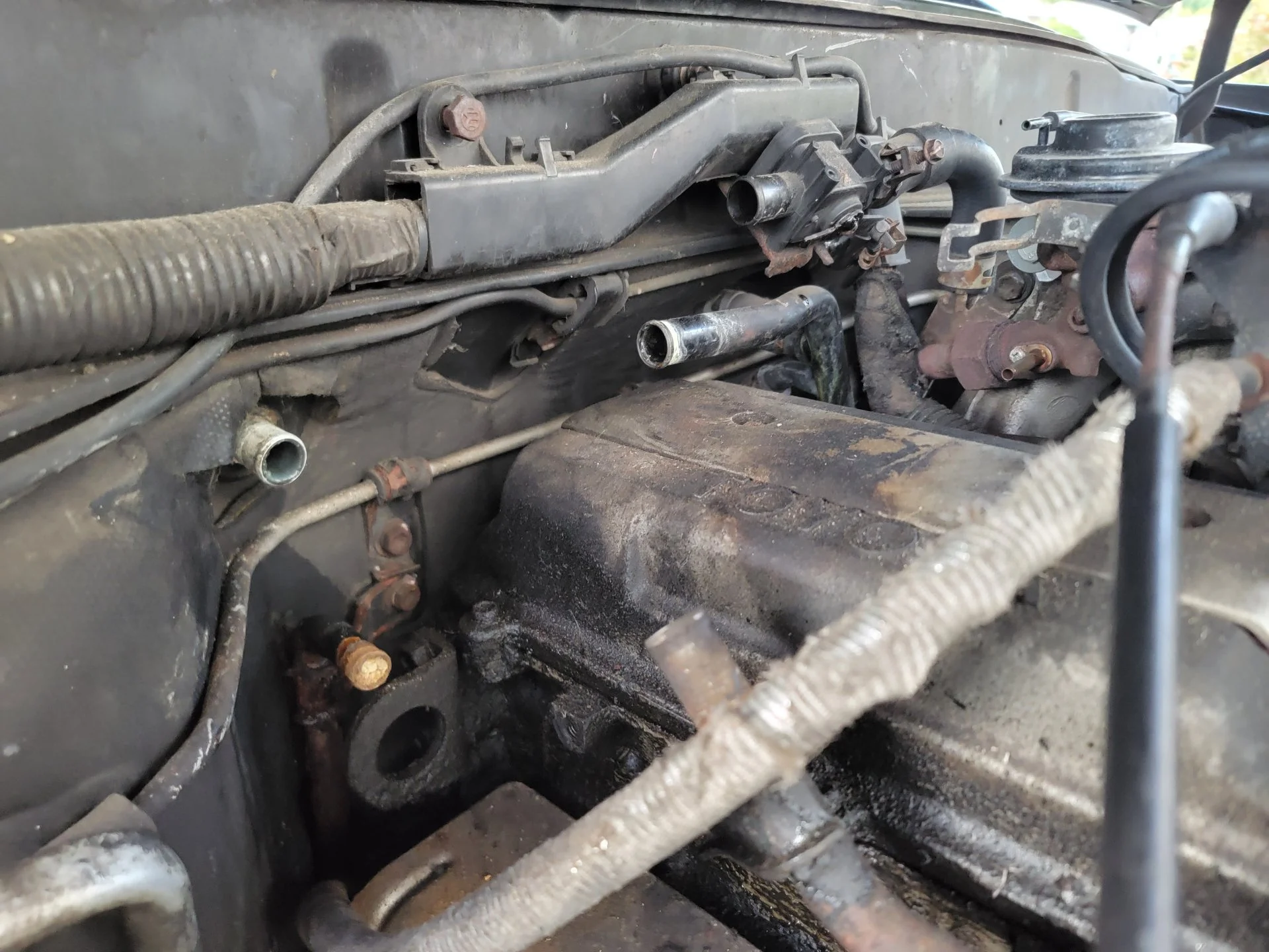

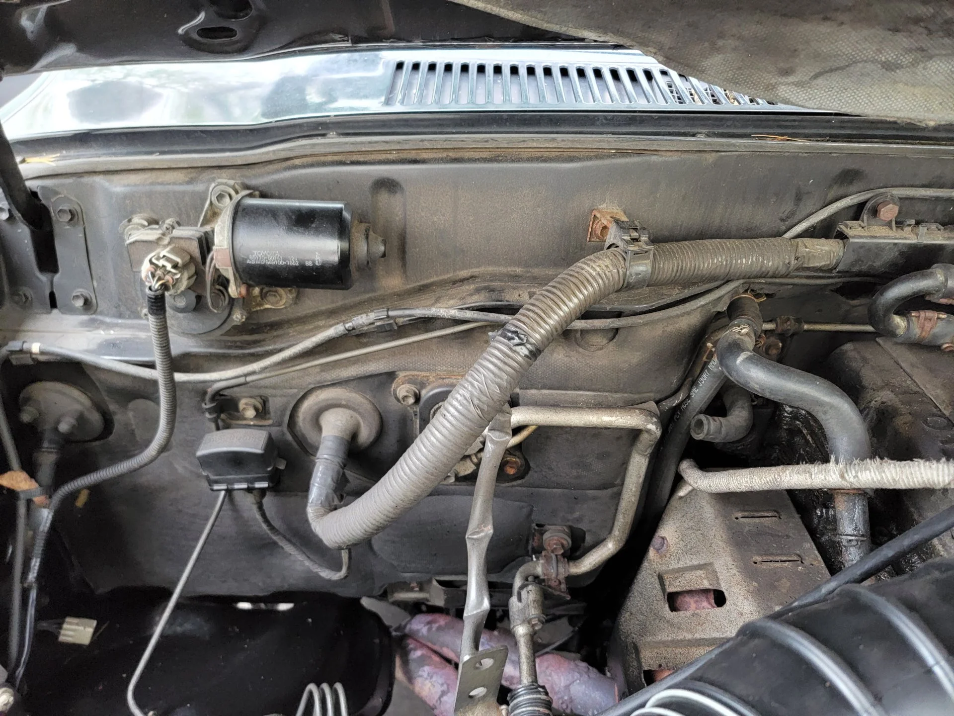

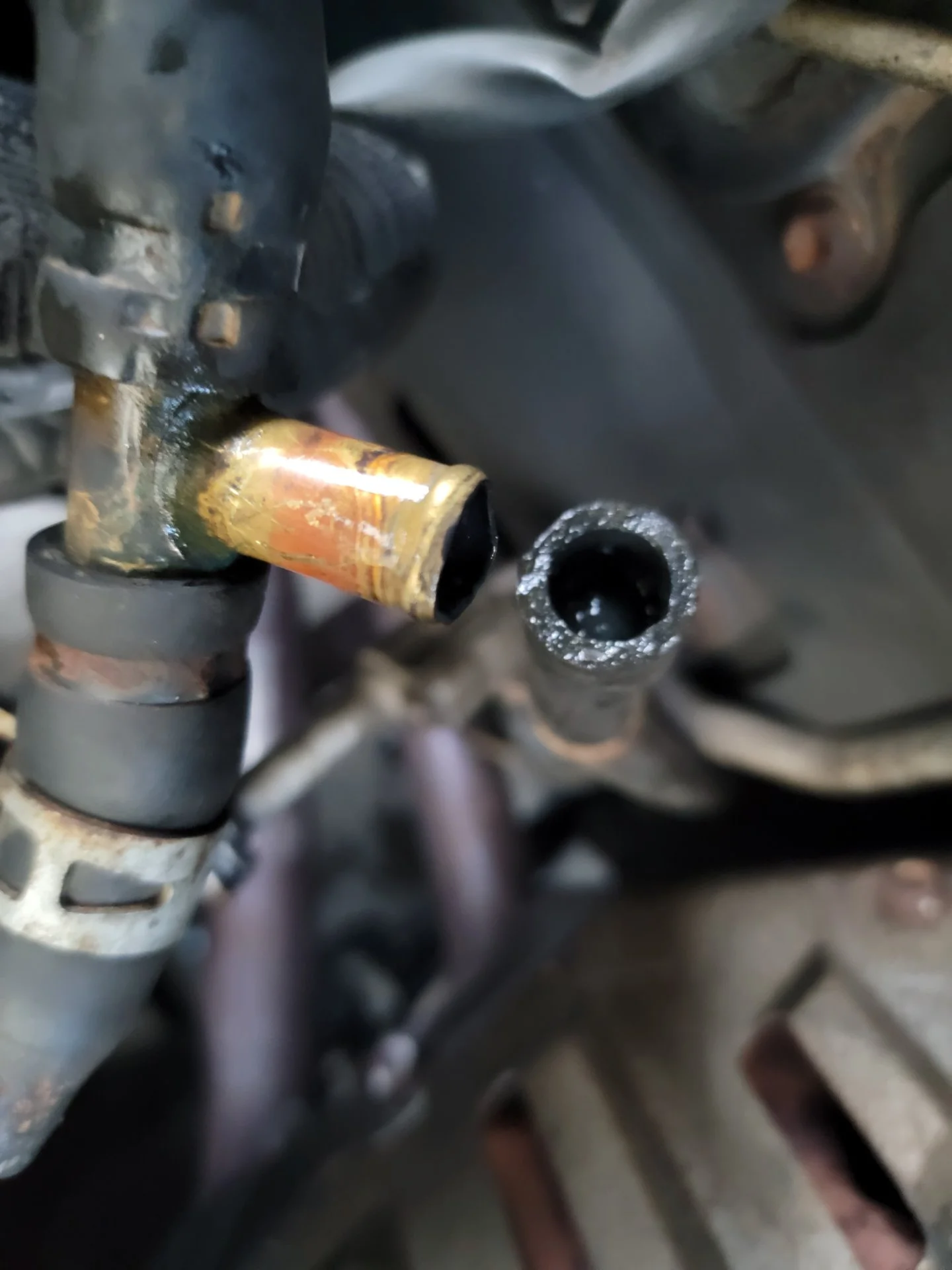

Yeah, that left side looked sketchy to me. You can see a little hose below the T connector that connects to the firewall. That could probably be the stock firewall port you were looking for? My gut tells me that metal pipe is rusted so he bypassed it and routed the new rubber hose to the rear blower. It's actually working right now, but I'm going to do the rear heater delete.

Peace of mind. given a previous mechanic has already bypassed the metal piping on the passenger side, the other side is going to rot away eventually which could cause a coolant to leak.

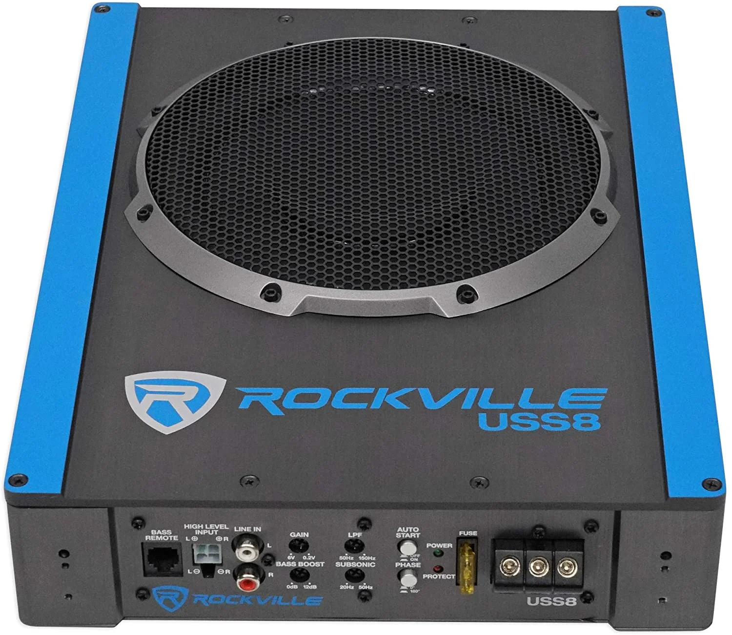

I know the Lexus had the sub/amp in a different location (Armrest/console) but that rear right cargo area is enough for a shallow 8-10" sub (apparently) and a slim amp. I've been thinking about that for my own rig, OR one of those slim sub/amp combo units.
Like this one - not to derail your thread.

@avdeveloper you might've mentioned it but have you inspected the metal rear heater lines above the cats and transmission? It's common for those to rust and crack as I understand it. There may be a rubber hose attached to them as well.
yeah the rear heater line on the passenger side turned out to have been bypassed by a mechanic years ago. the rubber hose was no longer connected to that hard line. I'm deleting it entirely anyway because we've never used the rear heater for years.

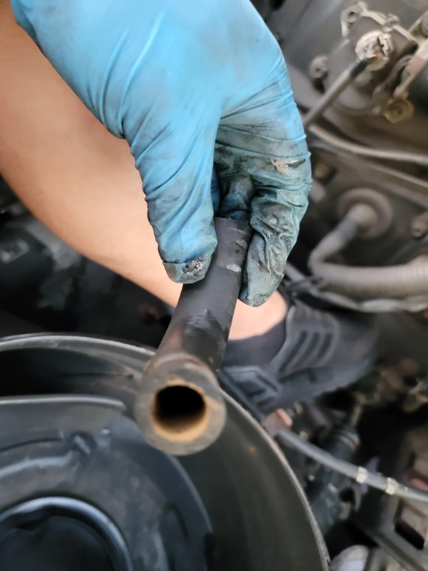

The passenger side of the heater core is out. Next is to get at the driver side, which is proving to be a PITA to reach. I noticed the rust on the hoses. Those are probably the ones causing the water to turn brownish huh?
It's going to be tough say what is causing the water to be brownish because it's probably a number of things. I don't recall how intense of a baselining you are going for (i.e. budget/time evailable) and that will dictate whether you worry about it.

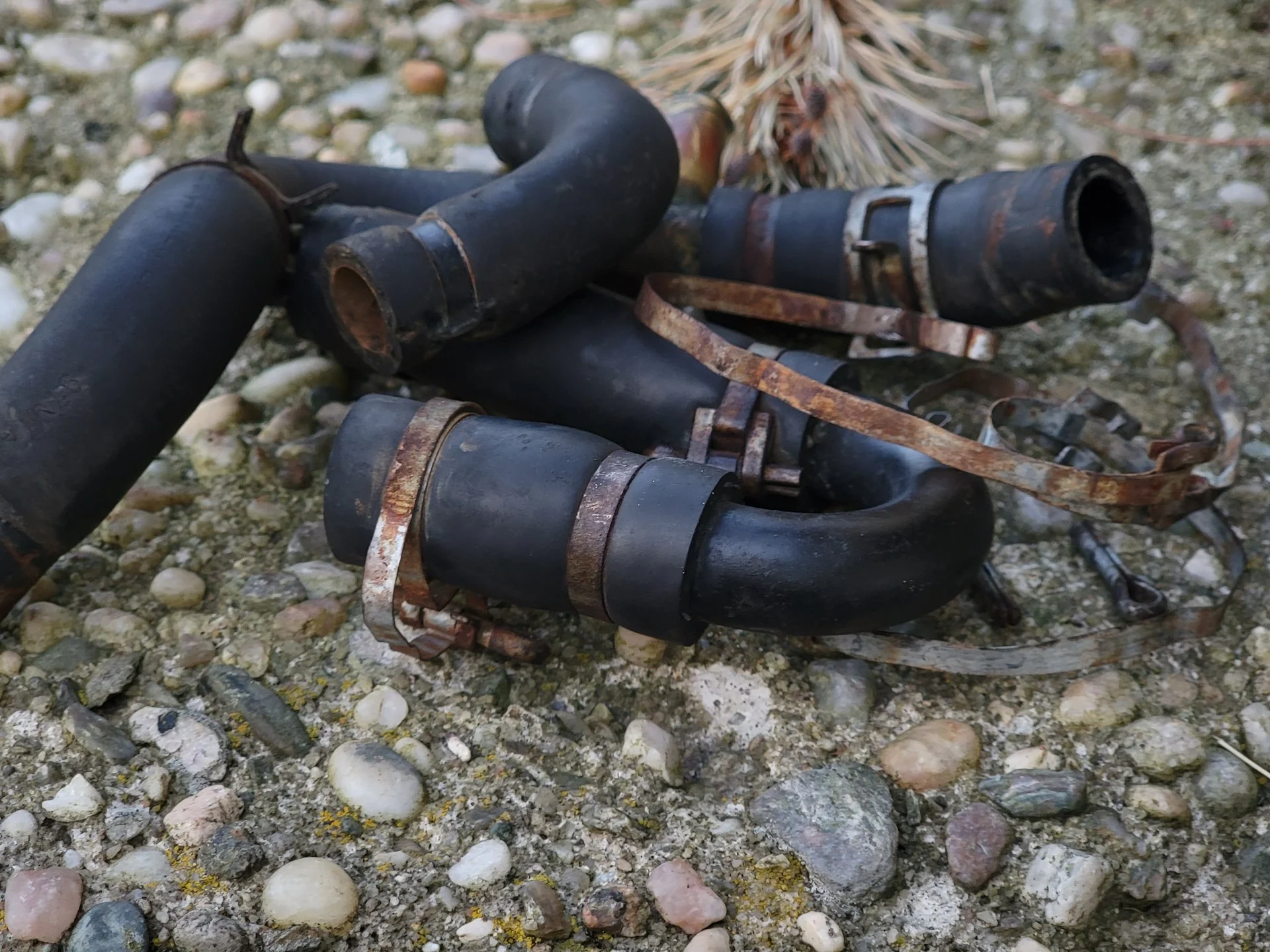

I had a lot of corrosion just about everywhere in the coolant system. I was able to do the rust remover treatment and get it run mostly clear before changing any hard pipes or hoses. Someone here reminded me not leave water in the system overnight and to add coolant right after the final flush to prevent new corrosion from forming.
That said, I was surprised how far I had to go to get rid of rusty/sludgy components after the flush. I ended up doing 100% of the hoses and a number of hard pipes that were not planned in advance. I also changed everything else: water pump, clutch fan, radiator, shroud, etc.... Was it necessary? I have no idea. I probably went too far and wasted some money. Although, it would have pissed me off to go through all of that work and end up with temps in the low 200s even though that is probably okay. Ultimately I feel good that the odds of overheating should be reduced. I also think some of my other issues relate to the fact that my engine compartment had been running warmer than normal for years even though it was not overheating in the classic sense of the word.

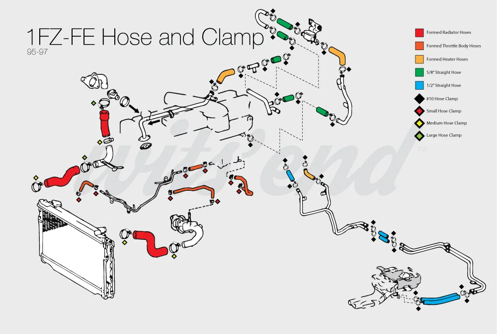

Also, if it hasn't been posted yet...
Also, I think all of us need to frame this and put it up in a garage ;)
