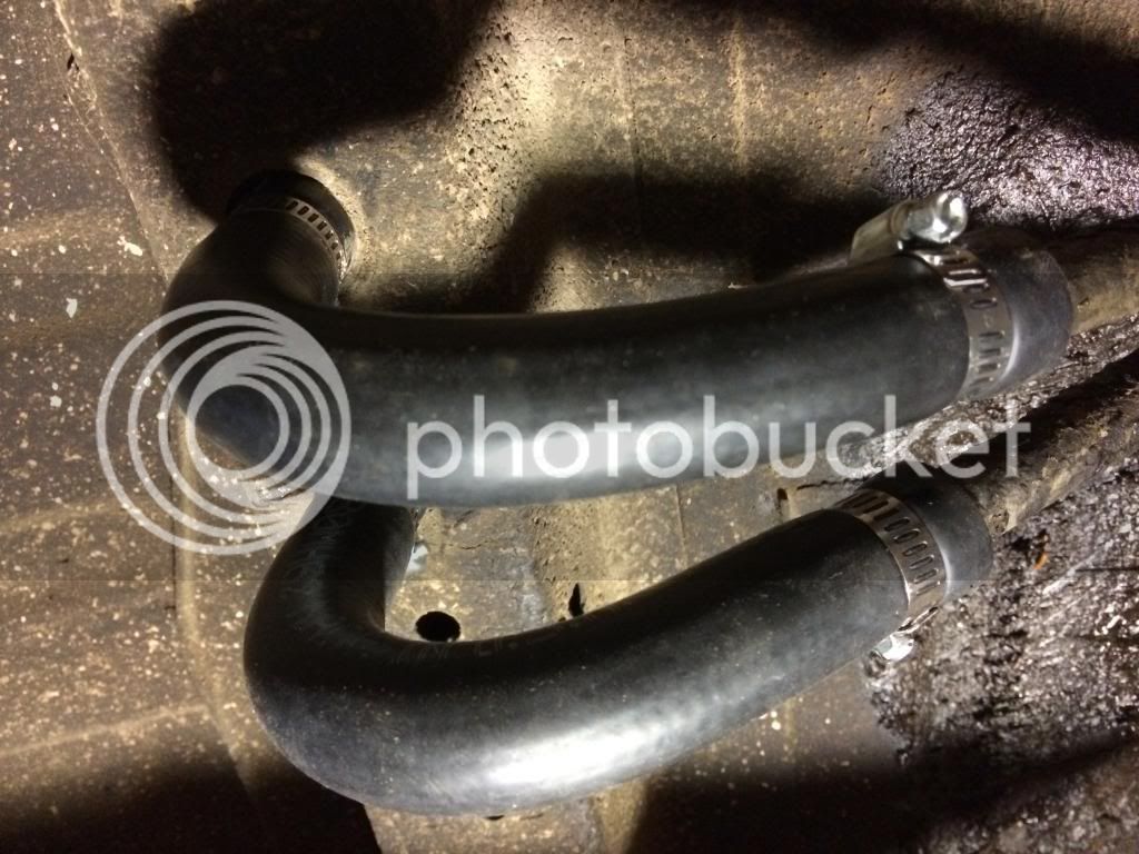

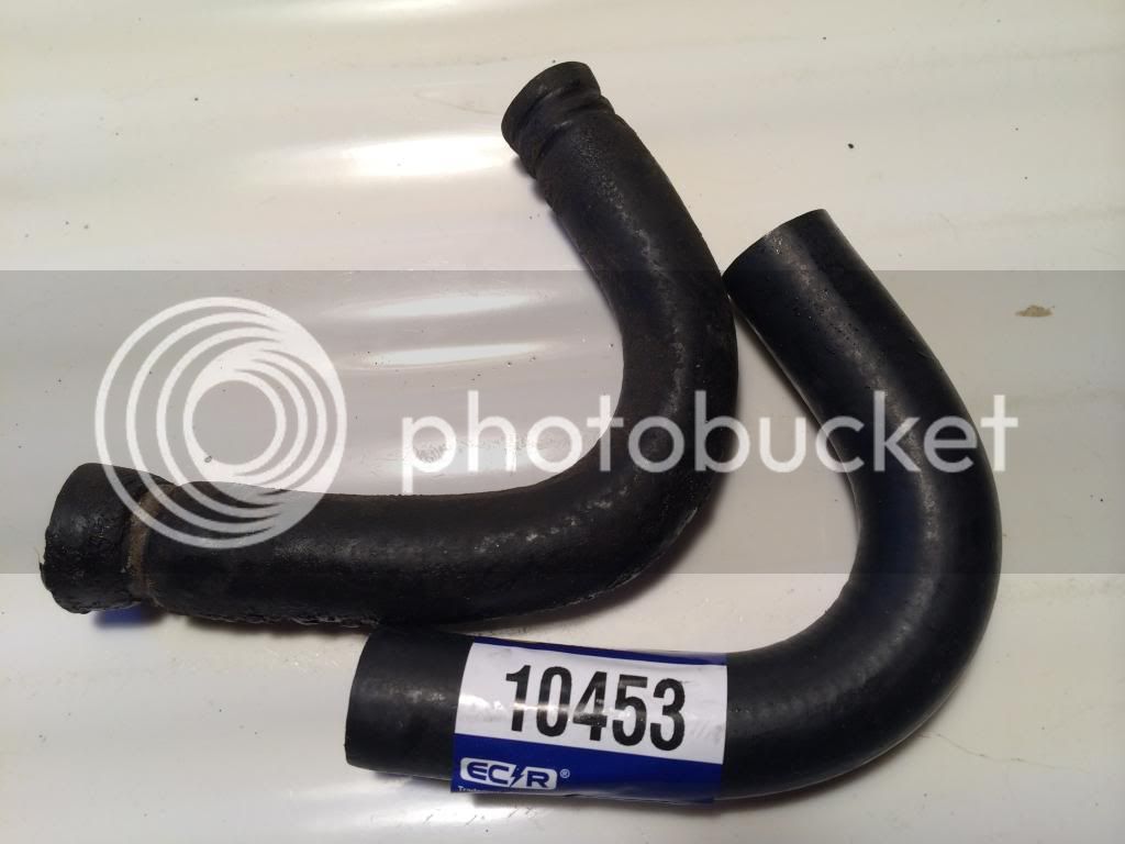

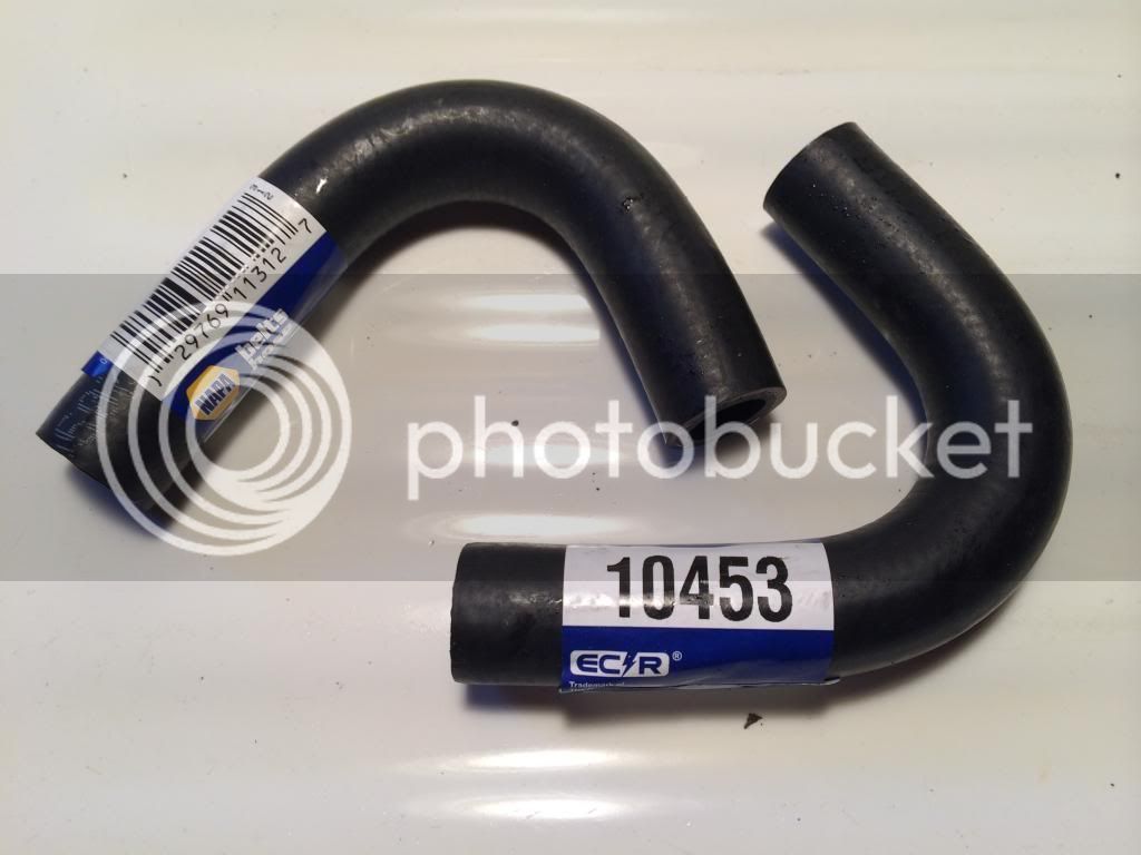

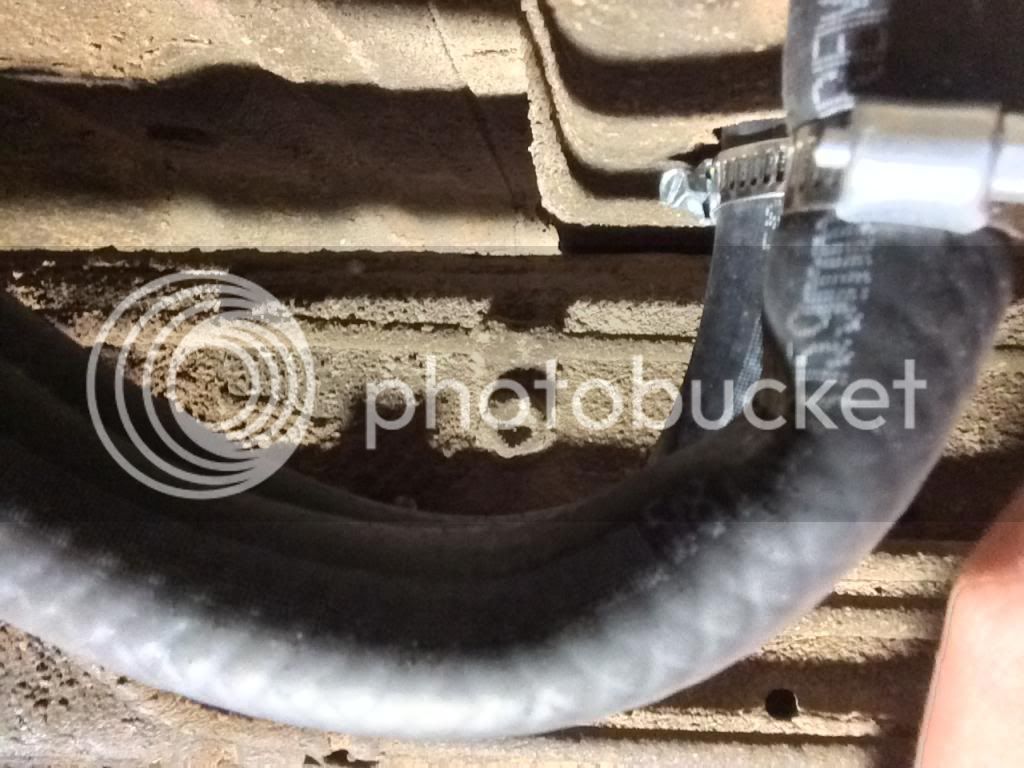

Since I have now gone through my engine compartment during the refresh and pretty much replaced every hose, belt, or other 28 year old rubber dried up part that could fail me, I decided I should check the hoses going to the rear heater. Yep, they looked questionable too so I cut them off. I had some cut-to-length straight hose left over so with fingers crossed I cut them to proper length and put them on. As I figured would probably happen, the bend radius was too much for straight hose to handle and caused them to kink. It probably would have been OK but did not sit well with me.
I did some digging online and it looks like a hard item to find. I'm sure someone out there has them, but I'm lazy and didn't search too long especially knowing what premium a Toyota formed hose can bring.

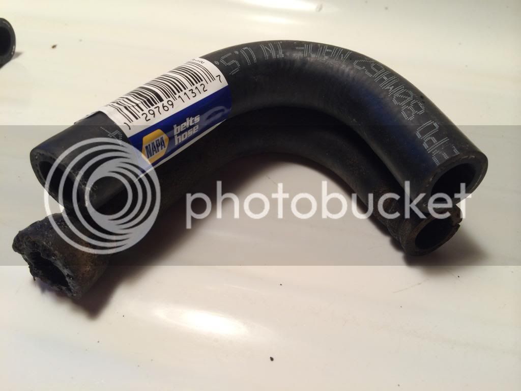

So off to my favorite NAPA I go with crusty hose in tow. I live not far from one of their distribution centers, they usually have most everything in-house. They pulled out a big ole' book with preformed hose shapes in it. We found a few that looked close and had them pulled from the warehouse. Nailed it!
Here is some need to know info for you guys in need.
Part # 10453
Price $12.95 each
It is a tad shorter than stock, but works just fine!
Hope this helps someone out!

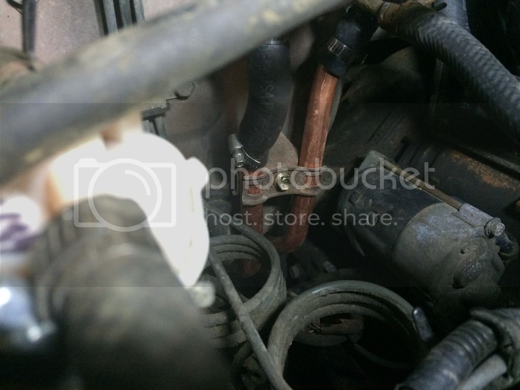

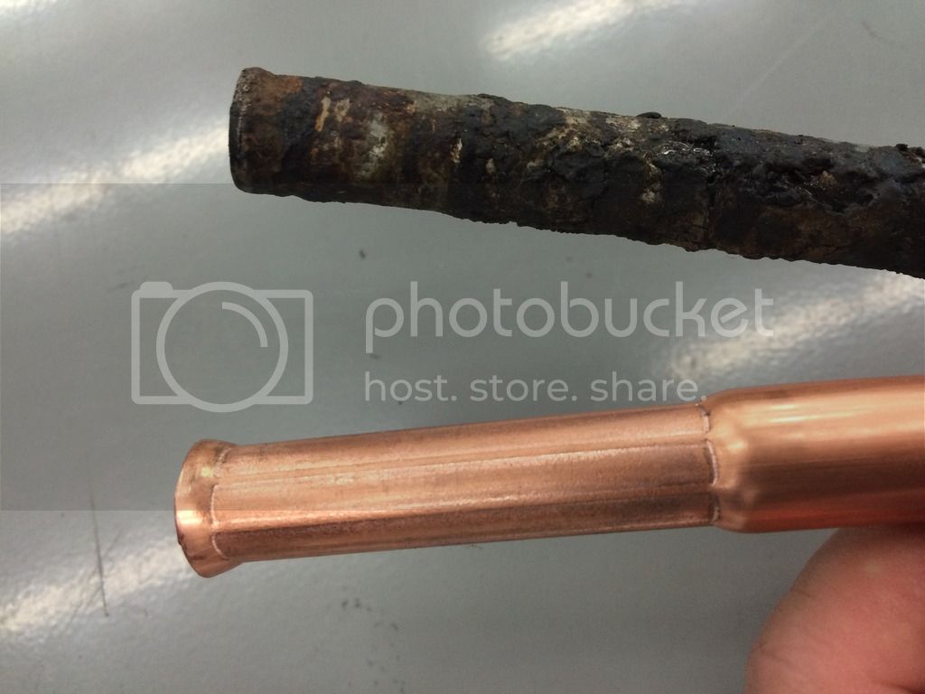

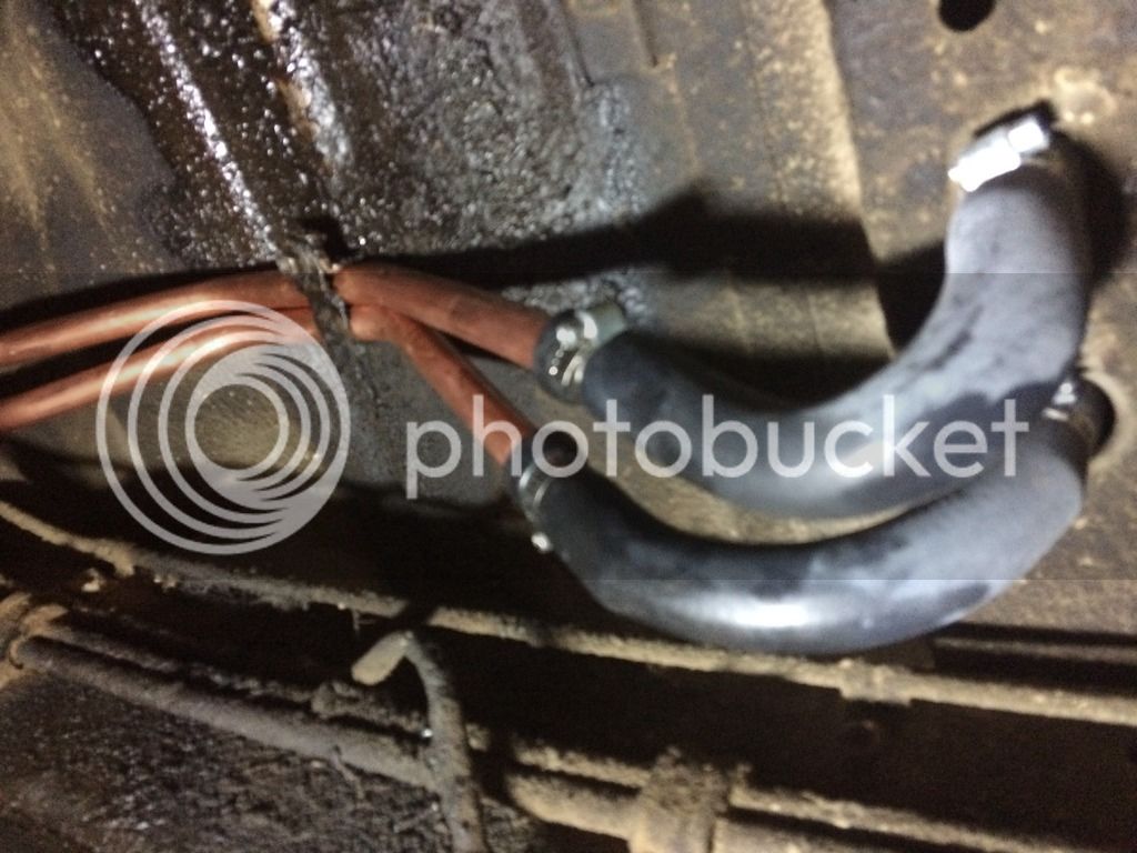

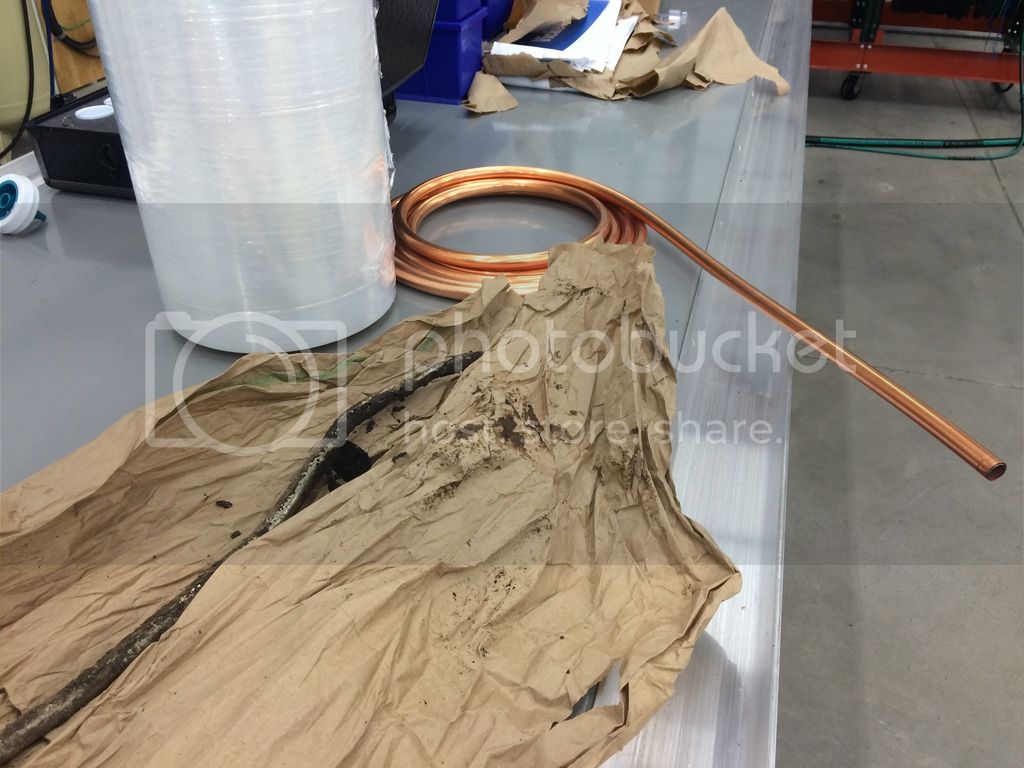

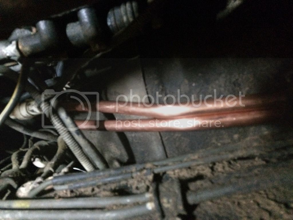

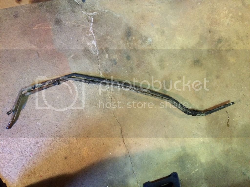

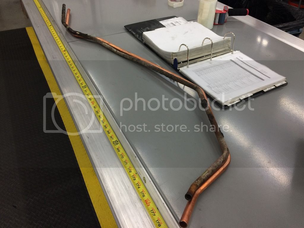

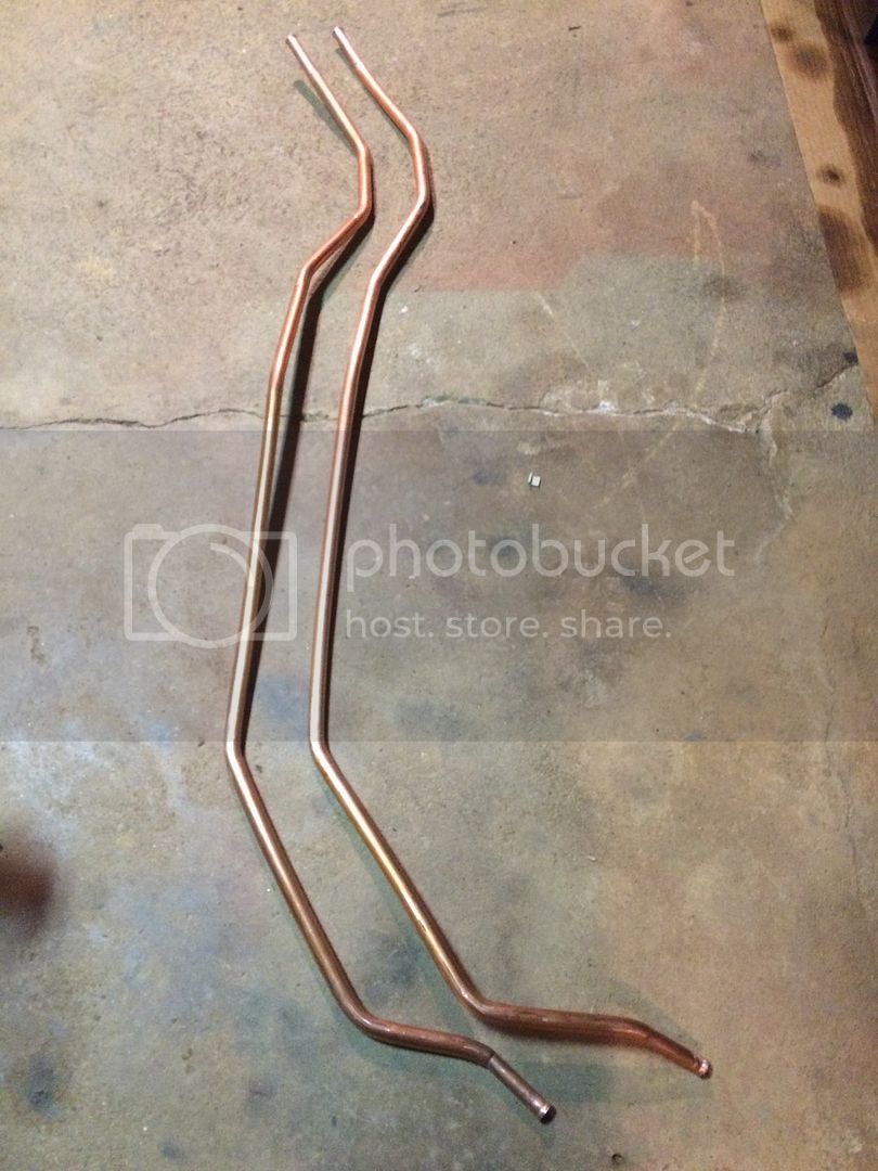

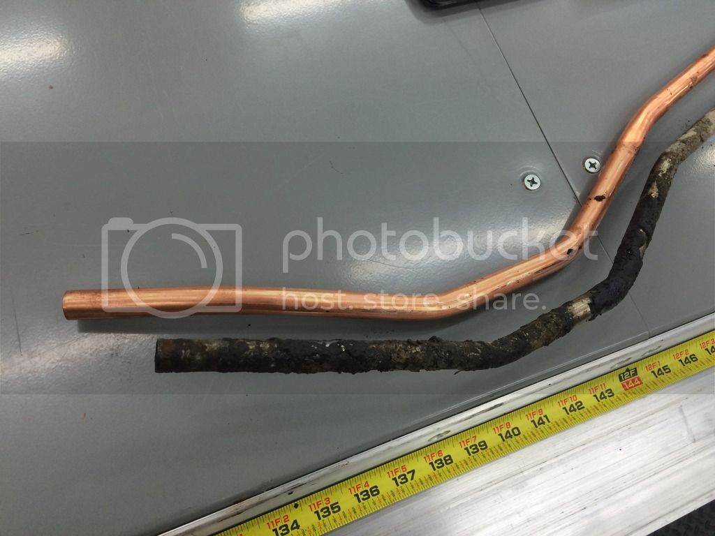

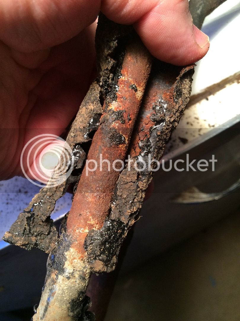

Just thought I'd add to this thread. I recently replaced the hardline to the rear heater. Mine had rusted where the pipes are insulated along the firewall. OEM no longer avaliable, so I had some copper ones made.

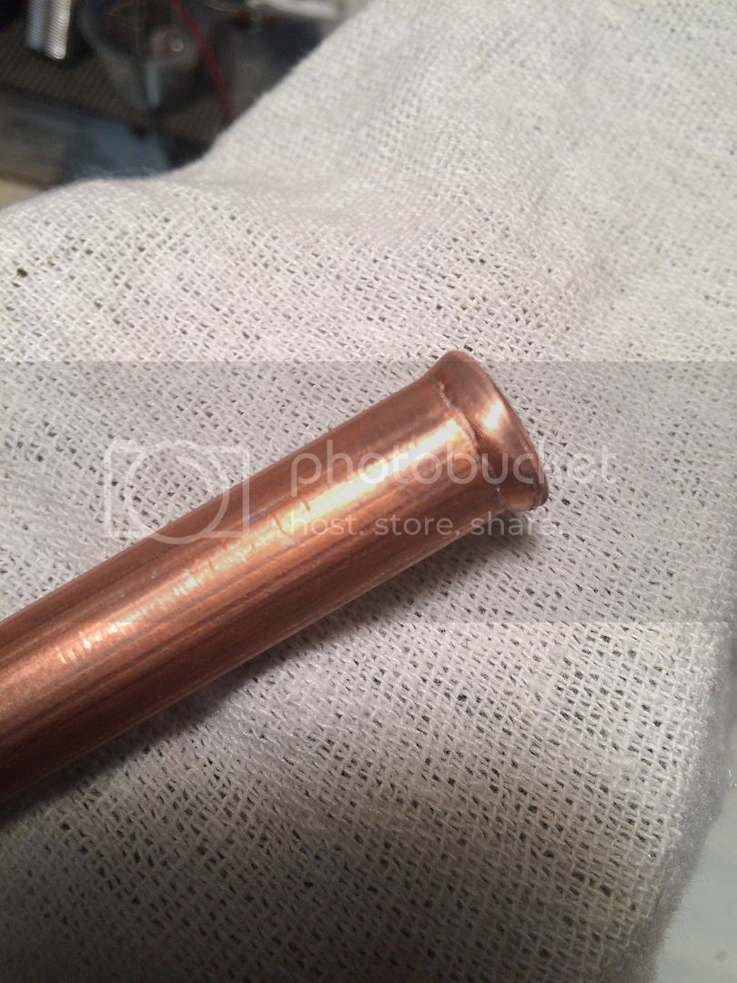

Turned out that the crimping wasn't necessary, the 1/2" ID copper line as just fine as/is but it was an nice touch.
20' of copper line from Home Depot =$48

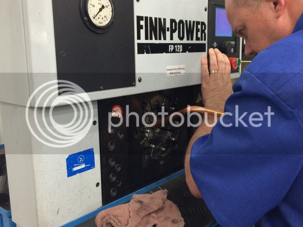

Bending at the Hydraulic shop = $30
New lines = $78 =Win!!
You don't see copper much on the underside of vehicles. Is that purely due to price, or are there other reasons? Looks great, btw.
I don't know. I figure if it's good enough for radiator construction, it will work fine for this. I don't live in a salty, corrosion prone area so I wasn't concerned with that aspect. My old ones must have retained moisture in the insulation leading to their demise.
Beno just got me a set of those rear heater hoses...FYI...those new pipes are sweet!
Mixing copper and iron in a salty wet environment will likely cause electrolysis corrosion problems. I would make sure that anything copper is separated from iron by a layer of plastic or rubber. If you're out of the salt belt it may be OK for a while, but I would keep an eye on the points where copper and iron touch. I don't think copper is used for radiators- I'm pretty sure it's brass, which has a better electrolysis resistance.
Thanks for everyone's input. I did some research before jumping to copper. I have read some things regarding dissimilar metal corrosion. There are arguments both ways. I wanted to go stainless, but finding in in a timely, cost effective manner was an issue. I will closely monitor the copper lines and be a test mule for this repair. If it proves to be a failed attempt, I will at that point source some stainless lines.
