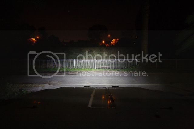

I put some H4 LED globes in and they are amazing, total transformation.
Canbus 80W 8000LM CREE LED H4 Hi & Lo Beam Headlight Conversion Kit 6000k White
They have been great so far and don't have a separate ballast so they are easy to fit, basic plug and play.
Had to section the rubber dust cap but worked out pretty tidy.
Have had them covered in mud and water and still going strong.
you can see the color difference here but the affect at night is outstanding.

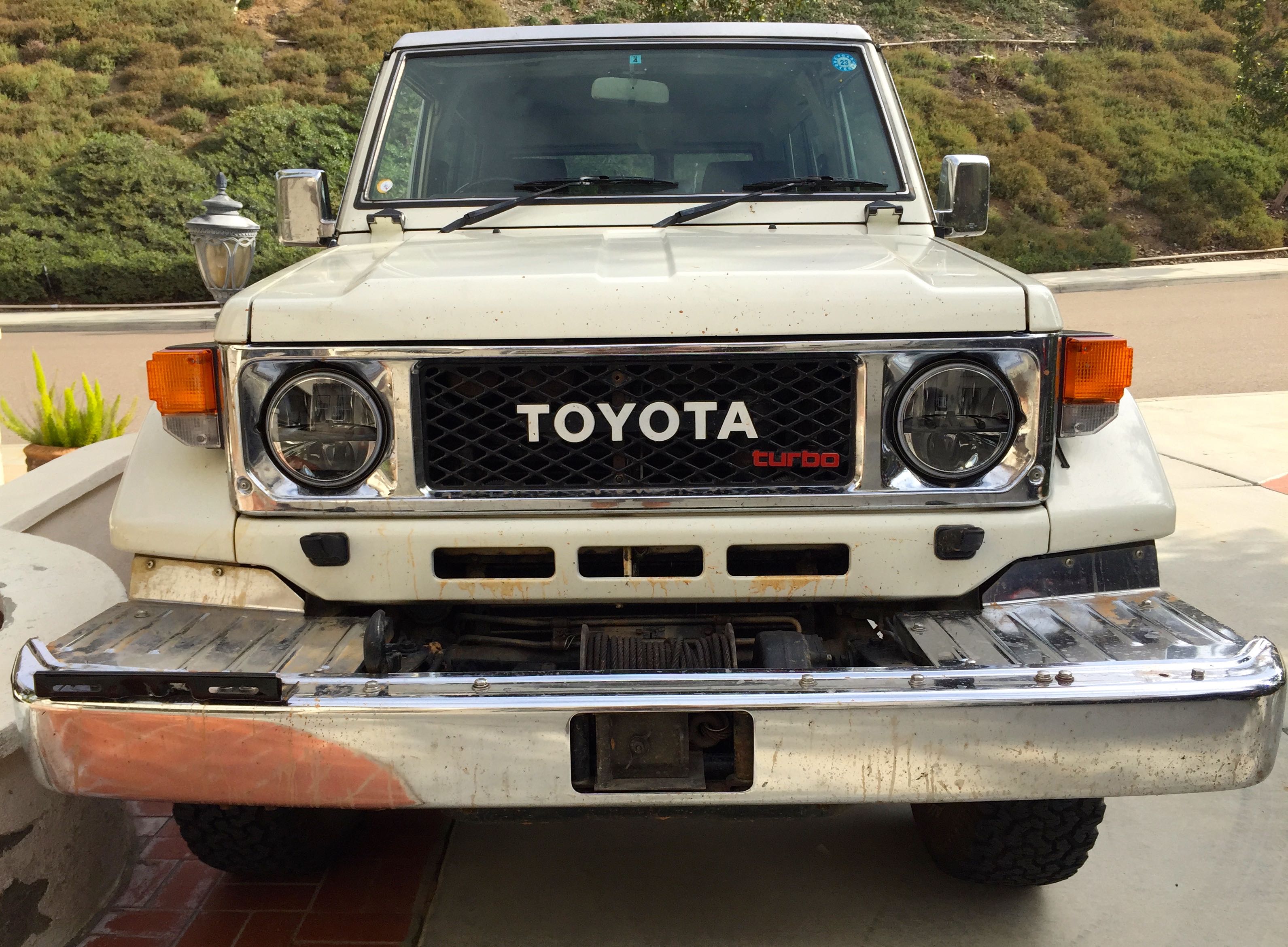

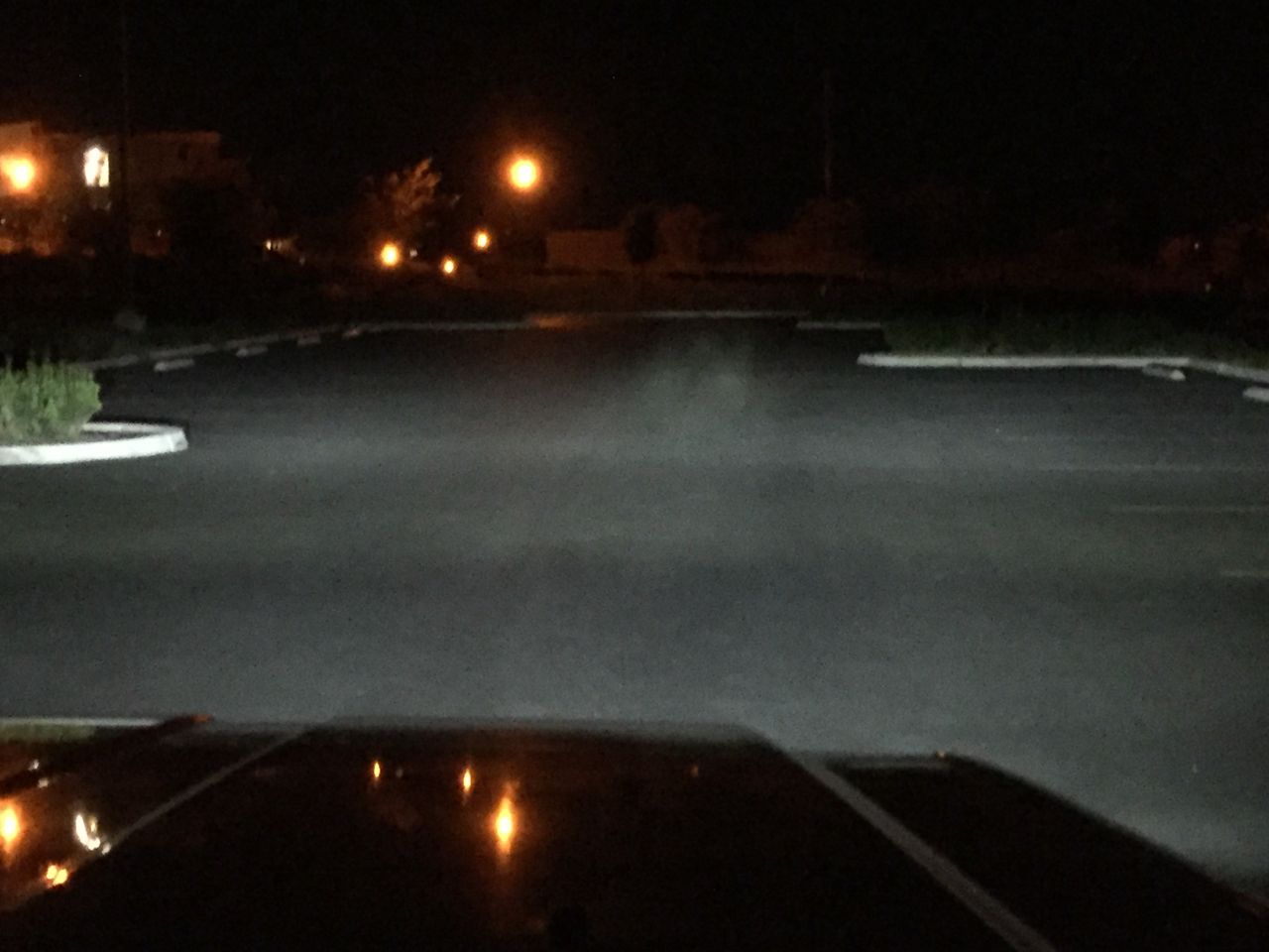

I run those same lights on my BJ74. They are for sure directly plug and play, with a 5 minute maximum installation time. Nothing required to make them work with 24V.
The light is much brighter and whiter than stock. There is a weird X or W pattern that appears roughly at the center of the light pattern. Some can't stand it, complain that it is distracting. I have to admit it does get my attention more than it should, but so far I've been happy with that as a trade off for vastly improved lighting on the road.
Way to modern looking for the 70's styling in my opinion.
But each to there own.
Yeah, I know what you're saying. The visibility improvement was worth it for me. However, the OEM lights are still in my garage just in case I change my mind.

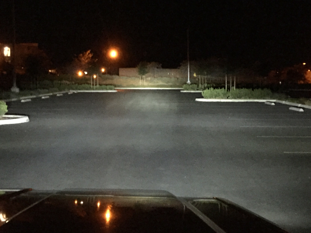

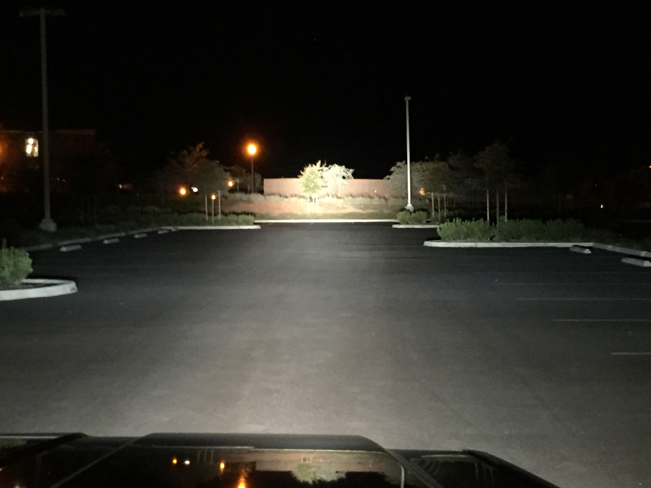

Can we get a picture of what that looks like tonight?

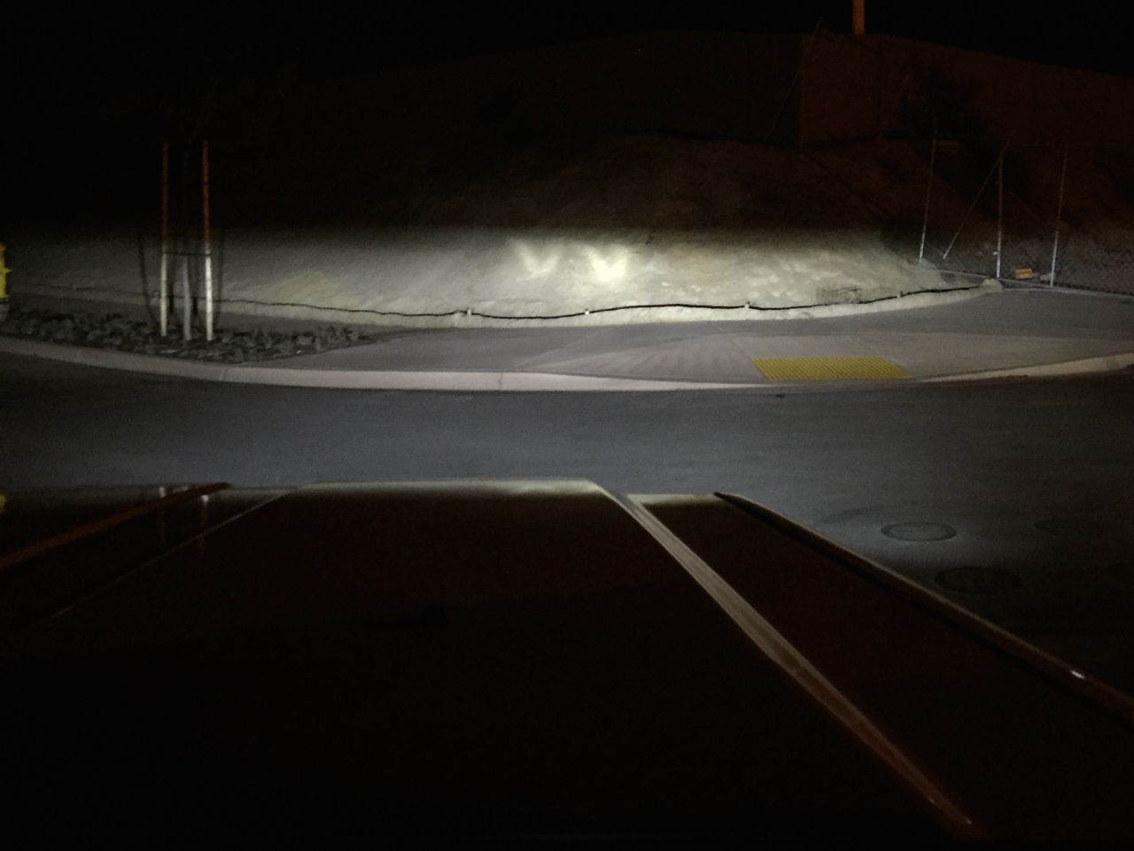

Here's a low beam pic where the "W" is pretty visible right at the center of the shot...although in this picture it looks more like a V V than a W.
...and here's a link to a short video on the darkest road I could find in the suburbs. Warning: 9.3MB video file.
http://dustbird.com/ih8mud/70/trucklite.m4v
HTH.
Does the VV pattern remain when the lights are on bright?

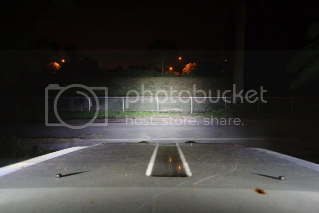

Here they are.
just headlights.Very crisp and clean and much brighter than halogens.

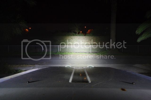

with the 4 inch spots.
