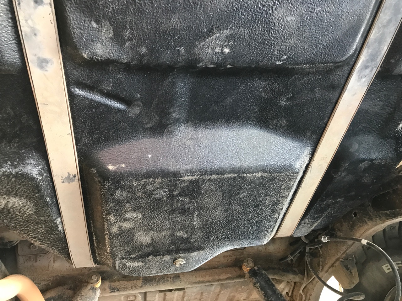

Started in the back and made quick progress putting QuietCrap (80mil) down
So far so good. At this point, I could almost imagine hearing the sound coming from my speakers...
Fast forward a few hours and new carpet (and padding) is in. Thanks to @reevesci for the quick turn around on the carpet kit. Awesome stuff!
Still have most of the 2nd roll of QuietCrap left for the doors and tailgate and a few loose ends to tie up, but so far so good. With just the floors done, the truck is noticeably quieter and the new carpet is really nice. Only drawback is the truck smells slightly less like an old taxi.

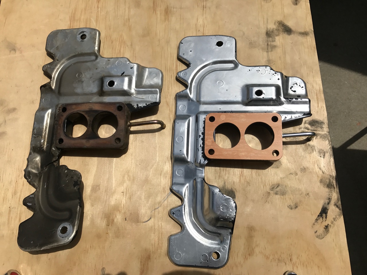

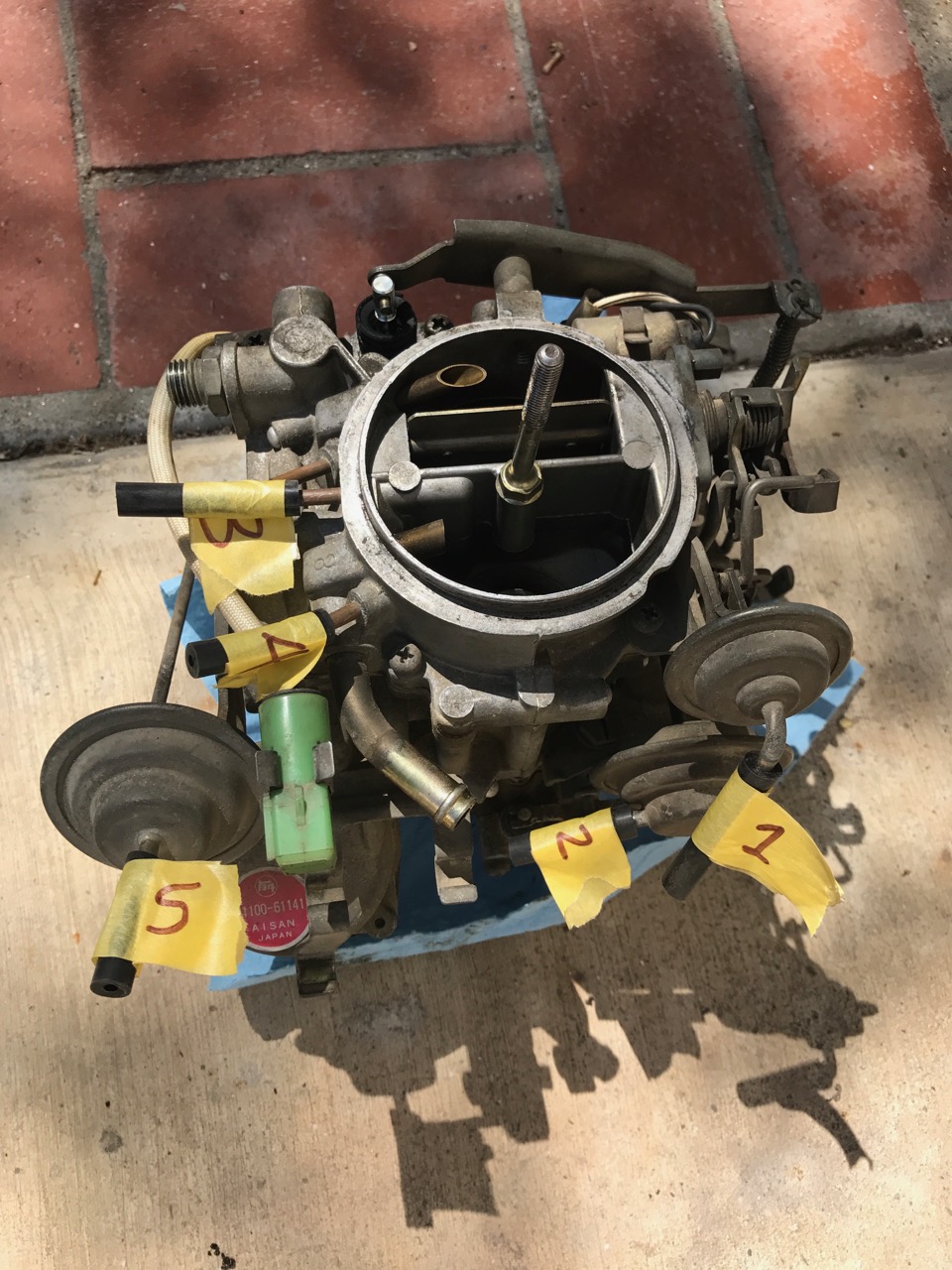

4. Had the carb rebuilt by Mark's Off Road (before pic below)
5. Verified intake manifold is NOT cracked (thankfully!)
6. Replaced carb insulator plate for good measure

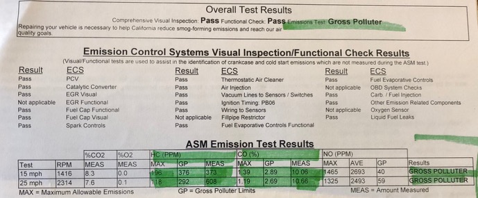

With my California registration due, and an irrational level of optimism, I got a smog check. Failed miserably.
Given the truck was running OK, but not passing smog, I decided to go another direction with regard to registration so I could put some miles in and see how things go. (PM me if you want more details, but there's a bit of an Easter egg in the pic below).

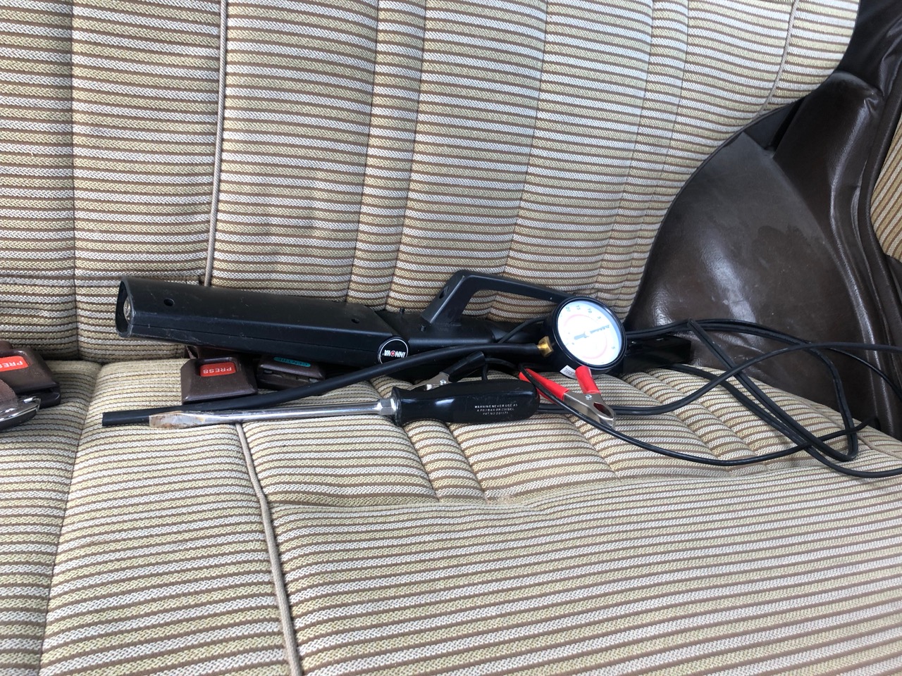

Have learned to keep these in the truck at all times

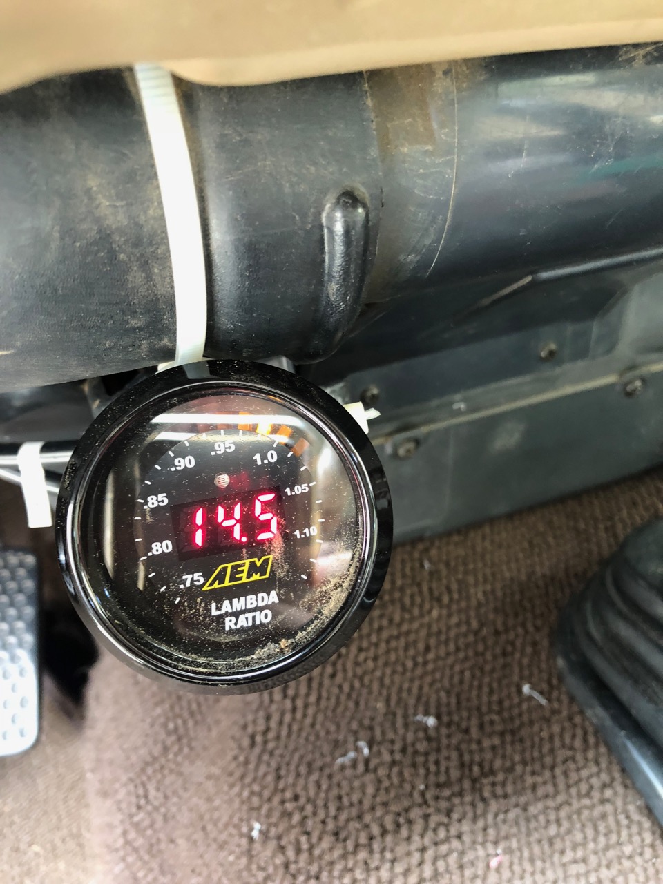

Ed Hanson's welded a bung for an oxygen sensor
Quickly mounted the AFR/Lambda gauge after spending way too much time on the wiring (added a Blue Sea fuse block and circuit breaker and wired the gauge through a relay using accessory power from one of the unused terminals behind the dash)
Haven't put a ton of miles on with the AFR gauge installed, but it doesn't seem to be running crazy rich as I was expecting from the smog test results, so I'll leave the carb alone for now. Perhaps whatever happened that day when it randomly started running better also leaned it out. Fingers crossed.

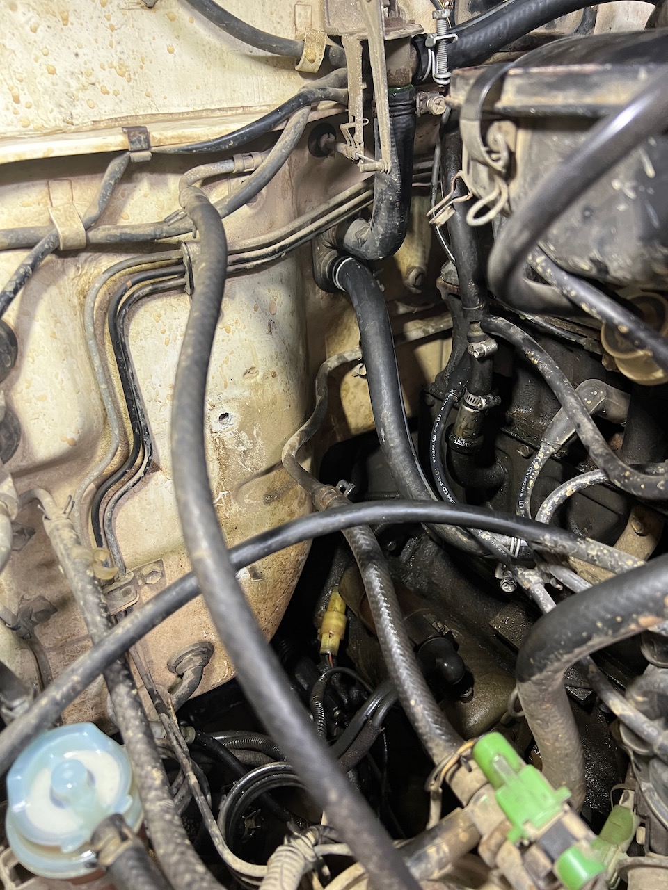

After poking around in the engine bay and reading and rereading carb and smog threads here, I decided to take a hammer to the EGR valve. I'd tested whether it opens by applying vacuum and could hear it move, but wasn't getting a good sense of it closing. Symptoms seemed to match a stuck open condition, so out came the hammer. After a couple smacks, the EGR valve closed, idle smoothed out, and I was able to bypass temporarily by cutting off vacuum to the EGR valve.

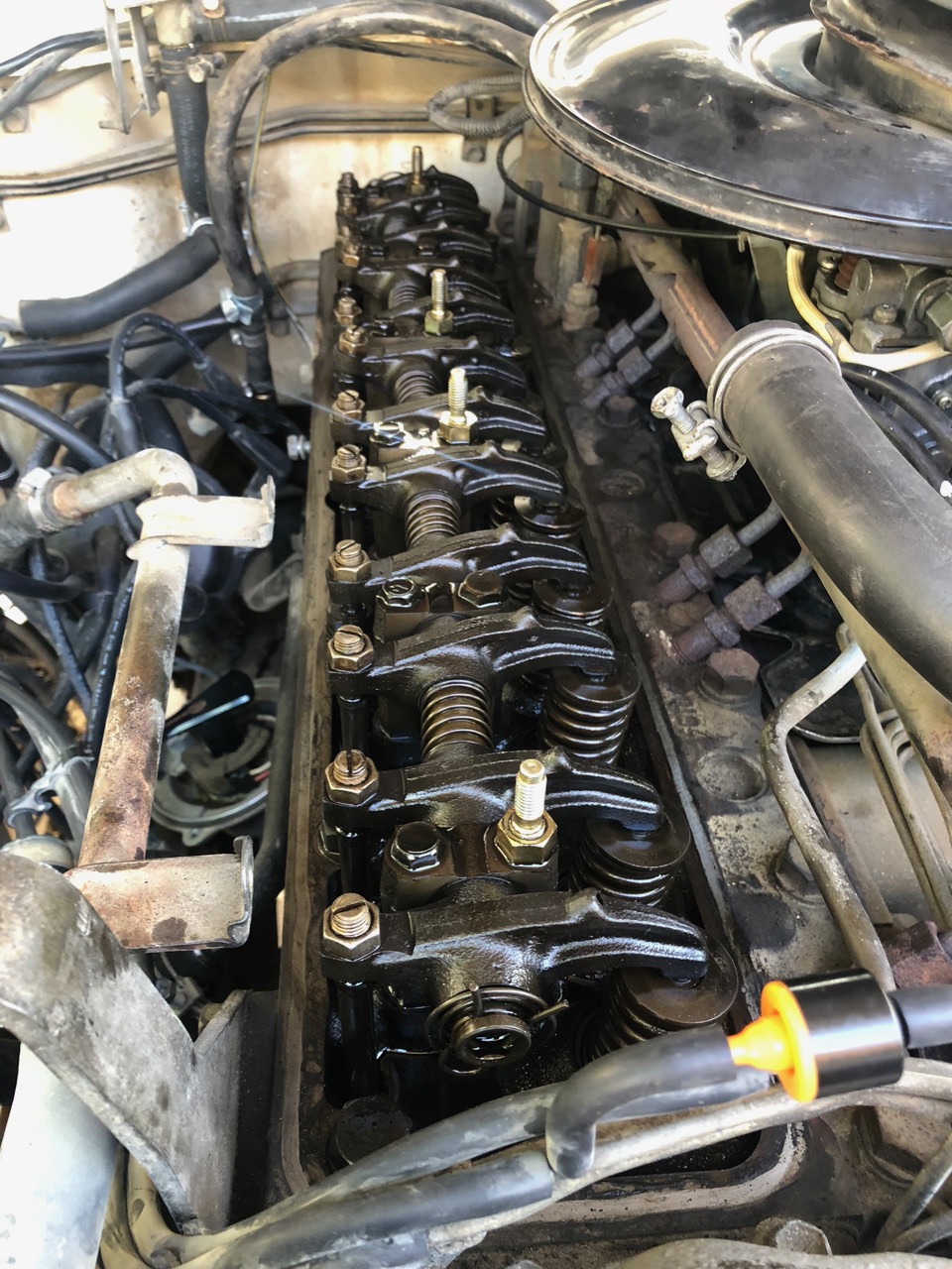

I'd been delinquent on adjusting the valves and with the truck idling and running reasonably well, through the time was right. I pulled the plugs and distributor cap, rotated the engine using the alternator bolt until the stars aligned on the flywheel, and dug in. The valves (both intake and exhaust) on 1, 2 and 5, 6 were tight and the rest oddly loose.
Fired up the engine and found idle vacuum went up and the engine had smoothed out, both in small, but appreciated amounts. On the road, the truck feels a bit smoother and seems to pull better. Nice improvement for the cost of a gasket and a couple hours of work.

Next up: Adjust idle mixture a bit (AFR reading 14.4) and dial in the ignition timing.

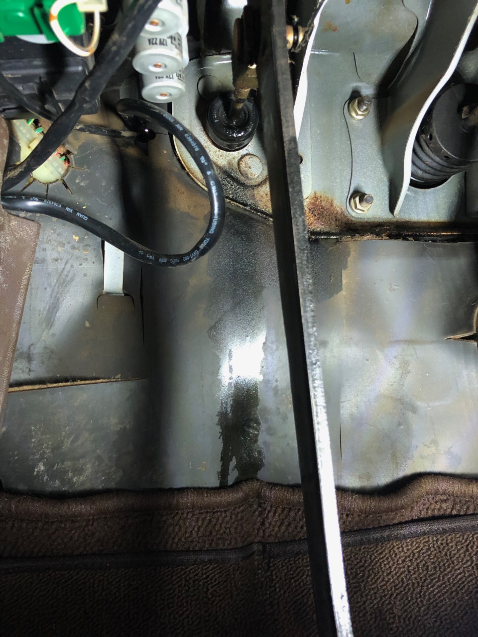

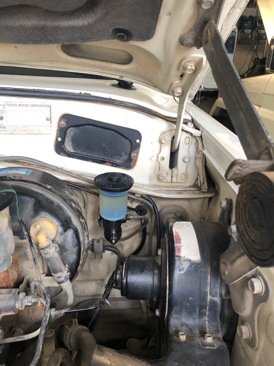

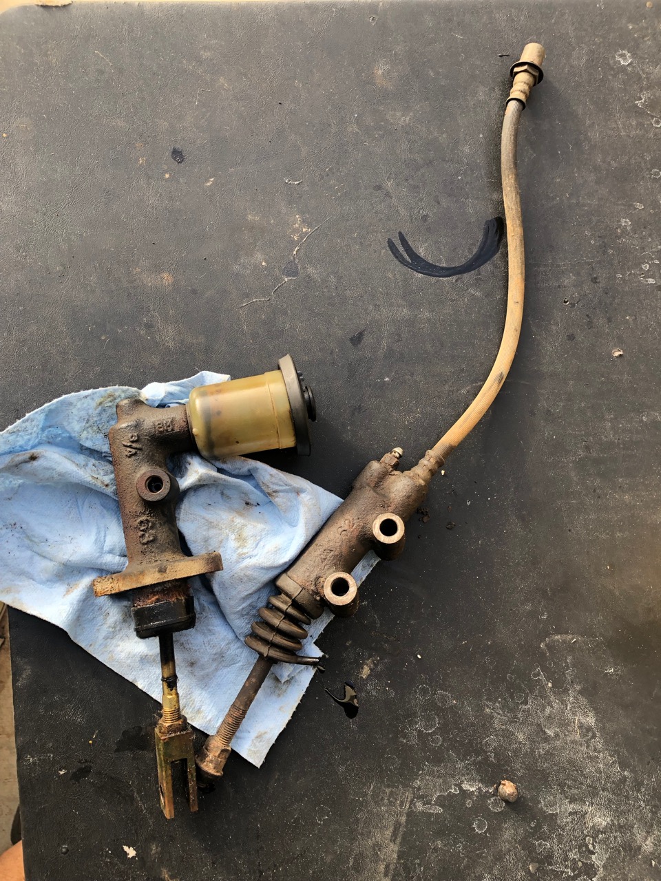

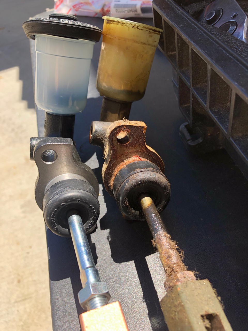

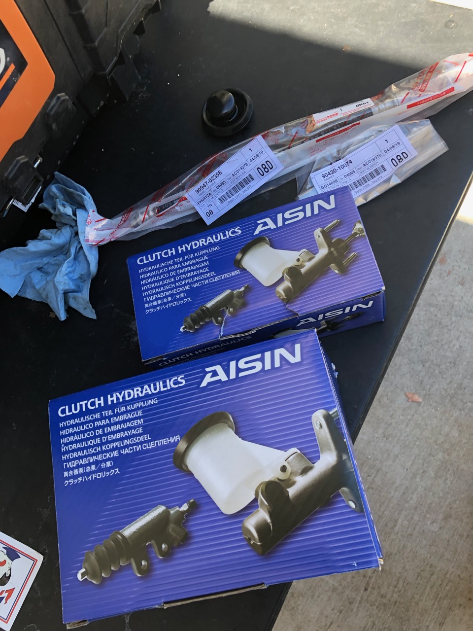

Unfortunately, that didn't last too long before I discovered the clutch master had started leaking (into the cabin).
Thankfully Aisin replacement master and release cylinders are readily available and reasonably priced, so on they went along with a new Toyota soft line going to the release cylinder. After some fiddling with the pedal free play and release cylinder adjustments, no more leaks and the clutch pedal feel is about as good as I could expect on a 30 year old truck.
So that's where my fluid is going...
I think the Toyota hose might have been the most expensive part of this repair

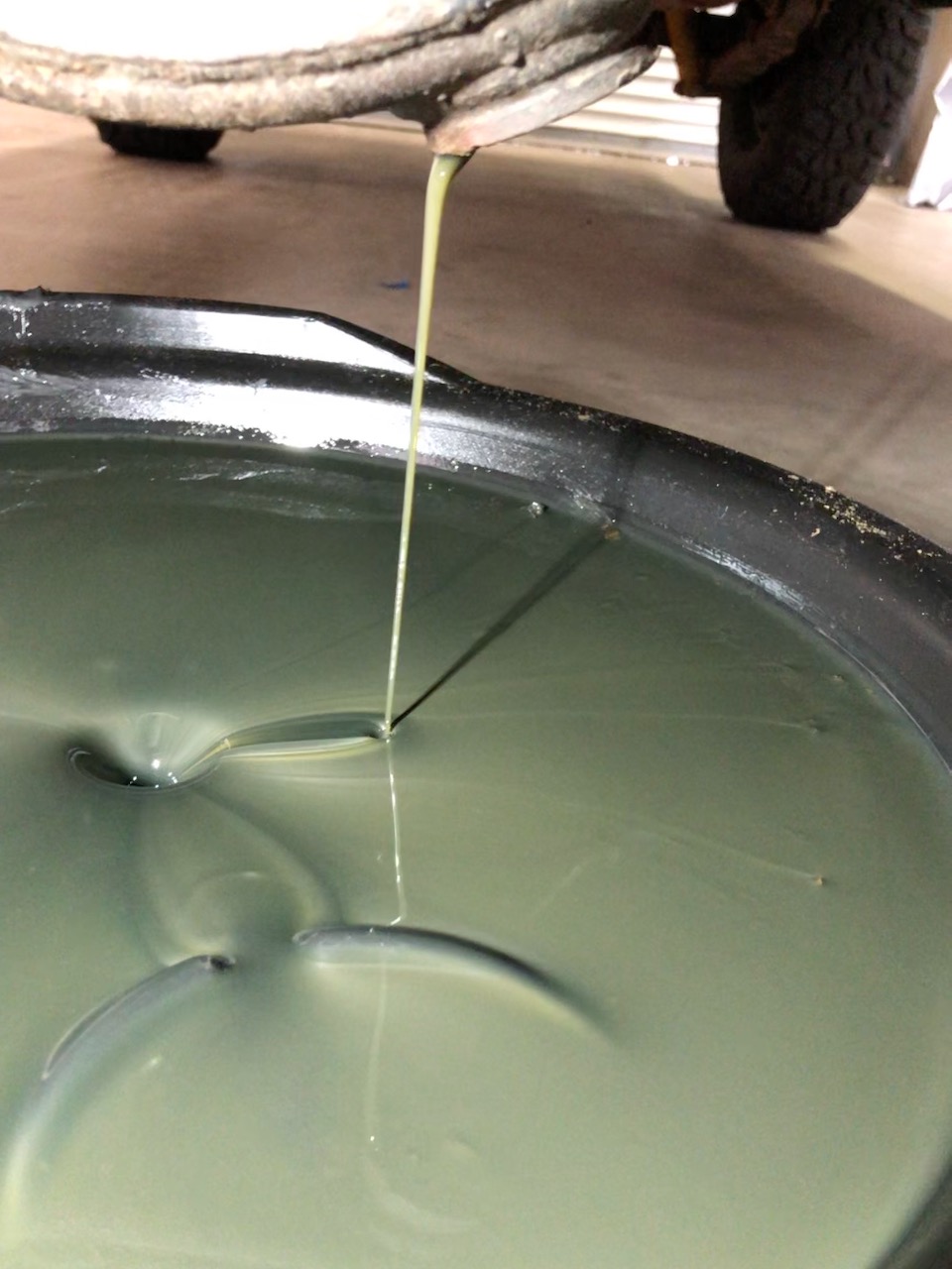

New and old. Note the sludge in the bottom of the reservoir. I flushed the fluid when I first got the truck, but obviously didn't do a great job cleaning out the reservoir.
Headed for the landfill
Ready for another 30 years

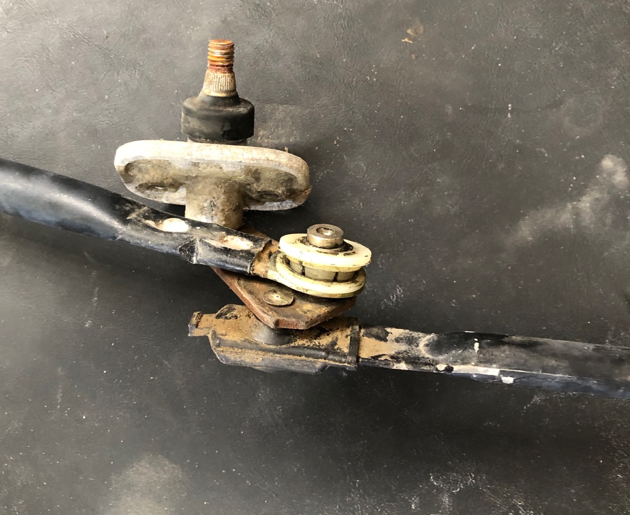

So as it turns out, it rains here in San Diego and while it probably won't continue to do so, I finally mustered the energy to figure out why my wiper blades flap all over the place. Not surprisingly, the linkage was sloppy and the bushing connecting left to right wipers was out of place.
Before doing anything other than pulling the whole 35 year old mess out of the truck
After poorly cutting a piece of rubber I found laying around and wedging it in between the bits to hold the bushing in place...hopefully. Not the most elegant solution, but the price was right.
Success at least in my driveway testing!

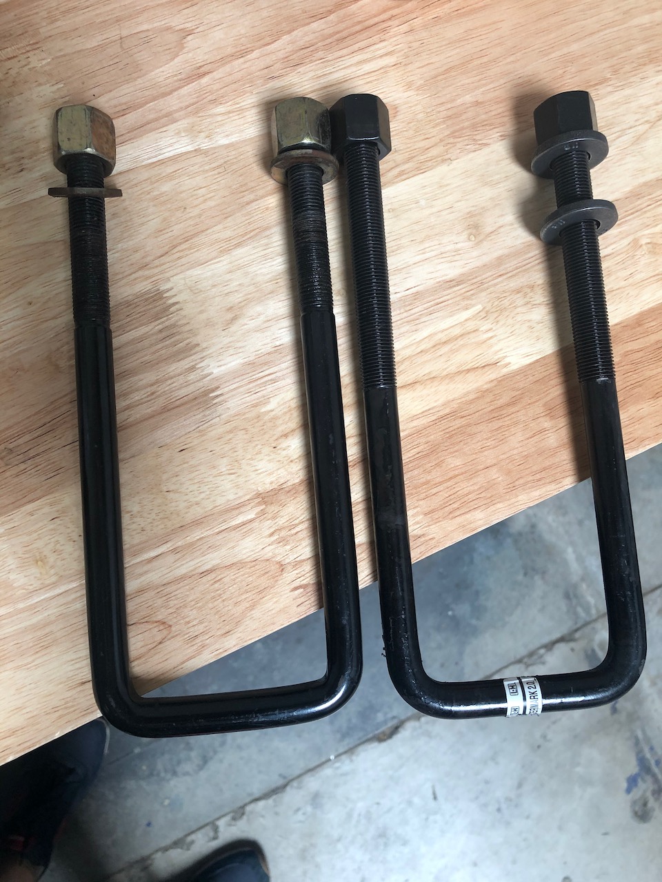

Short answer: Cheap leaf spring u-bolts.
Some things I did to try to diagnose and address the clunk:
-Greased every fitting I could find...u-joints, leaf spring shackles - No impact
-Removed the rear drive shaft, locked front hubs, drove in 4H and 4L - No impact (ruling out the Lock Right as the culprit)
-Cranked down on the leaf spring u-bolts - No impact
-Checked for 12-6 and 9-3 play in front wheels and steering which seemed fine - No impact
-Blamed bad birfs so swapped in some Trail-Gear Longfields from @cruiseroutfit - No impact
-Enjoyed a few hazy IPAs by way of curbside pickup - No impact
-Changed the differential oil looking for, but not finding (thankfully) any metal shavings - No impact
-Read some comments on aftermarket leaf spring noise by @OSS - Got me thinking...
-Had a local spring shop make up custom u-bolts - Solved

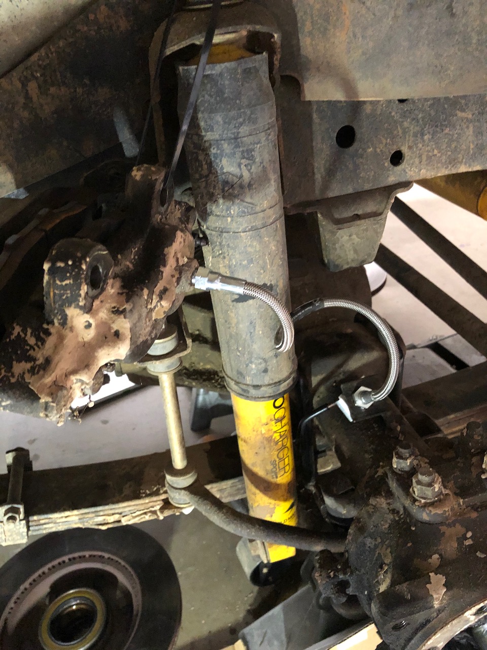

Bypassed the dust shield with a locally made custom brake line...my future knuckle rebuilding self will thank me.

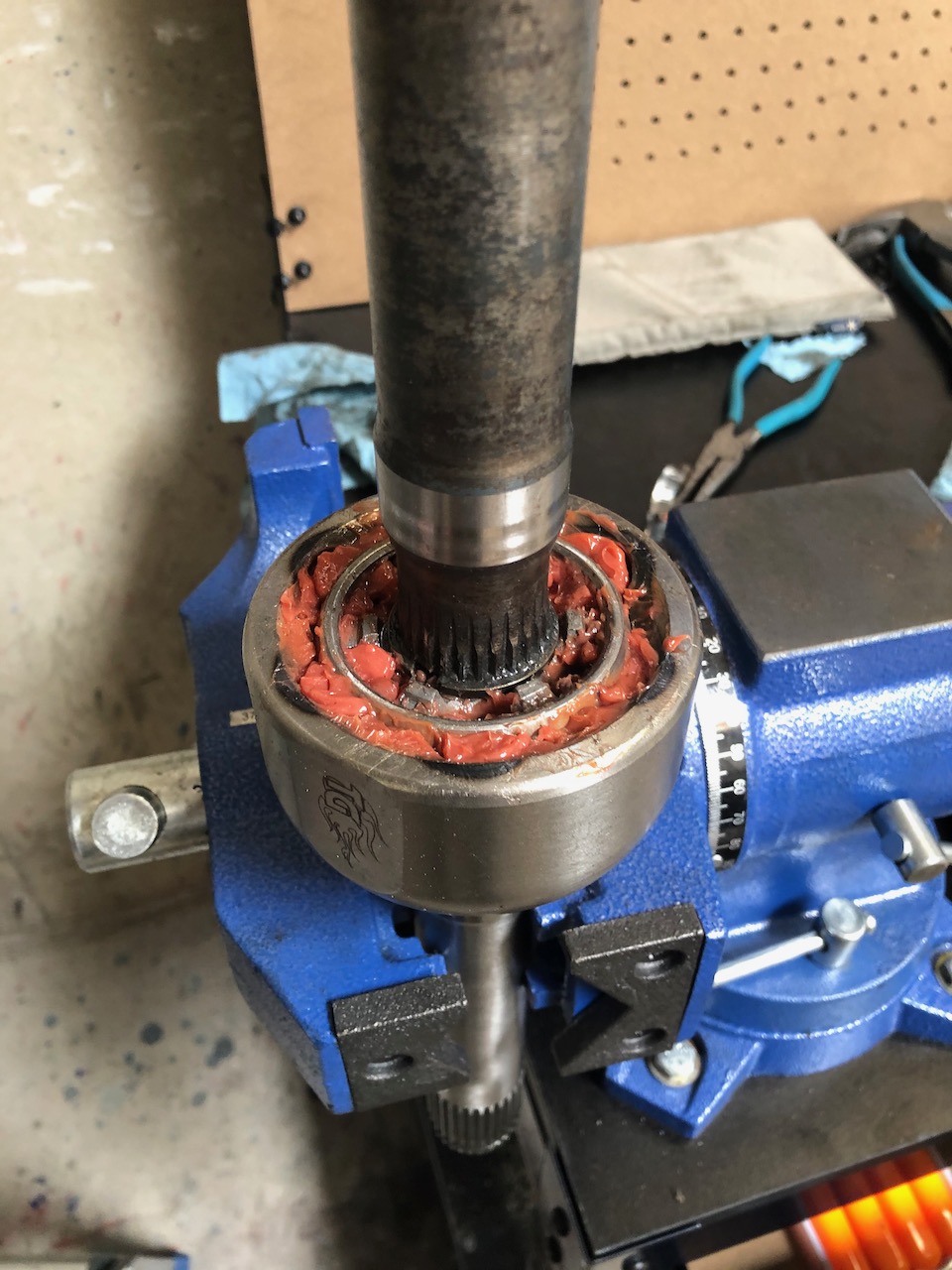

Those little clips that hold the axle shaft to the birf are no fun. By far, getting them in place was the most time-consuming part of the job. @saltycoconuts , if your truck has these, I'd like to rescind my offer to help with your knuckle rebuild! (kidding...mostly)
Strange color, but no metal chunks

The culprit on the left, replacement on the right. The guy at the local spring shop did not have good things to say about the OME u-bolts and used some colorful language about how he'd never run them on anything he worked on or drove.
Finally I can actually hear the ratcheting from the Lock Right which is a nice change from the loud and startling clunks. It is hard to imagine that much noise from u-bolts, but at least I have refreshed knuckles, repacked bearings, clean diff oil, flushed brake fluid, new lights, etc. as a result of my poor ability to diagnose what turned out to be a pretty simple fix.
New one to me. How were the u-bolts causing the noise? Was the spring physically shifting against the axle? What were the u-bolts torqued to?

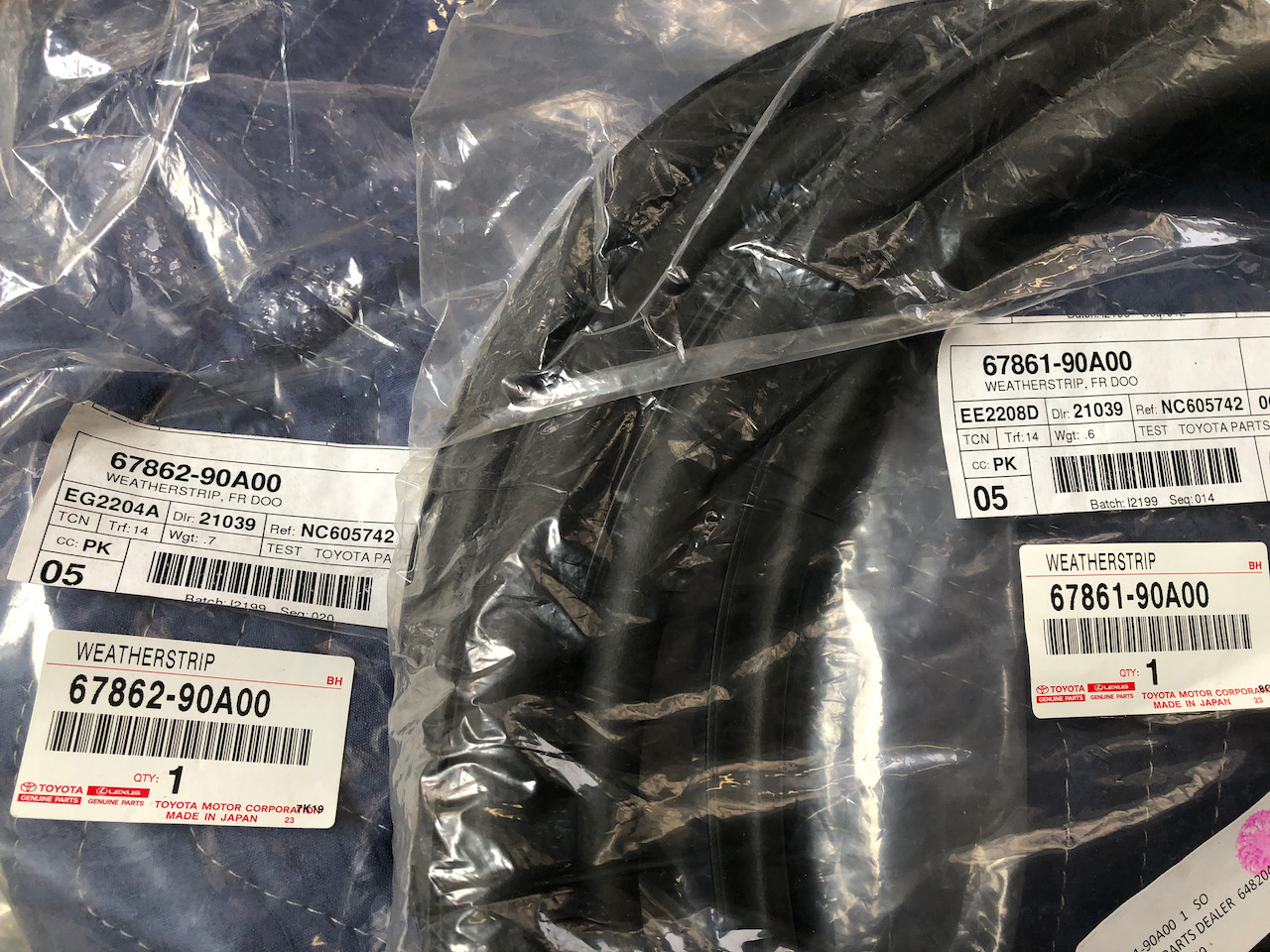

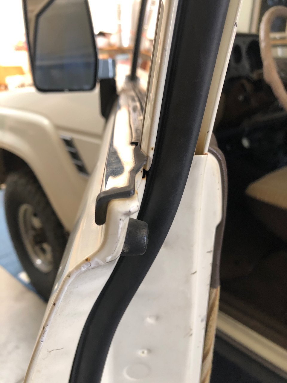

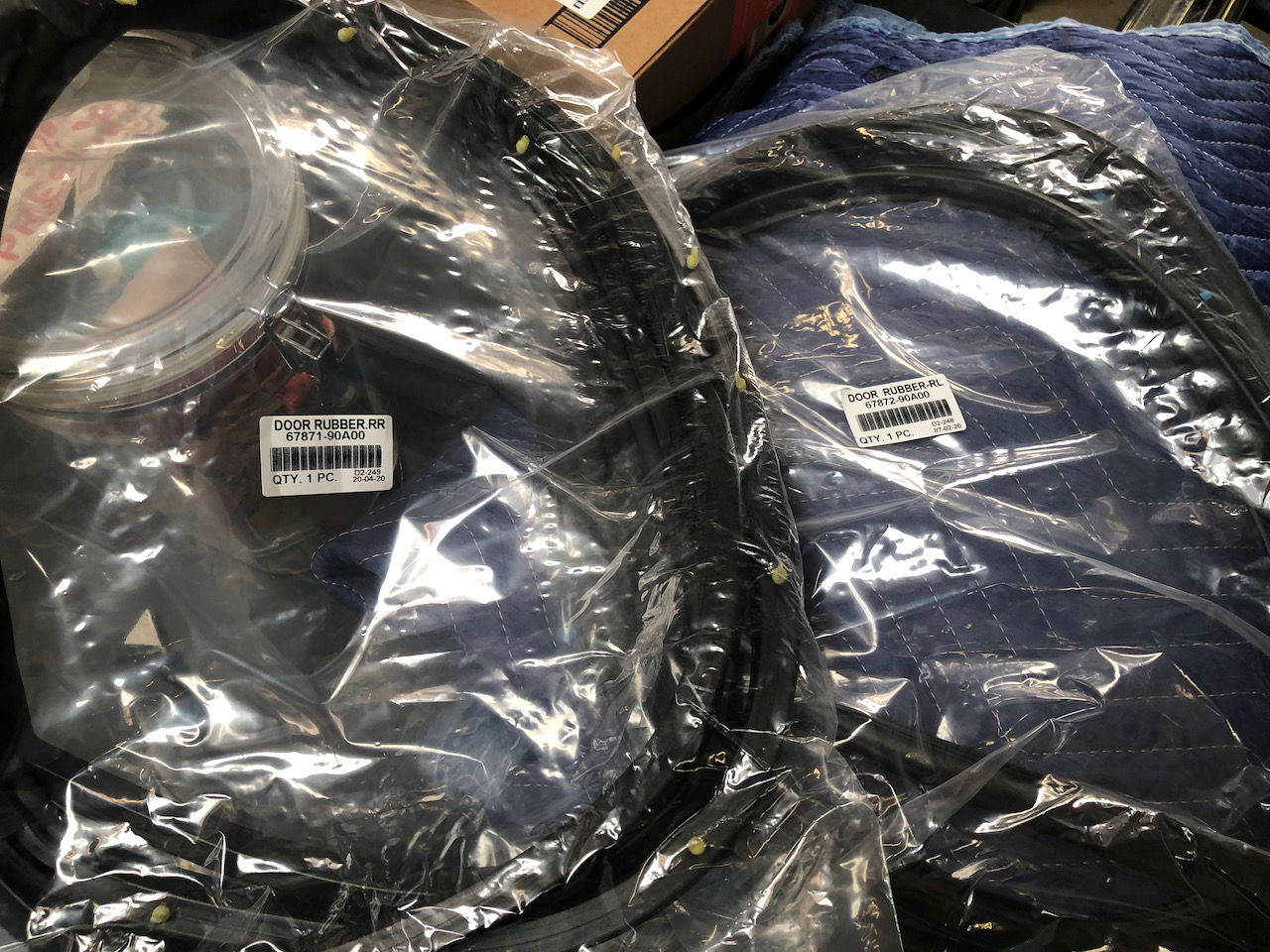

Found some OEM front door seals I bought a few years ago and for some reason didn't install...so installed those.
Part numbers for those looking
Installed
Inspired, I tried to find OEM rear door seals and found (like I must have a few years ago) they are NLA, so ordered replacements from City Racer (@Racer65 ). A couple days later they arrived and installed in maybe 15 minutes.
Such a simple upgrade, I shouldn't have waited. The doors now shut solidly and there's less wind noise on the road (other than that coming from the rust holes in the roof). Maybe there'll even be a bit less water inside the truck next time it rains!

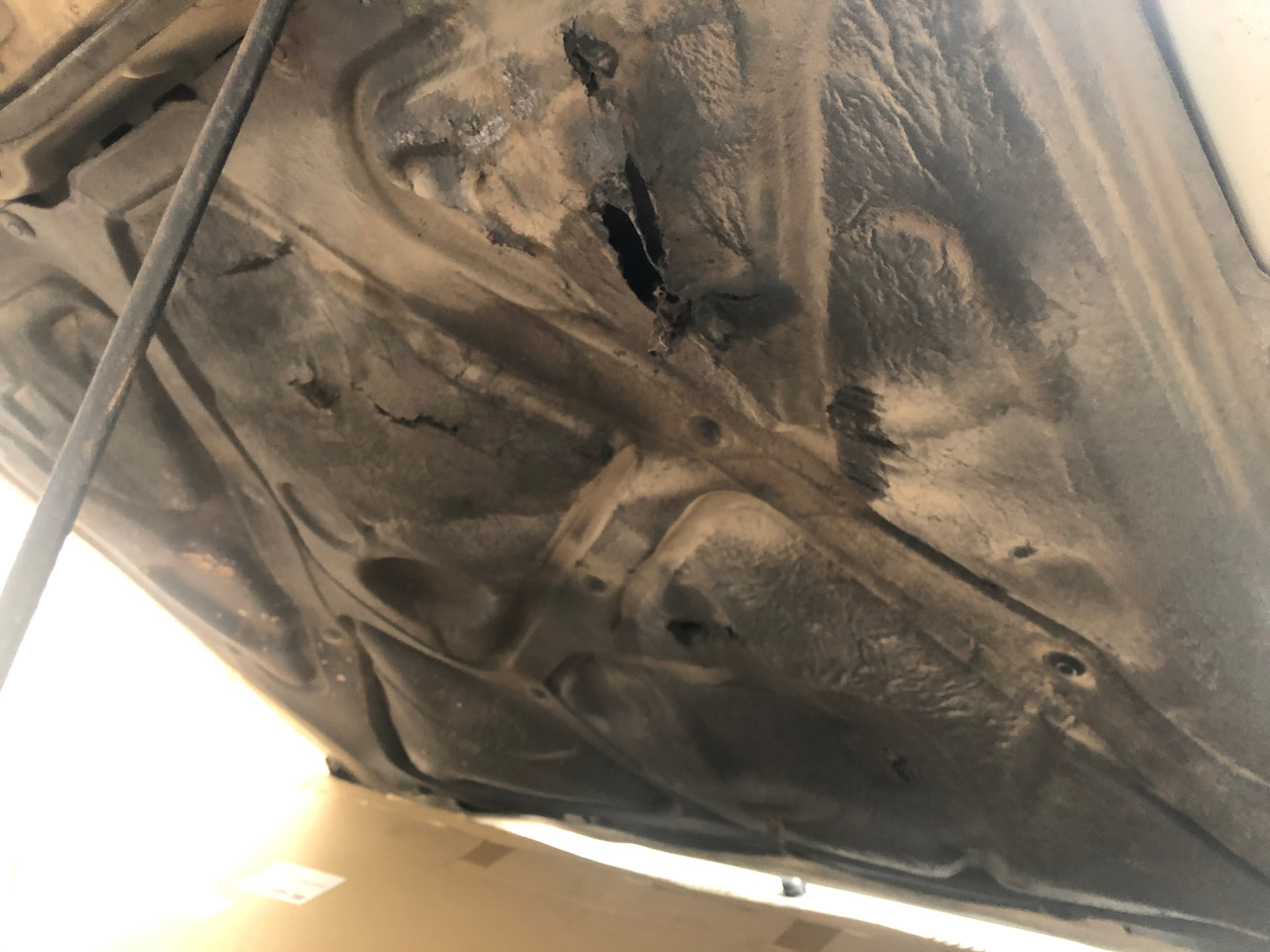

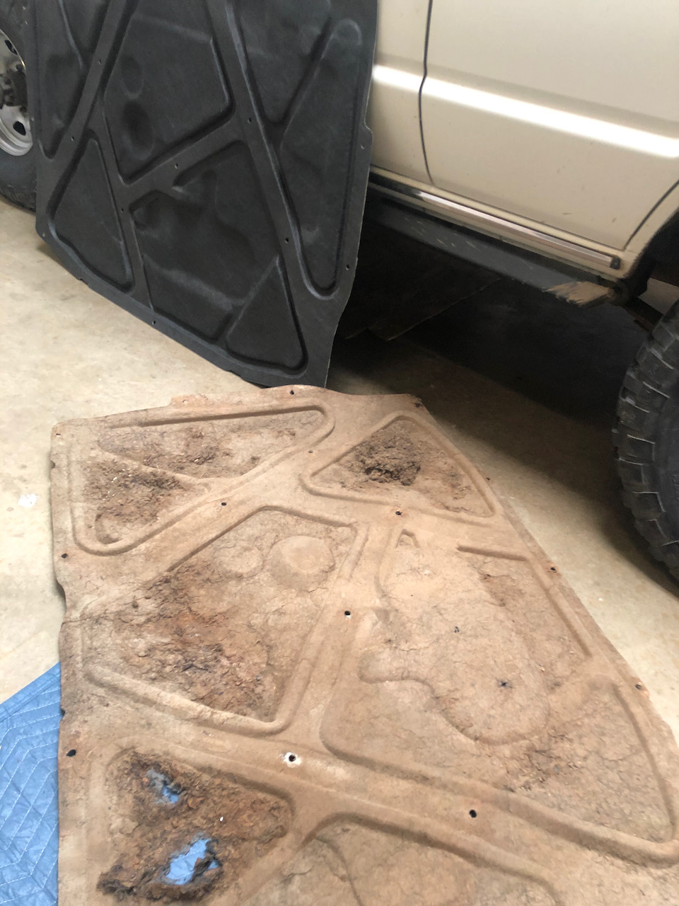

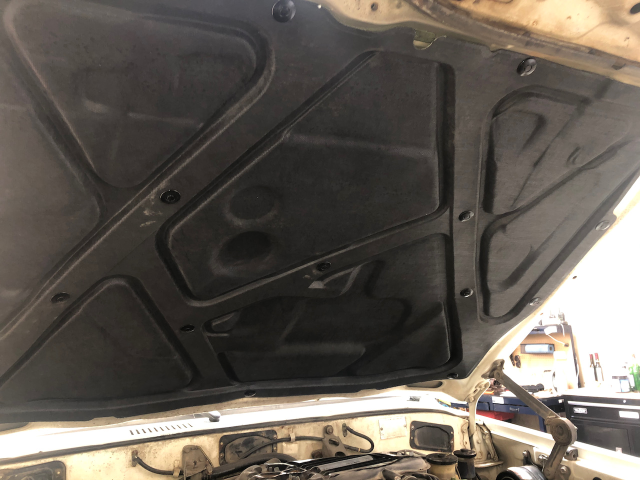

While searching around for OEM door seals online, I randomly stumbled across the hood insulator part number and thought after nearly 40 years, mine might be due for replacement. It was. I ordered from a local dealer to avoid crazy shipping costs and next morning by 7:00am it was ready for pickup.
Before
Discovered an ancient mouse civilization had at one point inhabited the old hood insulator
All new and insulated
To save anyone searching, here are the parts numbers...
Hood insulator: 53341-90A00
Clips (you'll need 17): 90467-09014

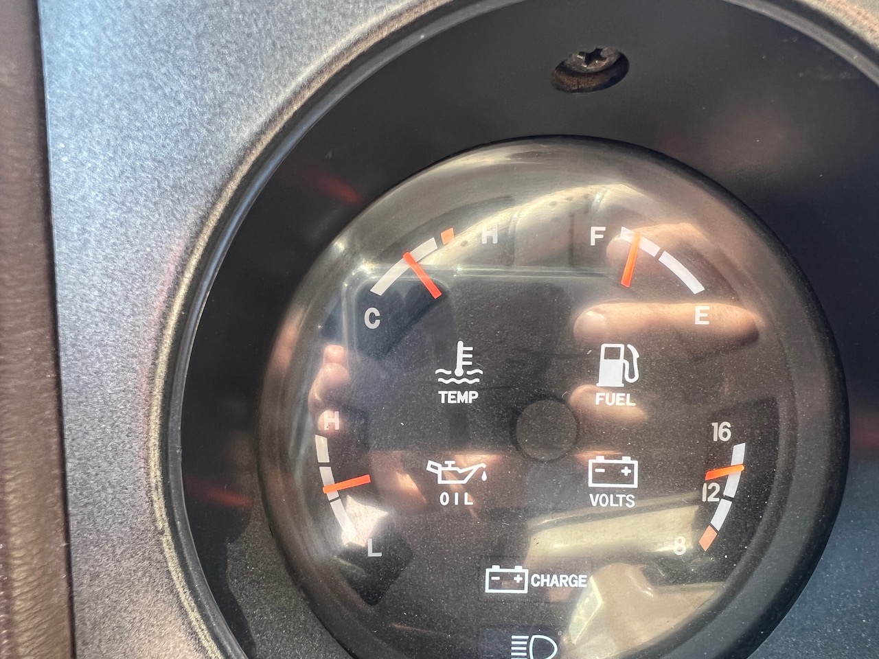

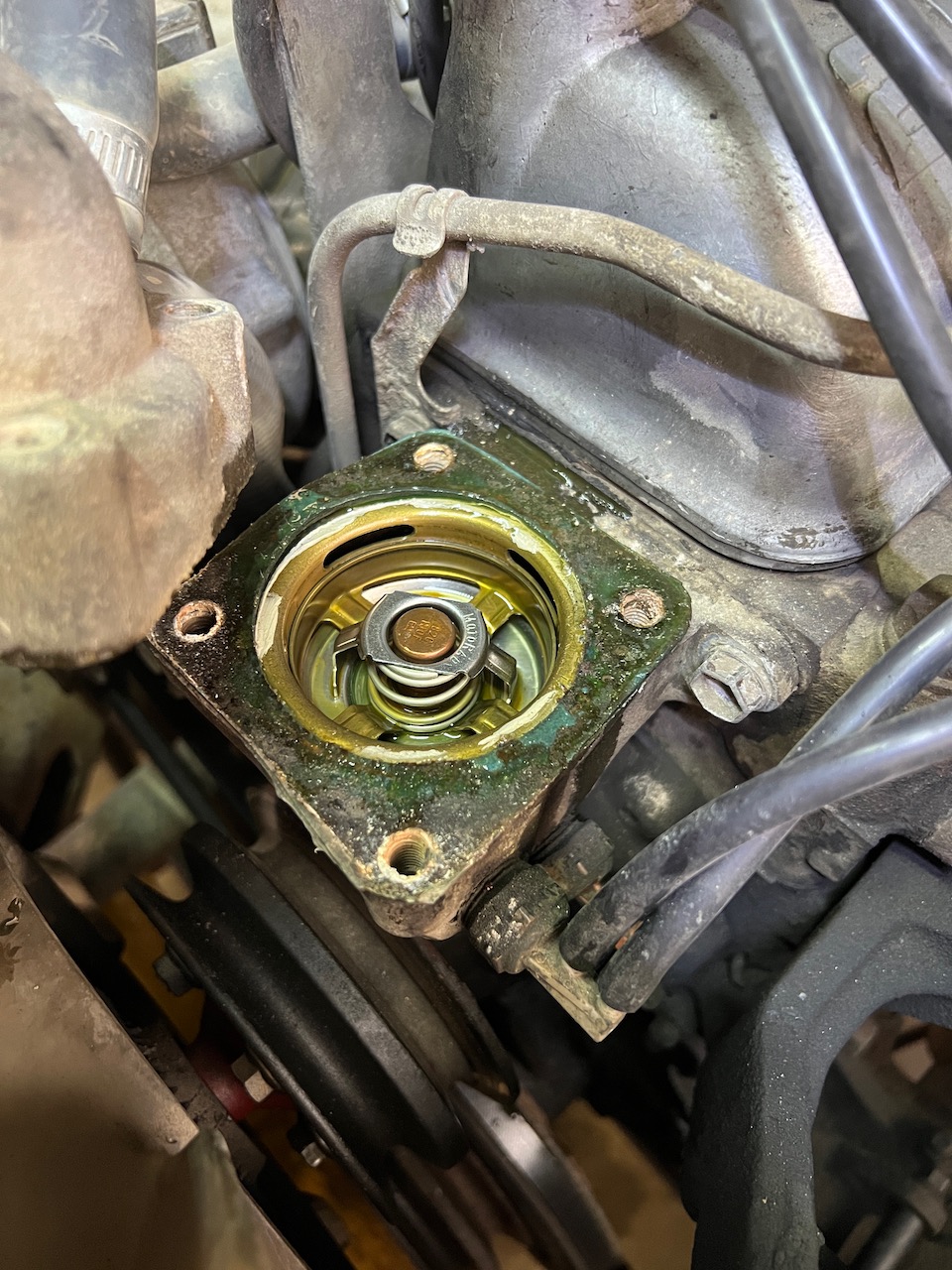

While waiting in line for overpriced gas recently, coolant temps started to creep up to an uncomfortably high level (had previously ALWAYS run cold on the factory gauge). I thought I'd changed the fan clutch and thought I fully went through the cooling when I got Righty, but couldn't find my notes on the fan clutch, so dug in...and fell down a bit of a rabbit hole of while you're in there fun.
Too warm compared to normal readings (pic taken after getting $100 of gas)

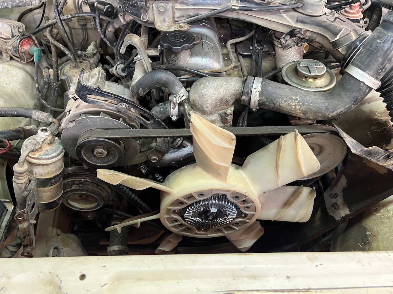

Having no record of changing the thermostat, I decided to do so and found this. Likely the cause of my gauge always reading low temps.
New thermostat, new water pump, new fan clutch (Aisin FCT049), and radiator went off to be refreshed.

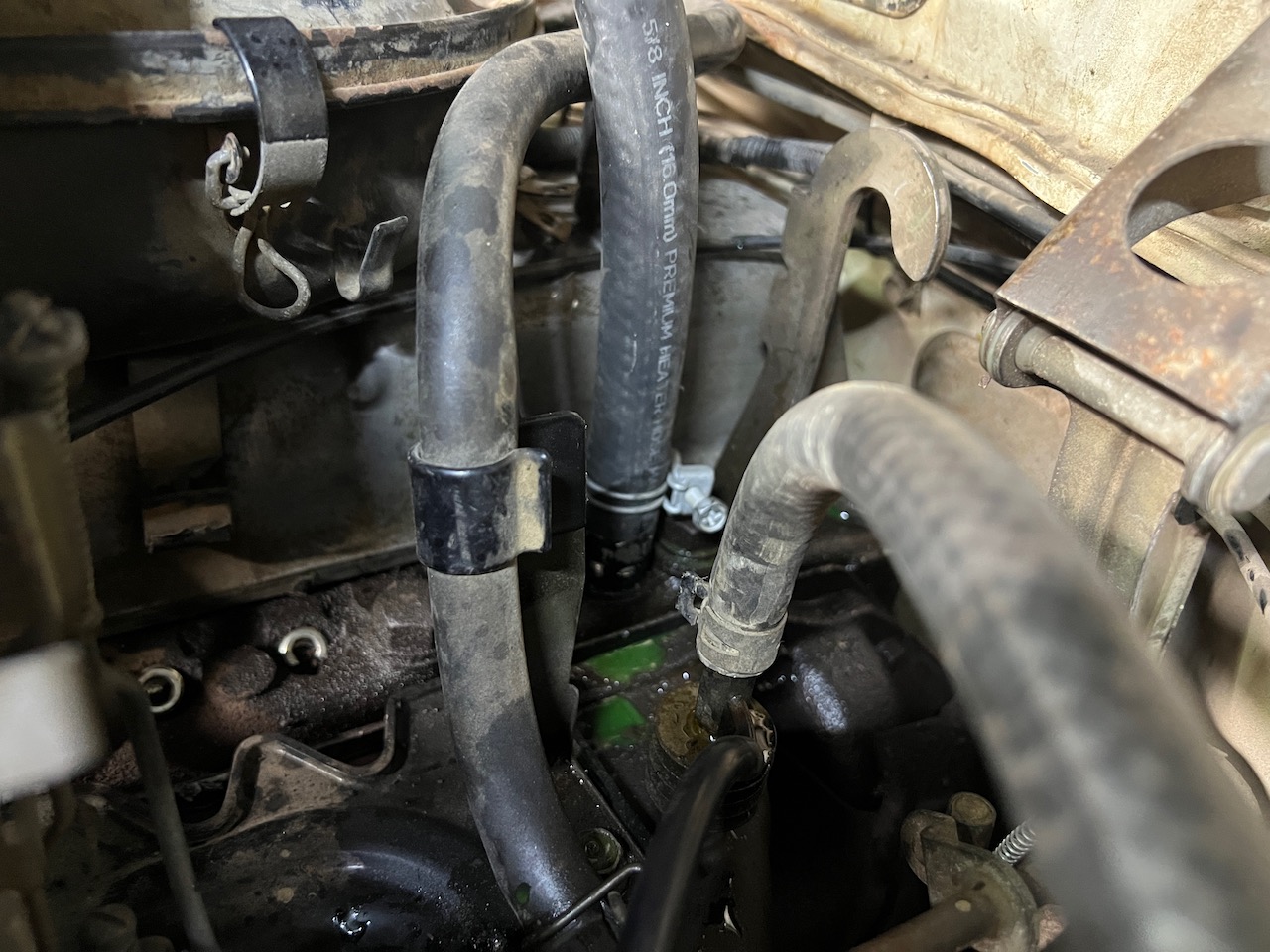

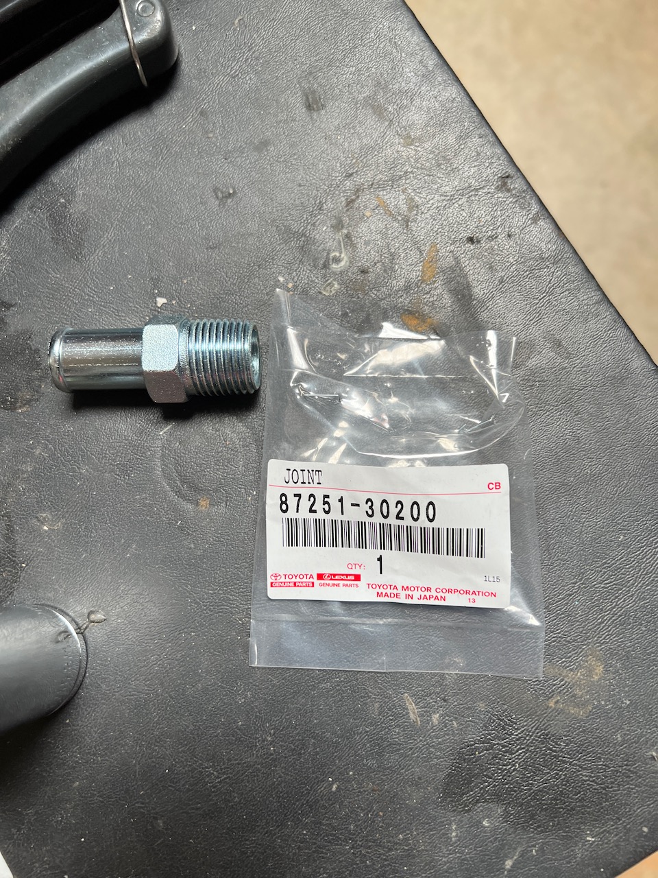

Maybe the problem is that useless rear heater...one thinks without too much logic or really any testing...

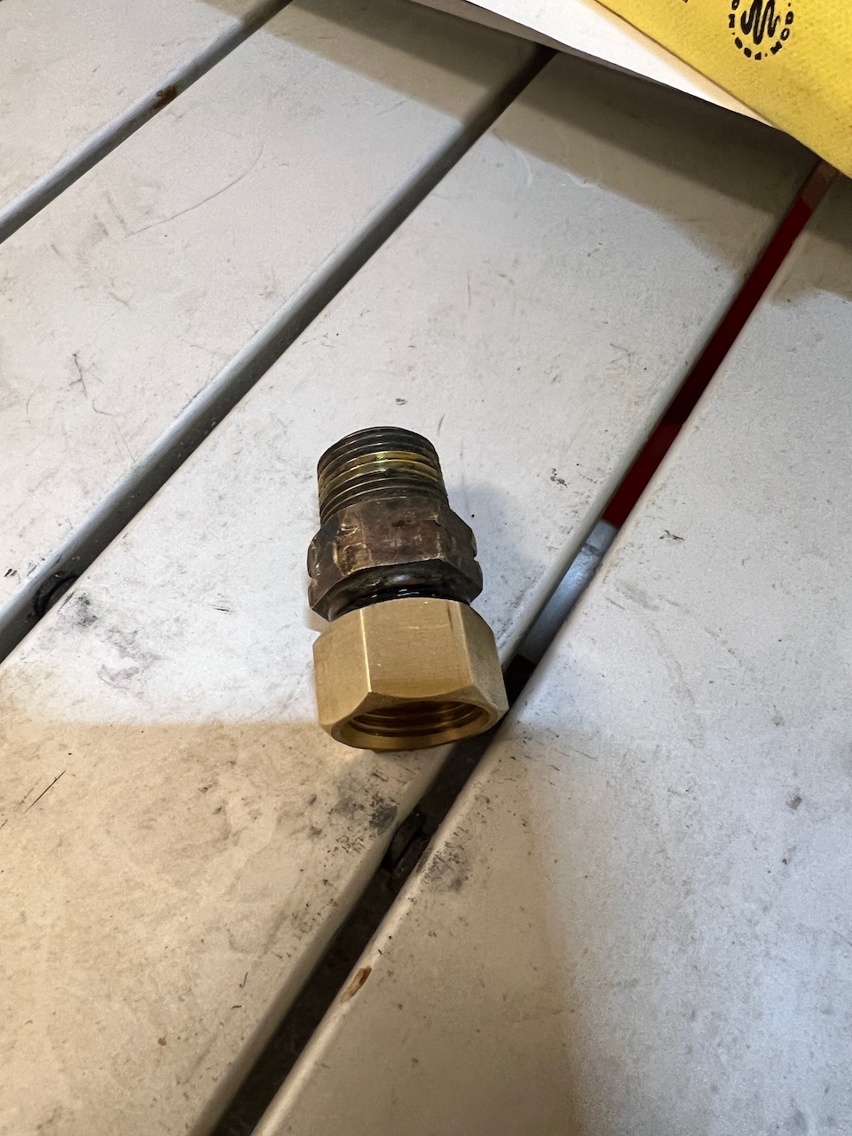

Bought this OEM goodie as part of a rear heat delete, mostly for the name
Installed the "joint" after a lot of PB Blaster and some swearing with a 22mm wrench
Happily removed a bunch of connections and failure points (I told myself as justification for all this work)

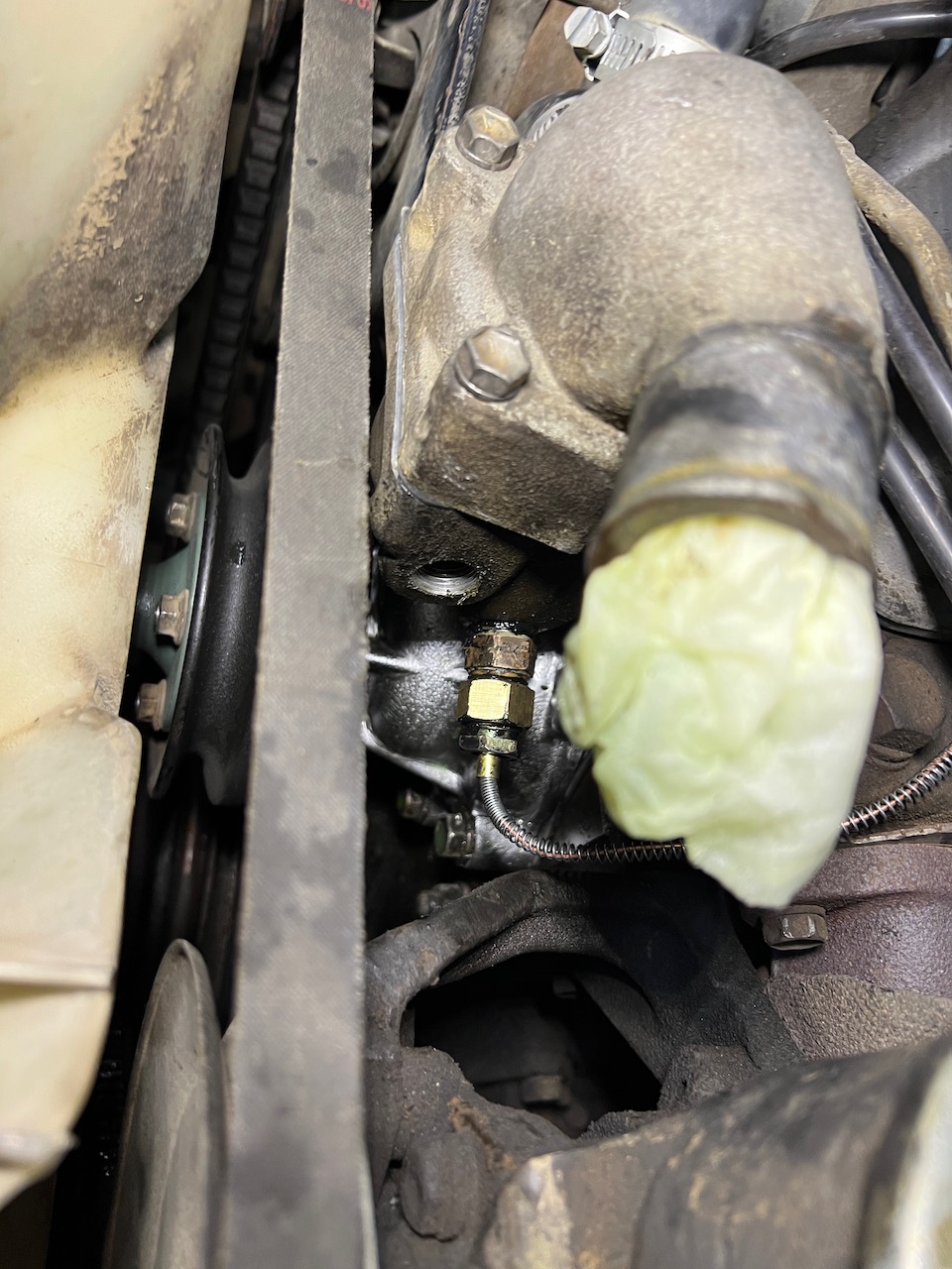

If your read enough here about odd temperature readings on the factory gauge, especially after coolant flushes you'll want a secondary gauge (or an advanced degree offered by @OSS in threads like this one to calibrate your factory gauge) and/or you'll add a secondary temp gauge and if you're cool, you'll use the method I did, copied from @MrOverQualified in this thread to get the temp probe into place.
Drilled and tapped this bit rendered useless by a desmog
Threaded the whole thing in

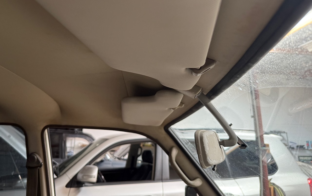

New 70 series visors to replace the saggy and dirty originals

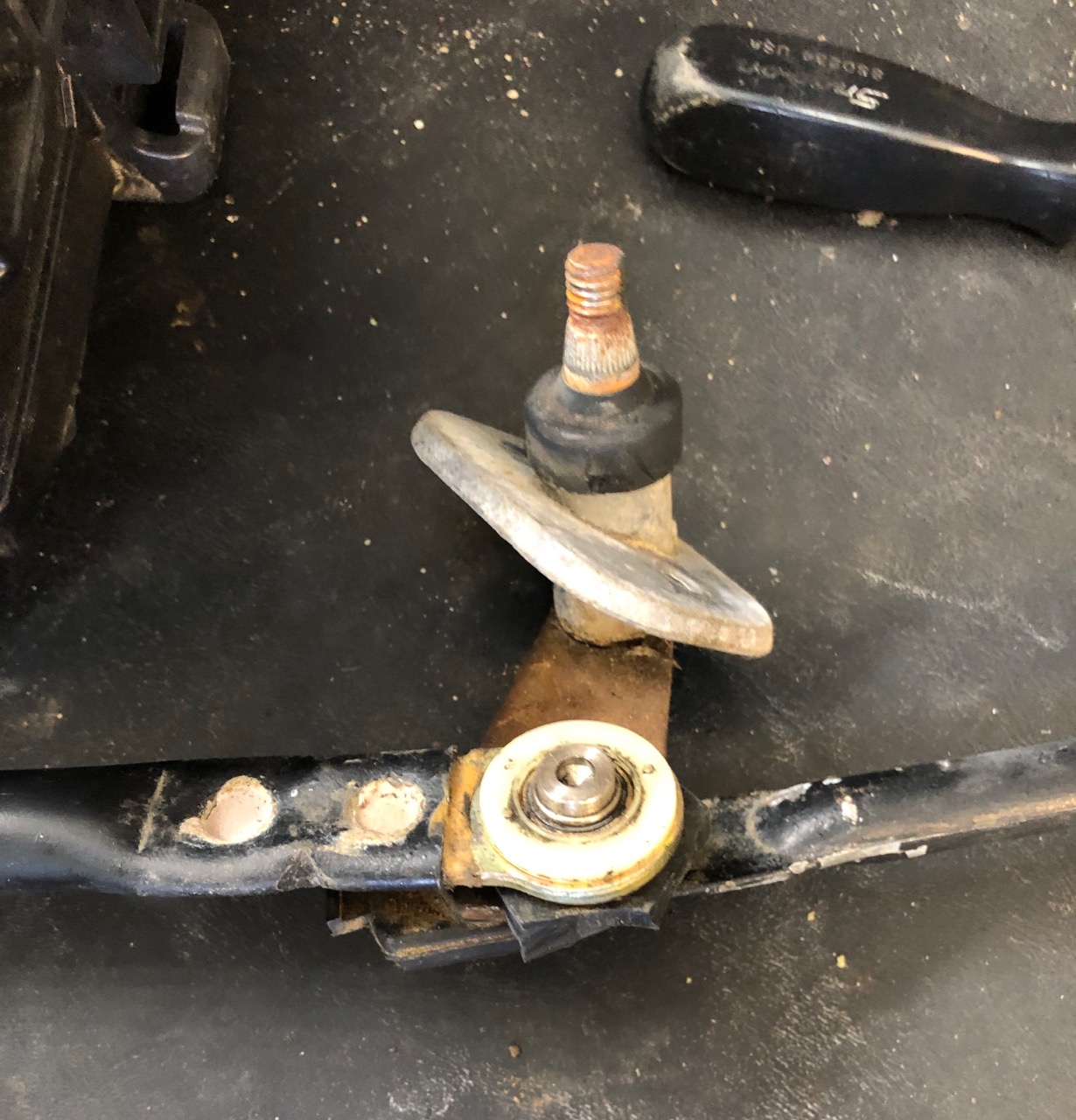

In the unlikely event of rain in San Diego, new wiper arms and blades make a huge difference. One of those, "why didn't I do this before" things.

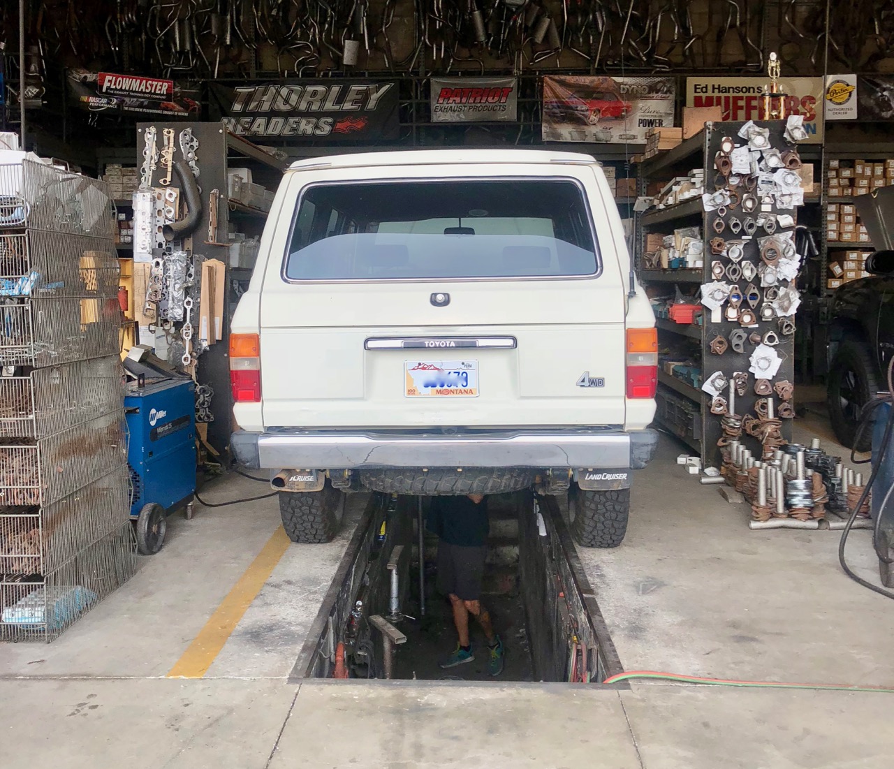

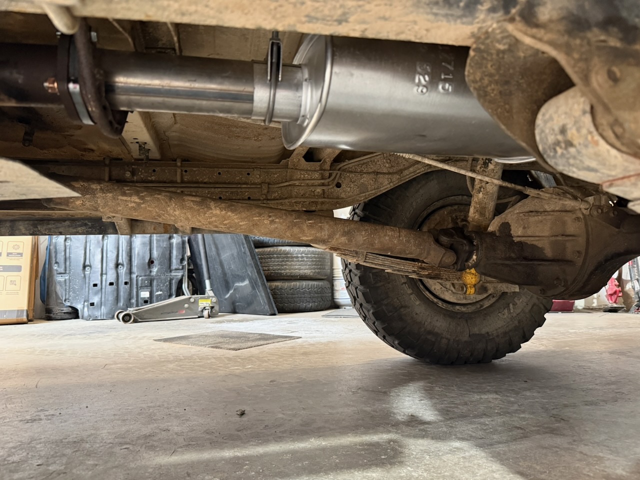

Replaced the "cat back" exhaust using the kit from Man-a-Fre. Another of those, "why didn't I do this before" things for sure.
Everything was going fine...nice quiet ride from the new exhaust, no leaks, new wipers ready just in case...then suddenly coolant pooled up below the truck.

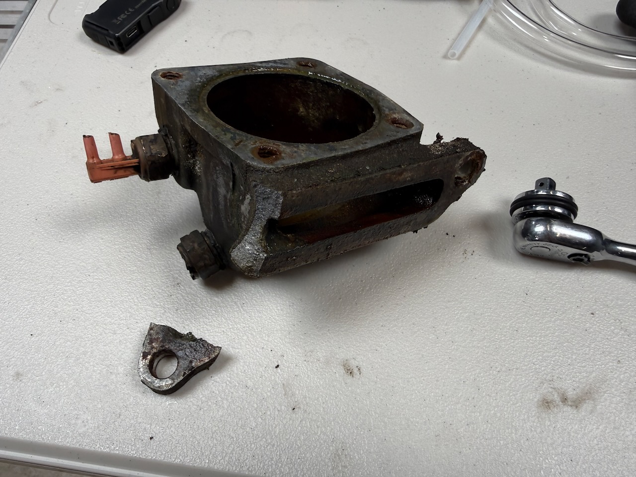

Having changed the water pump and thermostat, flushed coolant, had the radiator refreshed, etc. less than 5,000 miles ago, I was surprised to see a leak from the front of the engine. Pressure tester revealed the lower thermostat housing connecting to the head had cracked.
Broken ear

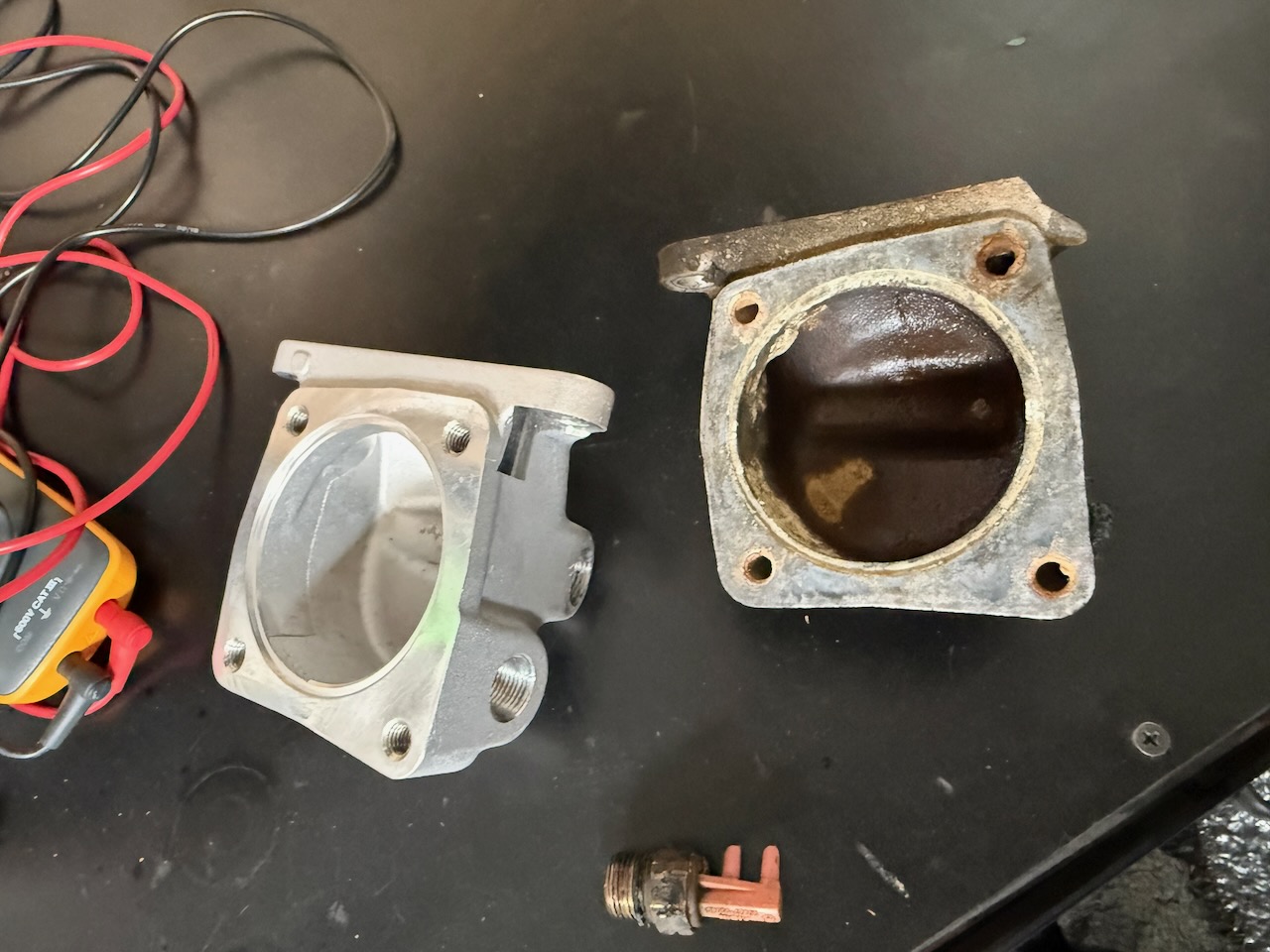

Having coincidentally met Seth from @TRFarmers at a Toyota event a few days earlier, I happily placed an order for a replacement housing. Thanks, Seth!
Certainly looks a lot better and has spots for one of the few remaining vacuum bits after desmog and my aftermarket temperature probe.
Bolted right up, fresh coolant, and so far, no more leaks.
