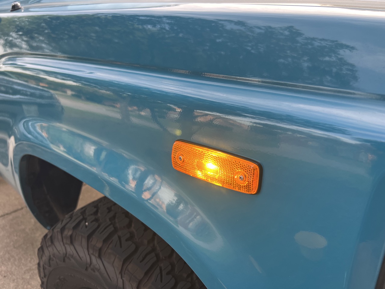

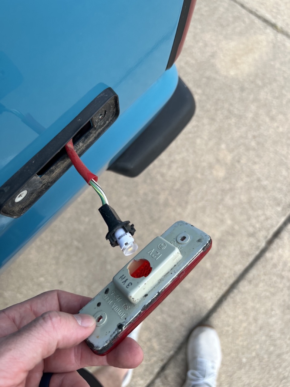

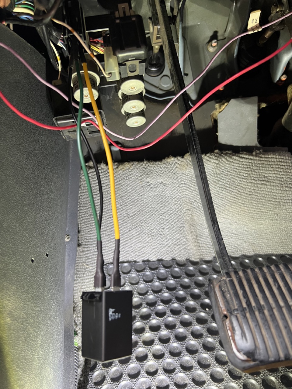

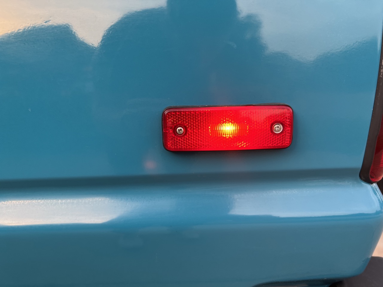

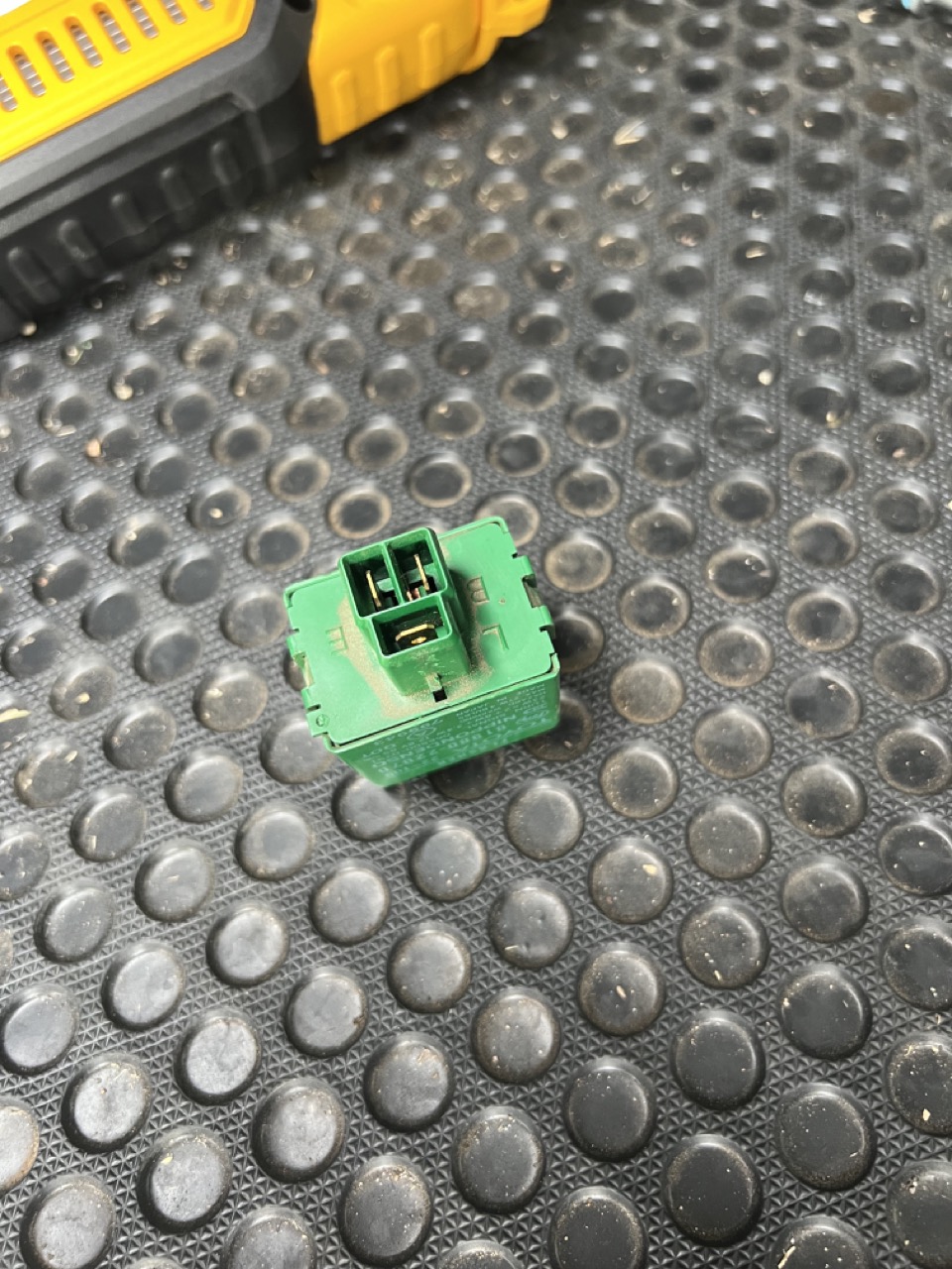

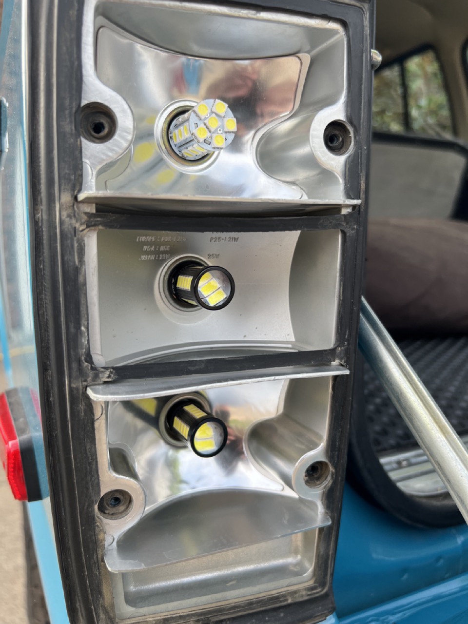

This morning I got home from the gym and needed a little garage time, so I decided to swap out the lights for LEDs, and install the flasher relay. This led to the Cruise Control delete, but I will save that for another post. This kit came with the truck when I bought it, the parts came from Odd Iron Offroad. ODD IRON OFF ROAD: 70 SERIES LAND CRUISERS - https://www.oddiron.com About $240 total, according to the reciept in the box.

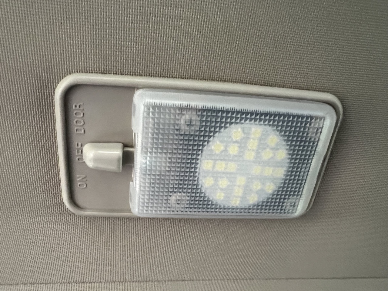

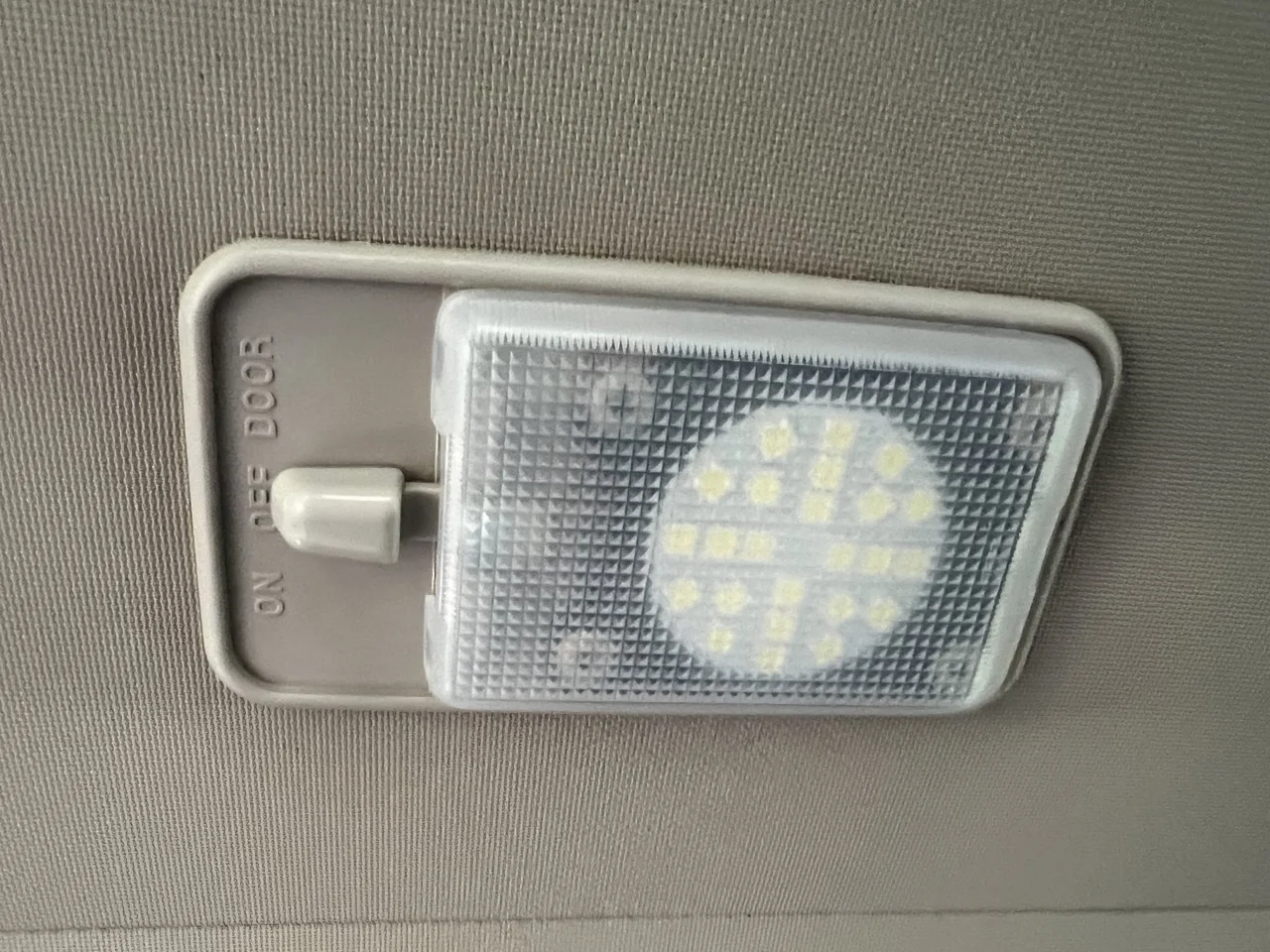

Dome Light and Cargo Light where pretty easy.

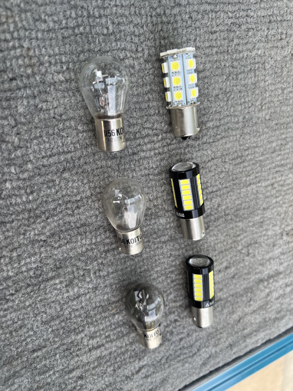

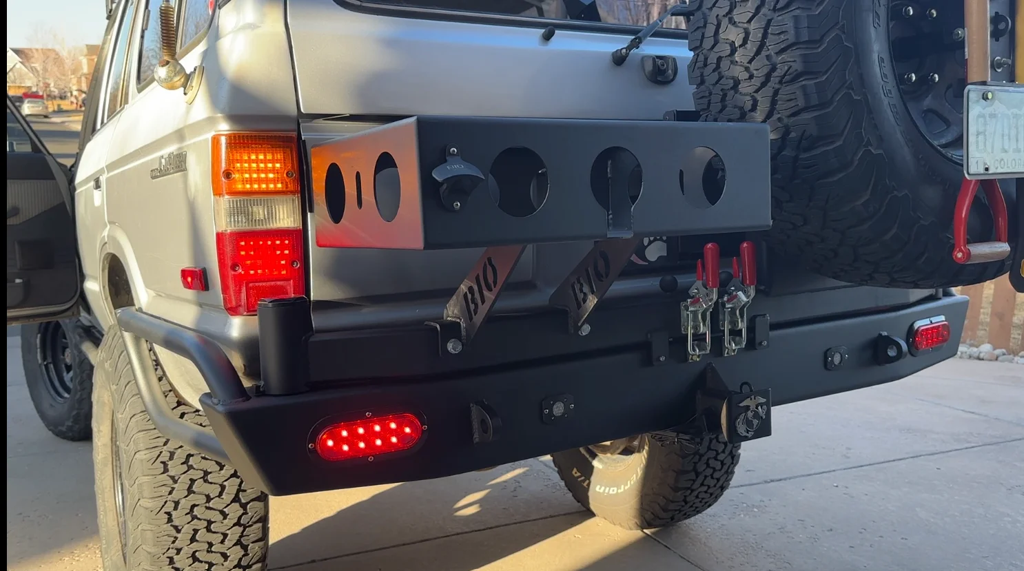

then the driving lights,
before
after
Dome Light and Cargo Light where pretty easy. View attachment 3379406
beforeView attachment 3379409
afterView attachment 3379410
View attachment 3379412View attachment 3379412View attachment 3379413

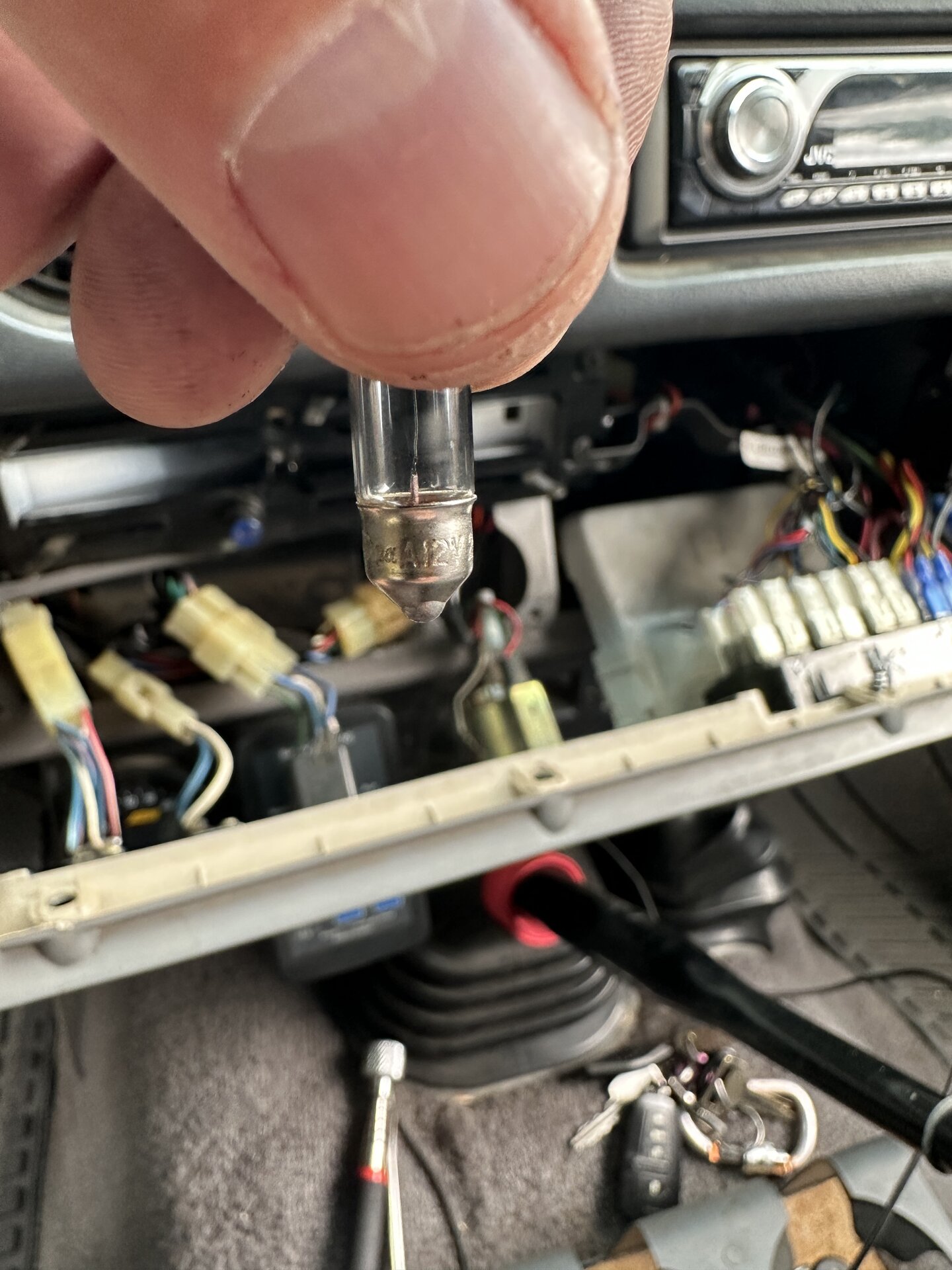

Does anyone know what model # for this bulb? Goes behind the Hot/Cold selectors and fan control cover in the lower dash area. I am looking for a brighter LED replacement. Preferably red to match my SpeedHut instrument set-up.
It’s festoon style bulb, I believe my truck wanted a 13 or 14mm bulb. Lots of people have had no problem with a 15mm bulb.

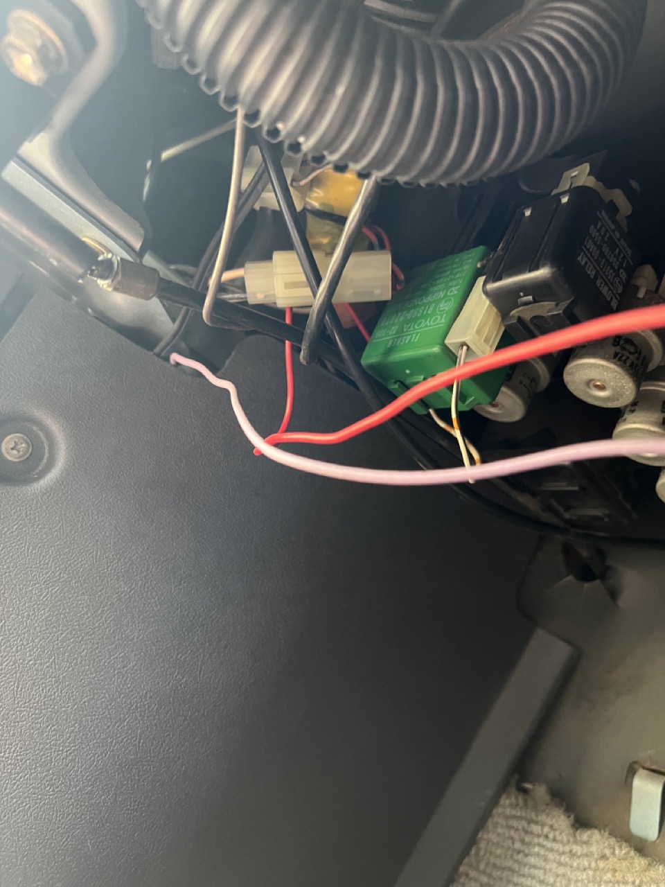

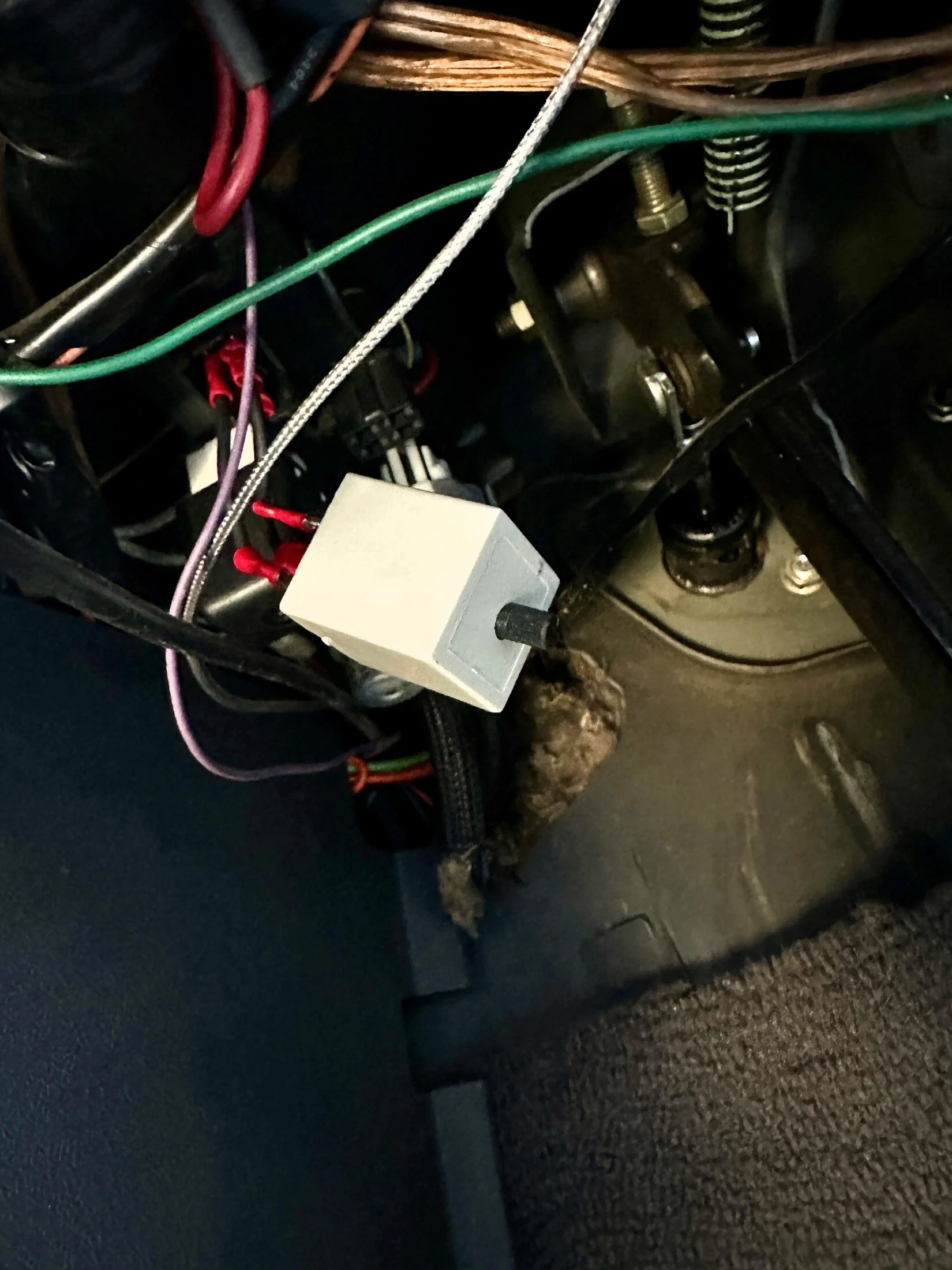

I just installed a Digi-Tails setup on my 60 that I ordered awhile back. Very bright and super easy to install. I had a flasher timing glitch that was corrected by replacing my OEM Flasher relay with the one that came with the Digi-Tails kit. I had to add some extension wires as the generic one they sent didn't fit into the Toyota slot. Similar to what @ax0n did above. It has an adjustable timing knob that allowed me to set the flashing speed to my liking. Worked like a charm.
