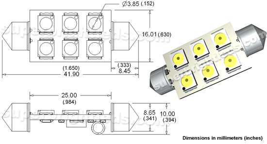

what's the best led to replace the both dome lights?
I've done both dome lights. I think for the price the the front dome light 3022-xHP2 work great. and for 7 bucks...
This is the one i am going to use behind my heater controls w/ a red gel to get the red i want and still have it bright enough. I tried the low power 9 block in red and it wasn't bright enough. I also tried the festoon 4 low power and it really sucked! (EDIT - new HP4 fits same size and likely brighter - gel for color you want)
and for the back i swapped in the 6 HP LED - SUPER nice and bright. awesome to light up the cargo area. 3710-xHP6 and ~15$
(EDIT - updated pics. Also am going to try the HP6 in dome with some mods it is supposed to fit. HP4 will definitely (just newer version of the HP2 i used))

Love how the 6-LED festoon looks in my cargo light so I ordered another one for the dome light and a pair of the WLED-WHP9-T for the front corner lights.

I've tried to fit the 6 high power LED festoon in the dome - let me know if you figure out a way to make it work. I didnt' want to get too crazy and mod it, but it was too big to fit when i tried. But i could just be a pansy, and with enough bending it might fit...

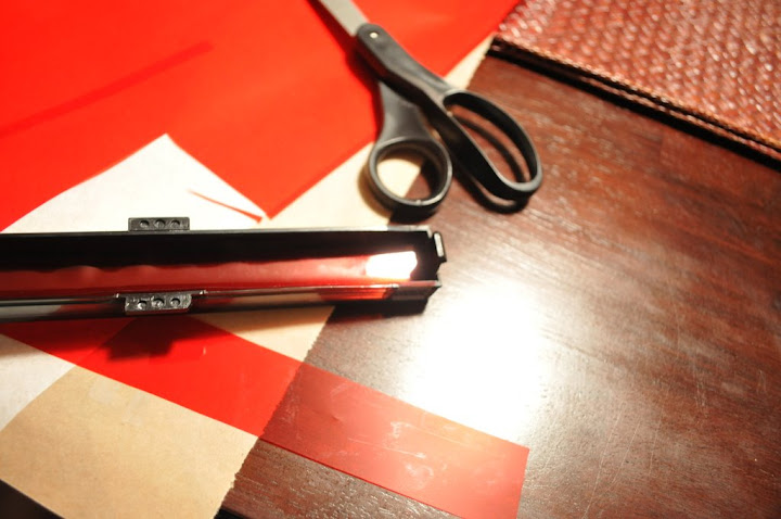

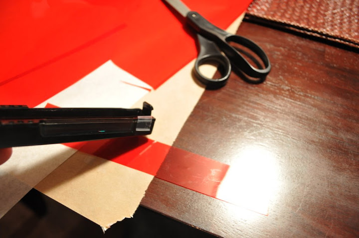

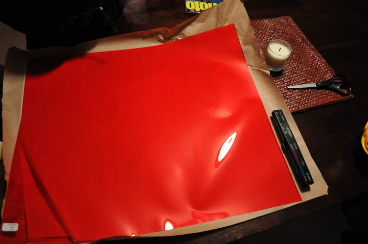

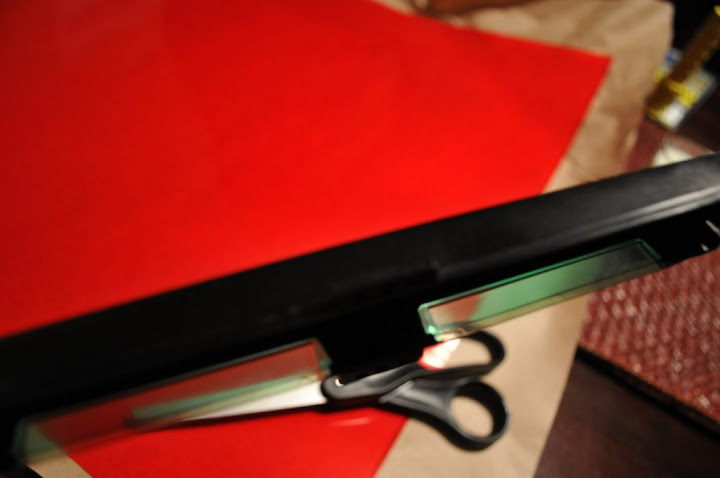

Got started on the red heater controls. I took the HUGE red gel i got online from a theater supply (7$ and 7$ to ship..oh well). I have enough for a ton of these - if someone needs some let me know.
the heater control panel has these windows at the bottom i didn't originally plan for.
I decided to cut the gel a bit wider to bend and then cover these clear sections.
A bit of scotch tape to hold the first piece in...
you can see the first piece folded into an L and in it:
I decided to do two layers of this red to make sure it's red and not orange. By shining a light through it i gauged this should work better. i can pull the tape and remove one easily as i offset the tape a bit for that reason.
I wanted to give you guys an update on what i was doing, but haven't installed these yet. I am going to get some video soon and work on posting here to show how bright they are.
