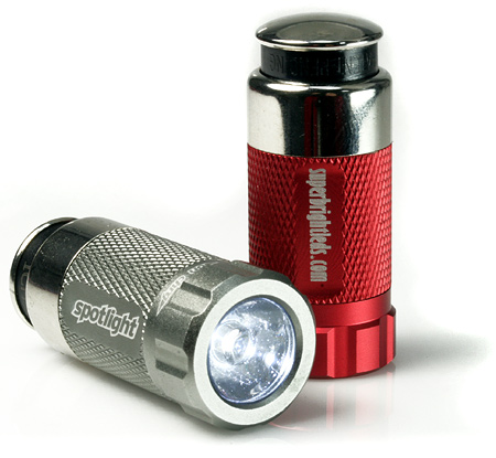

Also - i got one of the cig lighter 1/2 watt LED flashlights too (told you i was a LED geek). PRetty damn cool. It plugs right into the cig lighter and shows charging w/ red light. supposedly 2 hrs burn time from a charge (but takes 8hrs to charge) - i've used mine several times already since it's nice and small, plus always handy!
Here it is from superbrighleds.com:
rob

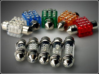

I also got some new LED's (go figure). I'm swapping a bright red LED into inclinometer before install so it will match. Plus tried 2 diff red ones for heater controls. Plus played around w/ some for the dome light/rear light.
Here's the one for inclinometer: (EDIT - new bulb version)
Here's both i tried for the heater controls:
(EDIT - both the small circular and the brick version in colors i wanted)
(i think the 4 bulb festoon is too dim. the 9 LED square works better and was same as i have in my original blue swap.) (EDIT - i'd go with the newer HP festoon like the 4HP below and use a gel for whatever color you want. The 9 LED "brick" is pretty low power)

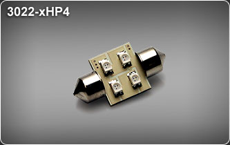

Also, have George's LED dome light (TaskLED Home) (i have older style. White LED lighting) so tried superbrightleds.com 2HP for new dome light. Need to try these side by side for comparison - but seems really nice and 7.00 instead of 30.00! (i've had George's for 3+ yrs and it's great, but LED's have come a long way...)
Here's the (EDIT - 4HP now only one available) one (also fits in heater controls if you want bright white light (EDIT - probably pretty bright - gel?)).
I tried the 6 HP LED like above HP2, but is too long (37 or 38mm) so won't fit without getting creative...
Also, probably get 1 more of the 2HP above for rear interior light as well.
