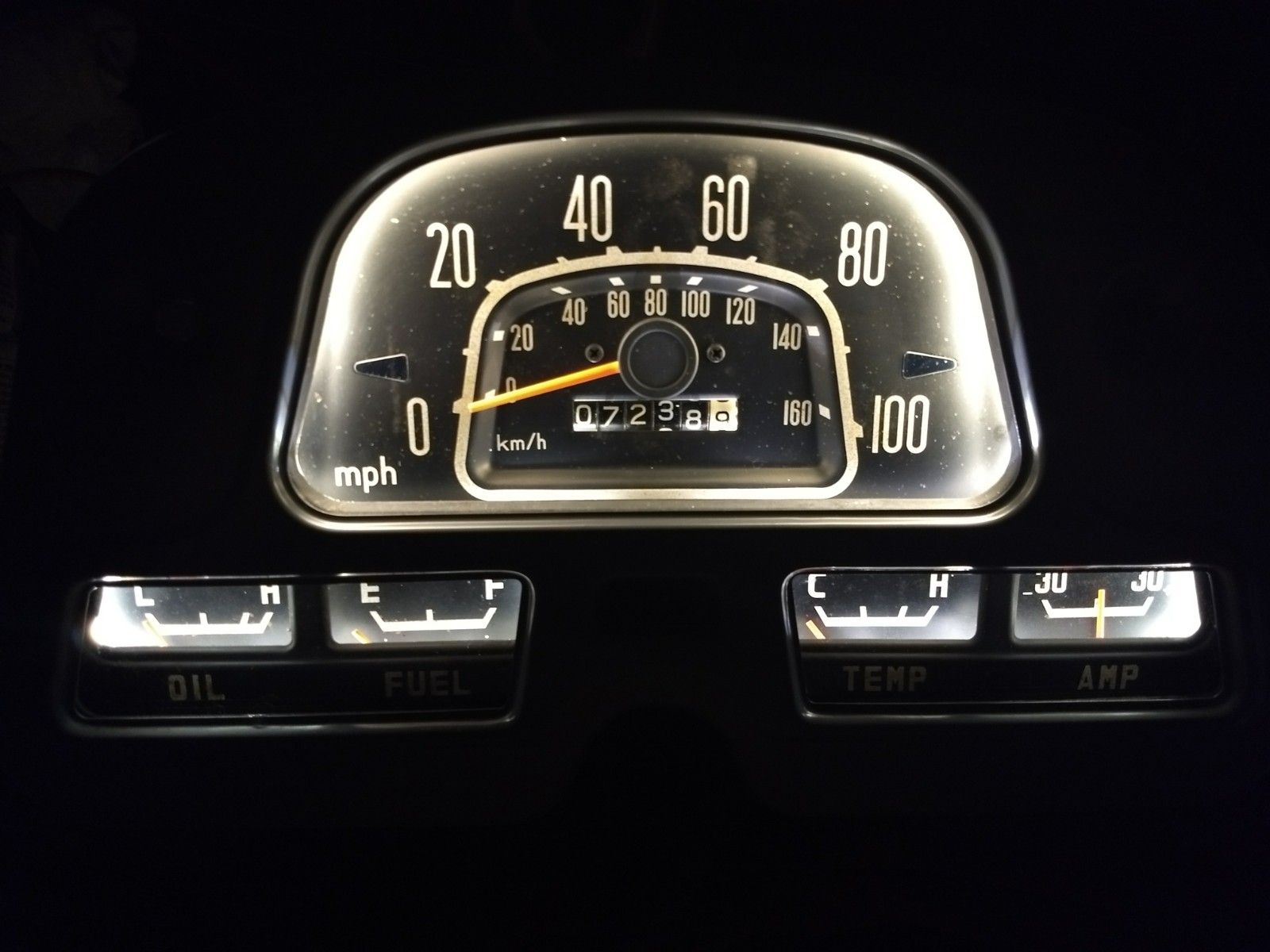

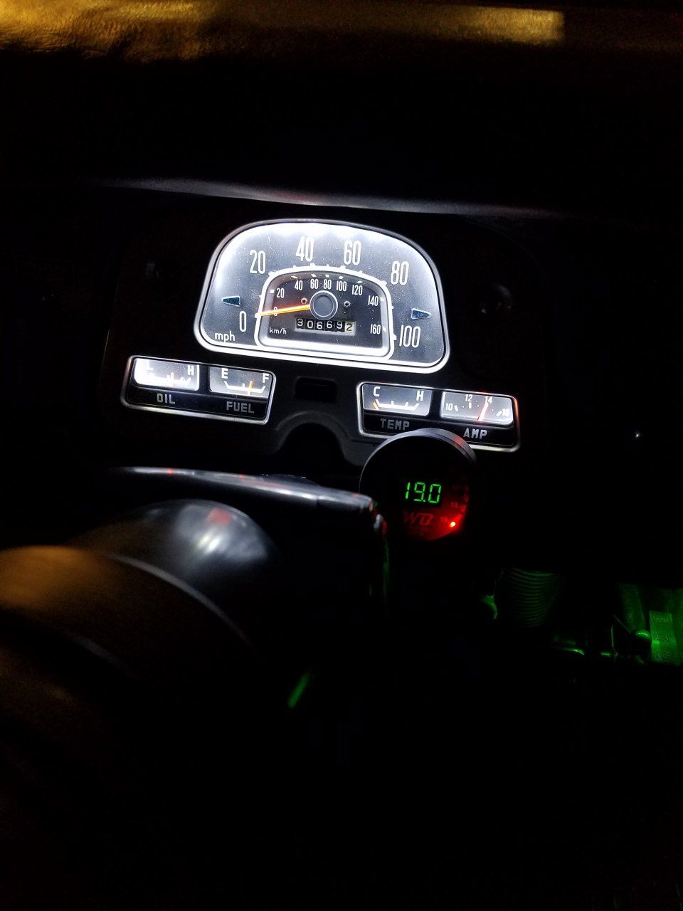

Here is the final result:
One of the things I like about this solution is that the odometer and speedo numbers get lit up nicely. It seemed that the EL wire didn't get much light to these areas.

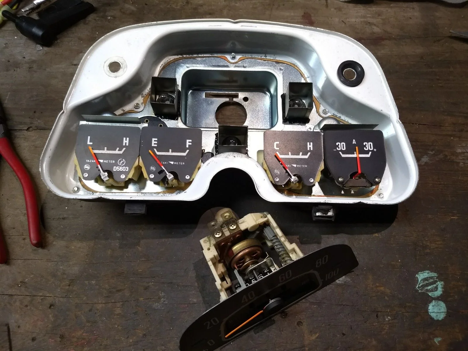

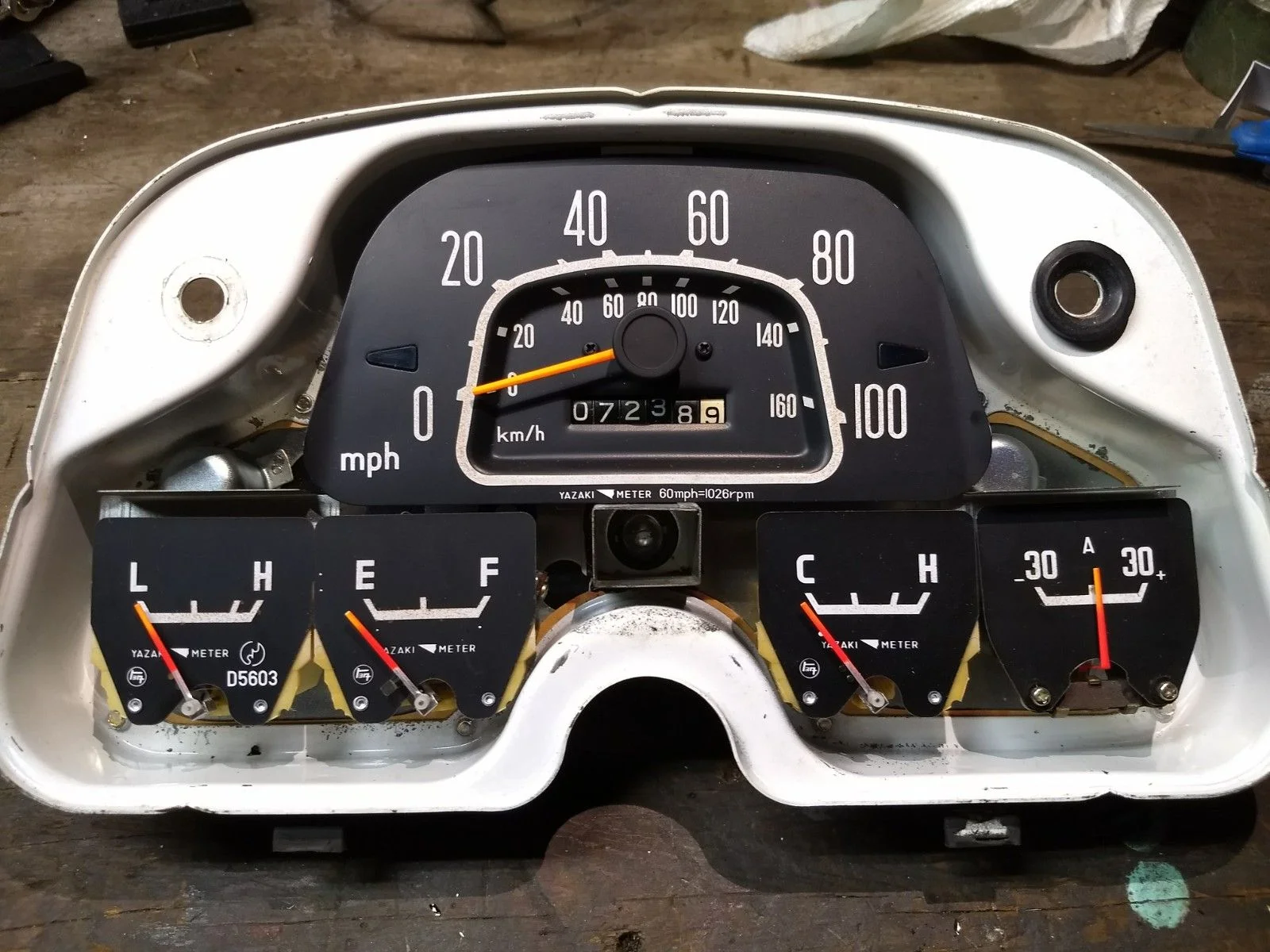

After removing the cluster from the truck I started by pulling the face and black panel off of the cluster.

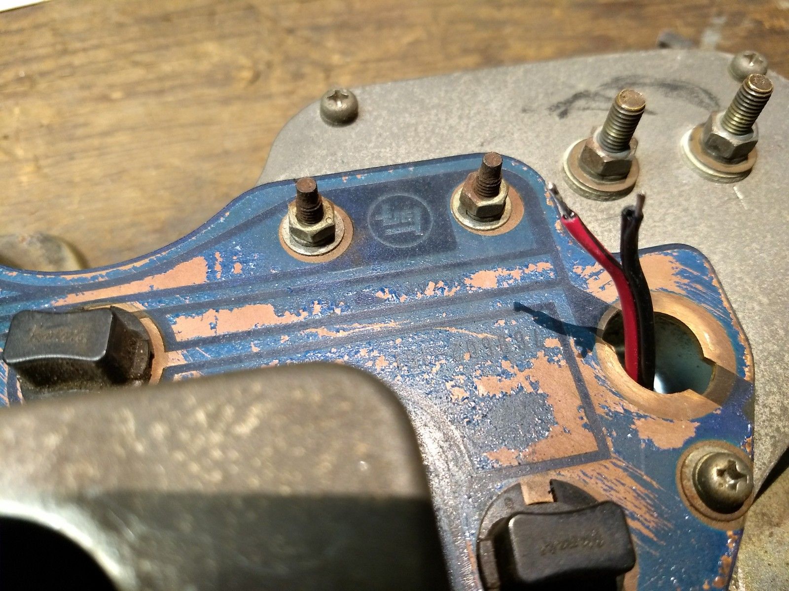

Then I removed the speedometer. There are 2 screws holding it in place and 2 wires going to the speedo that can be accessed from the backside.

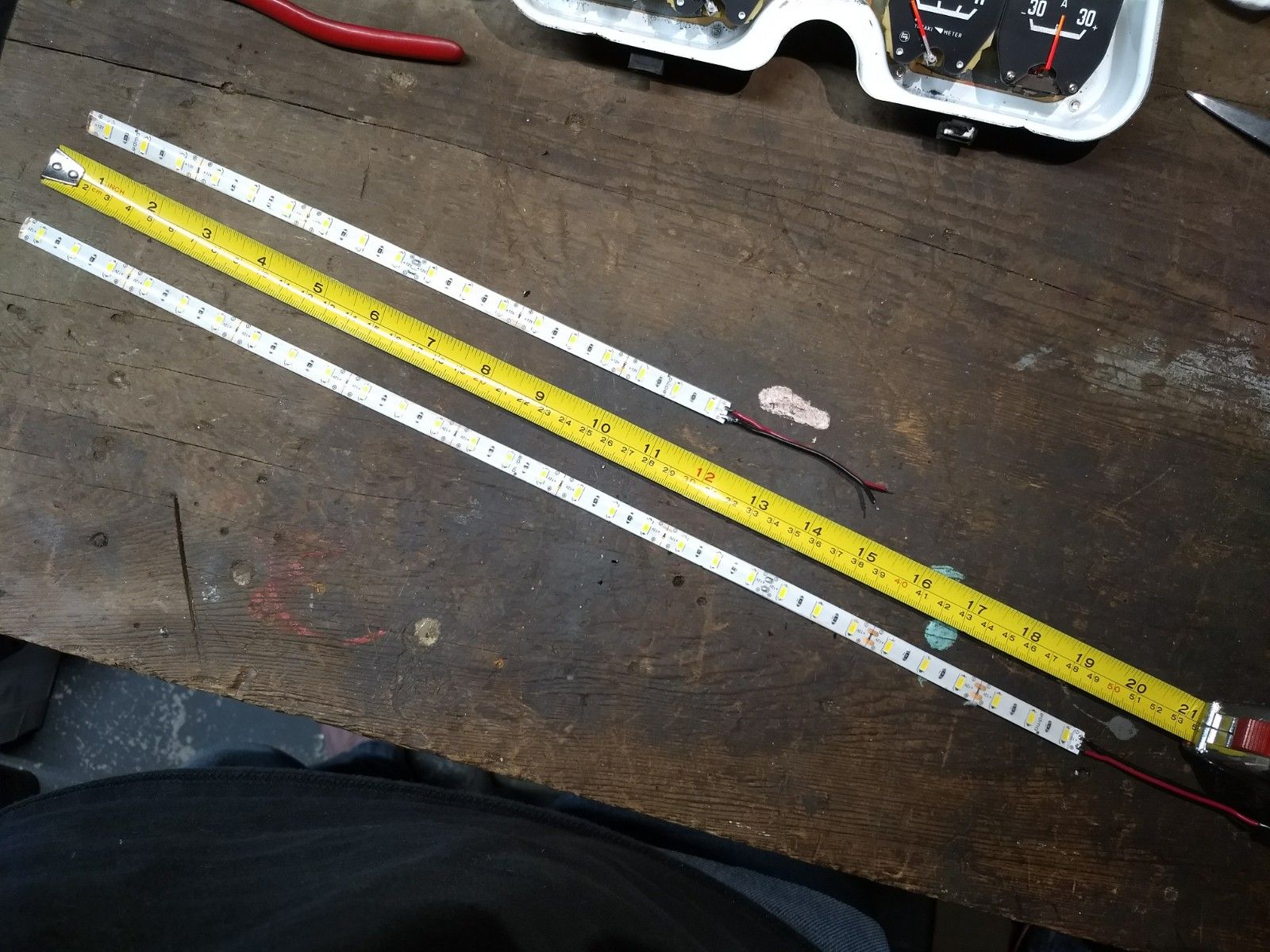

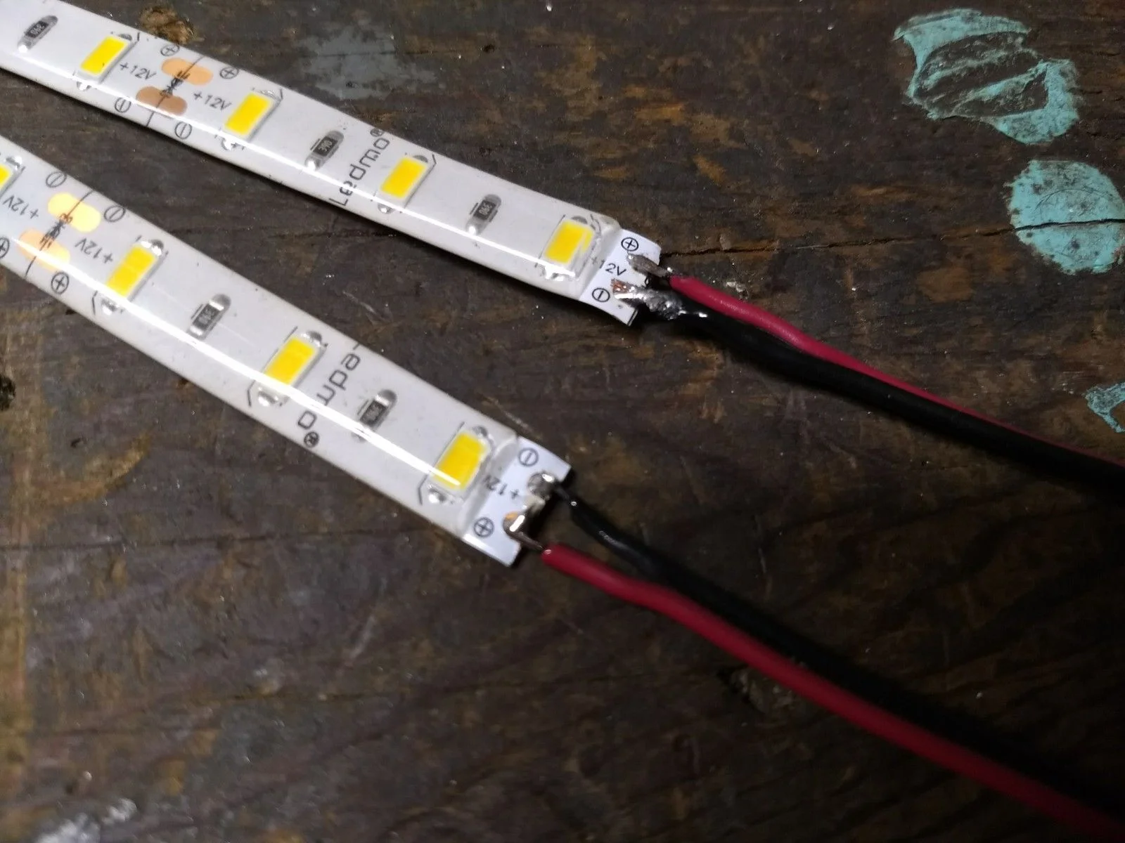

I used 2 pieces of LED strip instead of one long one. This enabled me to better balance the light going to the speedo with that going to the 4 lower gauges.
Cut the lengths of LED strip and solder leads (there are plenty of YouTube videos abut this process - it is easy) (Note: the lengths shown here are 2" too long, I ended up trimming both pieces by 2")

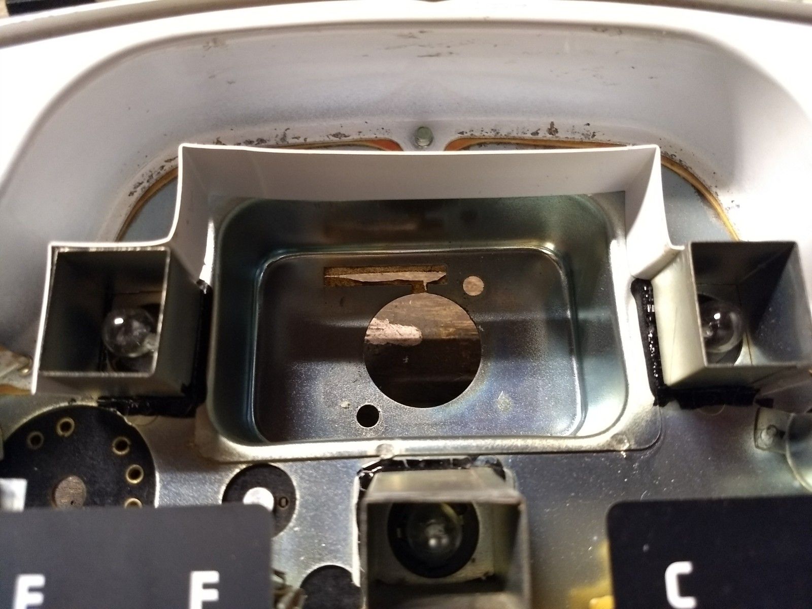

The cluster was originally lit by 2 light bulbs that fit in from the back through 2 holes and the bulbs are shrouded by these little "hoods"

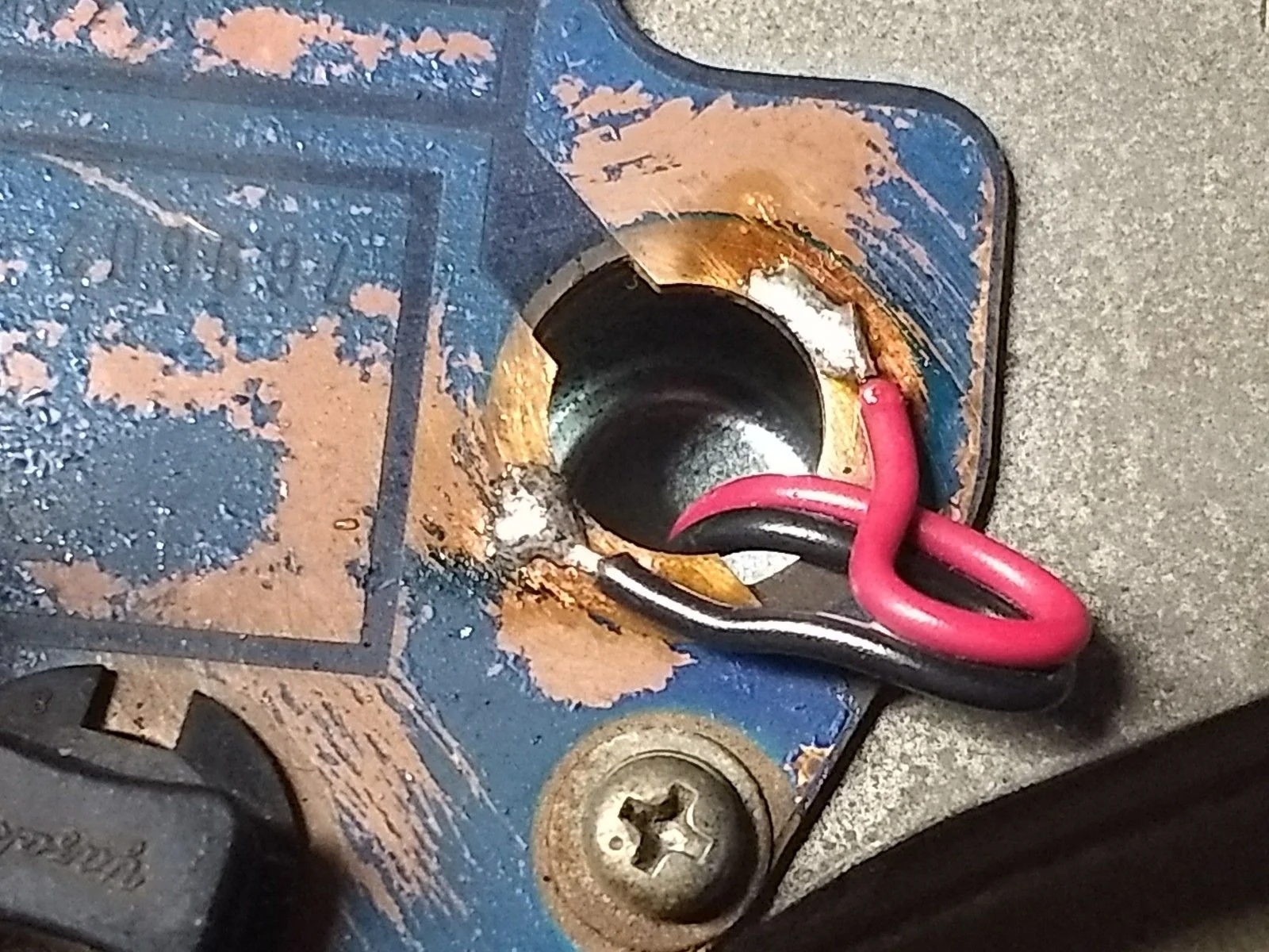

At the end of the install of the actual LED strips I soldered the wires to the circuit board where the original bulb's sockets got their power. Note: you need to make sure to have the + and - in the right orientation or the LED strips will not work so test before you do a final solder.

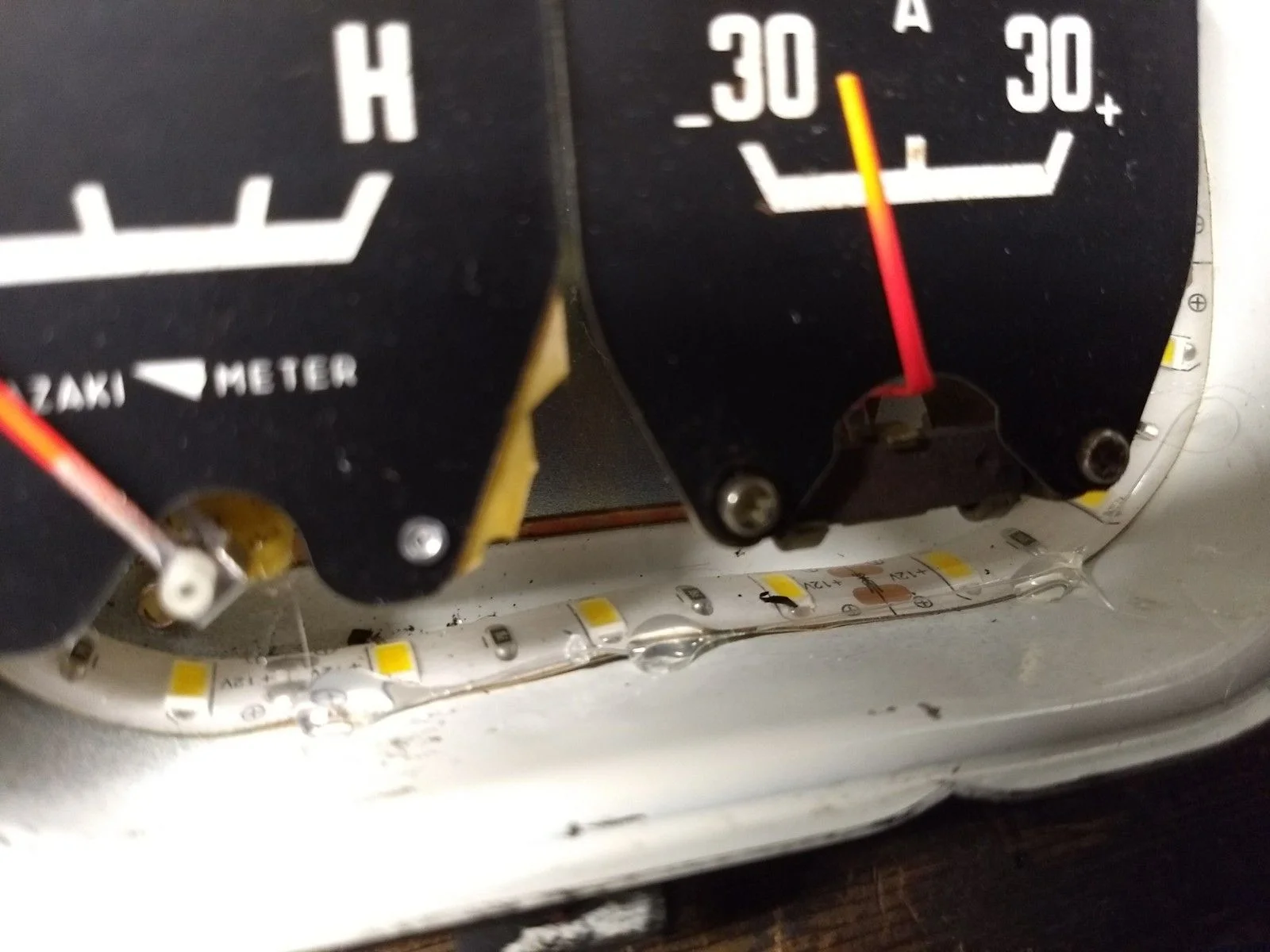

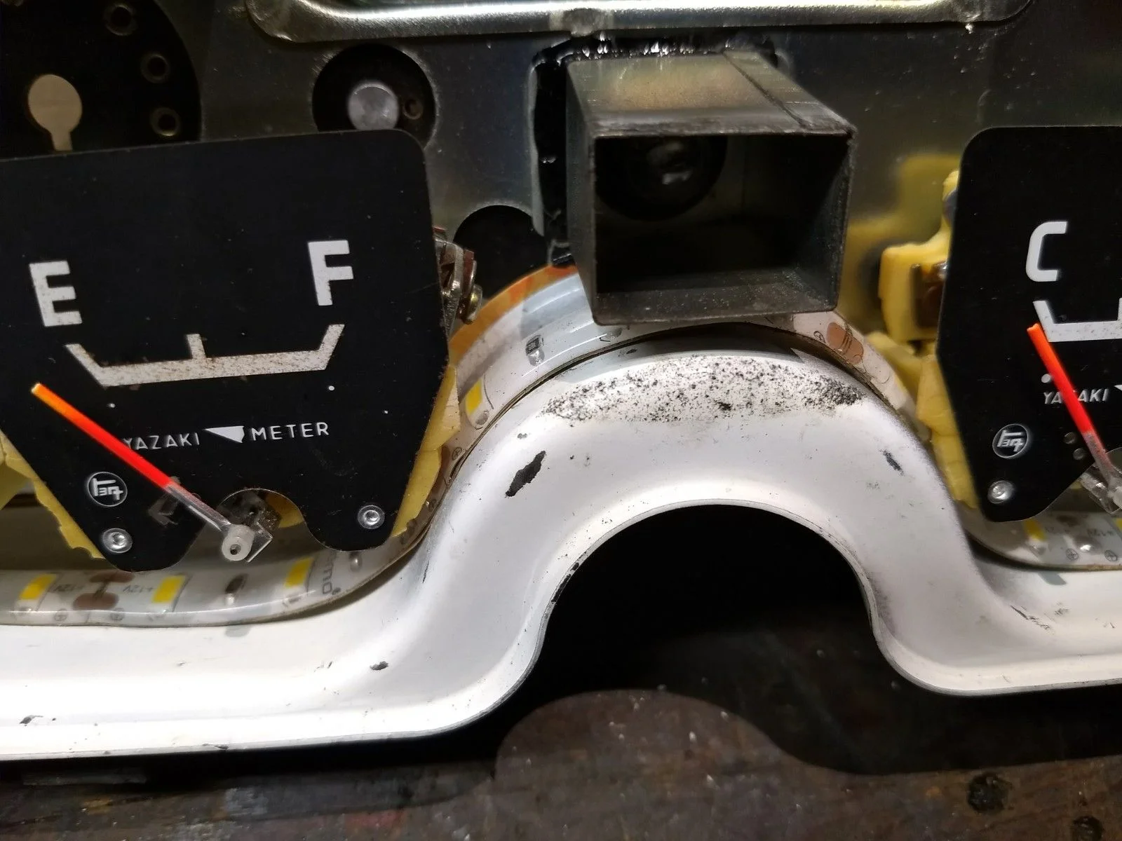

Routing the lower LED strips is pretty straight forward. I started that piece of LED strip at the right most (when looking at the cluster) bulb hole and ran it down and around the outside of the cluster housing. If you get LED strip without the waterproof coating this will be a little easier as the clearance between the housing and the gauges is tight in spots. BE CAREFUL not to damage the gauges! The ammeter is especially easy to bang into and bend the needle - don't ask me how I know.
I used the adhesive on the back of the strip and added a few dabs of hot glue - belt and suspenders kinda guy that I am.
When going over the "hump" I tried to set the LED themselves up symmetrically to avoid hot spots

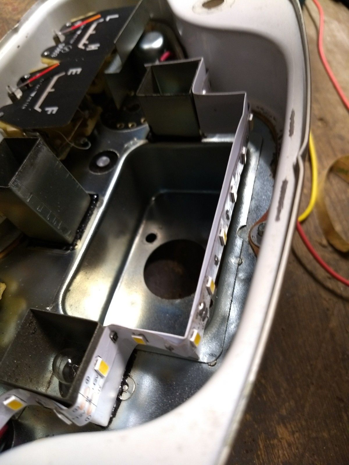

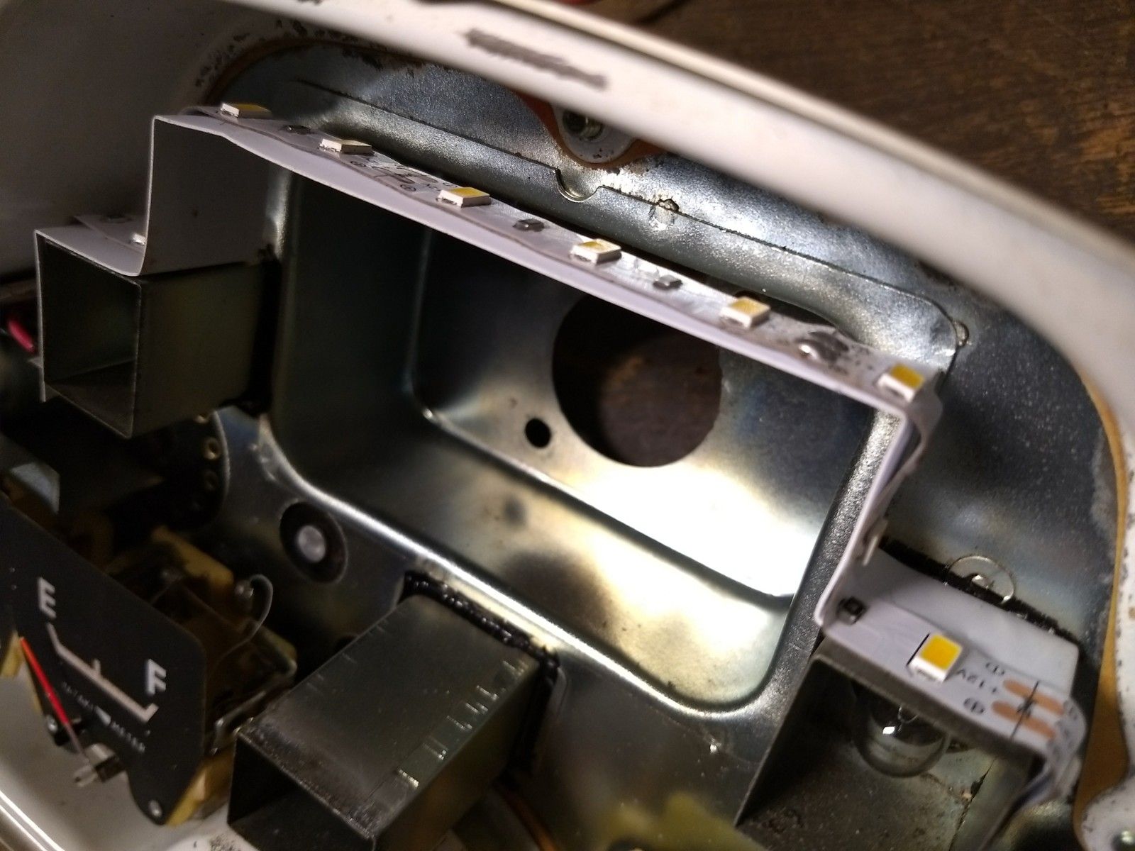

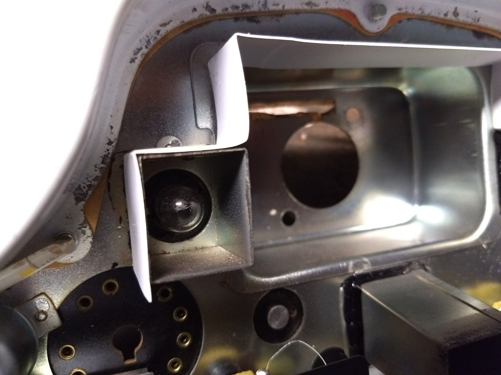

The top piece of strip ended up being a little more complicated. When I ran the strip around the housing like I did on the bottom I ended up with too little light on the speedo AND I could actually see the LEDs when looking from the passenger seat angle.
I ended up building a little "shelf" so I could face the LEDs out towards the white of the housing, this gave a nice even distribution of the light and eliminated the direct LED view. I used a piece of vinyl Venetian blind that I had laying around but any thin strip of steel, aluminum or plastic should work. I bent it to fit over the speedo and to be able to be attached to the 2 shrouds for the turn signals. I hot glued it in place.
I started the top LED strip at the left side bulb hole and stuck it to the shelf.

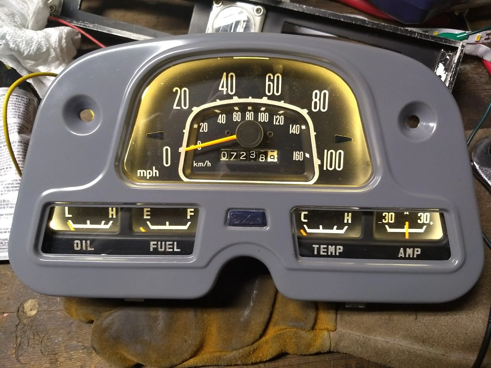

This is how it looks before reassembly.

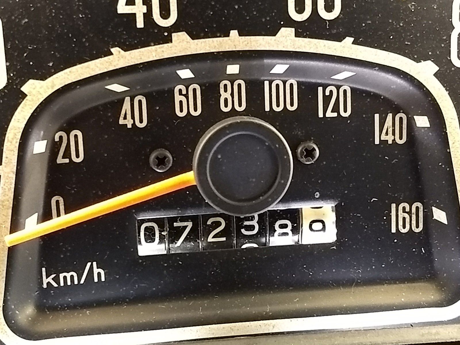

This shows the "better" light on the inner area of the speed vs what I saw in the EL wires pics that are around.

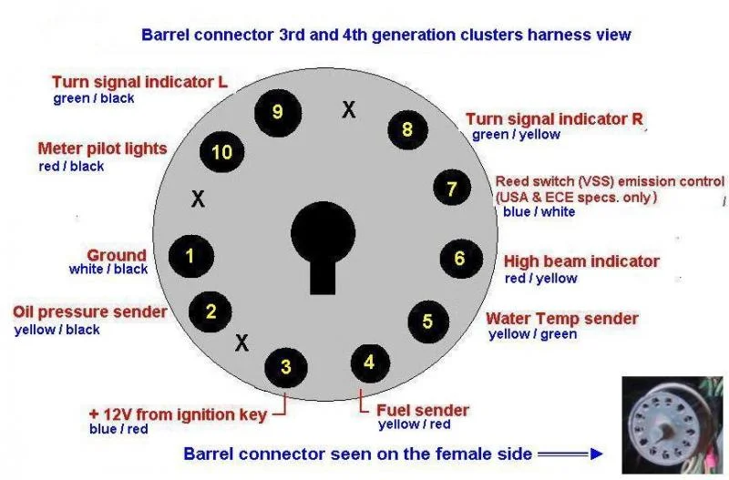

This is a diagram of the multi pin connector on my cluster that I got here on MUD - different model years will have different ways power gets to the cluster so you will need to figure that out for your application. I used this to supply power to the cluster to test the orientation of the LED's leads on the circuit board.
