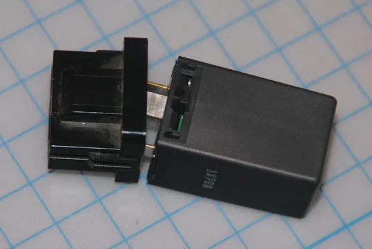

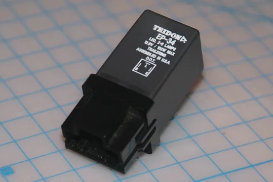

More pics for reference. You can see in the 2nd pic the cover needed to be notched to fit over the new relay tabs.

Now that I live in France, we don't have Napa in Europe. If nobody knows which is the correct flasher from formerly-responsive SuperBrightLEDs.com outfit, then I'll just ask my brother to buy me one of those Napa part EP-34 and send it to me in the mail. Thanks for the great writeup and pics!

I used the Napa flasher and it made absolutely no difference. Still had frenetic high speed blinking.

Napa EP doesn't work the Superbright one for Toyota does.

I replaced most of my rear lights with LED's on my 97 lx450 and get the fast flash turn signal. When I replaced the front two signal bulbs with LED I get no turn signal response in front or back whatsoever. I then replaced the Toyota flasher in the driver door panel with the aforementioned Napa flasher unit and had no change whatsoever, with or without the jumper. So I reinstalled the regular flasher bulbs in the front and have the fast flash in the back and flash in the front for now but i'd really like to use the led's. I'd like to just plug in a new flasher relay but the NAPA one above doesn't seem to work for mine. Is there another Flasher unit anyone could recommend?

Superbrightled.com
Thanks for the heads up. I didn't read your flasher comment about superbright correctly the first time around, not sure how I missed it. I'll buy the superbright today and hopefully it will rectify the issue.
