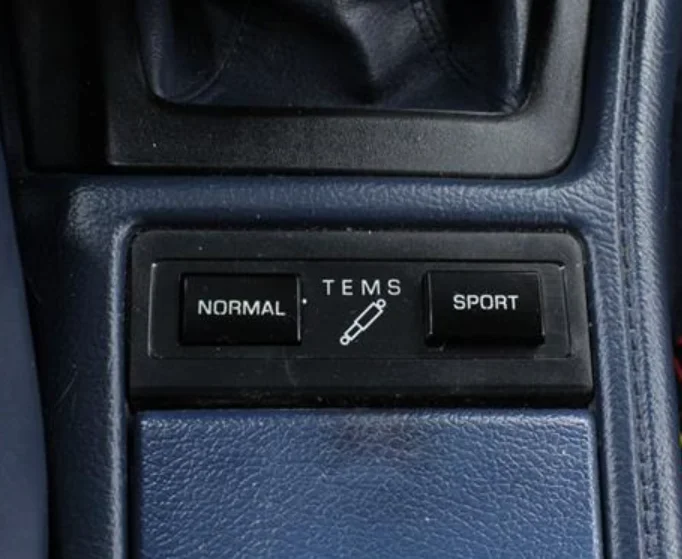

is TEMS the same as AHC or something different?
Same thing. AHC is the height component of the system. AVS is the variable damping component. TEMS is Toyota's acronym for electronic suspension which encompasses AHC, AVS and a few other systems across multiple vehicles. TEMS dates back to 1986 when they put electronically adjustable shocks in the MK3 Supra.

TEMS is the one managed using the Comfort-Sport knob.
So if you change the Comfort-Sport level, you are managing TEMS. I had even ever used other Toyota TEMS cars before my current LC 100.
I used to know TEMS in my earlier Toyotas as Toyota Electronic Modulated Suspension.
