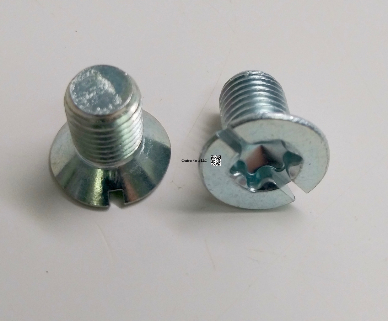

I personally would without question stake punch this new torx V - head machine screw that replaces the flat head
Just because it’s a torx does not mean it is an anti-stake feature ?
Toyota part#90149-10001 installed and staked.
No one suggests the Torx head doesn't require staking.
The "upgrade" is a screw more easily torqued (and removed) than the original flat head..
@ToyotaMatt .
Could you explain what you mean by your statement?
sure ,
after seeing the above tech. photos and seeing the post's where some folks mentioned the new updated TORX type fastener's for the front end
plate , as both a upgrade and a implied substitute , it puzzled me as to why TOYOTA has not to date simply made or created a direct across
the board global official parts suppression from the old 90113-10022 old flat head , to the newer 90149-10001 recessed female
torx. head ...?
i took the time , out of shear curiosity , and found some confliction global 2F engine appliccation info of when the 90113-10022 is phased out and the 90149-10001 is introduced ? there is a few years of overlap in many cases , on same exact land cruiser Modle ID codes ?
i have chalked it up to a Toyota laziness oversite , both to overlap both part numbers and to NOT supersede the old one for the new one ...
so i posted the 3F FSM pages step by steps above to assist anyone who may stumble upon the topic in the future ....
does this better explain my above statement :)

No, it doesn't explain your statement regarding my post.
My post that you quoted in your retort:
I refer to the "Torx head" (accurately stated) and "a screw more easily torqued.." which is also accurately stated.
Your retort was:
"TORX and Torqued got mixed up a bit above .... :D"
So, please explain how my post "got mixed up a bit"...
Your retort was:
ok ..........
i am not sure what a " retort " is ?
but if your referring to when i made my comment about TORX and Torqued being mixed up above , i was referring to myself , and making phun of the fact that i read all the various post way to fast , and related the 2 words to each other in a satire and dry humor way , because i did indeed
do just that ...
i also have never seen this updated TORX screw before , so sometimes new and different things can confuse people ....
does this now explain better , that i was not actually referring to your post ?
- last night i did a in-depth MUD Advance search on this 90149-10001 " updated TORX " screw , and i did find some past content on it , but is was very scarce at that ....
- so i guess folks now know it can and is a acceptable substitute for the old disc. / nla 90113-10022 thanks to your detailed TECH post above ..
- thanks mr. 73FJ40 :)
