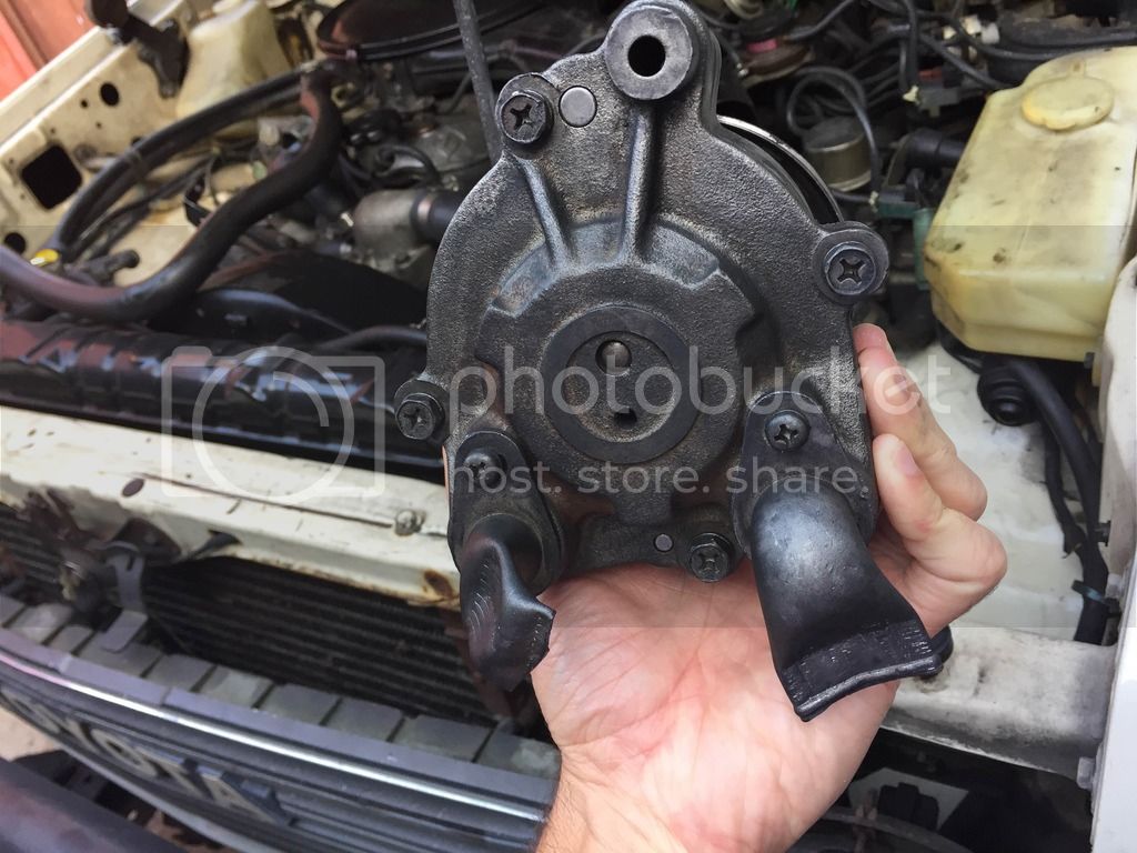

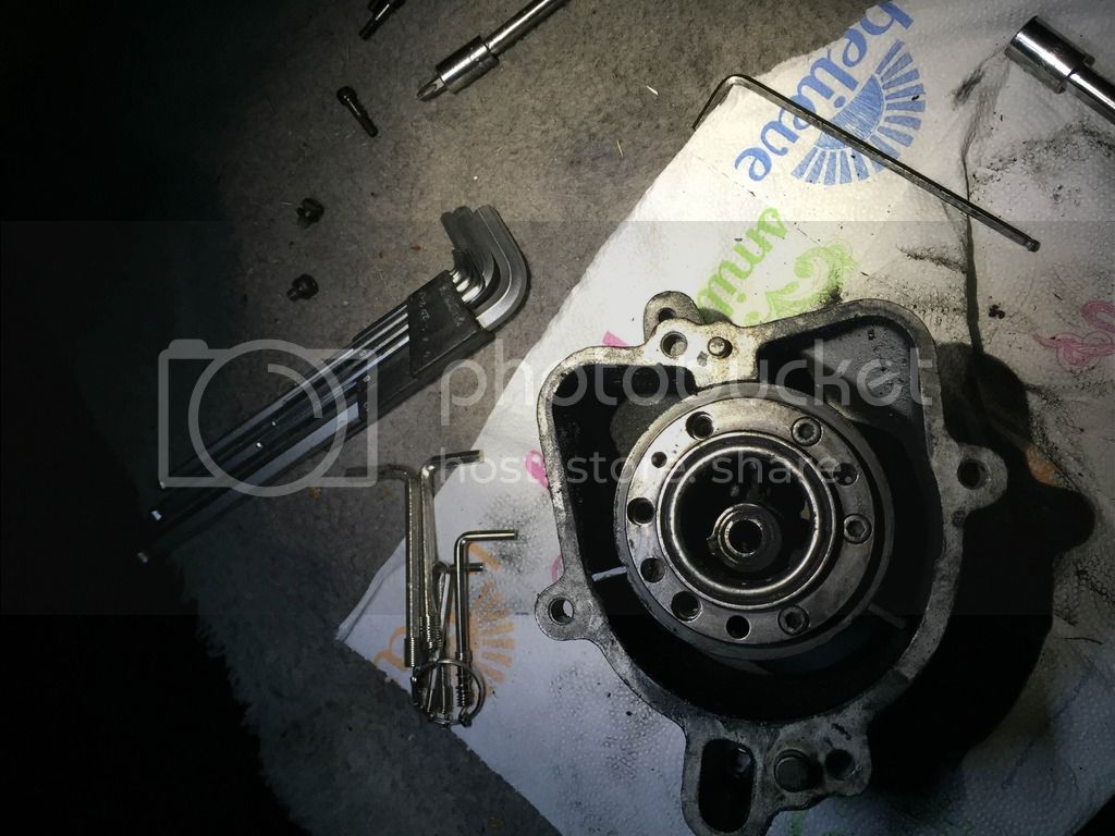

For future reference I took a few photos.

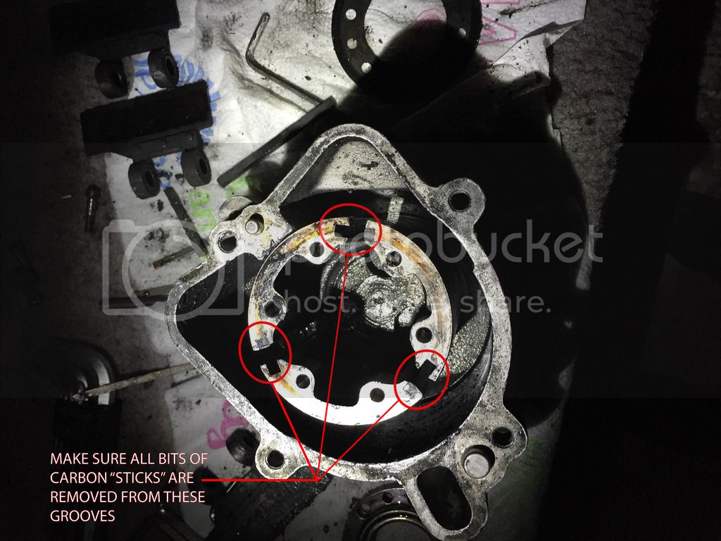

In this photo the pump is almost gutted. You can see there is still some carbon smog stick material in the grooves which still needs to be removed.

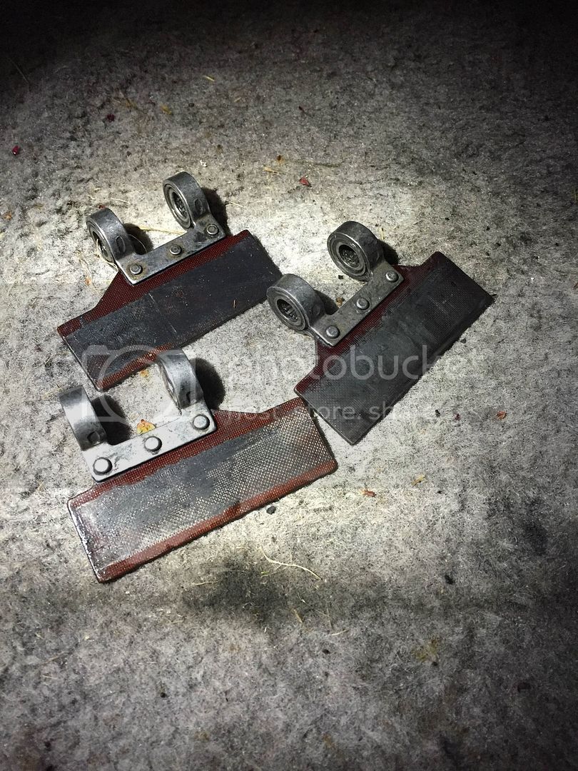

These are the three fins/vanes that get removed. If anybody wants these they seem to be in good shape. Let me know.
The two pipes coming off the back of the pump, bent shut. What happens at the other end, where these connected to the rest of the air system?
And finally, the bearing that needs to be regreased is comprised of small steel rollers which sit between the two steel rings surrounded by hex head screws, at the center of the photo below.

Spike Strip- I believe there are no cracks. I'll send them your way, pm me your address.
